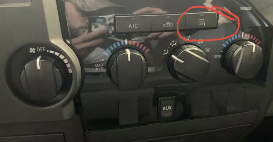

    The one I grabbed was from a 2WD, not sure if it's the same as 4WD.

    It probably won't have the indicators for 4WD hi/lo, naturally.

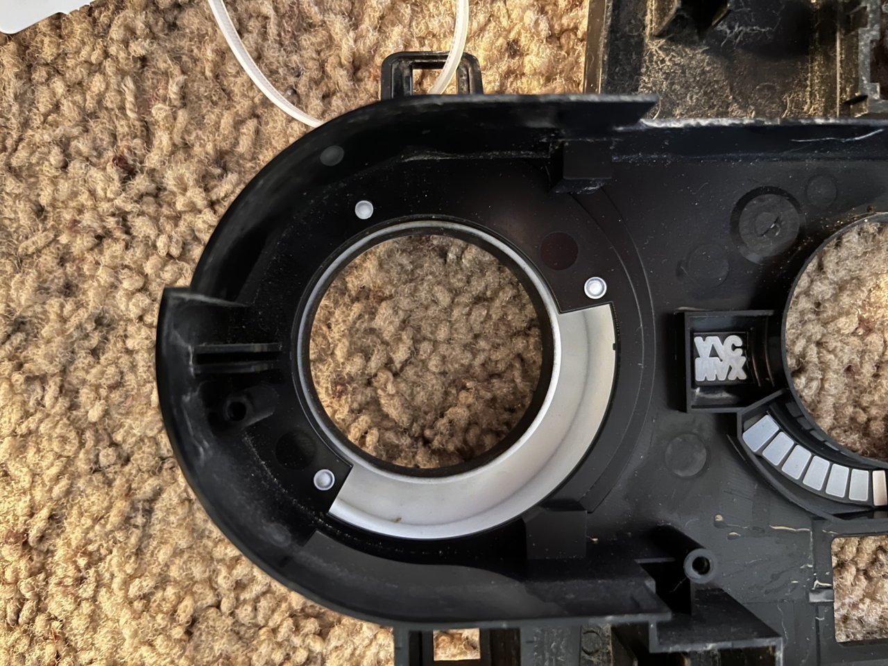

    I got something else going on in the journey converting the dash to black. Climate controls came in yesterday and looking closer the defrost button on the black knobs compared to my grey knob button looks different. The black appears to be a side view mirror defrost only. I’m assuming these controls are for a DC without the defrosters on the rear glass. I’m thinking about just swapping the knobs to avoid losing defrost on the back glass. Does anyone have any experience on these climate controls. TIA!
    B85AC12E-B2AB-470B-9C1C-02DB430A292F.jpg F6F9E4C4-8EC6-4AA0-95E5-0EC81DDDBF64.jpg

    The fact that it specifies makes me think there is a difference. Probably just the indicators.

    How would you swap the fan ring? I haven't taken my climate control unit out in awhile. Can the fan-strength ring be removed without breakage?

    Obviously I have no skin in the game, but my virtual money is on the button activating both the side mirrors and rear glass in a CM
    Let us know?

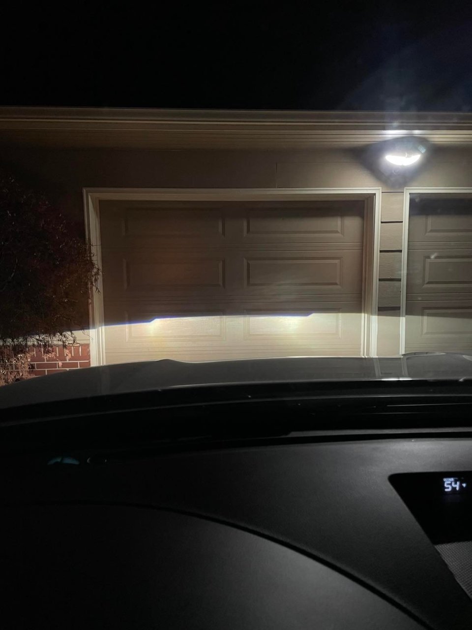

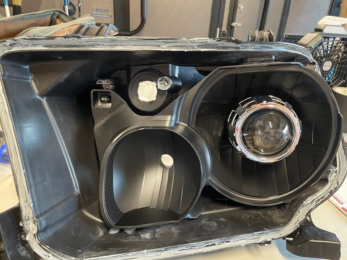

    New to the group so I just wanted to slowly update on the upgrades I've done to the truck.
    Retrofitted some projectors from the Retrofit Source. It leaked the first time sealing it and I put it all back to stock after the frustration. After some time, I took them apart again and re-sealed it with a thick layer of butyl rubber instead of stretching it out like how they were in the instruction videos. Took it to the car wash and it didn't show any signs of a water leak so they're staying on the truck lol.
    If I had to do it all over again, I'd fork out the money for a set of Morimoto's and a really good explanation to the wife on why I needed them haha.
    Oh yeah, don't be a dummy like me and paint your hi beam reflector bowl. I had to find a projector type bulb to fit in there as my hi beam, along with the bi-xenon function of the projectors.
    Cheers

    Here’s an update for this. There is 3 plastic welded tabs holding the fan speed ring in place.
    074615F5-43A3-4A60-83EF-6A8A9BF877FB.jpg B9244520-D832-4E75-9387-657930398CEE.jpg
  14. Feb 19, 2022 at 3:25 PM
    oogabooga289
    oogabooga289 New Member
    Jan 7, 2019
    #24086
    218
    Interesting. Looks like drilling/dremeling the backside of those plastic welds and using a few dabs of epoxy after the swap would probably do the trick. Bummer it wasn't just clipped in. Thanks for the update!
    joseph_womack and 20GR8 Super like this.

    Yes I think you are probably right on the epoxy. I am going to try to polish up the front fascia before I try to remove the ring.

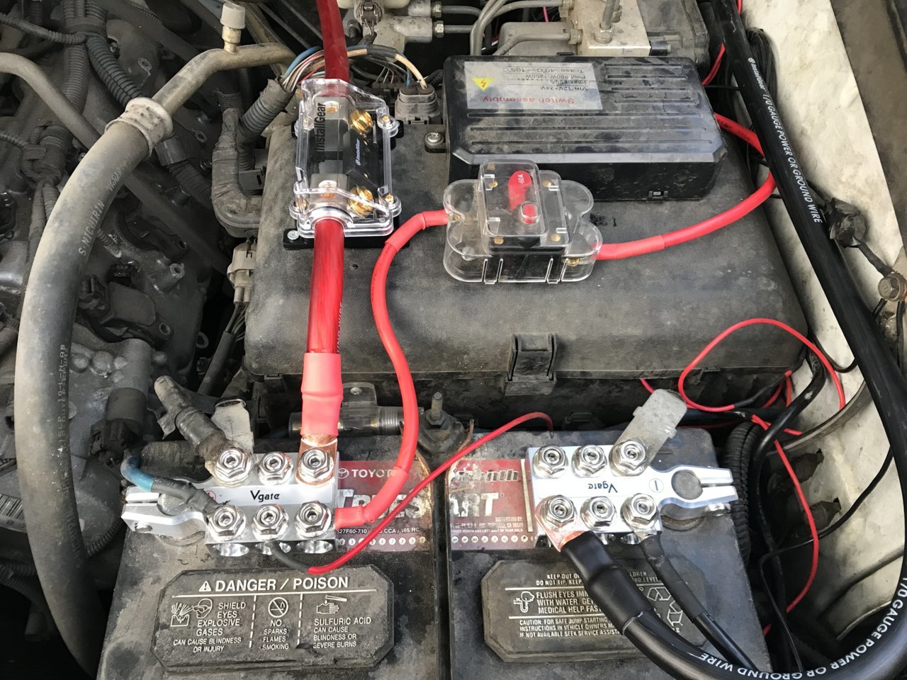

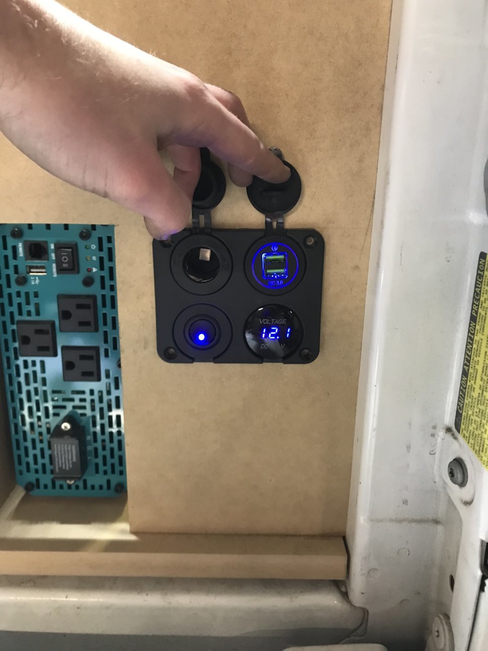

    Wired up my inverter and have a tie-down track ready to be installed, but I ran out of daylight to install it. Unfortunately, as seen by the voltage meter my battery no longer wants to play nice. That picture was taken right after I shut my truck off so the readout should be closer to 12.6 and if I run the lights in my bed I can watch the voltage tick down like a countdown which is not good. I have not had any problems with starting the truck yet but I have a feeling it is only a matter of time at this point. The battery is about 5 years old now so it is the right time for me to be in the market for a new one.
    Most exciting of all though, I replaced a burnt out brake light!! :rofl:

    Those are some battery terminals. NICE

    is it safe to assume you are prepping your truck for a ghostbusters sequel or are there other valid uses for that equipment that I’m unaware of :confused:
