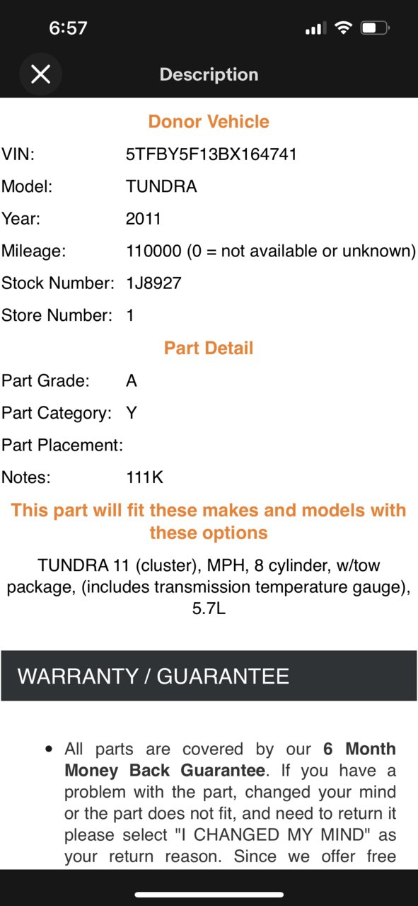

    Can you post all the details? Part # for the new cluster? Old cluster? FFV/non? Any VIN info on the new cluster or your truck? Years? There has to be some sort of cross-reference to be made that could help people.

    Unfortunately I didn’t get the part number off the new one. I will be taking it apart one more time to paint the cluster bezel. I will take notes then.
    This is the details I do have from the donor

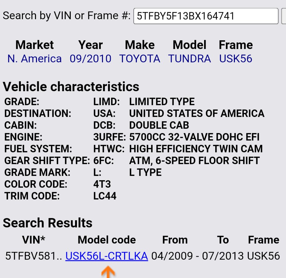

    Here's what I pulled off the listing VIN:

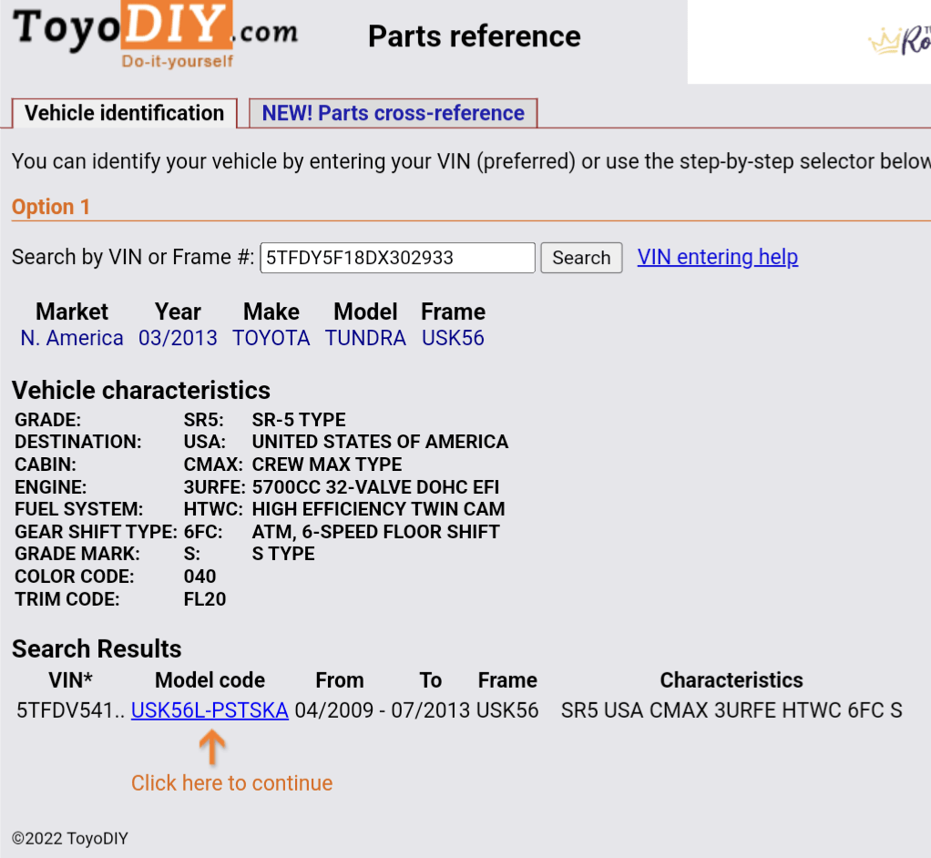

    My VIN 5TFDY5F18DX302933

    Looks like your engine types align. I'll do a little more digging in the morning... Still waiting on my offer response on eBay. That'll probably tell us a lot if/when I get an Optitron and compatibility between FFV/non vehicles...

    It's a good sign for me that a cluster from an 11 fits a 13.
    Your truck:

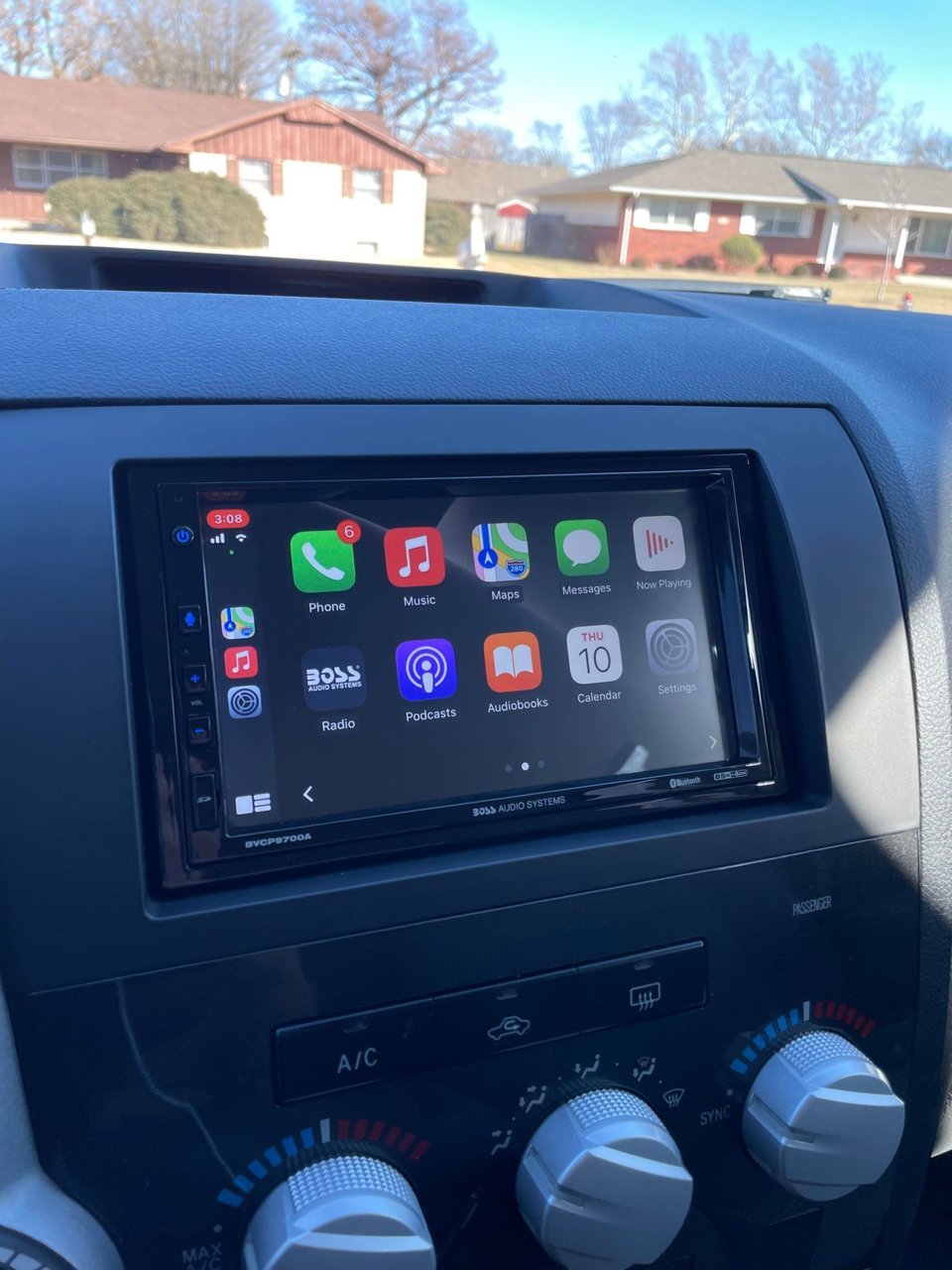

    New head unit along with rear backup camera. The part that took the longest was running the camera wire into the cab, other than that it went pretty quick.

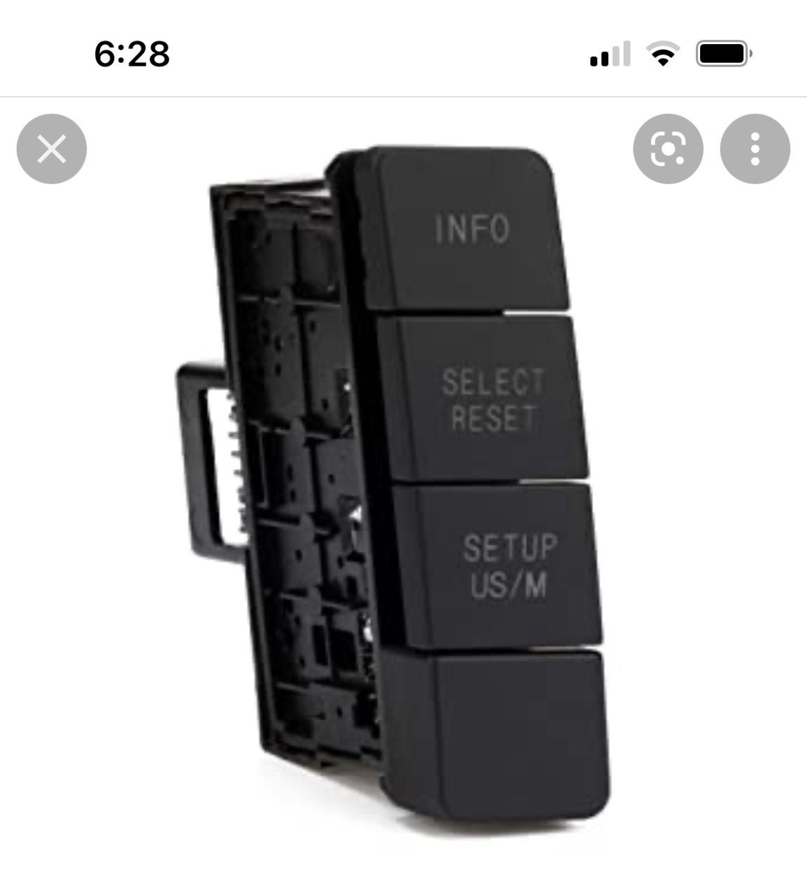

    I also have those buttons, but they control the little display on the center of the dash...
    joseph_womack likes this.
  20. Feb 19, 2022 at 7:05 AM
    Wynnded
    Wynnded What MPG...
    #379
    5,654
    Rockies
    Souped up truck
    When you plug in an Optitron cluster, they then change to control the display in the center of the cluster. You don't have to modify anything.

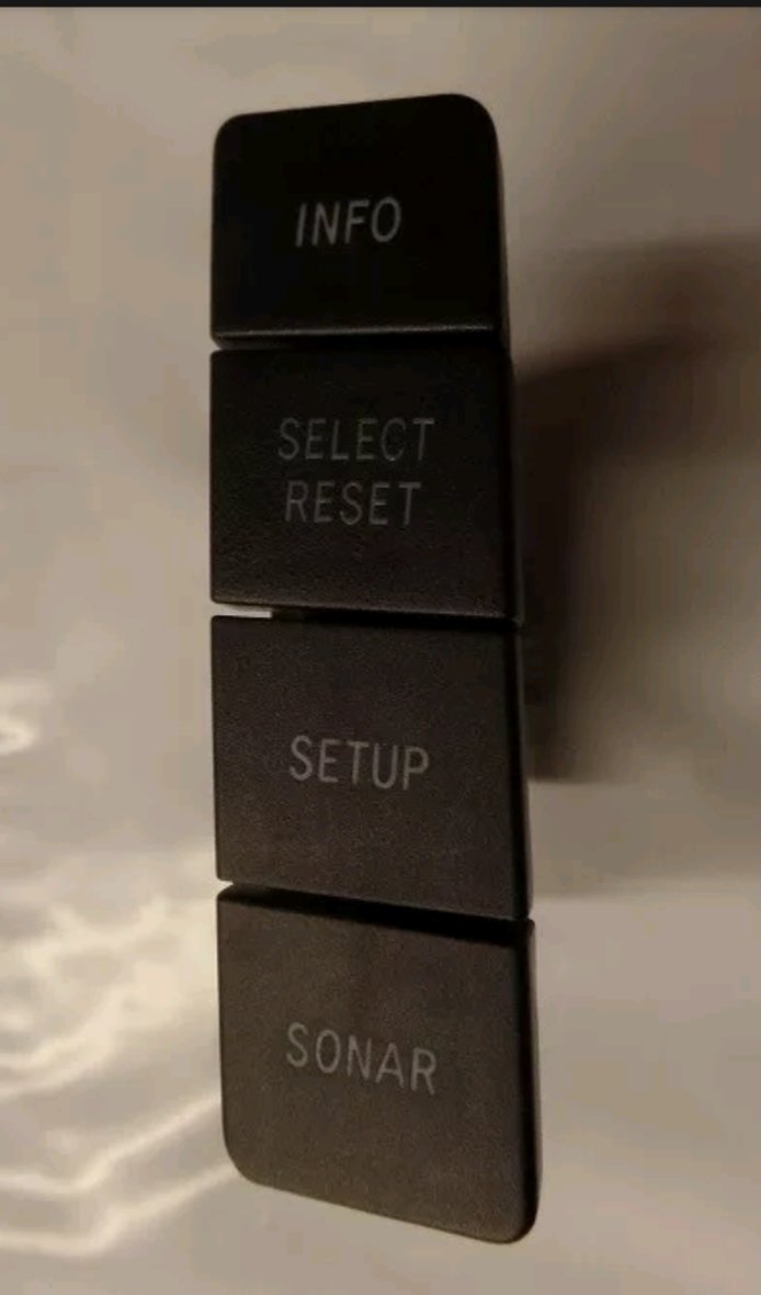

    That's interesting, so the center display just goes back to being a clock only? My buttons are also a tad different. They look like this:
    McYoda and joseph_womack like this.
  22. Feb 19, 2022 at 7:16 AM
    Wynnded
    Wynnded What MPG...
    #379
    5,654
    Rockies
    Souped up truck
    Clock and ambient temperature. I think that there are two different button configurations. For example, mine doesn't have Sonar because my truck doesn't have sonar. Either should be compatible with the cluster.
