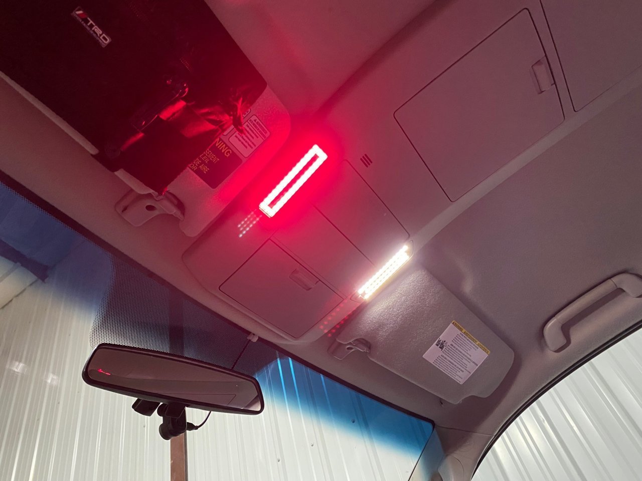

    Installed the Meso customs LED interior lights! Very easy installation. Also another confirmation that these fit 2nd Gens. If you have a crew cab with the stand alone dome light, the rear light will fit. Fitment is spot on, color match is spot on and they are brighter then bright - seems like a quality product.

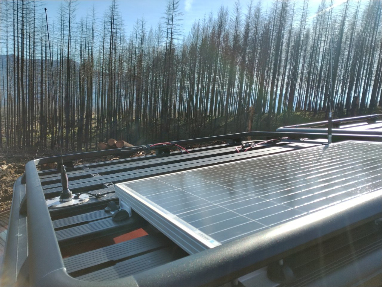

    Got my solar panel installed, made a new mount for the VHF antenna using a 5" x 1/8" stainless steel disc.
    Thumb screws look like they'd be easy to take off.... Looks are VERY deceiving. To get the panel off, you have to take the rail off. To get the rail off you have to hire a 10yr old or a junkie to reach their arm in to tighten the center support bolt.

    Are you running a secondary battery for add-ons? What setup do you have?
  6. Feb 9, 2022 at 3:29 PM
    Windsor
    Windsor Why do I do this to myself?
    Jul 8, 2018
    #16847
    908
    Homeless in Oregon
    2008 Tundra Crewmax 5.7L
    Some.
    No secondary battery. Put solar on to keep the battery topped up and to deal with the draw from my company supplied vhf radio. Have to leave it on 6-14 hrs a day depending on what they have me doing and don't like idling the engine.

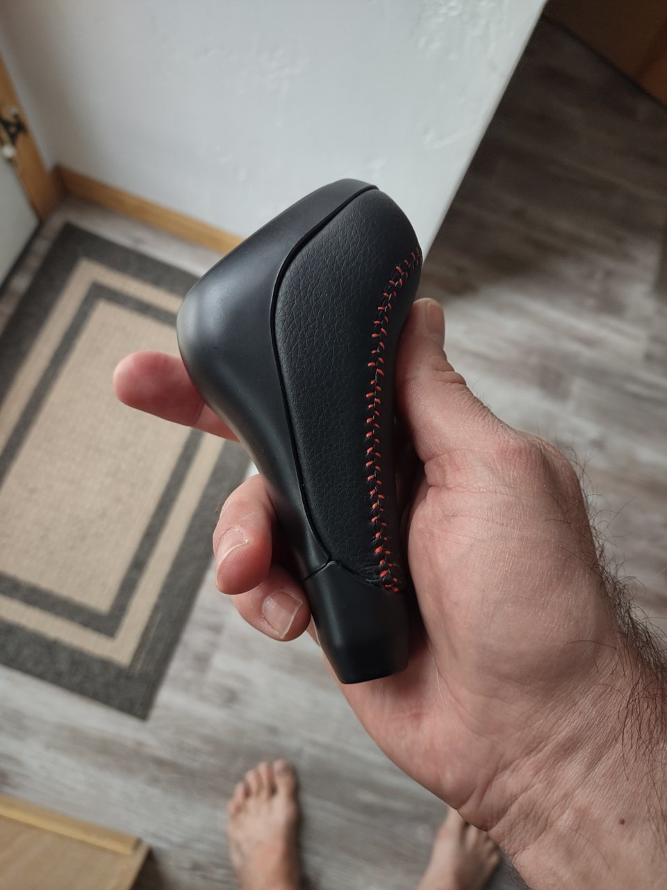

    Added a "TRD" shift knob. It's an Amazon piece for $35... But looking it over, I'm willing to bet it's a legit TRD knob 'second'. There's a small scuff on the plastic that likely means it didn't pass quality inspection. But I expect it'll get scuffed up anyway, so I'm happy with it. No issues installing, perfect fit.

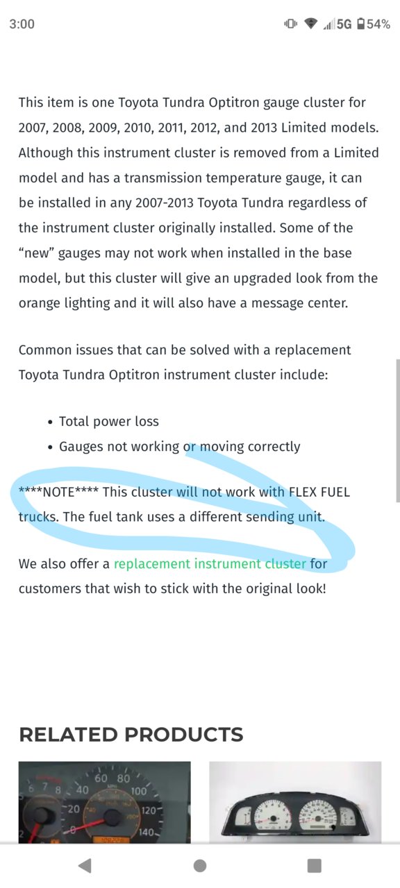

    Jealous. From what I've read, the fuel gauges don't work with FFV so I'm SOL. I am strongly considering doing the LED swap once it's not 4 degrees.

    I’ve got 17’s and 35’s. You have to run stock size brakes, and make sure that when they get balanced they put the weights at the edge of the wheel. They might clear the caliper but I didn’t want to risk it. There is not much clearance in there with 17’s

    It works with ffv

    I've read several places (including the manufacturer's website) that the sending unit on the FFV is different. It probably works overall, but the fuel gauge might not.
    You're saying that's not right? If not, this becomes an option (they're only like an hour and a half south of me).

    Yeah, I'm 100% positive the optitron cluster I have works 100%. I put it in my 2010 Flex fuel SR5. I got the thing off ebay a couple years ago. I have no idea what it came out of, would probably have to be a limited. There's a guy in Denver that I sent it to and he programmed the exact mileage I needed it to be and sent it back, wanna say it was $80 +shipping. The guy's warning seems pretty serious, but I'm not sure if he's right.

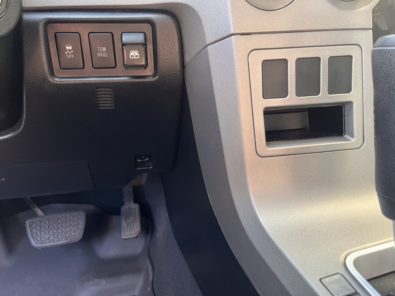

    Got the Optitron in today and I must say it’s very nice. I didn’t lose any gauges and everything works as it should. It’s cool to have all the extra features and settings. Money well spent!
    Also while I was in there I lowered the dash dimmer switch to the opening near the left knee and the tow/haul up to the open space near the right knee. I have plans to paint the last few grey pieces on the dash so organizing switches ahead of time.
