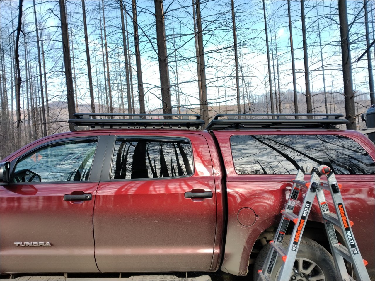

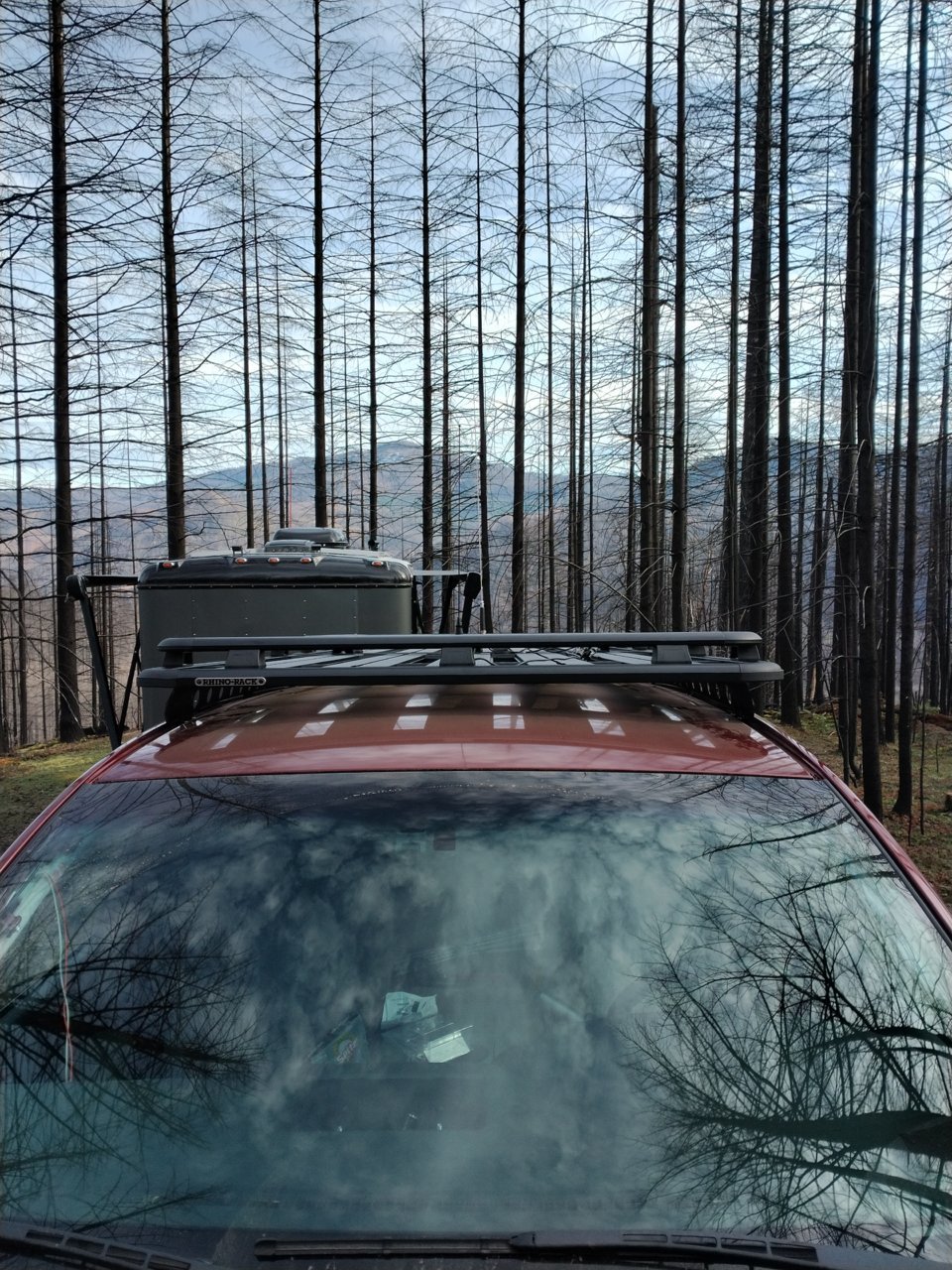

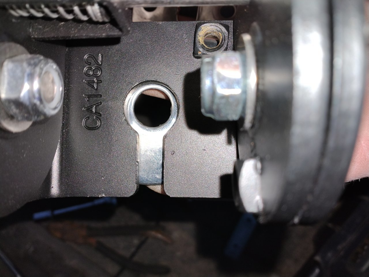

    Some.
    Had a 4" branch jam itself into the back side of my front passenger wheel. Twisted the backing plate up pretty good. Had to take the wheel off to straighten it out so I could keep driving.
    Tried mounting my Firering cable and CB antenna to the Rhino Rack mount. Unfortunately, the hole is FAR too large. Ended up having to take the fender mount off and mount it on the rack. So, my antenna is canted and off center. I am going to modify the RR bracket by cutting the hole large enough for the Firering to fit inside and I'll cut off the mounting face from the fender mount and tig it to the top of the RR bracket.

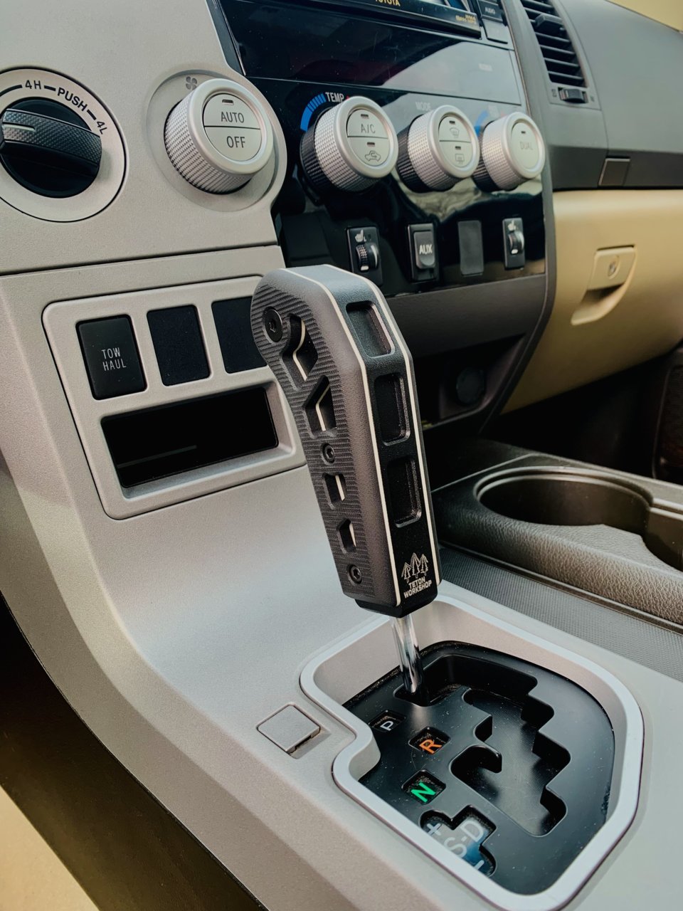

    Put the new Teton Workshop shifter in today. Need to get rid of the rest of the silver now.

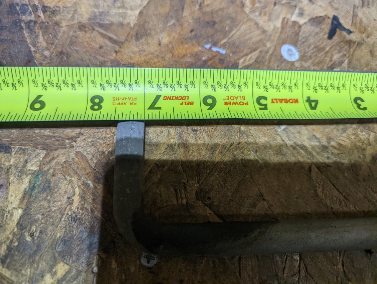

    For anyone needing to know, the factory U-bolt length dimension is 7" (inside). Toyota calls it 170mm. I suppose it's possible that mine are stretched to the full 7" (177mm).
    Inside is 2.5" and diameter is 14mm (9/16" for aftermarket replacement)

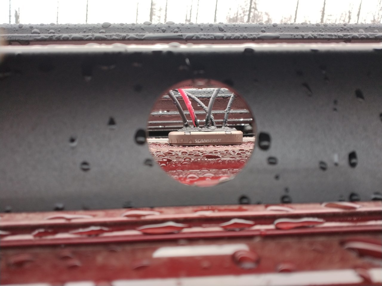

    Some.

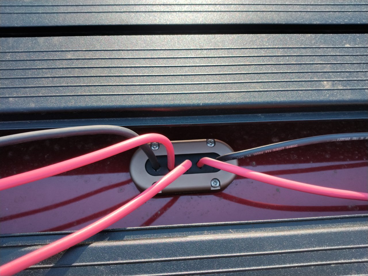

    I am using them for solar panel, CB, VHF, and some lights. For a little added waterproofing, I am putting some self leveling sealant on the top to ensure everything is sealed up. I also put a bit on the heads of the bolts that mount the rings to the roof so water can't creep by.
    Edit: all exterior wiring is heavy jacketed UV resistant wire.

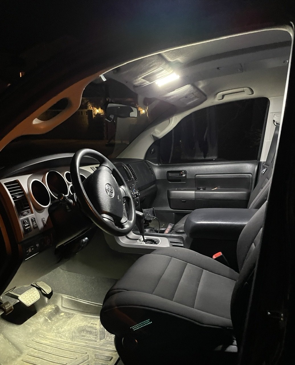

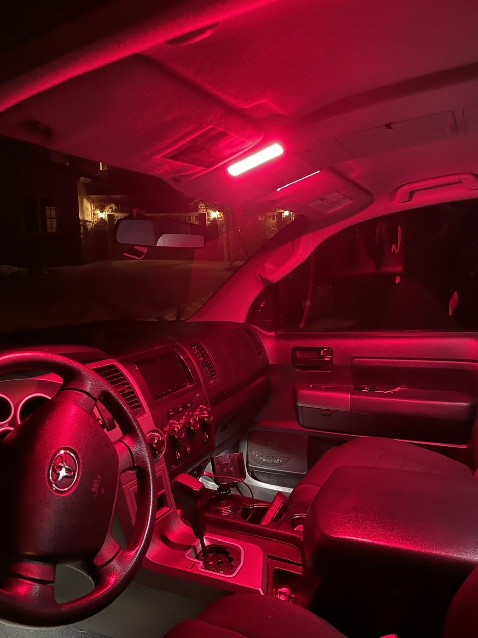

    Meso custom map lights. Says 2.5 gen but they 100% fit.
    super easy instal, lights look good but a diffuser lens over the leds wouldn’t be a bad idea. They are really bright.
    I had regular led bulbs and they kept going wonky and flickering and the silver reflector sucked to mess with. I hope these hold up.
    Light 10/10
    Fit 9/10 - still the best option I’ve seen.
    Looks 7/10 my preference to have a cover lens. YMMV.
    All in all - I like
    https://mesocustoms.com/collections/toyota-tundra/products/tundra-ultimate-map-lights

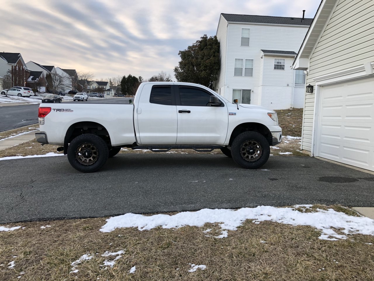

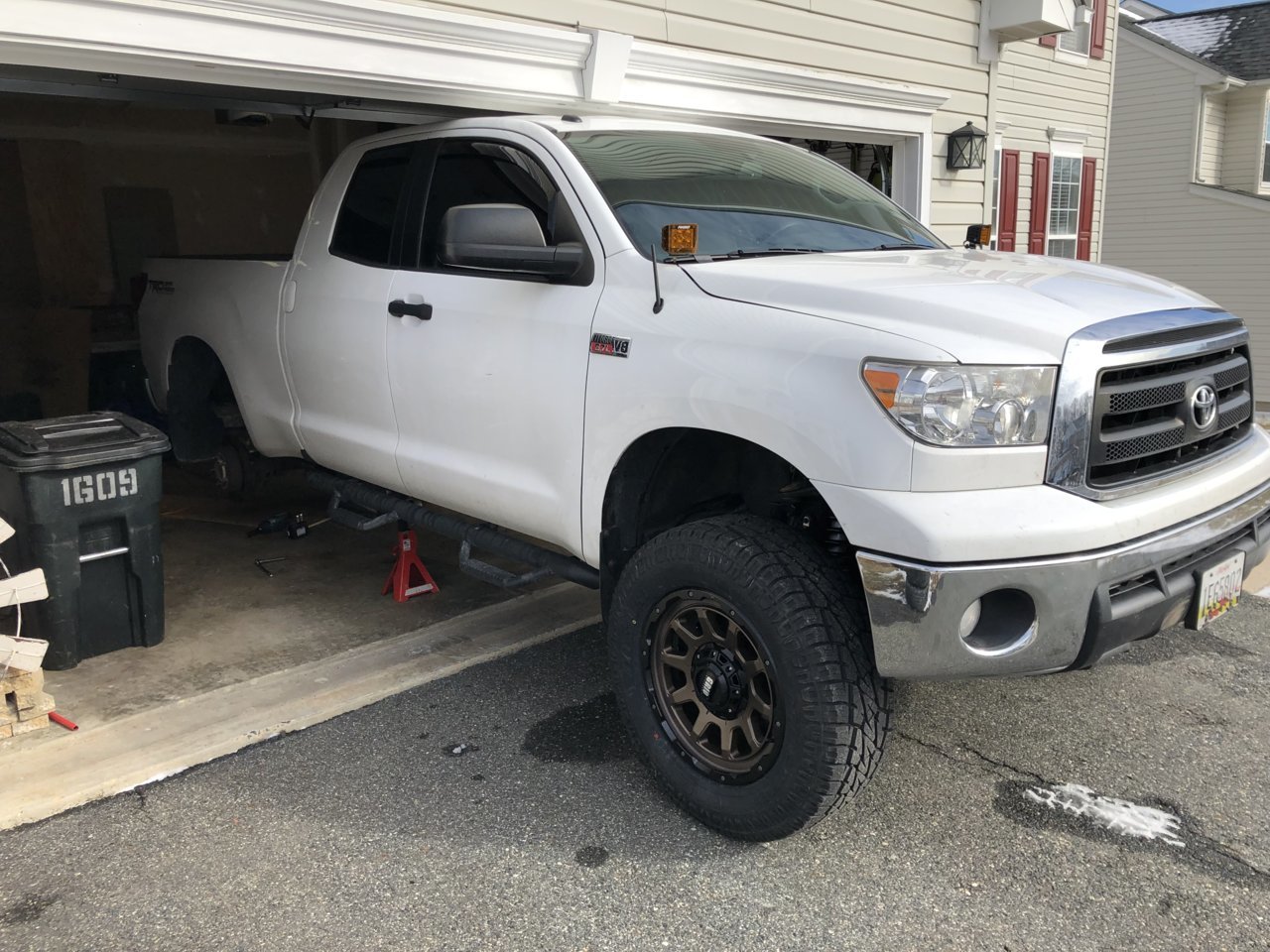

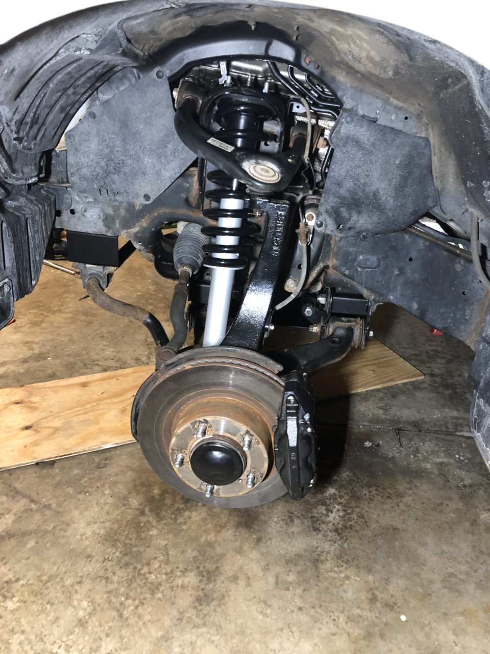

    Installed a 4.5” Rough Country lift and put on my new rims and tires over this past weekend. I live in the rust belt so the job took way longer than expected. The ABS sensor in both the driver and passenger knuckles decided they wanted to live in the OEM knuckles forever so that was a nice added bonus. Has anyone used a speedometer recalibrate before?

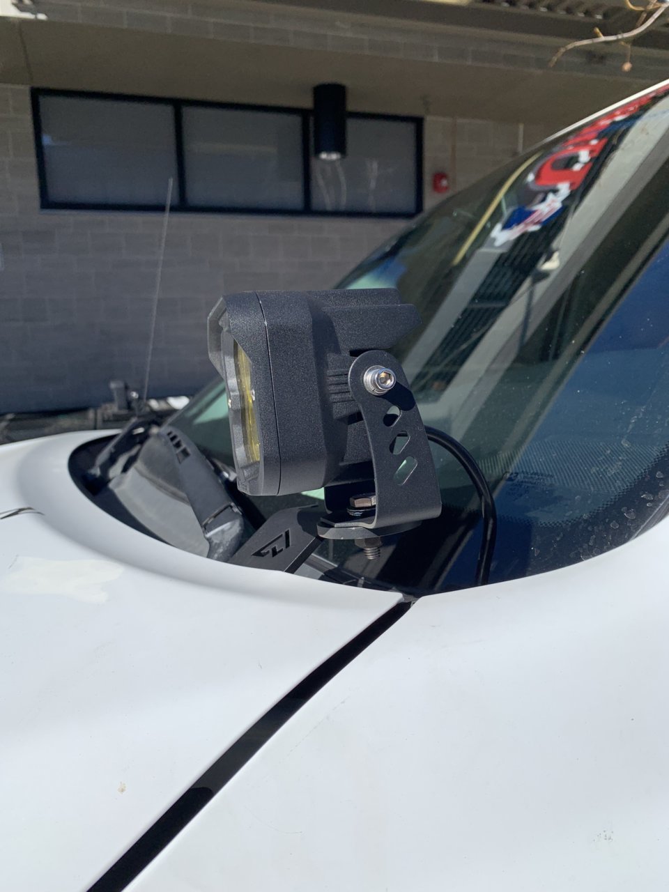

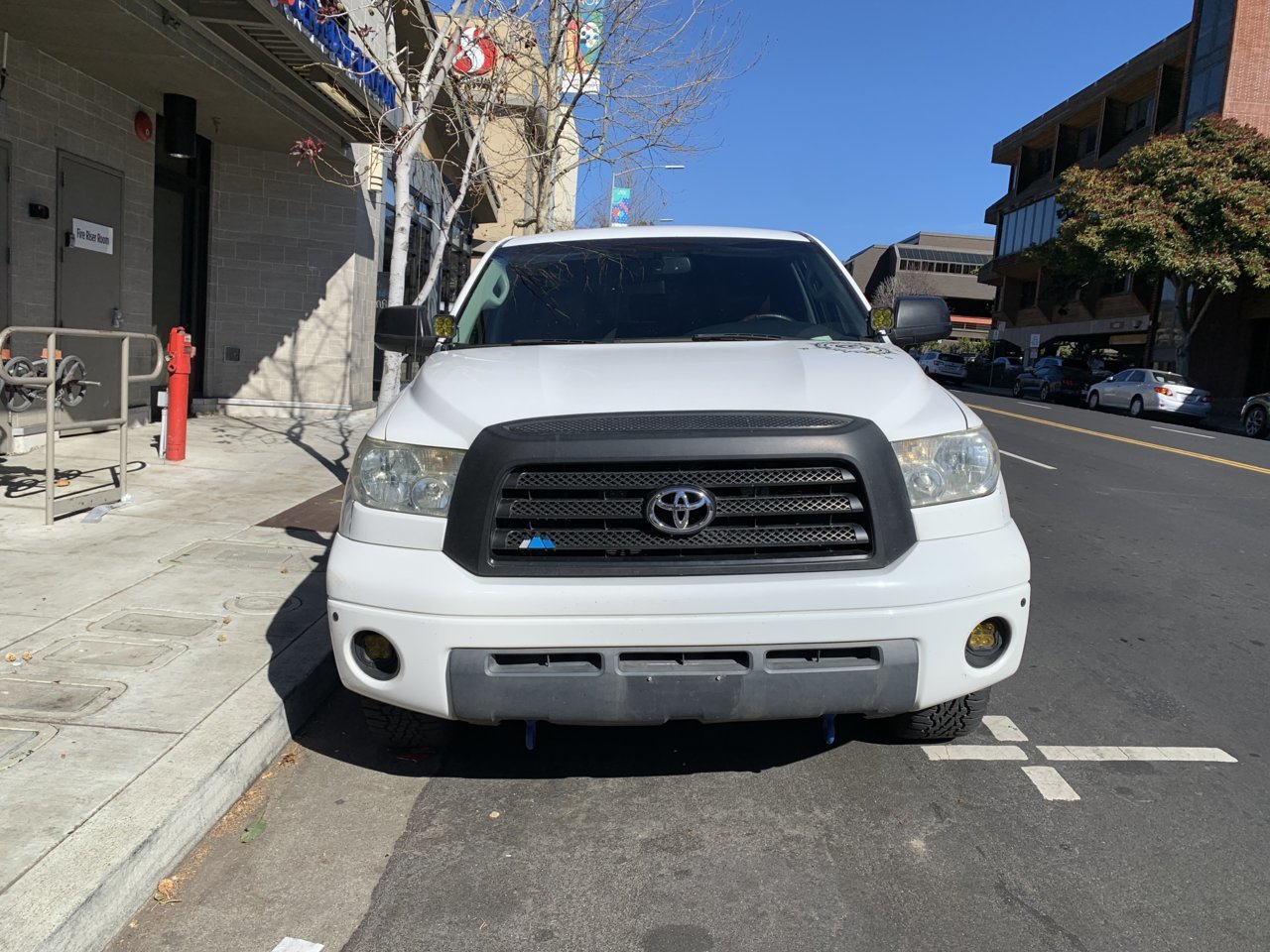

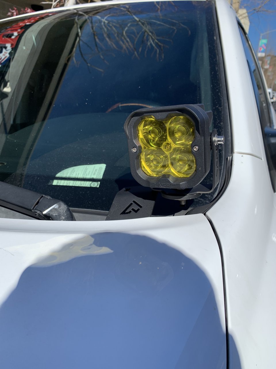

    Been a while since last posting. I was having a hard time trying to decide on hood mount brackets and came across someone on Facebook selling Pelfreybuilt brackets. Did a little bit of research and for the most part people were happy with their products. Unfortunately things turned out bad for them so these are their remains. Gotta say I love the mounts. The logo is great it adds on to the mountain theme I’m going with.
    Also thankfully someone on the forum was kind enough to give me their old splash guard will be painting that and adding a latch for easy engine oil changes. And finally changed my sparks plugs first time doing it myself pretty simple straight forward with all the great info on here. Returned to school to work on an electrical certificate so it’s going to slow down the progress but it’s moving!
