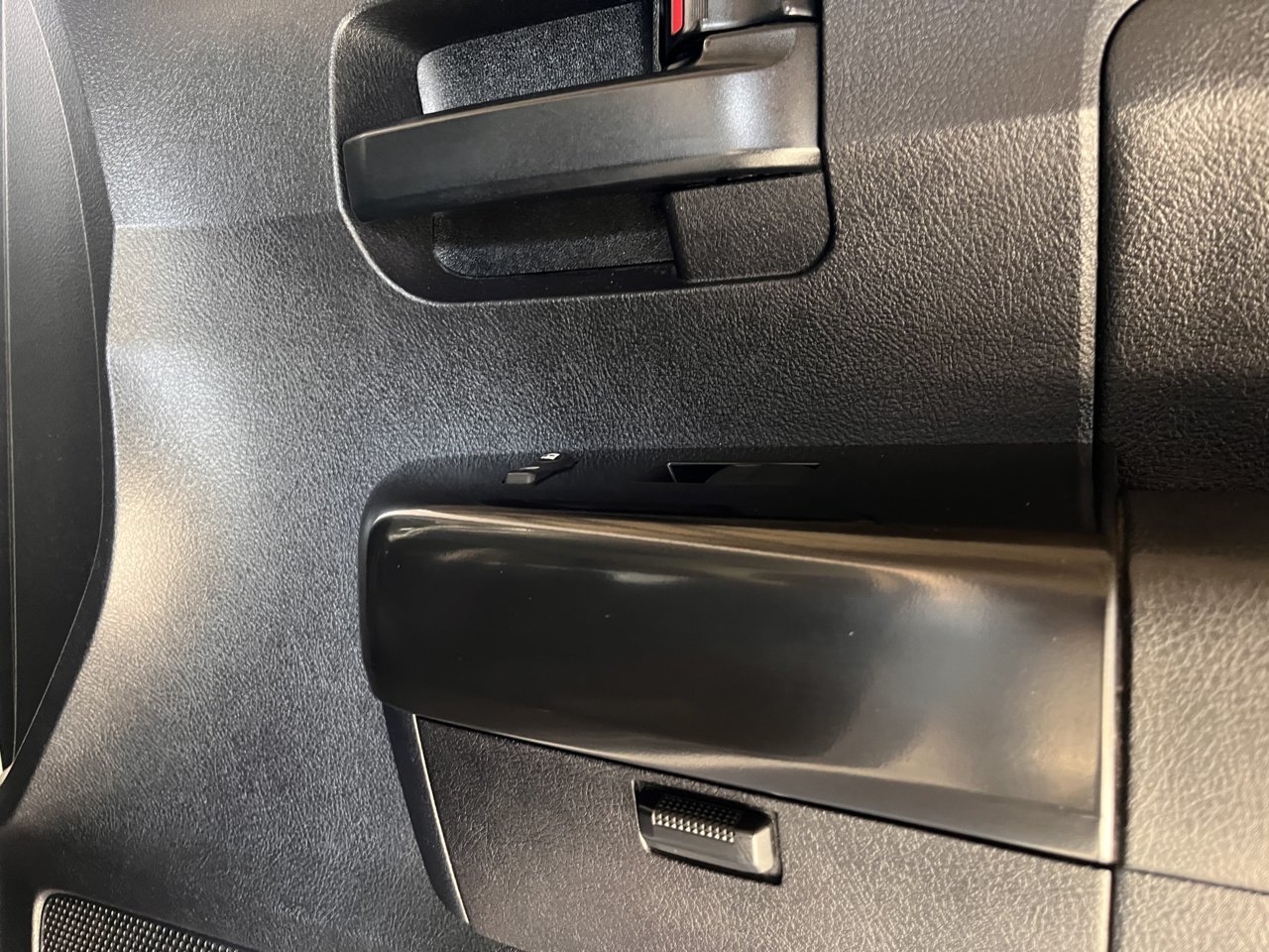

    Sprayed the window switch bezels. Used Krylon Fusion matte black. Did 3 coats then wet sanded 500-1000 grit. Did 3 more coats then wet sanded 3000 grit followed by a buff. All and all came out shinier then I would have liked for matte but I’m happy with it. Next will be the speedo cluster and shifter bezels if these hold up well.

    How did they look without the wet sanding? Did they still have some of that texture feel/look?

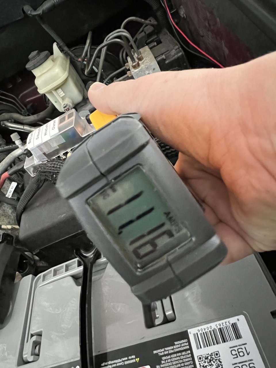

    Just put the battery charger on it......

    They were definitely more matte finish before sanding. As far as the texture goes I couldn’t get anything consistent enough to look like the rest of the door panel. I did see that SEM makes some sort of “texture” in a spray can. At the end of the day the most important thing to me is that it lasts without wear or chipping.

    Agreed! Will be watching to see how they hold up.

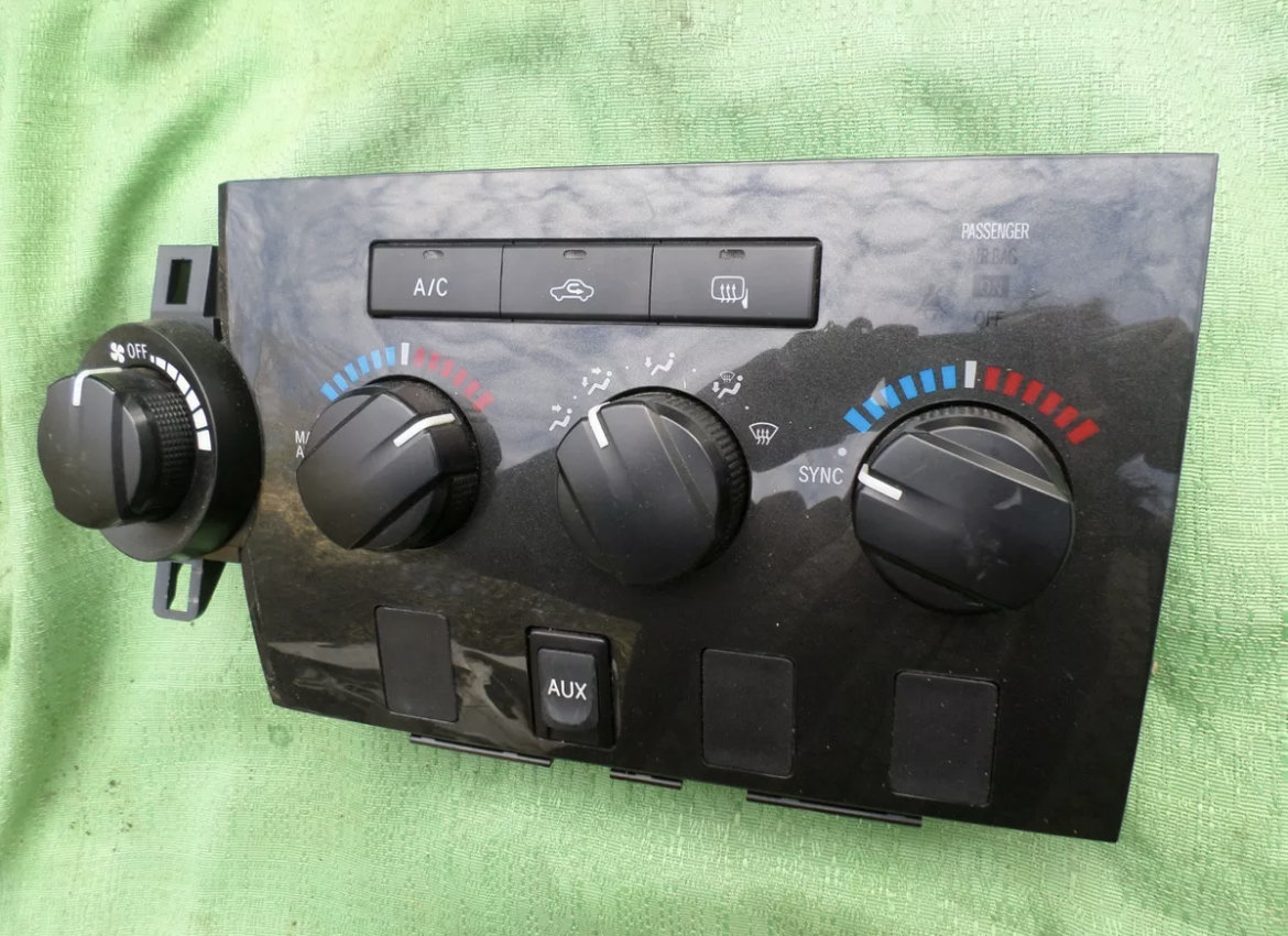

    Part 2 of this will be black AC controls and 4x4 switch. Relocate the Tow/haul to the right knee dash. I’m gonna go with the big compartment in that piece. Then paint the 2 grey dash pieces black to match. Black bottom half / grey above window line inside. This will hopefully please my OCD

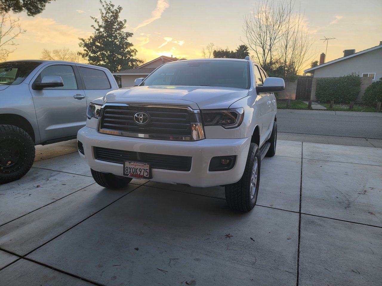

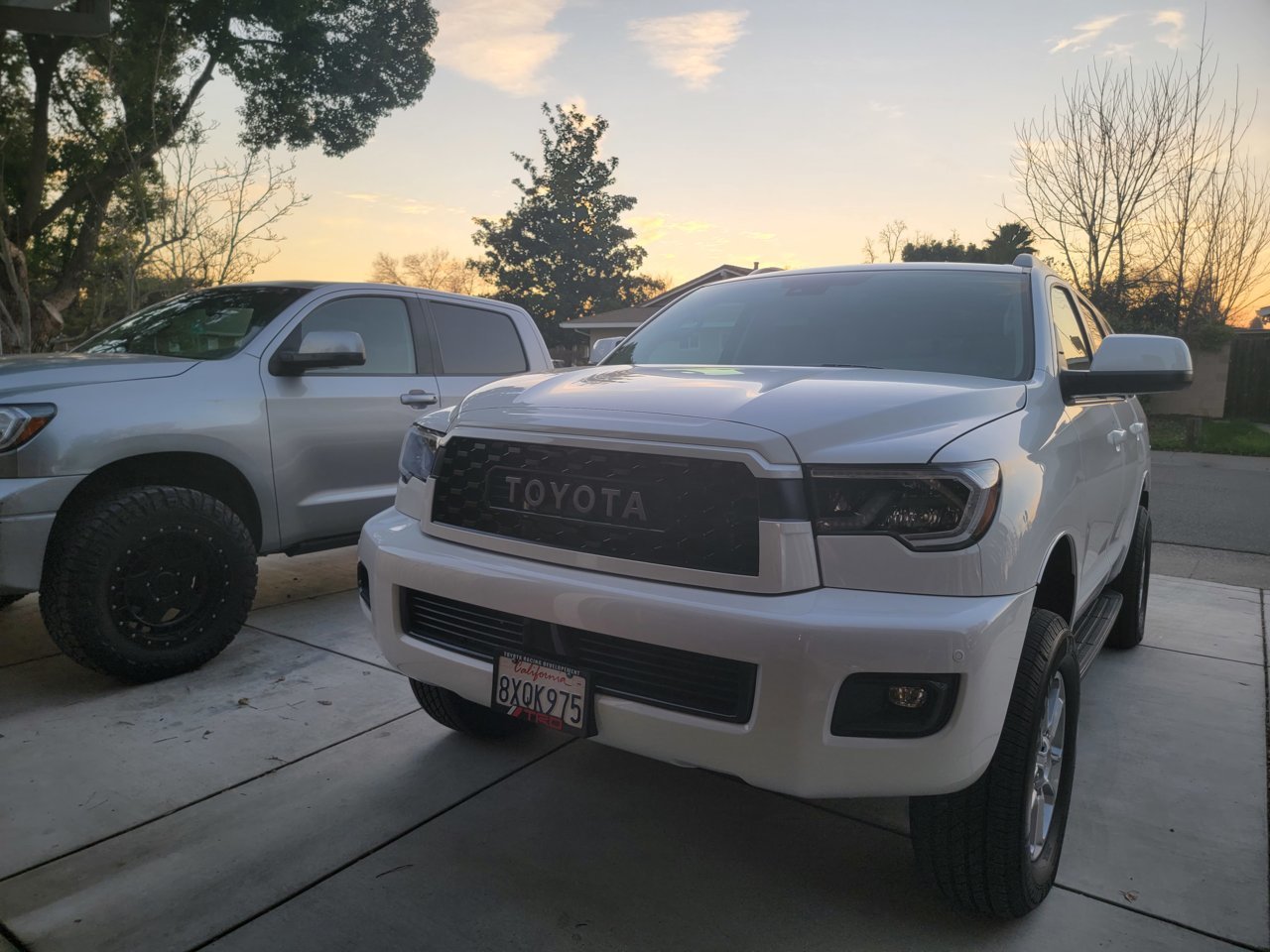

    New grill for the Sequoia

    looks great thx for posting.
    I gotta paint those next.

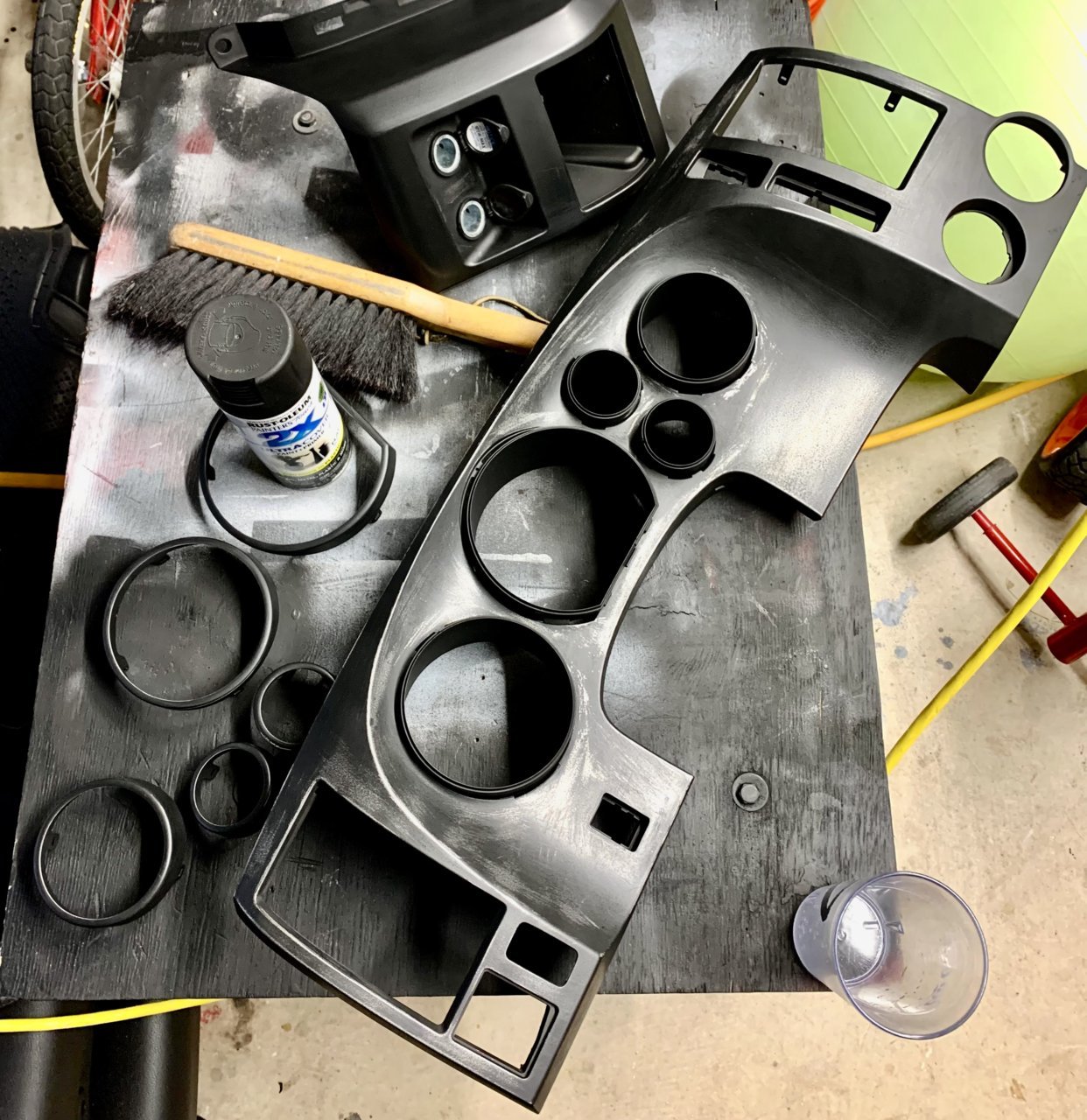

    i did the instrument cluster in the same paint I did other interior pieces (flat black textured) but I wanted some sort of distinction for the bezel rings so I painted those only in a semi-glass.
    i tried gloss but it was too much so I redid in semi and it’s enough to notice while installed but not over powering

    Makes me feel a bit less crazy when I see others going the same route and I thank you for that. Looks great by the way! I have a part number for that 4x4 switch in black if your interested 84724-0C020.

    Every time I get in I try not to make eye contact with my 4x4 and A/C buttons bc they are hideous.
    do they make the ac knobs in black?

    In fact they do! Part# 84010-0CD00
    They can be over $600 new but flEbay has a few affordable options.

    The black instead of silver ring around 4x4 knob is new to me! Thanks!
