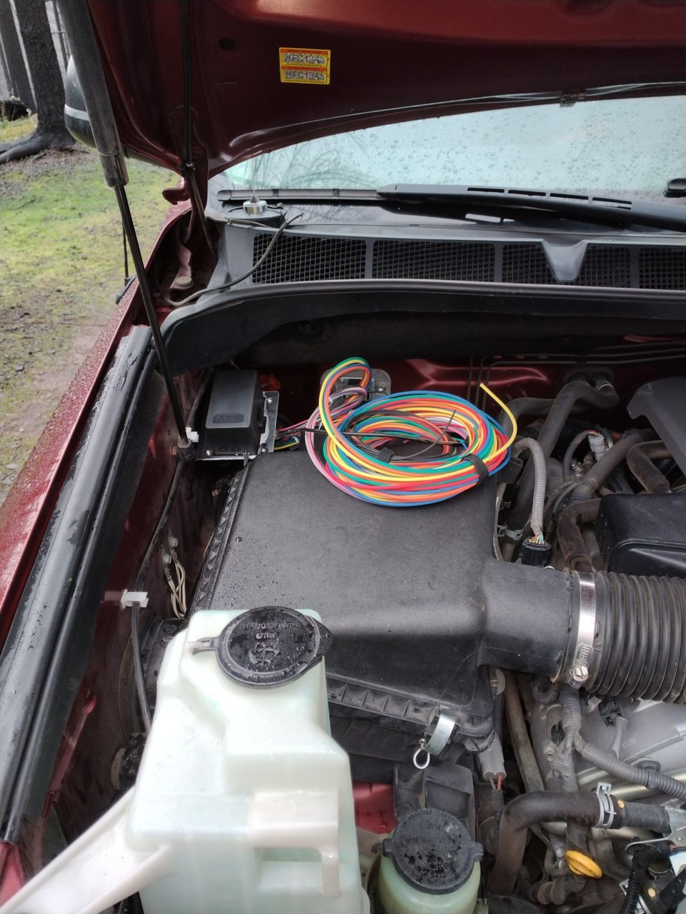

    Some.
    Started the install of my RTMR. Then it started raining again.

    What is an RTMR? Looks complicated.

    Some.
    Eaton/Bussmann Rear Terminal Mini Fuse and Relay panel (RTMR), auxillary panel. Wired with 5 constant power and 5 switched power with relays. A good way to get a clean aux power setup without multiple inline fuses coming off the battery.
    Very easy to install, the switched lines have color matched trigger wires and load wires. Constant power wires are a separate range of colors so nothing can get confused. Just looks confusing with 10ft leads rolled up, once installed it is clean.
    I ran #6 welding cable with an 80A breaker above the driver side headlight to provide power.

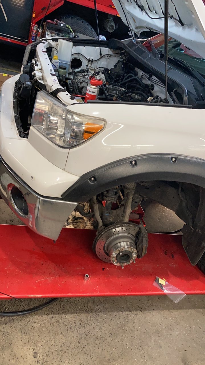

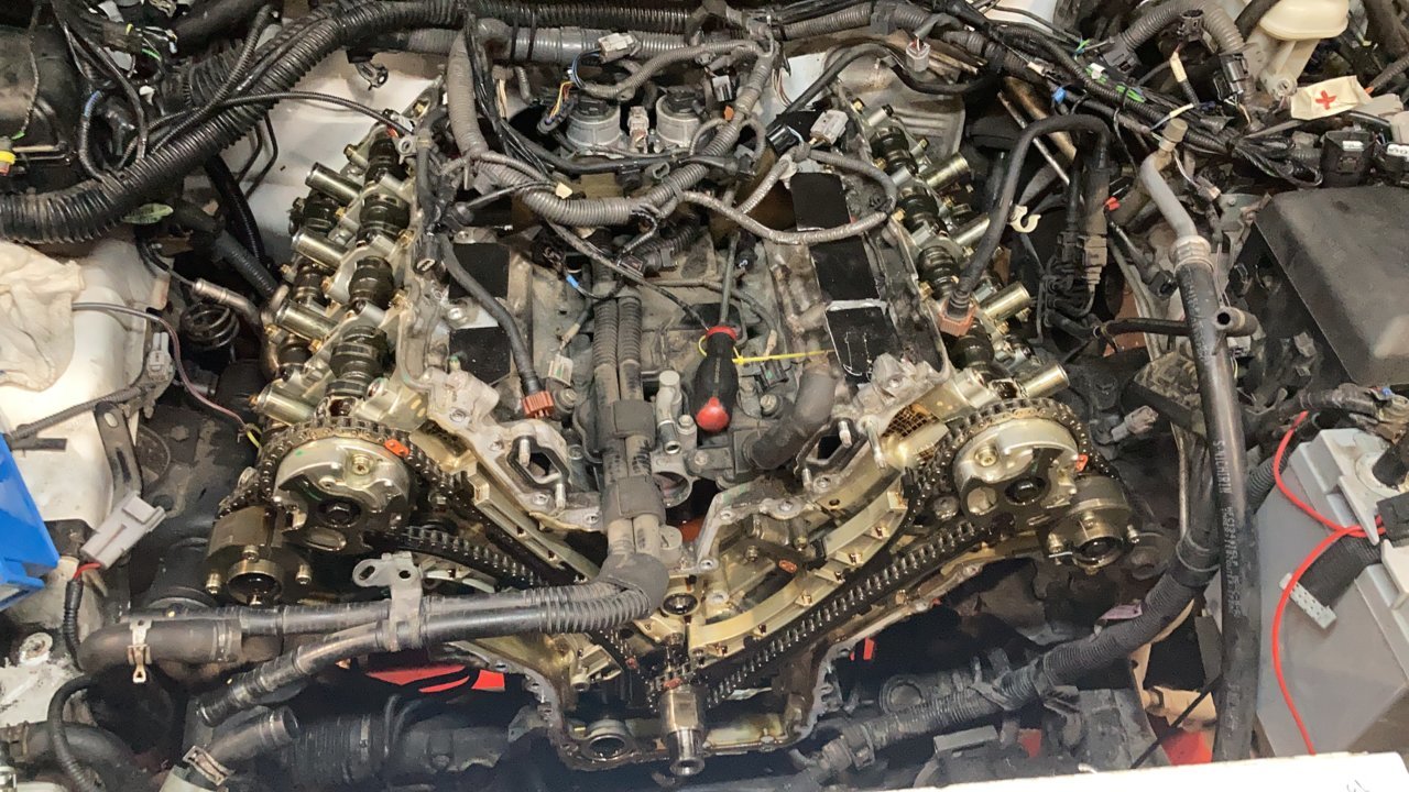

    Never stopping ...
    Took the heads of because of a misfire and not smooth running V8 ‍♂️

    Nice, look forward to seeing the finished product

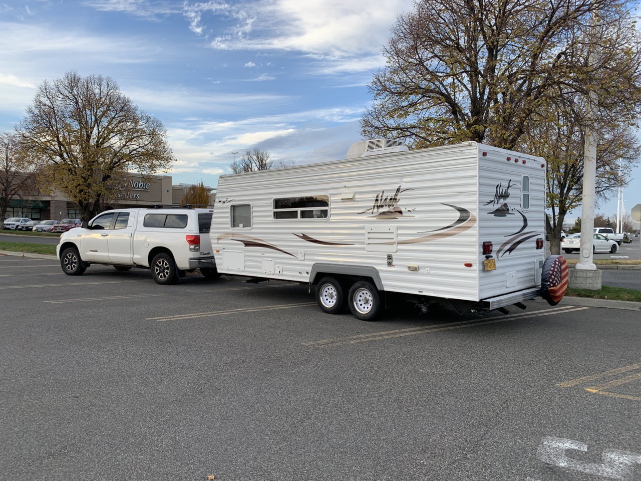

    Got a $54 parking ticket for not parking between the lines after I paid $8 to park in the lot. No parking space to the right of me and didn’t want a door ding. Good job city of Spokane. :censored:

    Isn't that the entrance/ exit beside you?

    Yeah but there is also a pole that marks the entrance/exit if you look at the back corner of my truck that I am within. Also that entrance/exit is wide enough to fit 4 trucks thru at the same time. Just confirms why I stay out of downtown.
