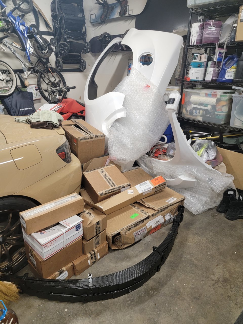

    Waiting on my TC shock hoops, RCV axles, front coilovers, secondaries and rear shocks. This wait is killing me.

    hahahahahaha . It will be all worth it :) I was with King last week tuning our suspension. One of their R&D guy told me that the shocks production is at full speed and that the springs is what causing their ridiculous lead time

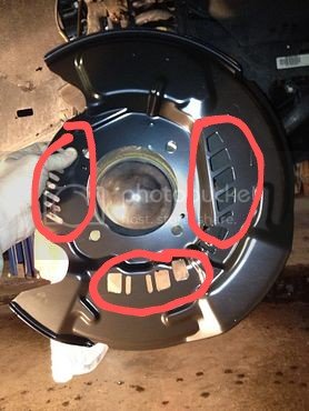

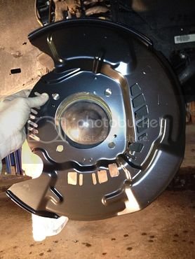

    Just putting this out there.
    The updated front brake backing plates look like this, the old versions do not have the three groups of venting holes.
    Confirmed that my '12 has the newer plates.

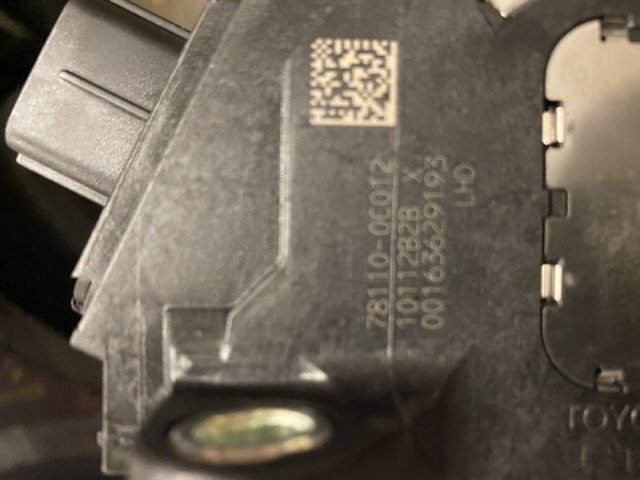

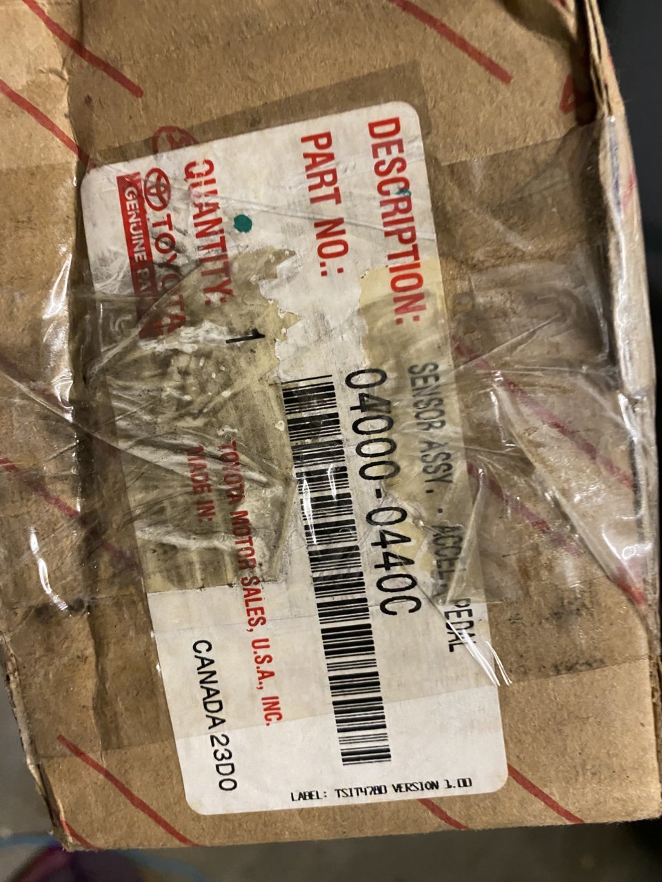

    UPDATE - I installed it. Two 10mm nuts and one wire harness (always the toughest part to determine which attachment methodology was used while standing on your head spinning nickels). Noticeable improvement in shifting in my opinion. It is obvious that this is not a simple mechanical part but has imbedded software.

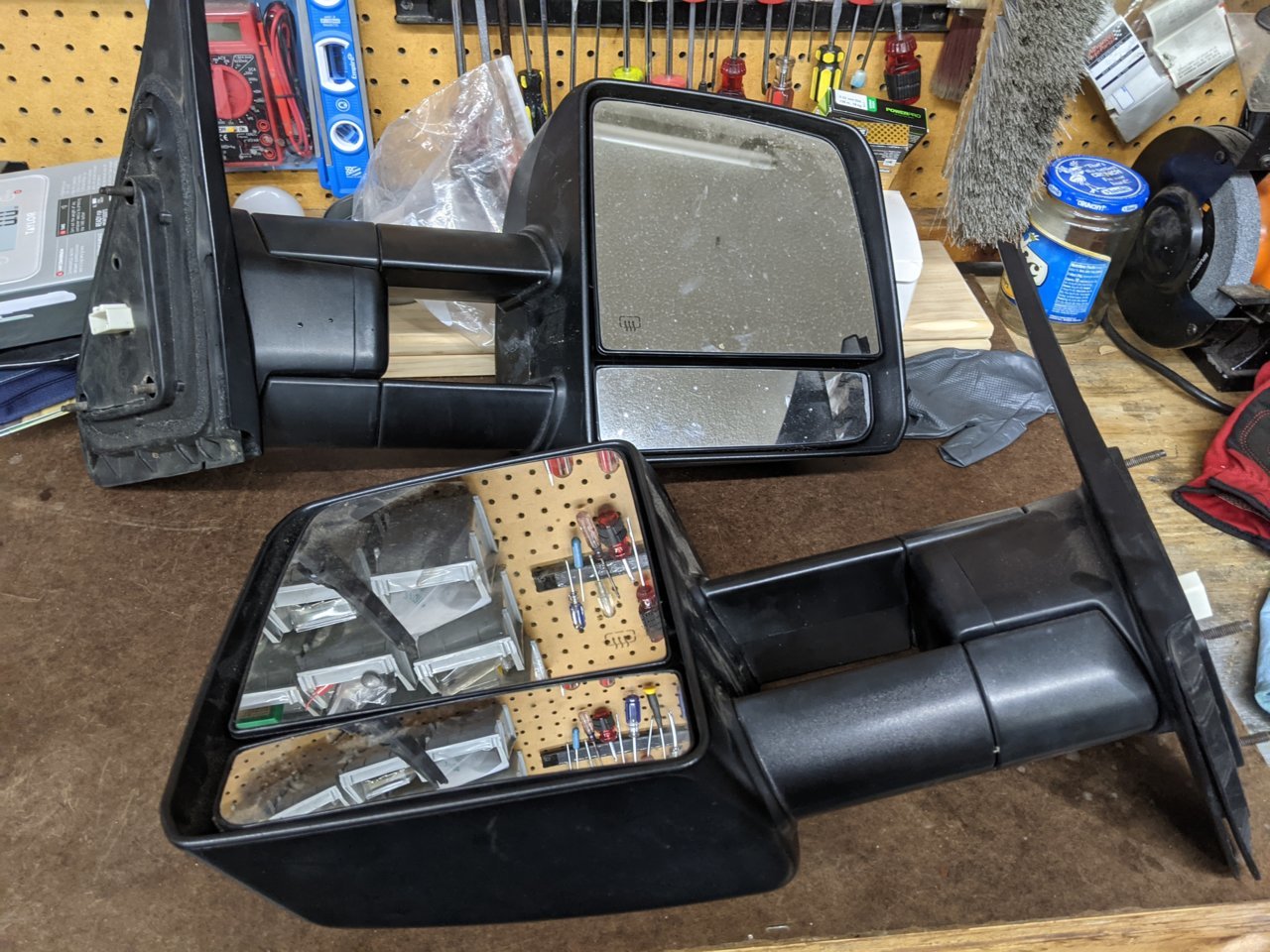

    Found some OEM tow mirrors for cheap.
    For those who ask, they add an extra 3" on each side (not extended).

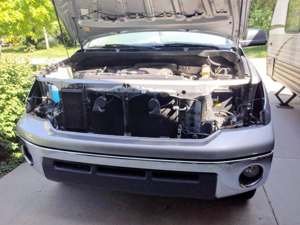

    OEM 18" wheels off a 2.5 gen 275/70/18 Falken Rubitrek A/T FabFour Redsteel front bumper with HF winch. Dobinsons IMS with 2.25" coils (610) JBA UCA's Iron Man +300lb rear leaf packs with Dobinsons IMS shocks ECGS bushing in front diff Black Oak Led Flood Pods. 40watt (x2) Black Oak 20" light bar. 100 watt OEM style rear bumper, black powder coat, added aux reverse leds. Stubby AM/FM antenna Century Camper Shell with Roof rack and bed mat
    Chased down three sources of rattles.
    First I adjusted the stoppers for the inside of the grill. Just a bit of pressure while closed now. Next I fixed the loose upper isolation mounts for the A/C condenser by adding two grommets to take out some of the slop. Last I replaced missing fasteners for the plastic wheel well liners. Much quieter now. Then I washed her and got started on swapping the rear leafs.

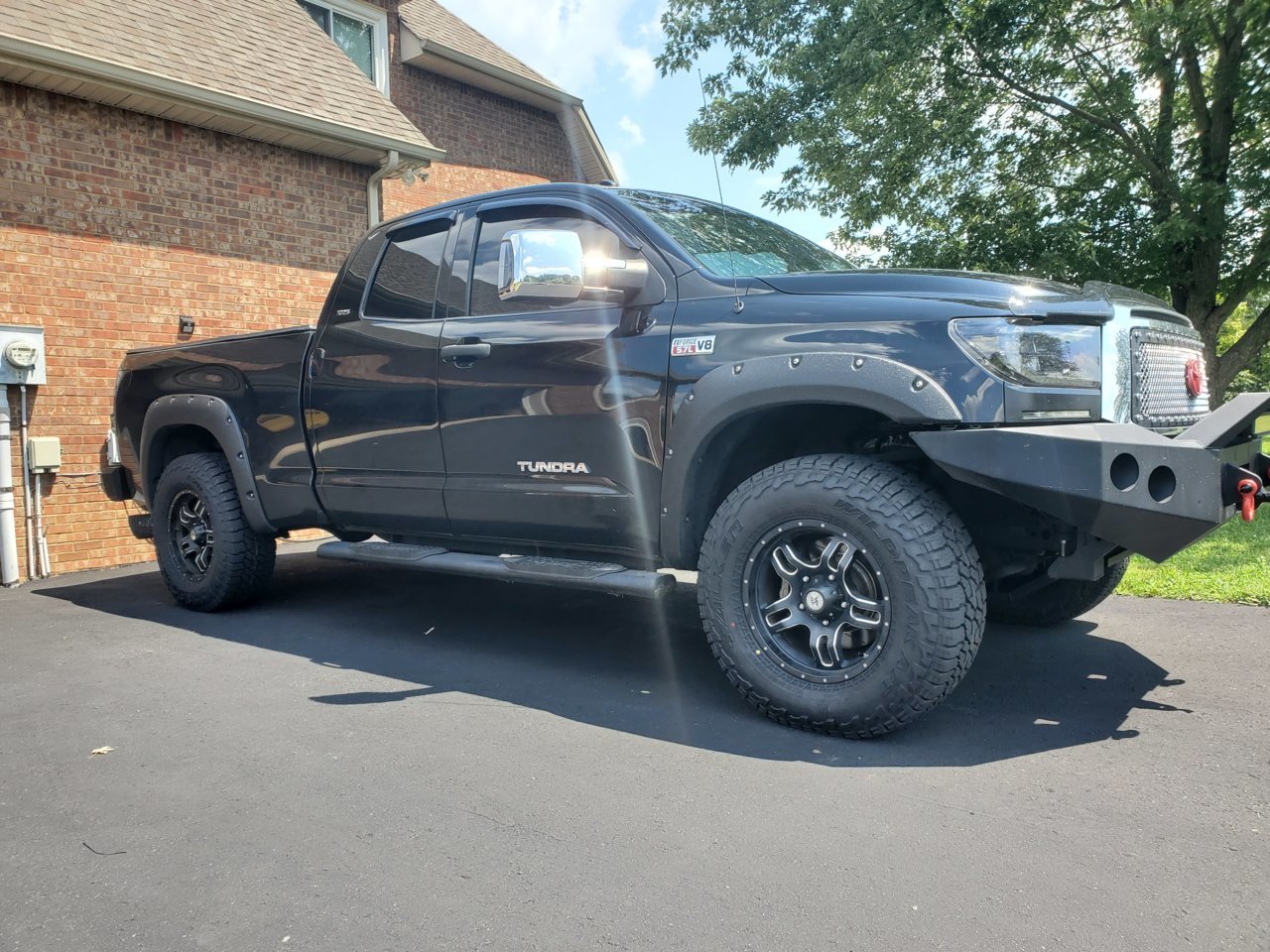

    Magnum front, Iron Cross rear bumpers, SB Cold air intake and Gibson Metal Mulisha exhaust, Fender flares, Tow mirrors, 18" Outlaw wheels, 12k Smitty X2O winch, Tech 12v auto start, Firestone Air Bags, Pedal Commander, Devil Horns, etc...

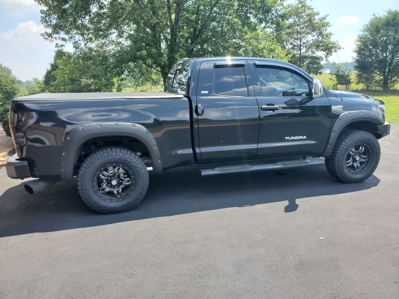

    Tundra got new shoes this morning. Falken wildpeak at3, 295 70 18. Couldn't stand the bfg ko2s any longer, the falkens are so smooth and quiet.

    No better feeling than new tires. Look sharp!

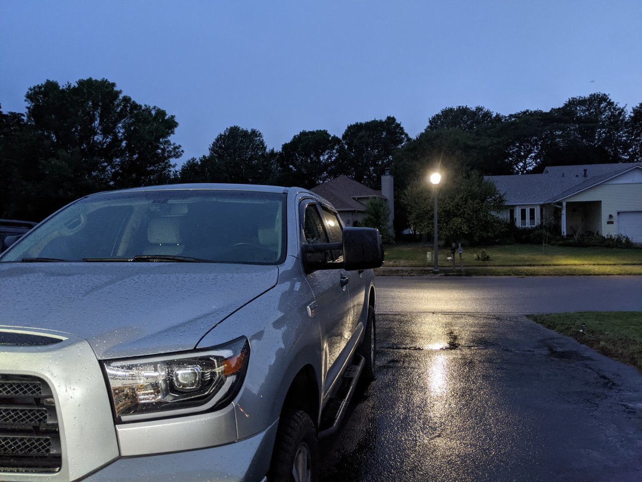

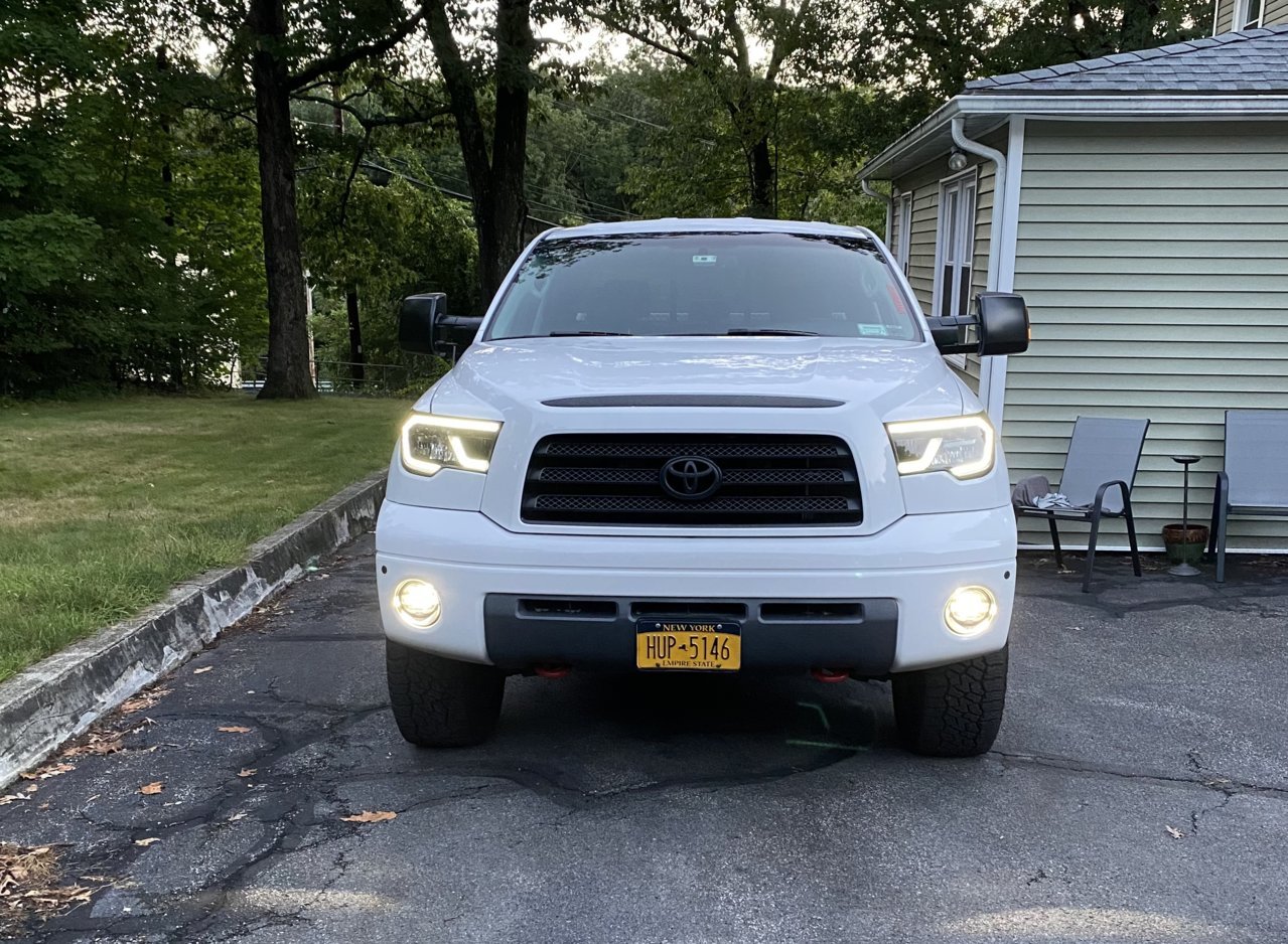

    Fogs anytime mod. Not sure why I didn’t do it sooner. I butchered the clips on the connectors to remove them though. Have to get them replaced (I think)

    I did the same thing with the understanding that they only add an each per side. They are much bigger. o_O
    Luckily I also found a good local deal.

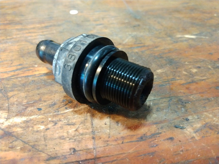

    Changed the PCV valve. New one "rattles" this one not so much. All gummed up. It would be nice if this upped my MPG, but I won't hold my breath. :rolleyes:
