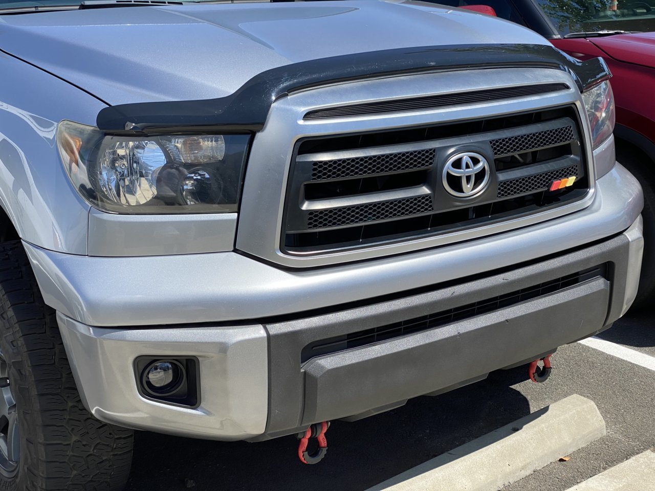

    Method Con6 Wheels, LED Swap, LED taillights, BAM 8” exhaust, Eibach Spro sport leveling front shocks, AJT Shift knob and AC controls, Cover king seat covers, husky floor liners, color matched mirror caps and door handles, retrax bed cover, shorty antenna, D ring tow Shackles, rear TRD sway bar, JVC KW-Z1000w head unit, Morimoto Fogs, Alpharex Headlights
    2nd Gen to 3rd Gen bumper conversion

    looks good. I would assume it is all mostly bolt on or? kind of new to the bumper swap vs the grille swap.

    I hope you don't take this the wrong way but the way that zero of the lines match up with this would eat away at my soul surely causing me to experience a burst aneurysm while driving and crash into a ditch.

    Mostly. In addition to the bumper and fogs, you’ll need the 3rd gen’s impact bar (just the end pieces of the bar that bolt to the actual bumper), the 3rd gen’s splash shield that goes behind the fogs, and an h7 to h10 fog light adapter. Got that on Amazon for $7. I also used washers to space the bumper out 0.5 inches, but that’s optional

    I don’t blame you lol. Not gonna lie I thought it would line up a little better; I even did the 1/2 in spacing on the impact bar. From certain angles it looks good though imo; I’m gonna roll with it for now since I already put the time and money into it. I’ll see about getting a real metal bumper down the road.3F2A06B4-0EF5-409C-AB8A-7731E2DFCE0B.jpg6F0BC418-4A2E-4375-A4F1-0E7B122FE22F.jpg

    It's not that bad imo. As far as lines, only if you really looking for it.
    I like it.
