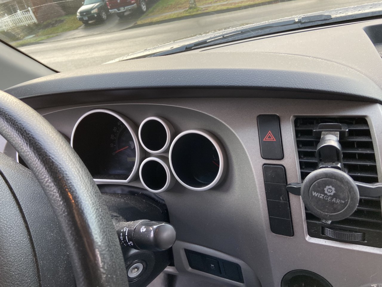

    All cosmetic so far see my posts in 2nd gen Black out chrome in progress….
    Finally got new head unit in and blacked the cluster panel etc.

    Man I’ve been dying to knock this out. You did a great job! What did you use to black out the dash? Did you do the window switch bezels also?
    I also adapted the lame coin holder and fitted my phone mount to it

    Thought of doing something similar with the coin holder. Did you simply cut the separators out and stick the mount in there? I use the same mount and this install looks cleaner.
    I pulled the coin holder out and apart. Drilled a hole through it and into the ball piece of mount. Used a one inch screw to attach. Didn’t mess with the separators. Mounted above them. Had to cut a v-notch in front piece for the nut that goes on the ball is all. I can take an angled pic of that if interested
    Rustoleum texturized matte black. Several thin coats or it will run. Only downfall is it’s rough so only clean with something that has no lint. I actually pulled the trim rings from the dash piece and will be painting them a metallic red to match the shifter and climate knob screws.
    I haven’t done the window switch bezels yet but they are on the to do list as well.
