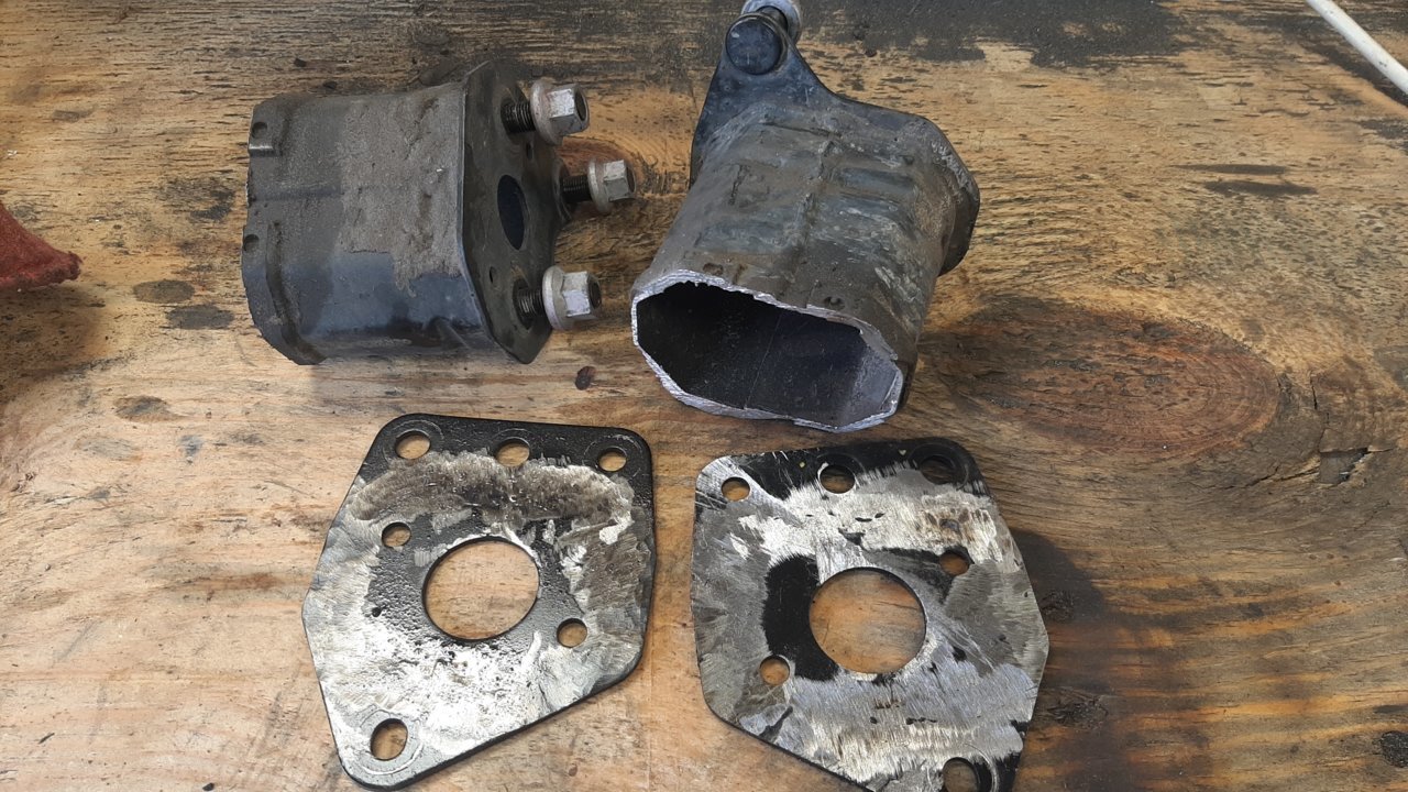

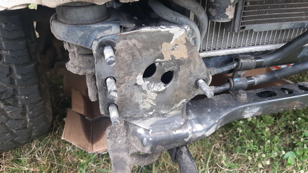

    I cut the bumper mounting plates off the old bumper extensions and welded them over the top of the factory frame horns for a little more meat. The stock frame horns are only like 1/8"

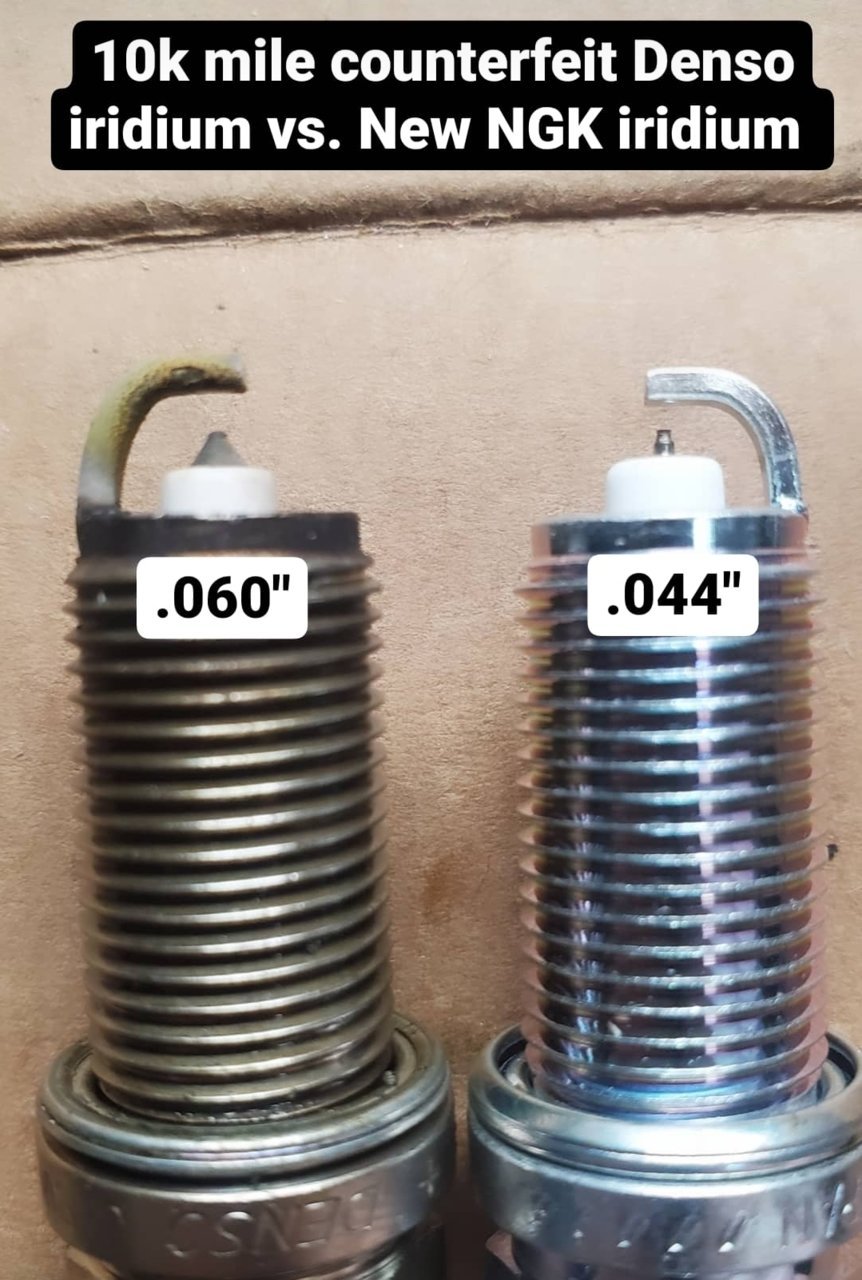

    Pretty sure I got counterfeit "OEM Denso" spark plugs on ebay a couple years ago before I knew better. They cost half of what the online dealers charge and the seller is no longer a registered ebay user. All 8 were gapped to .044" when installed, all around .060" now just 10k miles and no ground pad visible on the strap. I pulled them since I got suspicious with a single cylinder misfire fault code and loss of fuel economy.
    Buy genuine or from a reputable source!

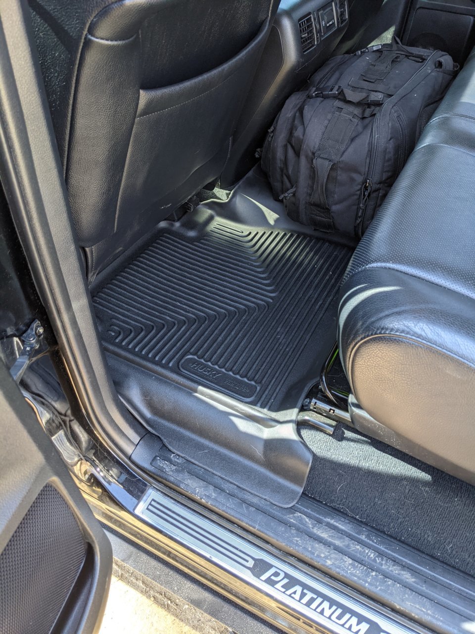

    Got new rear Husky X-act floor mat installed. I love how well they fill in the whole flooring area.

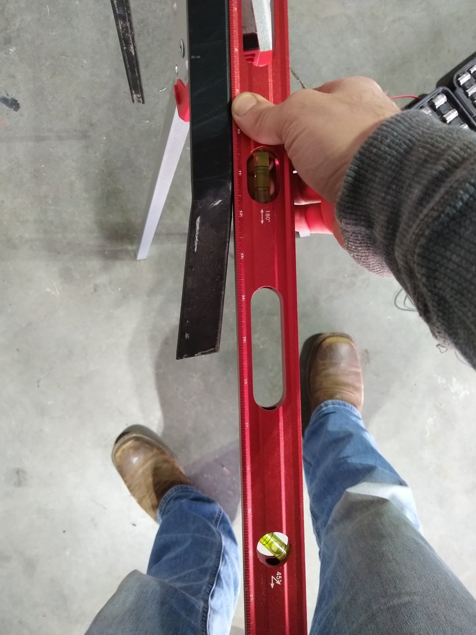

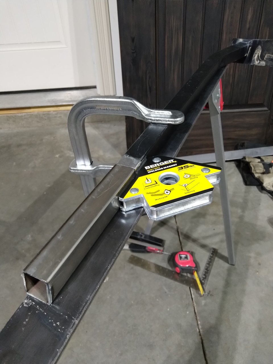

    I bent my over shell rack a couple years ago. Today I decided to cut out the bent portion and weld in a new section.

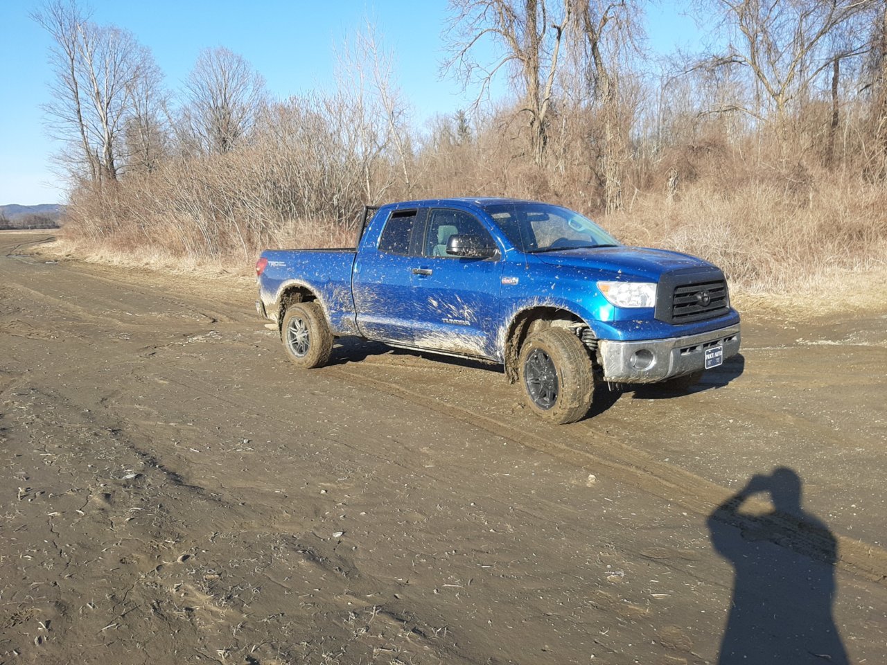

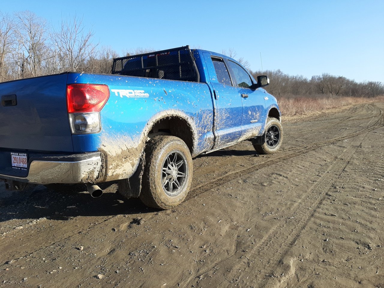

    Well guys I'm back. 08 double cab. Gotta change out these highway tires for some a/t with more bite, put on the bumper that I had ordered for my last truck, and do some chrome delete. 127k on the odo

    I've never seen the blue/brown two tone paint before. :p
    Seriously though, that blue color is awesome.

    I originally went to get another magnetic grey rock warrior but it wasn't what I was expecting so I got this

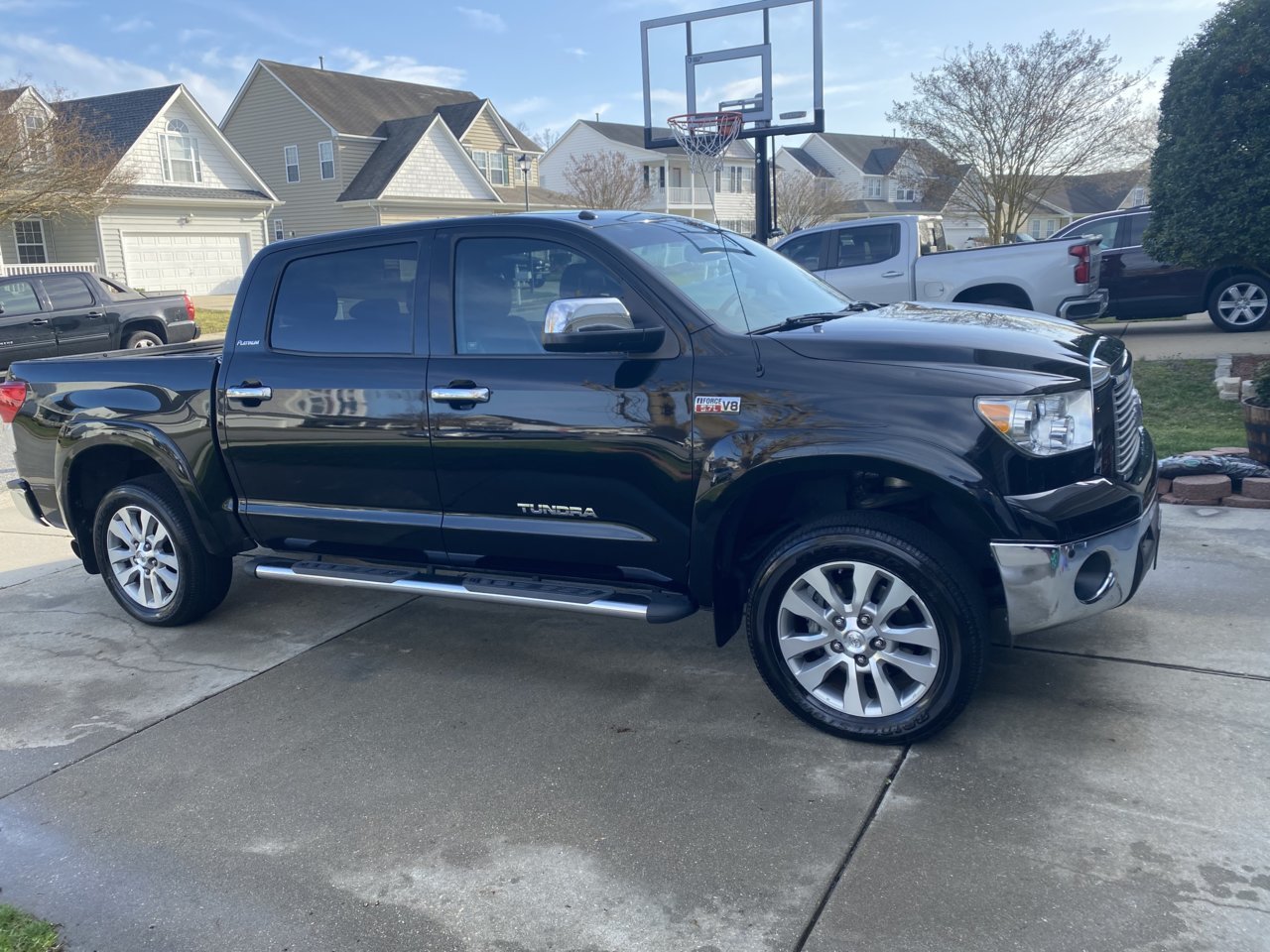

    Gave her a much needed bath, but she really needs to be Clay Barred and waxed.

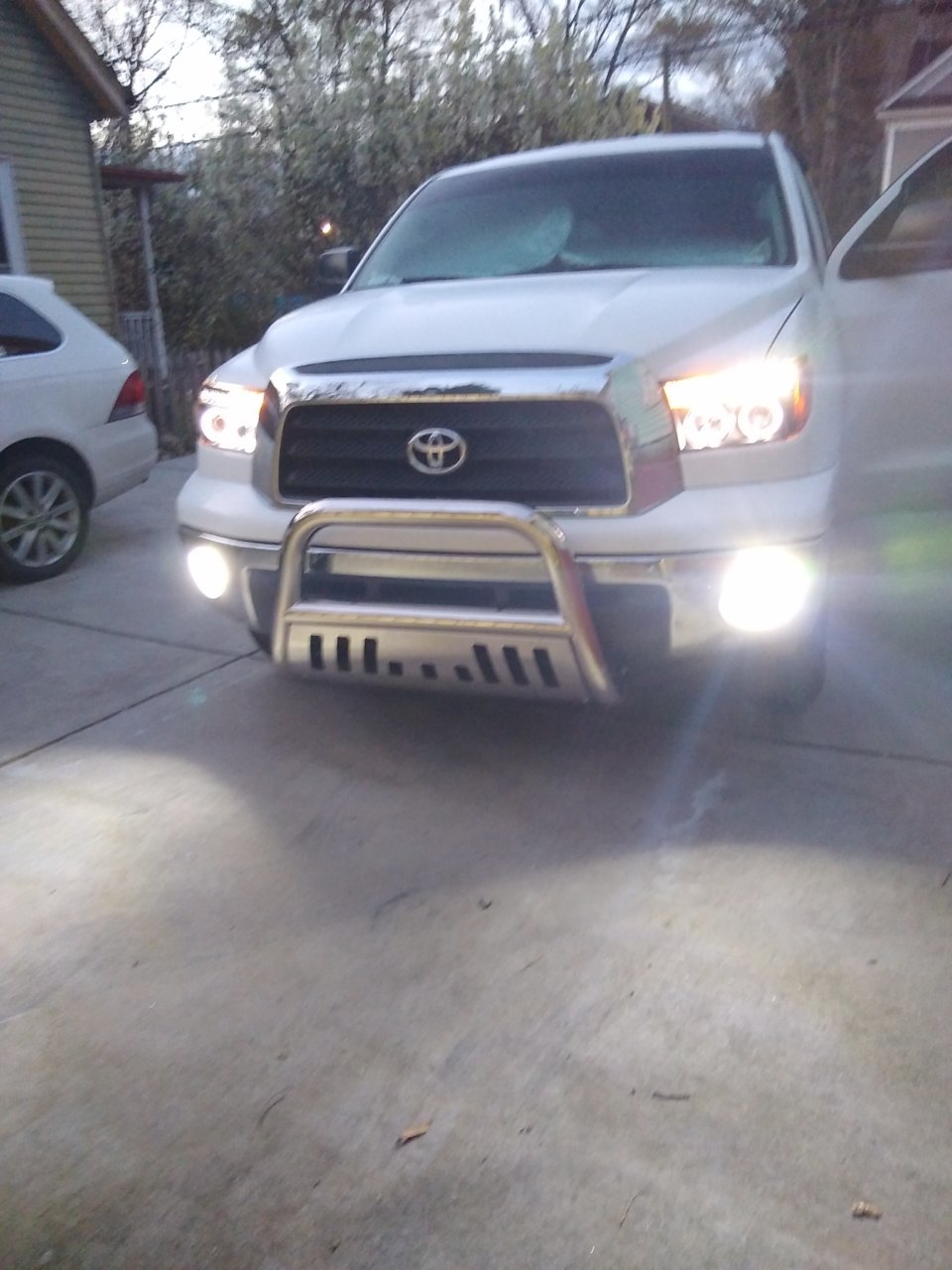

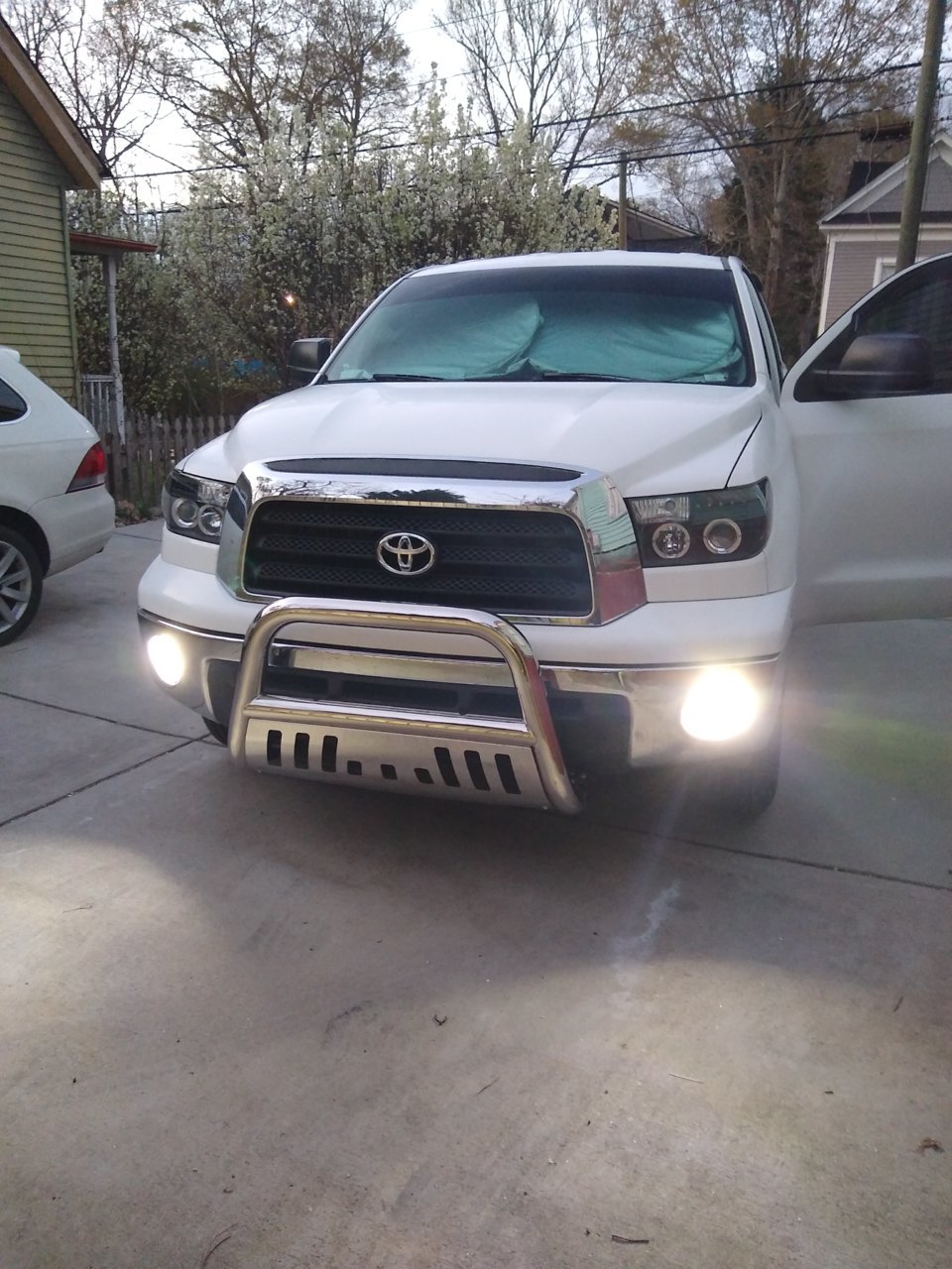

    New fog lights and led bulbs.

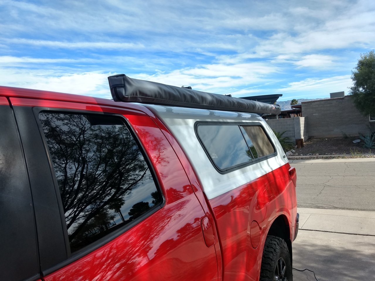

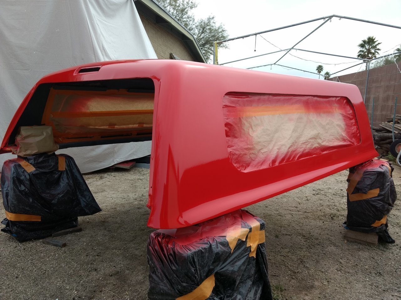

    I went thru this exercise a couple of years ago when I got my cap.
    After getting several quotes ranging from $550 to roughly $700, and being the tight a$$ that I am, and figuring I love projects, I decided why not give it a go myself.
    This is what I started with. My daughter said it looks like an ambulance.
    Set it on some blocks in the side-yard and proceeded to pull all the windows out and started sanding.
    I bought the cheap $15 Harbor Freight purple spray gun and I found the paint/primer on the interwebs at, of all places, Walmart online! Also, I had/have pretty much ZERO automotive painting experience. Taking my time to prep and paint, and trying not to be too OCD, I think were the keys to getting something half way decent.
    $150 and a few hours of labor later and this is it. Saved some $$$$ and it was quite the fun project. I'd encourage anyone to give it a try.
    superdenk, jtwags, The Dude and 27 others like this.

    ^dang that came out pretty nice^
