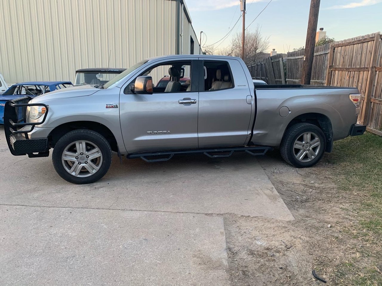

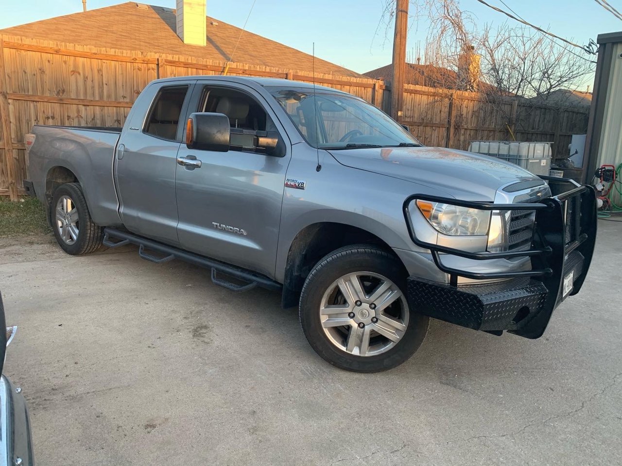

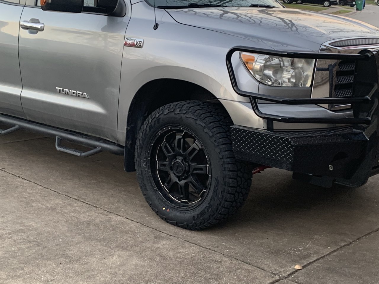

    1) Bought with 225k miles on it, a Westin bullnose bumper, and OEM tundra steps 2) Current Mileage 238k Mods: 1) Dirty Deeds BA Mufflers 8 inch with resonator (as of Feb 2021) - Had the 10 inch with resonator - Prefer the 10 inch without resonator - deeper sound hear it more in the cab 2.) Ranch Hand Summit Front Bumper/Guard 3) Ranch Hand Summit Bumper 4) Billstein 5100s all around 5) TRD front and rear sway bars 6.) Rough Country wheel to wheel steps 7) Pioneer 8400 NEX Wireless ApplePlay 8) Backup Camera: e-raptor 9) LED white lights replaced in headlights, fog lights, inside cabin, and exterior lights 10) Linex (unbranded by Central Texas Truck Coatings) 11) OEM Toyota side panels and generic panel on tailgate Maintenance/Repairs: 1) Valve covers, belt tensioner, alternator belt - $415 2) Evaporation fuel canister and filter replacment $1547 *This was a Toyota TSB for 07-08 AFAIK. Toyota covered in first 3 years of ownership. Mine failed after 13 years of daily regular driving use. Not bad at all. 3) Pioneer Unit - had to ship to Pioneer to replace Output IC - $45 (shipping) free under 1 year warranty fix 4) Pioneer Unit - Electrical feed back coming through speakers when accelerating. Fix was to check all wiring/tighten up/ make connections good again $42. 5.) Rear passenger door actuator replaced. Part was $287 with tax on ebay from Toyota dealer free shipping. 6.) Rack and Pinion, tow mirrors, shocks install, lifetime alignment - $1884.36

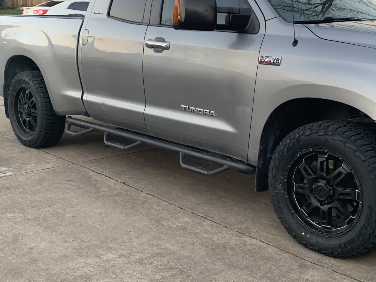

    Got the Falken ATW3 275/60/20s today. Gotta tip the ol hat tondiscount tire ordering them at 12:30 and getting them by 3:30 the same day. Love the look. Definitely feel the extra weight of the AT bigger tires when accelerating. Looking forward to taking them off the road.

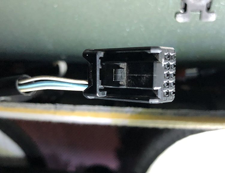

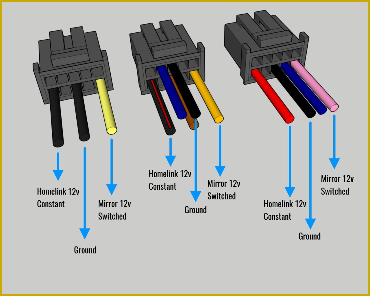

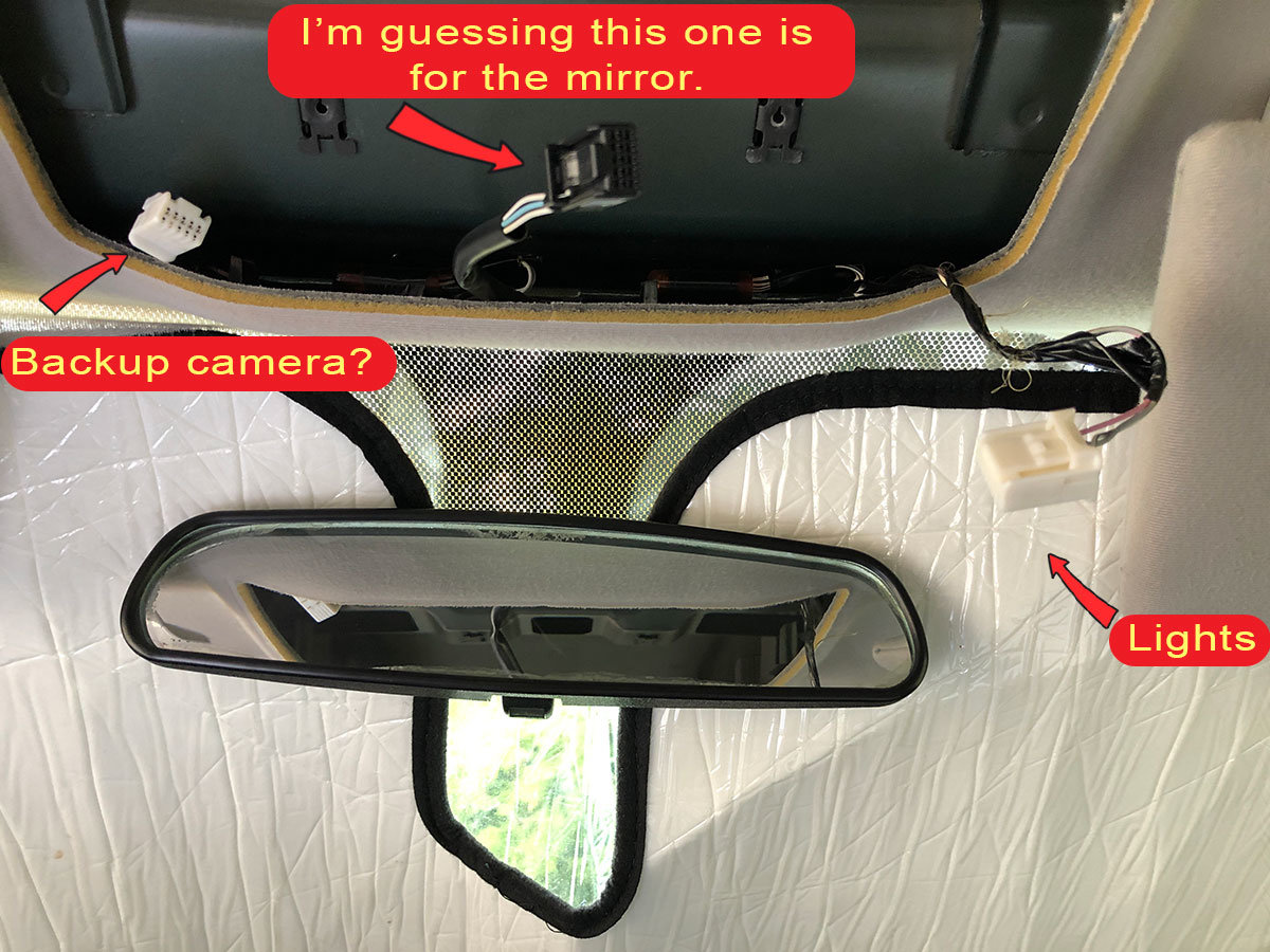

    Did you buy it with the Gentex pigtail? How many wires are there. Just start playing around with the wires to a 12v source to figure out what is what. I used a ryboi power tool battery.

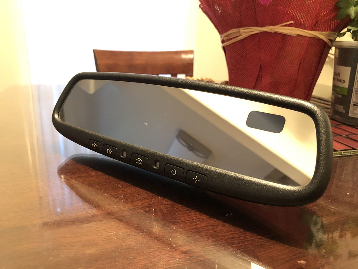

    Yes, it came with the pigtail. The place I bought it from also included a useful guide on making sense out of the wires. It's not perfect, but it helps. Check out www.spacetechstl.com/mirrors. For the Gentex 453 and looking at the back of the plug, they say the center wire is usually the black ground, the left most wire is the constant 12v for the homelink, and the right most wire is the 12v switched for the mirror. Hope that helps.

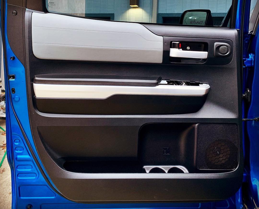

    Yeah, one of my favorite interior upgrades. I didn’t care much for the little storage bin on the 2nd gen panels, and I feel like these look more updated.

    ...And suddenly I've realized that it would probably be pretty tough to find SR5/Limited/Platinum Regular Cab interior door panels as I would suspect that most 3rd generation RCs were/are of the work truck trim level.

    Where did you get the mirror and is there factory plug in the headliner?

    Got the mirror off Ebay. Tried to test it with a 12v power brick, but didn't have much success. Didn't have my voltmeter, but need to troubleshoot a bit more today. I hope the mirror isn't defective. But yes, the plug does seem to be tucked under the front of the headliner beneath the center console. There are actually three plugs tucked there, but one is most likely for the backup camera, the other is for the lights in the console and I'm hoping the third center one is for the mirror. Here is a shot of my plugs under the console.
    The last pic is the wiring diagram that came with my mirror. It shows the usual wire out from the mirror. You will note that this does not correspond to the black plug on the Tundra. The instructions say to splice the wires from the mirror to the proper wires on the vehicle. A bit of a pain, but not too bad.

    Took my voltmeter out and measured the voltages out of the black center plug. The white is ground, the other two are constant 12v and switched 12v respectively, so pretty sure they are the power connections for the mirror. I was also able to confirm that the mirror works fine and the trouble I was having stemmed from the under powered test brick I was using. Hooked up to the center plug the mirror worked flawlessly.
    Although the directions suggest to hook up the Homelink garage door circuit to constant 12v, I'm going to combine the Homelink power and the mirror power, so both will be attached to switched power. That way if someone breaks into your truck, they cant just open your garage door.

    Yeah, took me quite a while to find these and probably have around $800-$1k total in them.

    Whoa....but then you need 4, I only have the two doors.

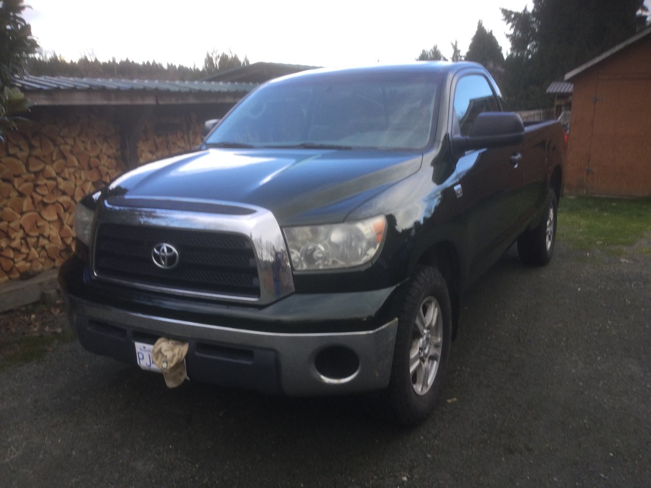

    One month later......see my thread. 36249869-B2F0-4AFB-9204-384C05CEB5E6.jpg

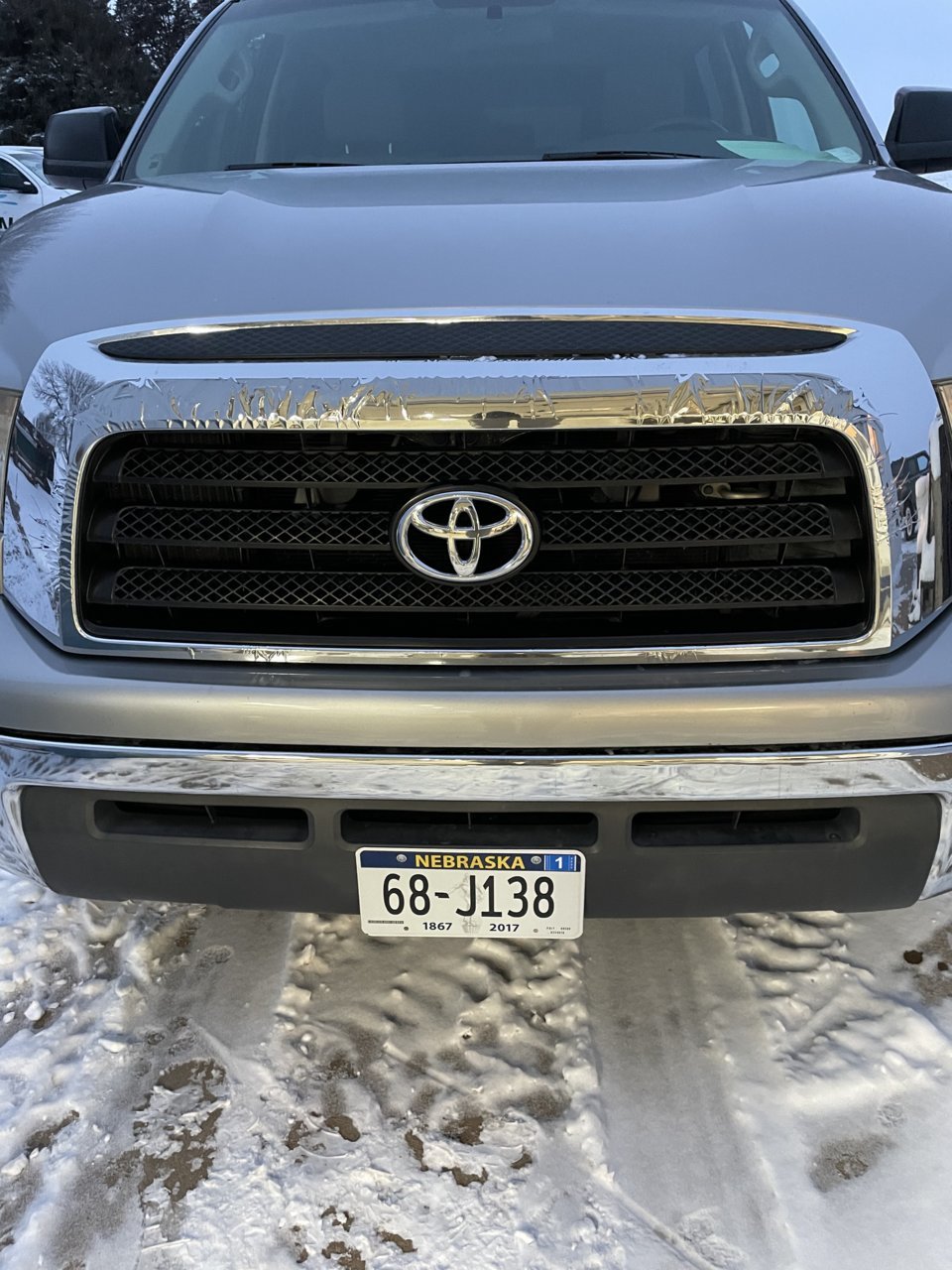

    I used an eraser wheel (auto body glue remover) on my semi peeling chrome grill. The heat caused by the friction of the wheel caused the rest of the Chrome to separate from the plastic. Then a quick spray job would do the trick. FYI.

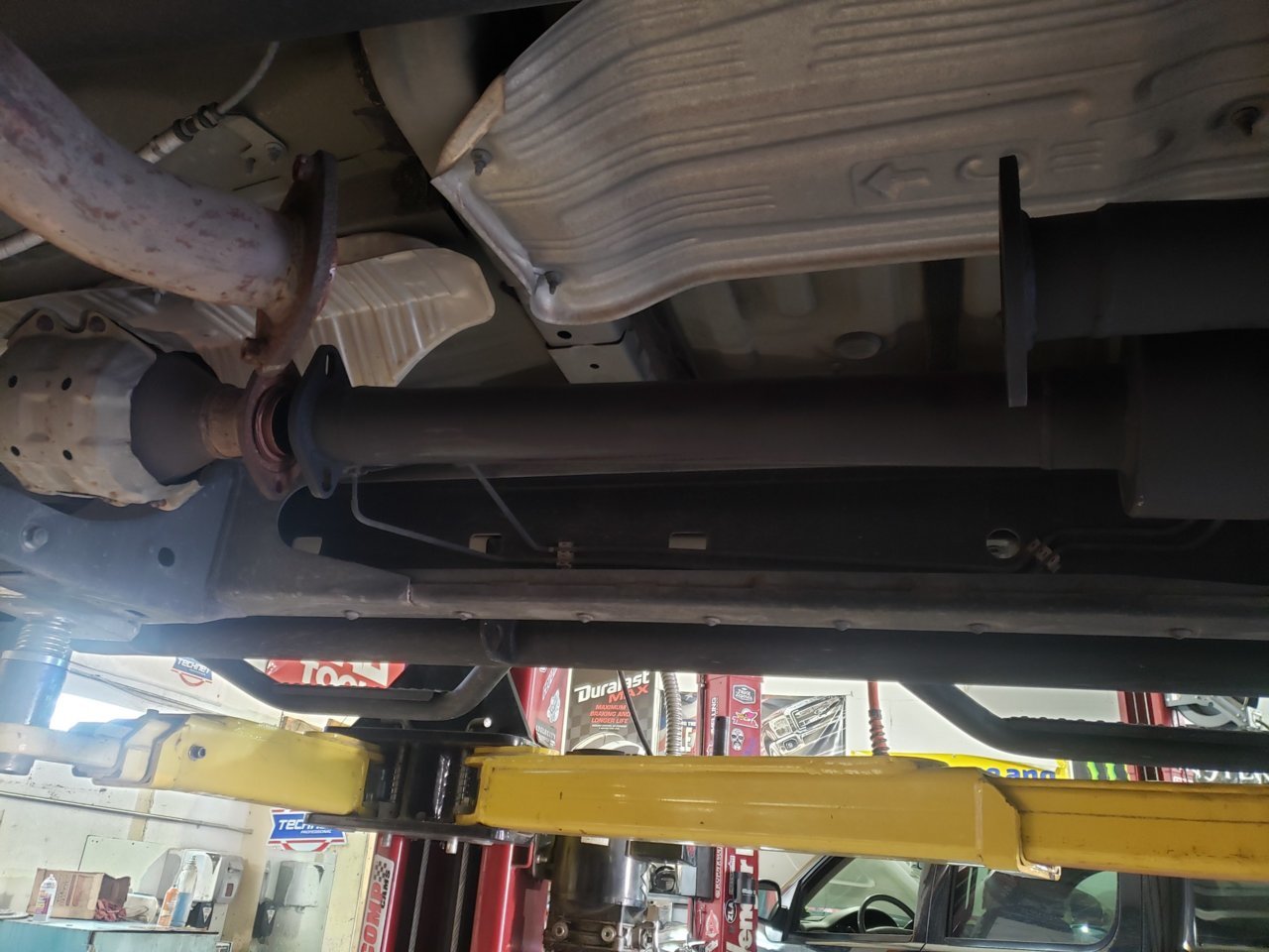

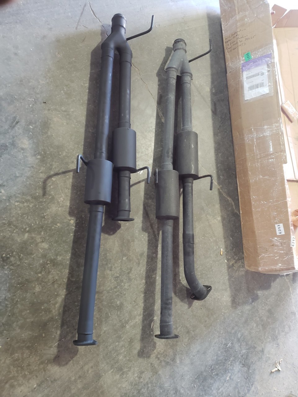

    **2/9/21 Update **
    I got the 10 inch system removed tonight. We installed the resonator with the 8 inch 2010+ model and adapter to make it work on my 08 Tundra. The adapter came without any bolts or a gasket. My mechanic was a little concerned because after bolting it up it wasn't a clean fit with some gaps on the top and sides. He wanted to make sure exhaust wasn't leaking outside of the gaps. He had sprayed it down with some sealant, and we didn't hear anything leaking. Not sure if it will eventually leak or not in time.
    After testing out the 10" without resonator for a few days, I realized even though it sounded deeper and throatier, the drone at around a consistent 45 and 60 mph became too loud when I was listening to music or podcasts. When I wrote my last update, I wasn't listening to anything on the stereo. Because of the drone, we left the resonator on the 8 inch system. The 8 is a little louder in terms of bass tone, but not terribly much more. I can hear the bass tones more easily on lower speeds accelerating compared to the 10. That is a plus.
    I'm not going to ship the 8 inch back to get the 6 and pay shipping to/from again. I went from spending $821 to $1176 after factoring in to/from shipping for the 8 inch system including the labor at my mechanics. Just didn't make sense to pay another $180 for a total of $1426, wait another month for the fabrication process, and possibly not be happy with the sound of the 6 with resonator in cabin in case it's too tinny and not bass filled enough.
    For my own knowledge I plan on talking to a local exhaust shop to learn more about other brands with deeper tones and no drone to a low amount of reasonable drone. For now I'm gonna roll with the 8 and resonator!

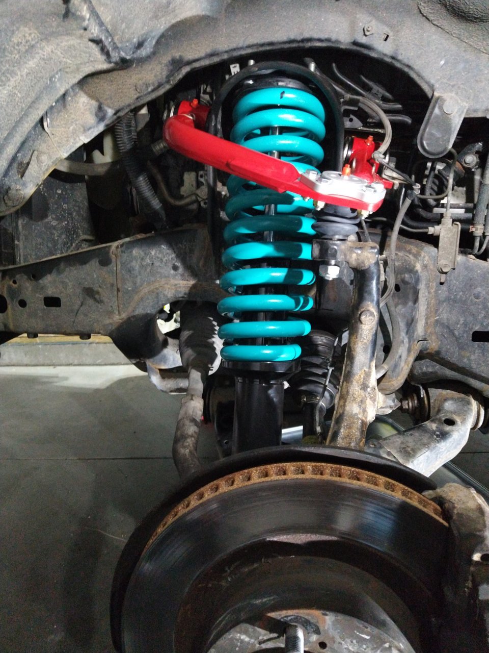

    Installed JBA uca and Dobinsons IMS on the Driver's side.

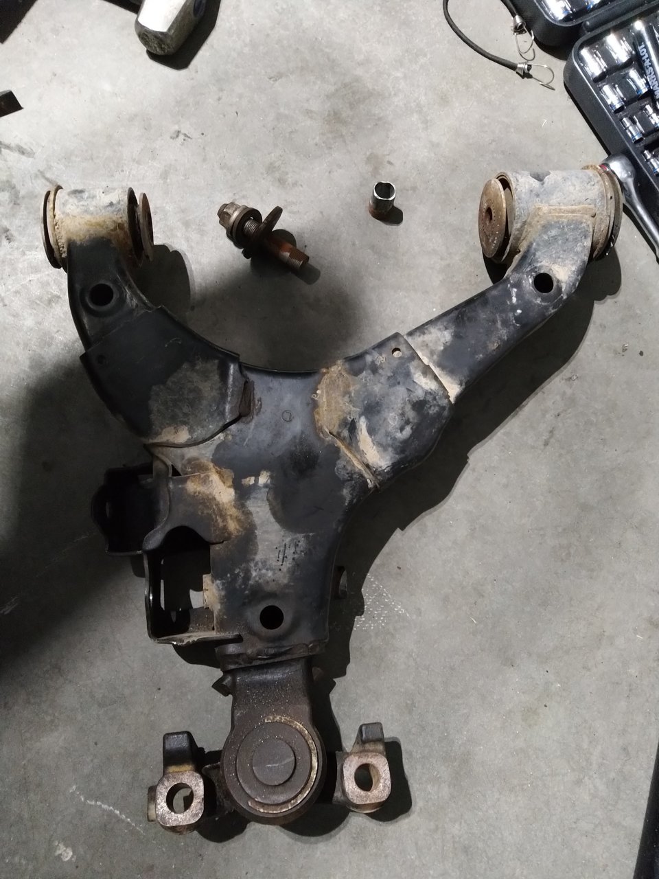

    Decided to replace LCAs too. Good thing because the adjustment cams were locked up and corroded pretty bad. So I cut the bolts/sleeves. Slow going even with carbide blades.
    Doing the other side tomorrow.

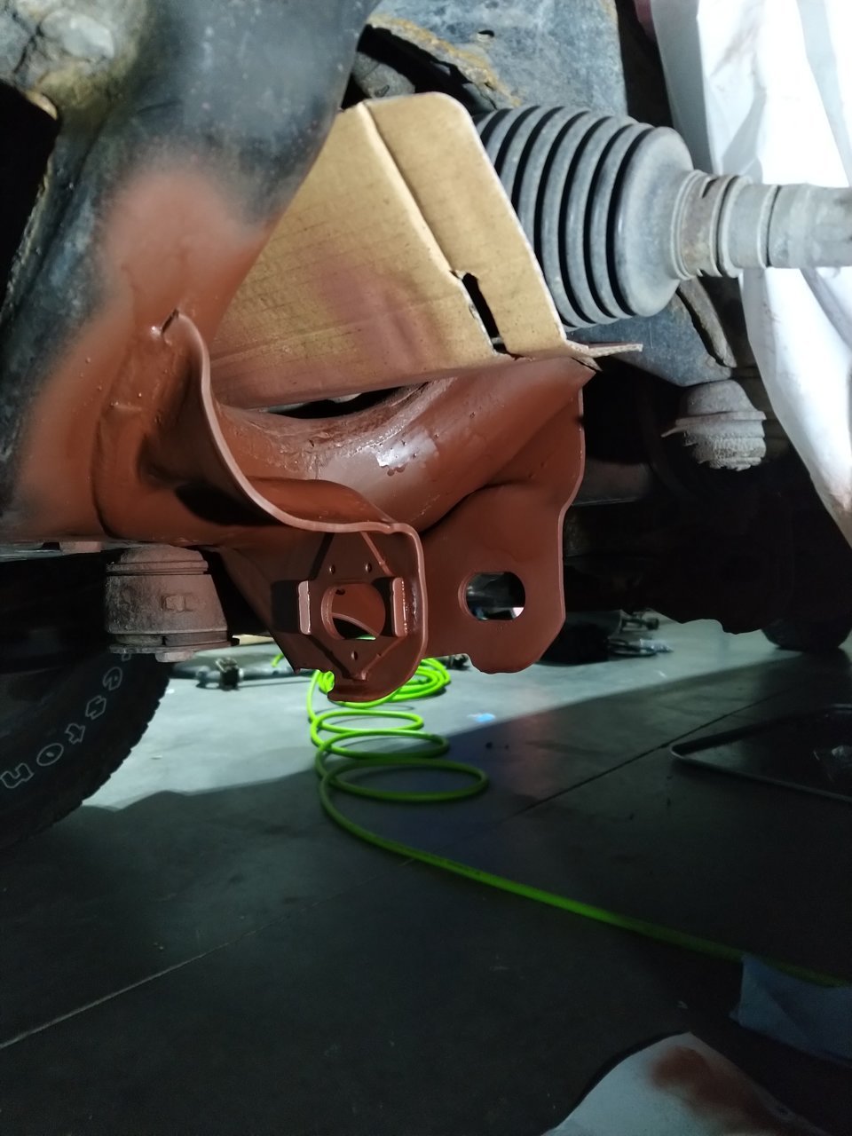

    Getting the truck ready for her new LCAs. Took the surface rust off with a wire wheel. Prime, then paint. Just trying to do what I can to prevent the new adjustment cams from looking like the old ones for as long as possible.
