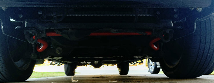

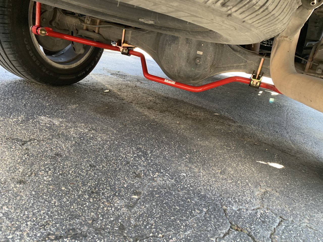

    1) Bought with 225k miles on it, a Westin bullnose bumper, and OEM tundra steps 2) Current Mileage 238k Mods: 1) Dirty Deeds BA Mufflers 8 inch with resonator (as of Feb 2021) - Had the 10 inch with resonator - Prefer the 10 inch without resonator - deeper sound hear it more in the cab 2.) Ranch Hand Summit Front Bumper/Guard 3) Ranch Hand Summit Bumper 4) Billstein 5100s all around 5) TRD front and rear sway bars 6.) Rough Country wheel to wheel steps 7) Pioneer 8400 NEX Wireless ApplePlay 8) Backup Camera: e-raptor 9) LED white lights replaced in headlights, fog lights, inside cabin, and exterior lights 10) Linex (unbranded by Central Texas Truck Coatings) 11) OEM Toyota side panels and generic panel on tailgate Maintenance/Repairs: 1) Valve covers, belt tensioner, alternator belt - $415 2) Evaporation fuel canister and filter replacment $1547 *This was a Toyota TSB for 07-08 AFAIK. Toyota covered in first 3 years of ownership. Mine failed after 13 years of daily regular driving use. Not bad at all. 3) Pioneer Unit - had to ship to Pioneer to replace Output IC - $45 (shipping) free under 1 year warranty fix 4) Pioneer Unit - Electrical feed back coming through speakers when accelerating. Fix was to check all wiring/tighten up/ make connections good again $42. 5.) Rear passenger door actuator replaced. Part was $287 with tax on ebay from Toyota dealer free shipping. 6.) Rack and Pinion, tow mirrors, shocks install, lifetime alignment - $1884.36
    Got the trd front sway bar and trd rear sway bar installed today. Wow what a difference. Drives like a car and can take faster turns without swinging out the backend.
    One thing to note: I was looking at a Hellwig Sway bar for $450. I told RealTruck.com that was out of budget and they dropped it $100 right off the bat. I still opted for the TRD's though because it was a better deal.

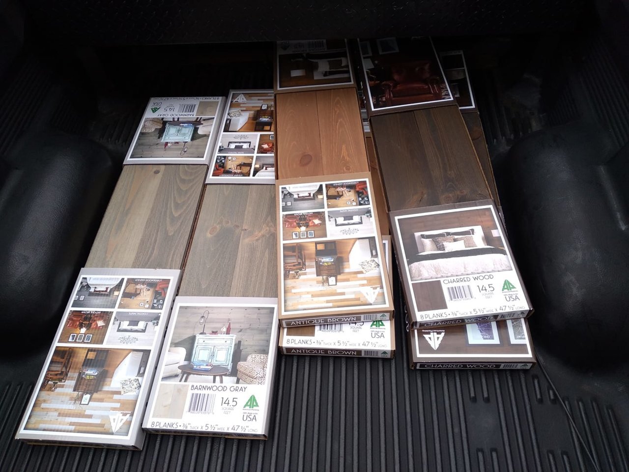

    Barn_siding_Den.jpg Hauled some Winter time Den remodeling project barn wood over the weekend.

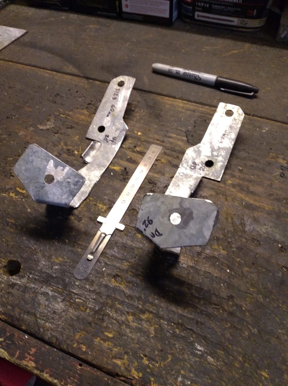

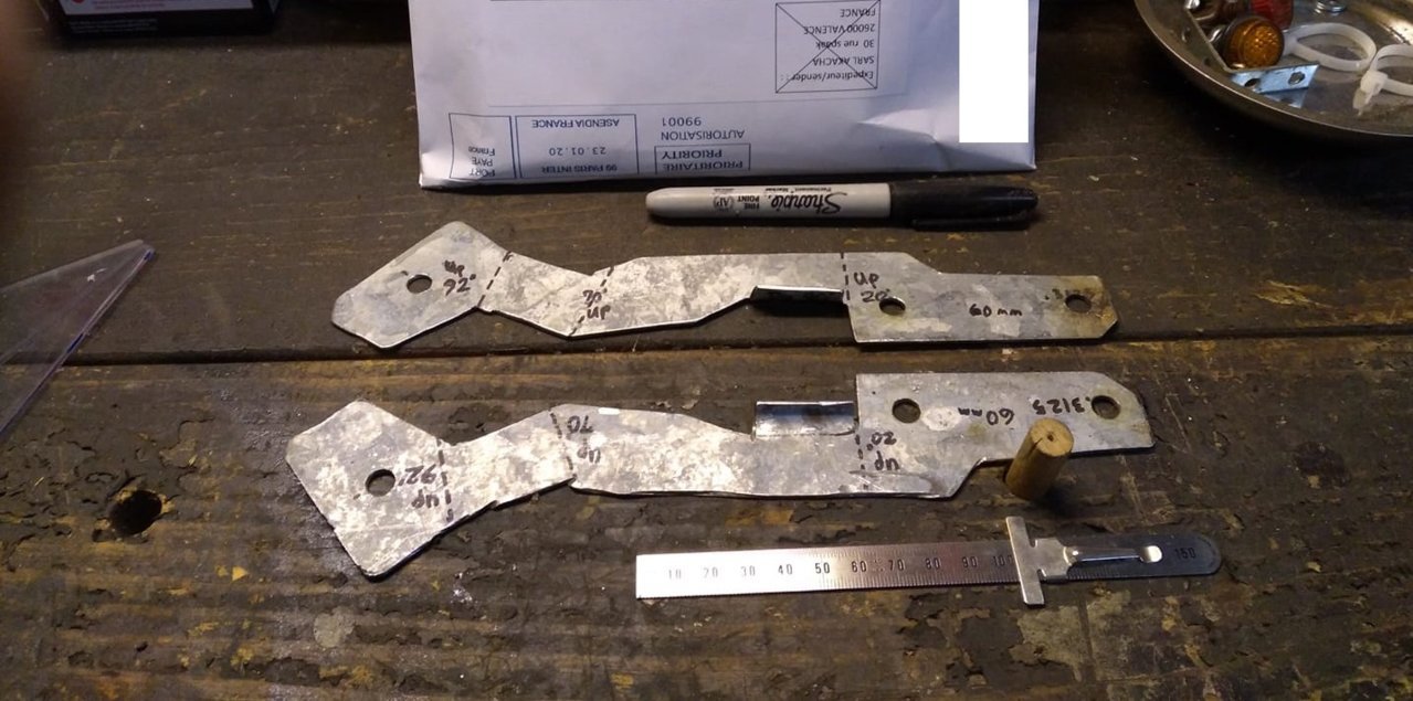

    Found some thicker gauge sheet metal in the bin and decided to make another ditch light bracket prototype.ditch_lt_brkt_flat-hole.jpg ditch_lt_brkt_bent.jpg

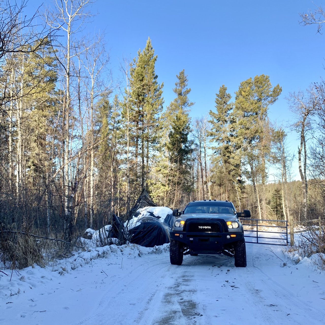

    It’s a Goat.
    Used it for a work station and tool transport. Had to cut the next hay bail open for the horses :)

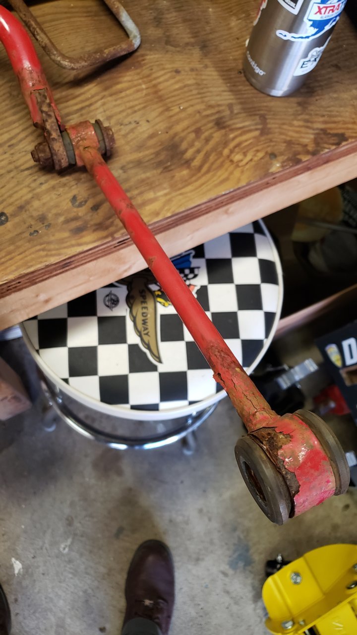

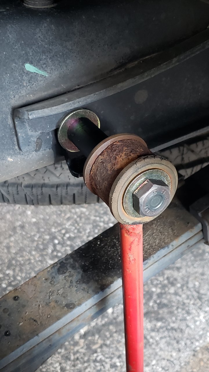

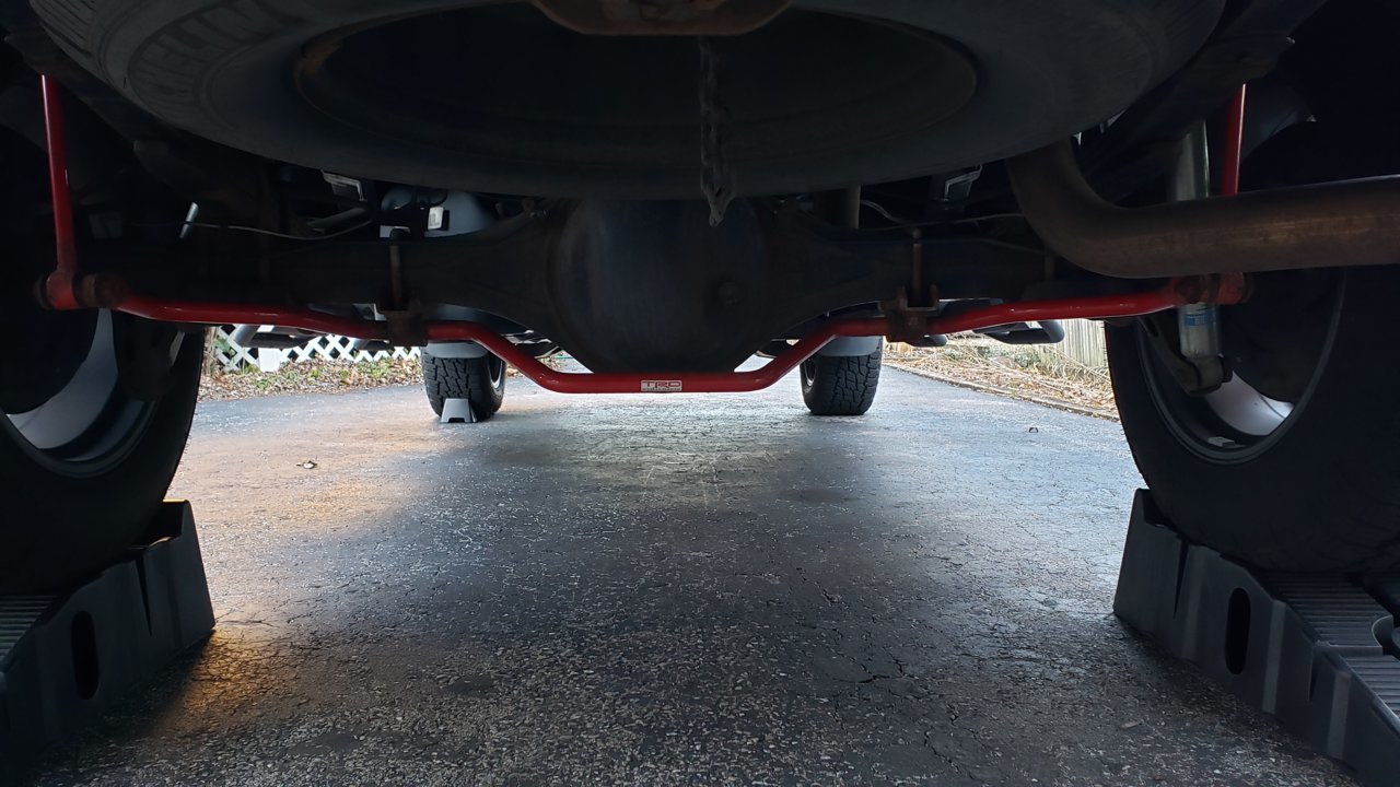

    Picked up this used TRD rear sway bar off FB marketplace for only 60 bucks. It's a little uglier than I'd hoped, but for that price I'm not upset about it! It didn't come with the hardware to attach the end links to the frame, so I had to do some running around to find 10.9 grade bolts of the proper length and thread. Then I had some schedule 40 pipe cut to length to make the spacers. I figure I'll spray paint the spacer to keep it from rusting too quick. Have any of y'all sanded/blasted your sway bars and recoated them?

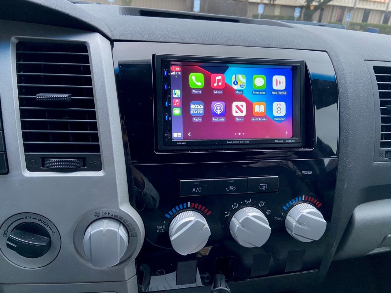

    Finally got this all installed:

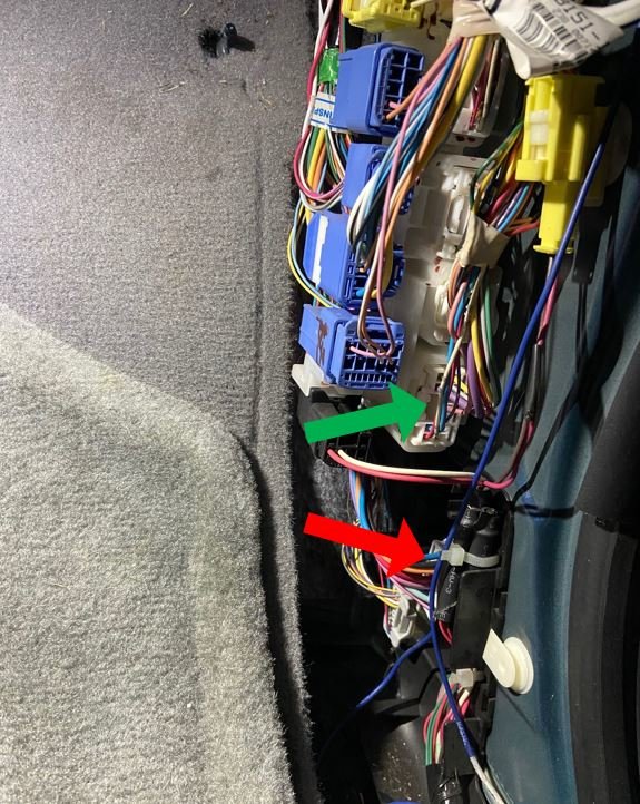

    One question from my head unit install:
    Crutchfield's directions say to tap into the reverse wire which is the blue wire on the 11-pin connector in the passenger kick panel. Problem is, there are two 11-pin connectors, both with blue wires. Anyone done this recently and know which one it is?

    I think crutchfield diagram shows which 11-pin connector. I see if I can find it.

    ok it says: passenger kick panel, white 11-pin plug, pin #3 blue.
    iirc its the top one. check pin #3 on both and see if both are blue.

    Thank you - that's super helpful!

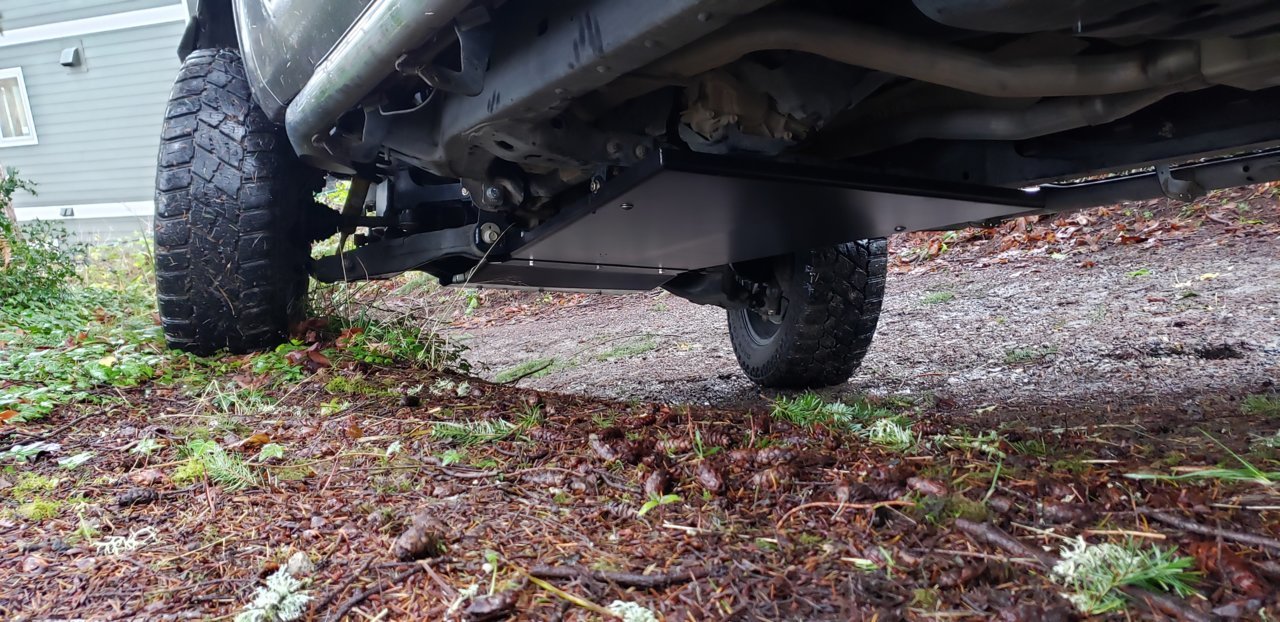

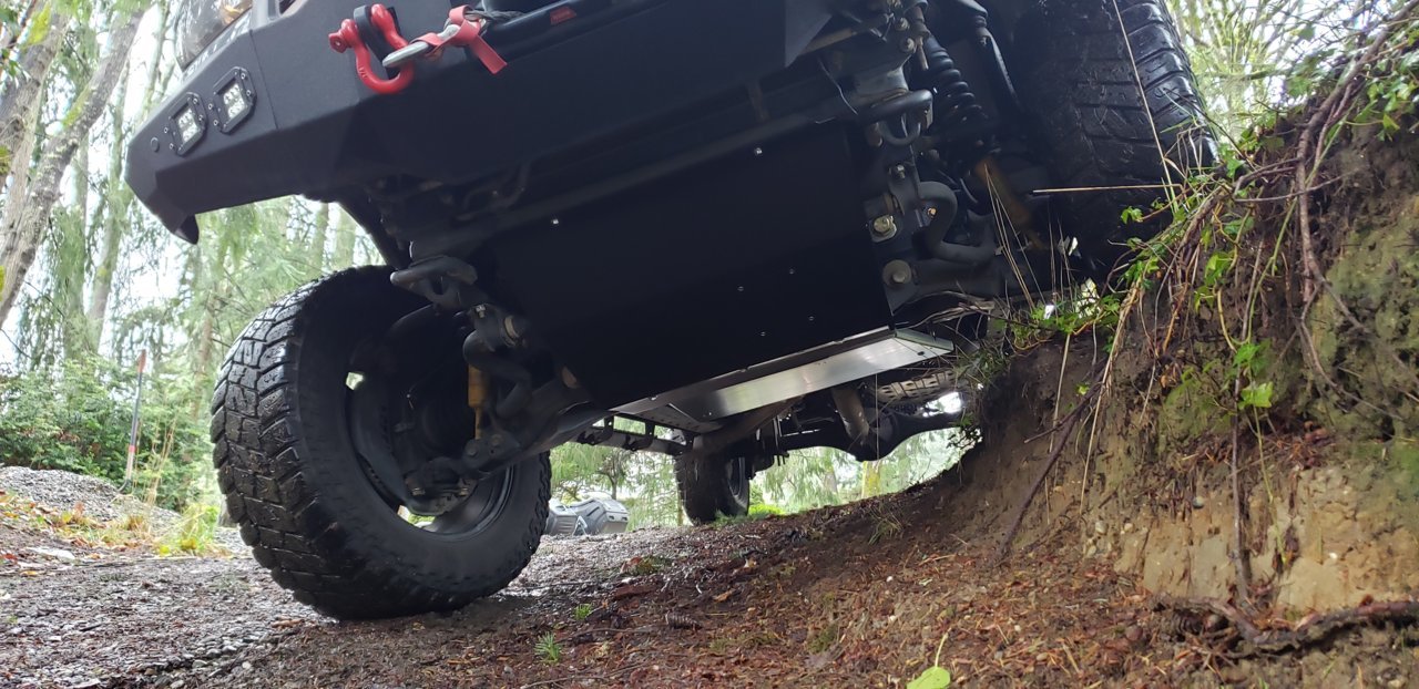

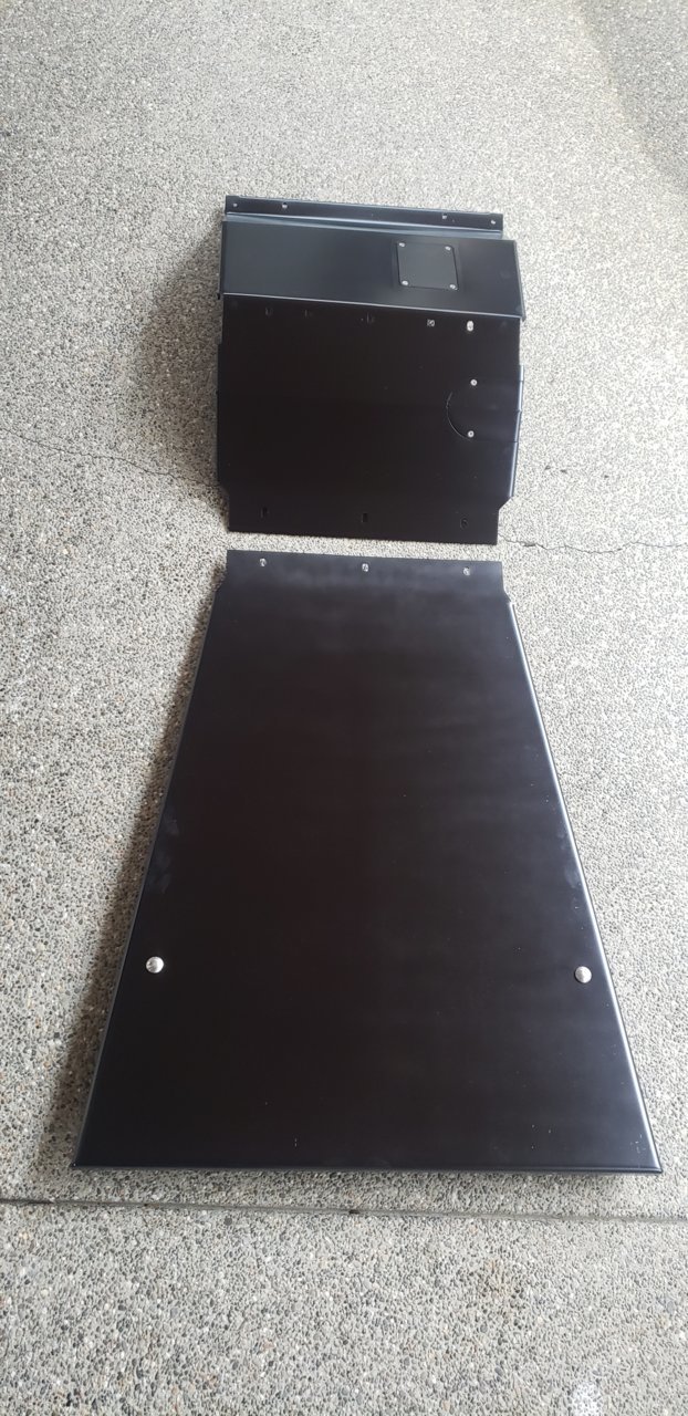

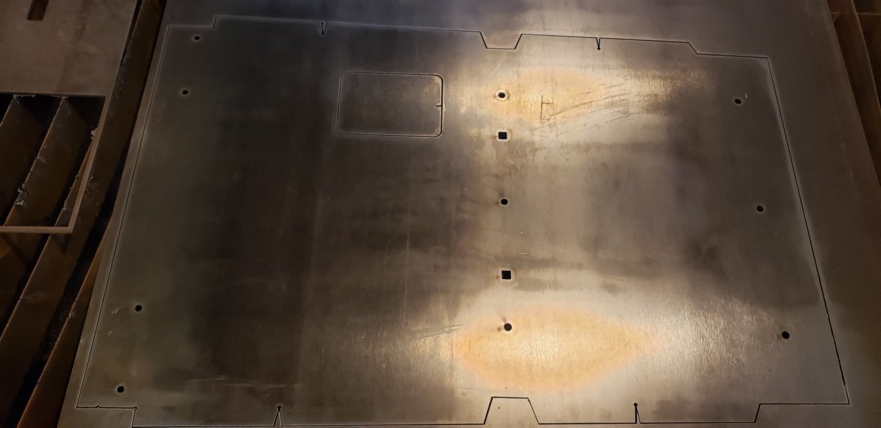

    It's not my 2nd Gen but I built these skids for a local friend.
