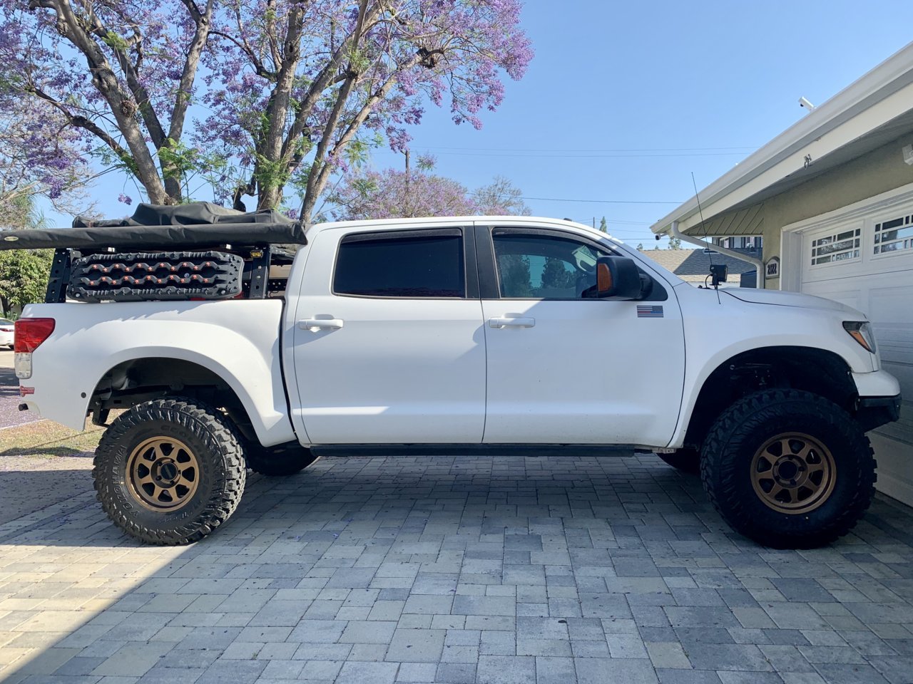

    Too much to list

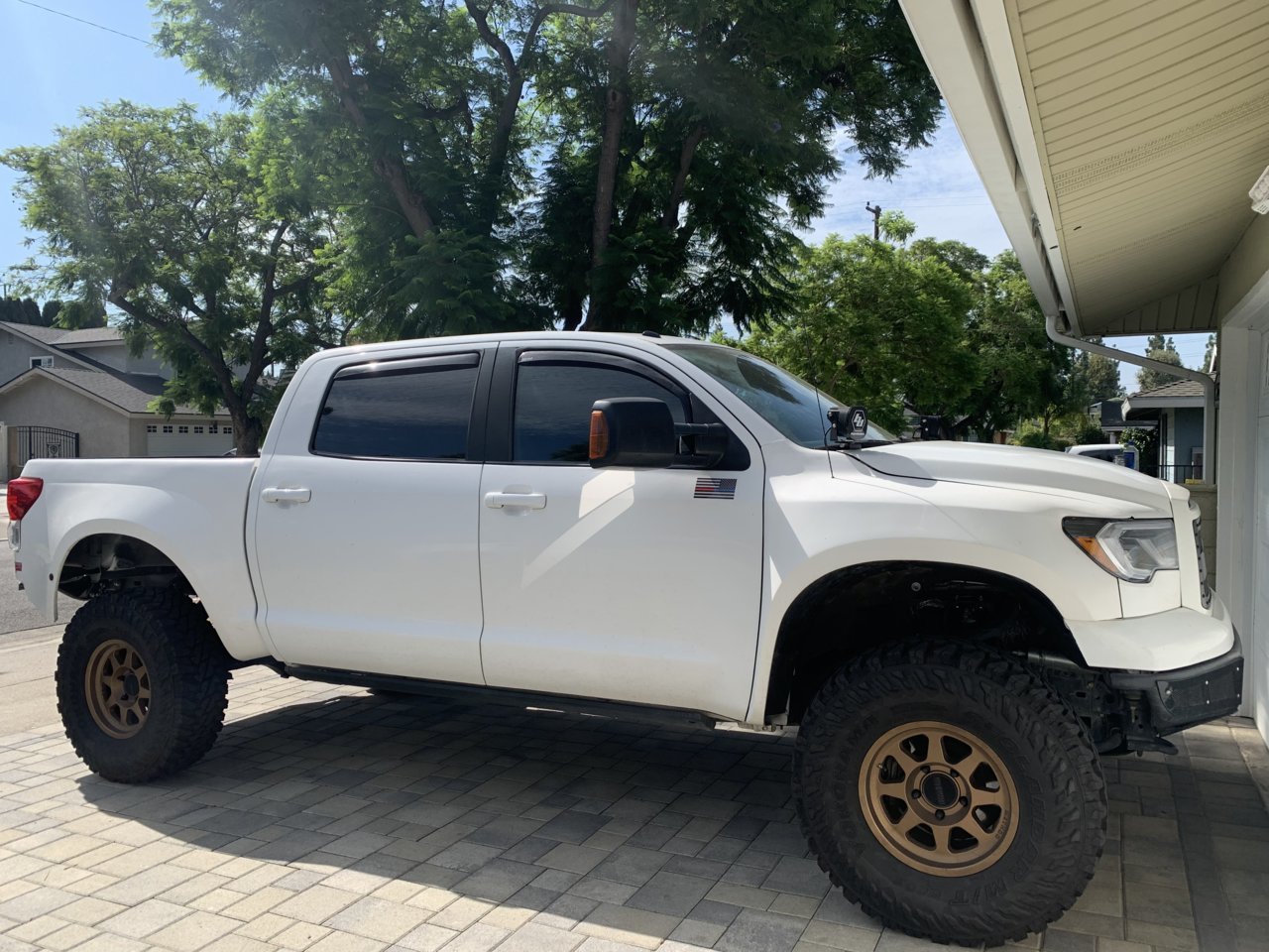

    Just trying to cut weight on the bed. Working on getting her new legs :)

    Are those the Advanced fiberglass fender flares?

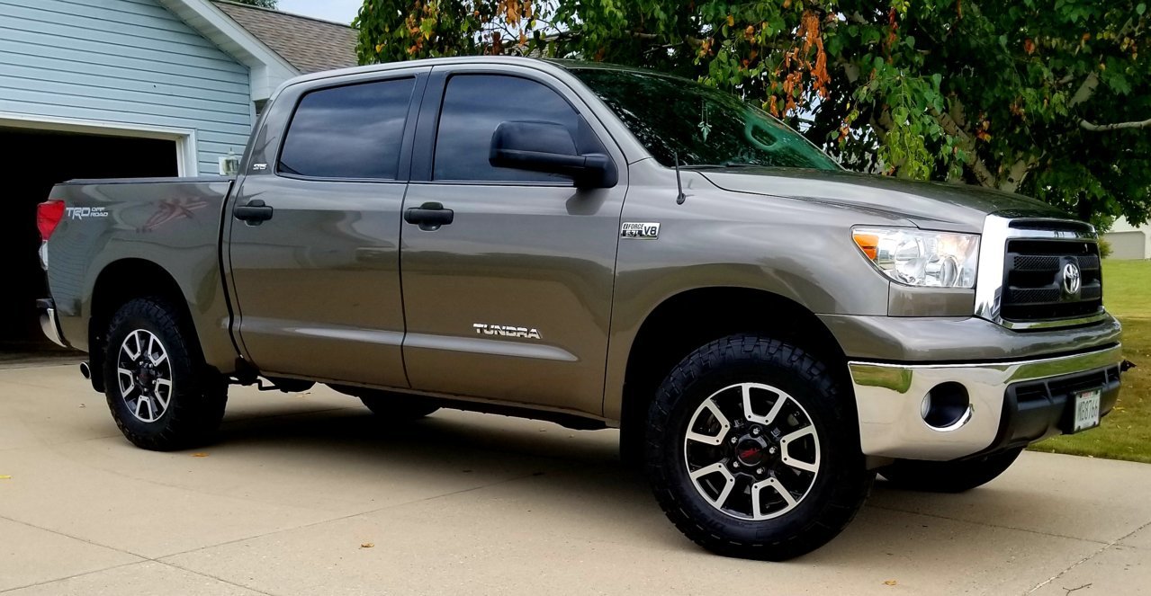

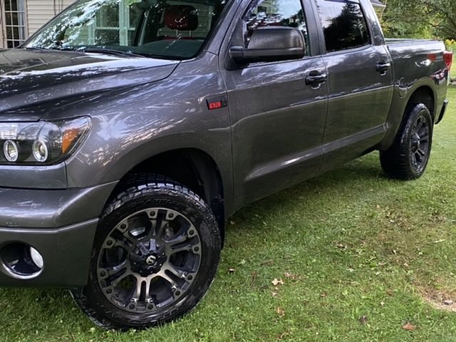

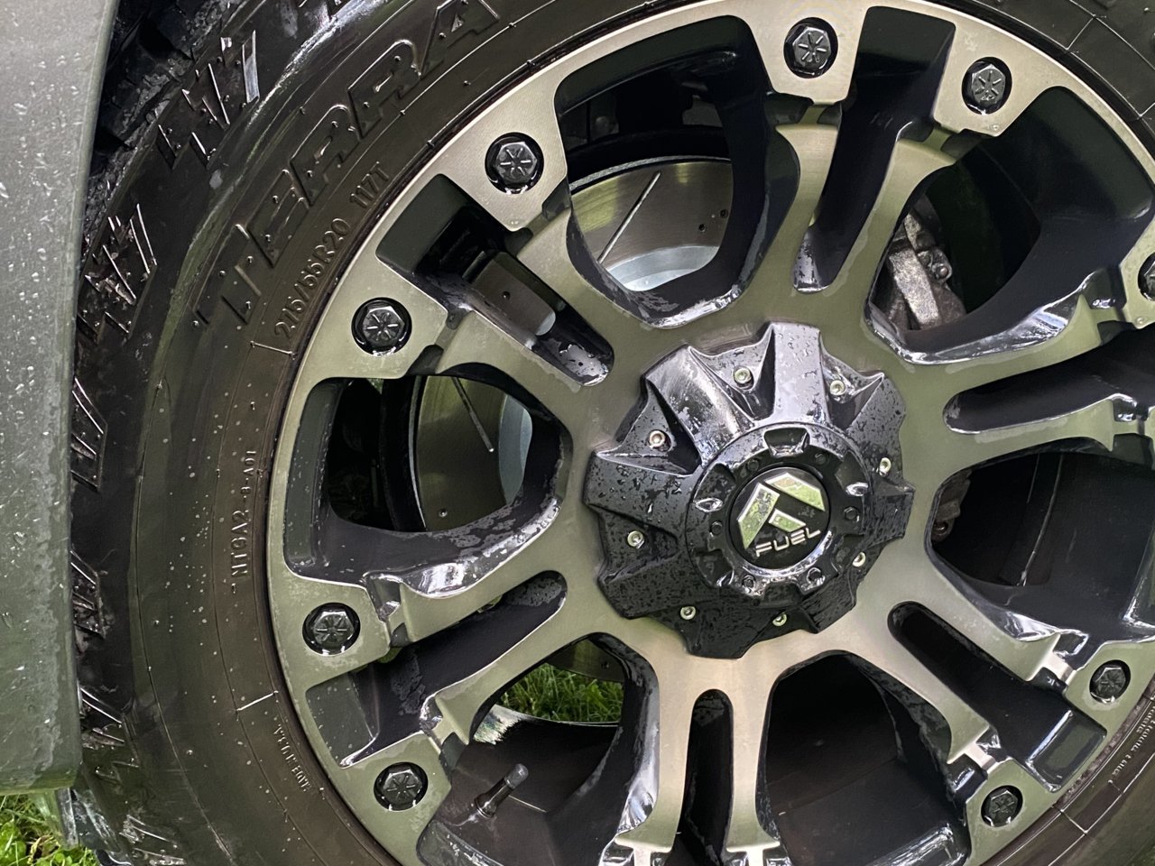

    Finally got some much needed detailing done. Stripped, nano skinned, polished, sealed and two coats of wax. Glass is clean and all the trim got some 303. I also pulled the rear bumper, cleaned and coated the inside and cleaned up the hitch.

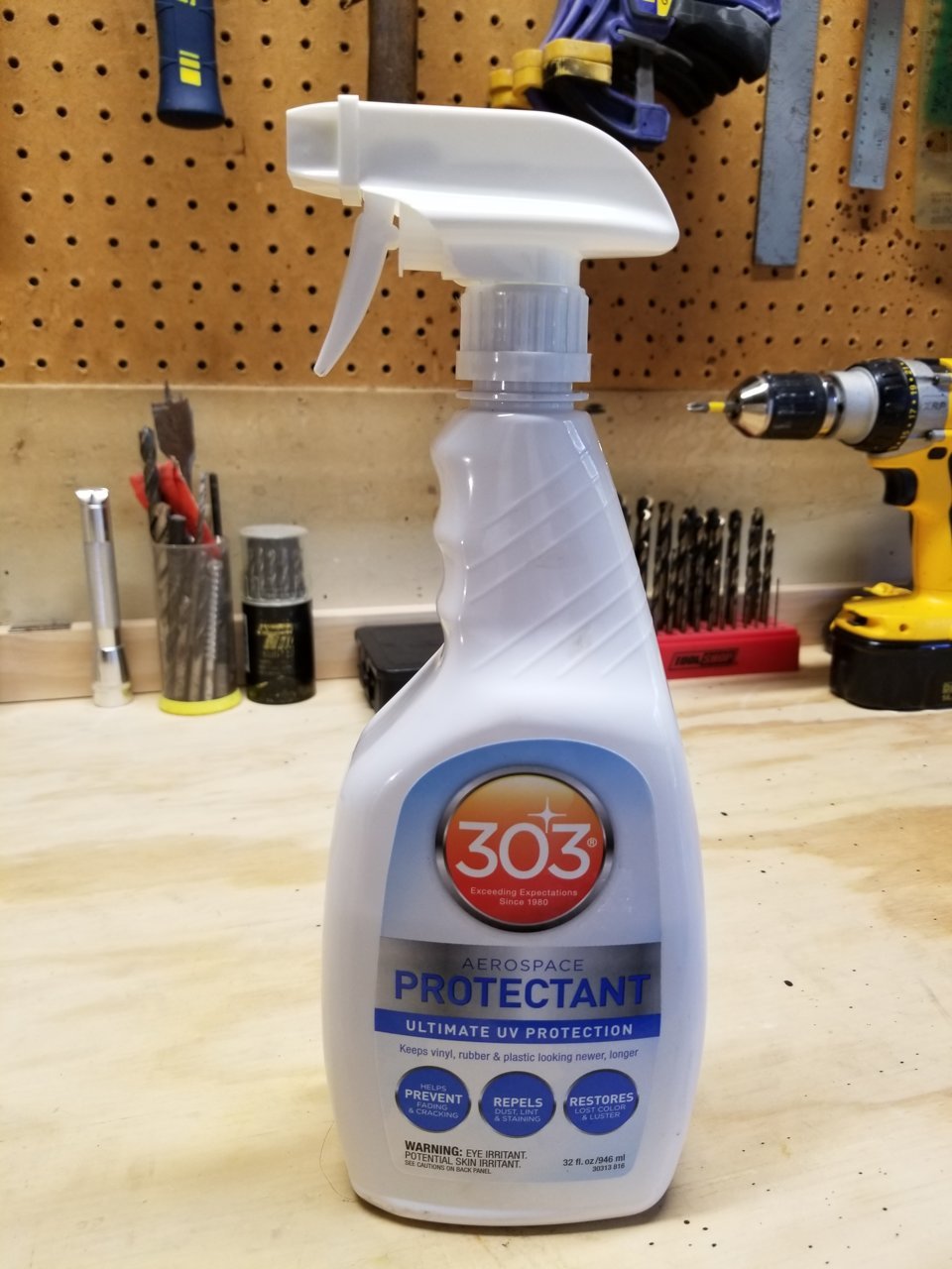

    That is a very clean looking truck! What is the 303 you mention for the trim?

    Thanks! 303 is a spray protectant. Alot of tonneau manufacturers recommend it because it doesn't have any silicone in it. I've used it for years and also like their multi surface cleaner.20200824_180837.jpg 20200824_180850.jpg

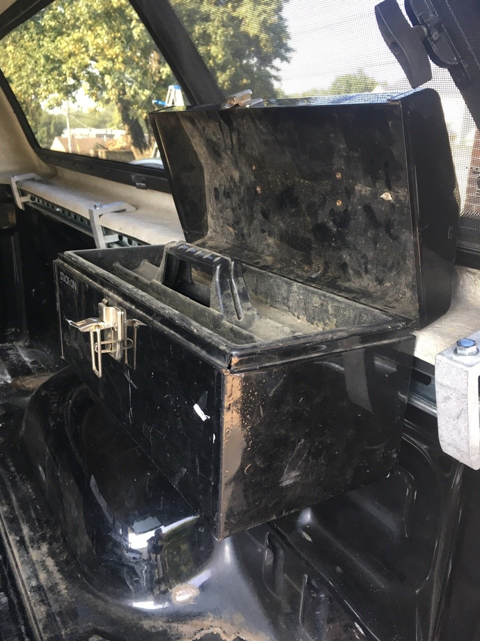

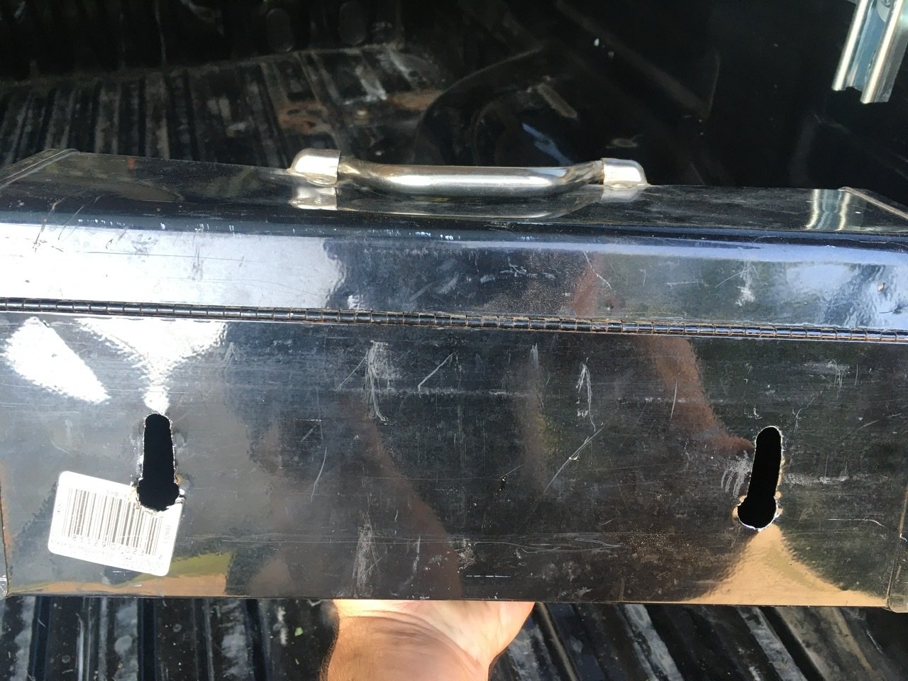

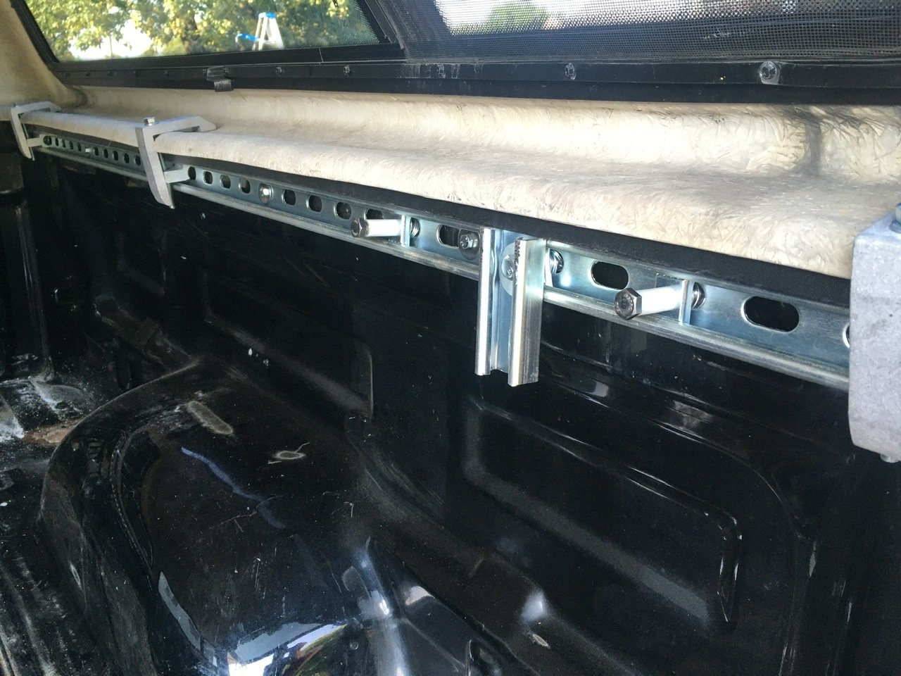

    Added some mounts in the bed rails for a little toolbox to carry some basic tools. Might hate it in practice, but liked the idea.
    95D649AB-6598-42C6-A131-769C4A9B0BCE.jpg EC125552-82D7-44CB-A30E-F33F982BBBAB.jpg

    Fantastic product. I use this every time I wash on all the black trim, the mudflaps and front and rear bumpers. Makes them look brand new.

    Thanks! It was a full weekend worth of work but I enjoy doing it and love how the truck looks. I feel much better about the hitch and the inside of the bumper now that the rust is gone.

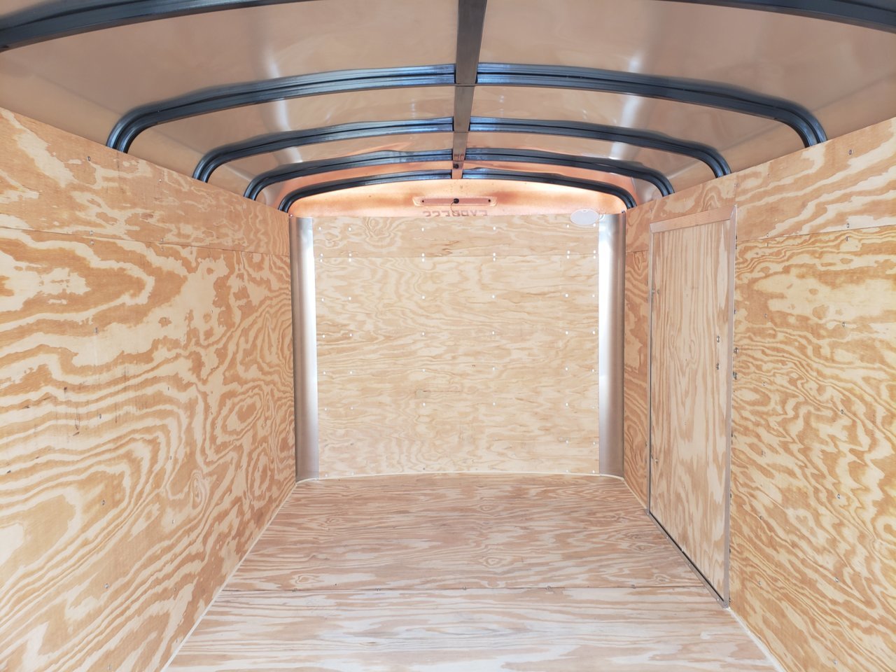

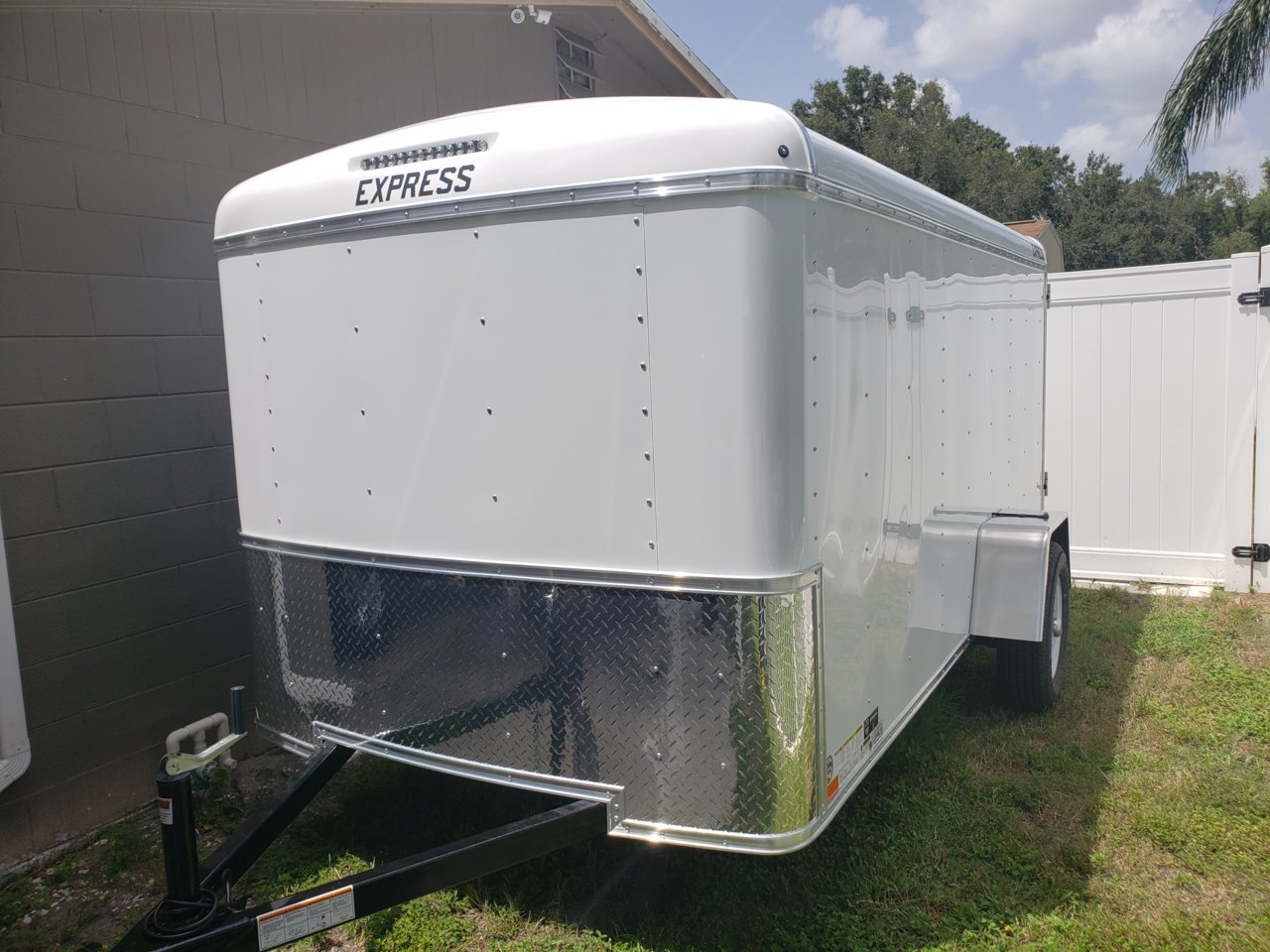

    Used it to pick up my custom built trailer. 6x12 7 feet tall. Had to go custom to clear the beams under my carport. It will even fit in the garage if needed. :thumbsup:

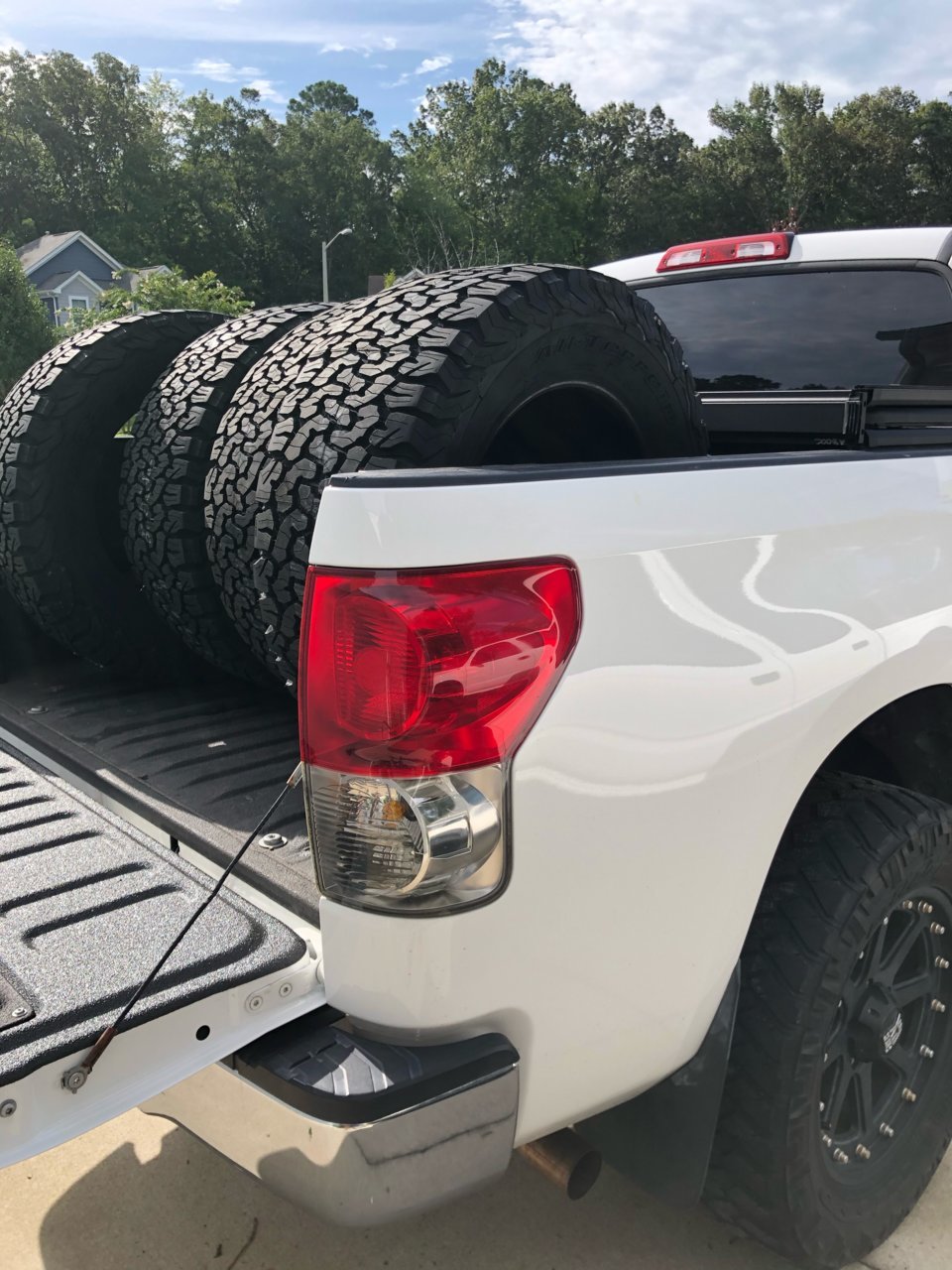

    New 35x12.5x20 tires waiting to get installed next week.

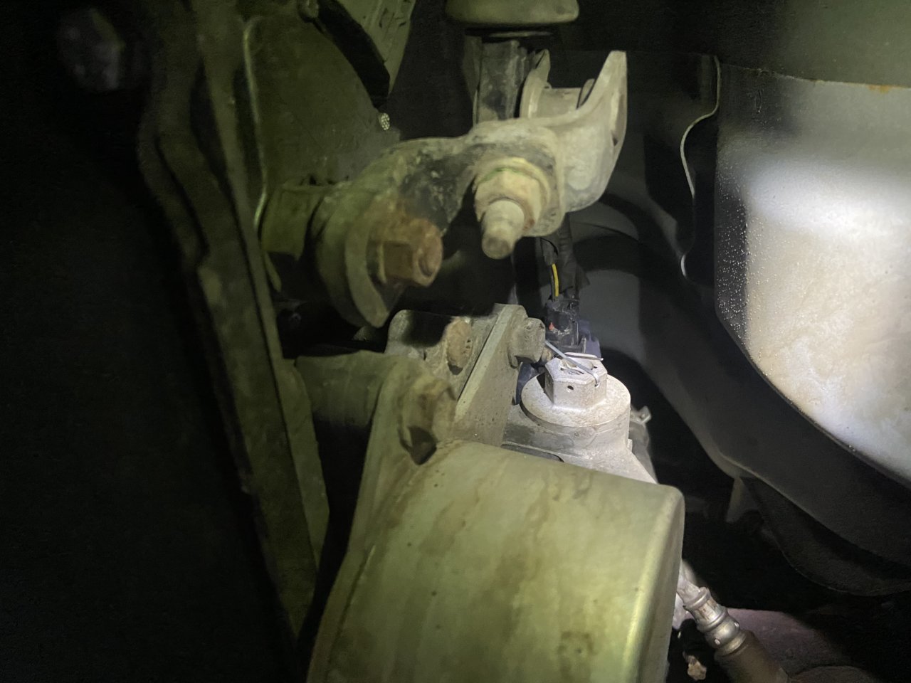

    Pinned my transmission thermostat today.
    Before I was around 195 cruising at 70mph on the freeway and highest it got was 210 at a red light on top of a hill
    After pinning at cruising speed of 70 I’m around 160-165 at the converter and got to a high of 180 at the same light on top of a hill.
    Both times I drove I had no load. From the research I’ve done this puts the fluid at a more optimal temp. Can anyone think of a negative effect this may have? I’m thinking I’ll unpin when winter comes around.

    Interesting, I’m also wondering if possible negatives of this but shoot 30 degrees cooler temps is a win in my book.

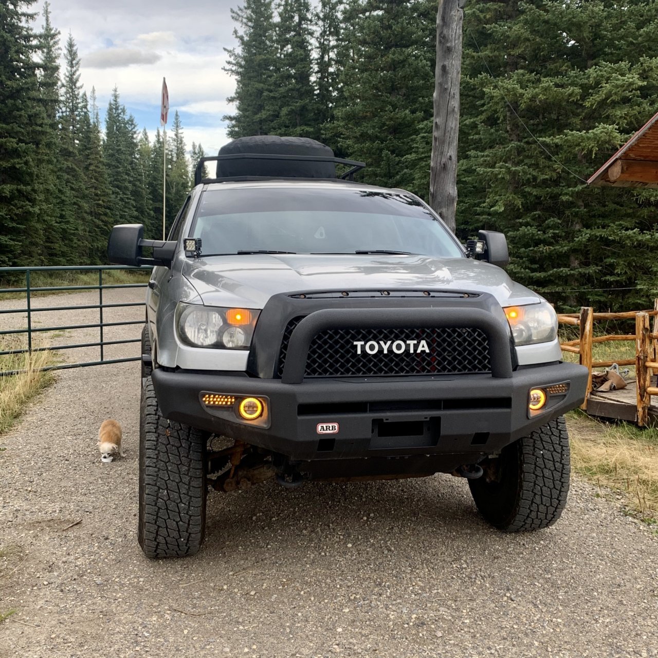

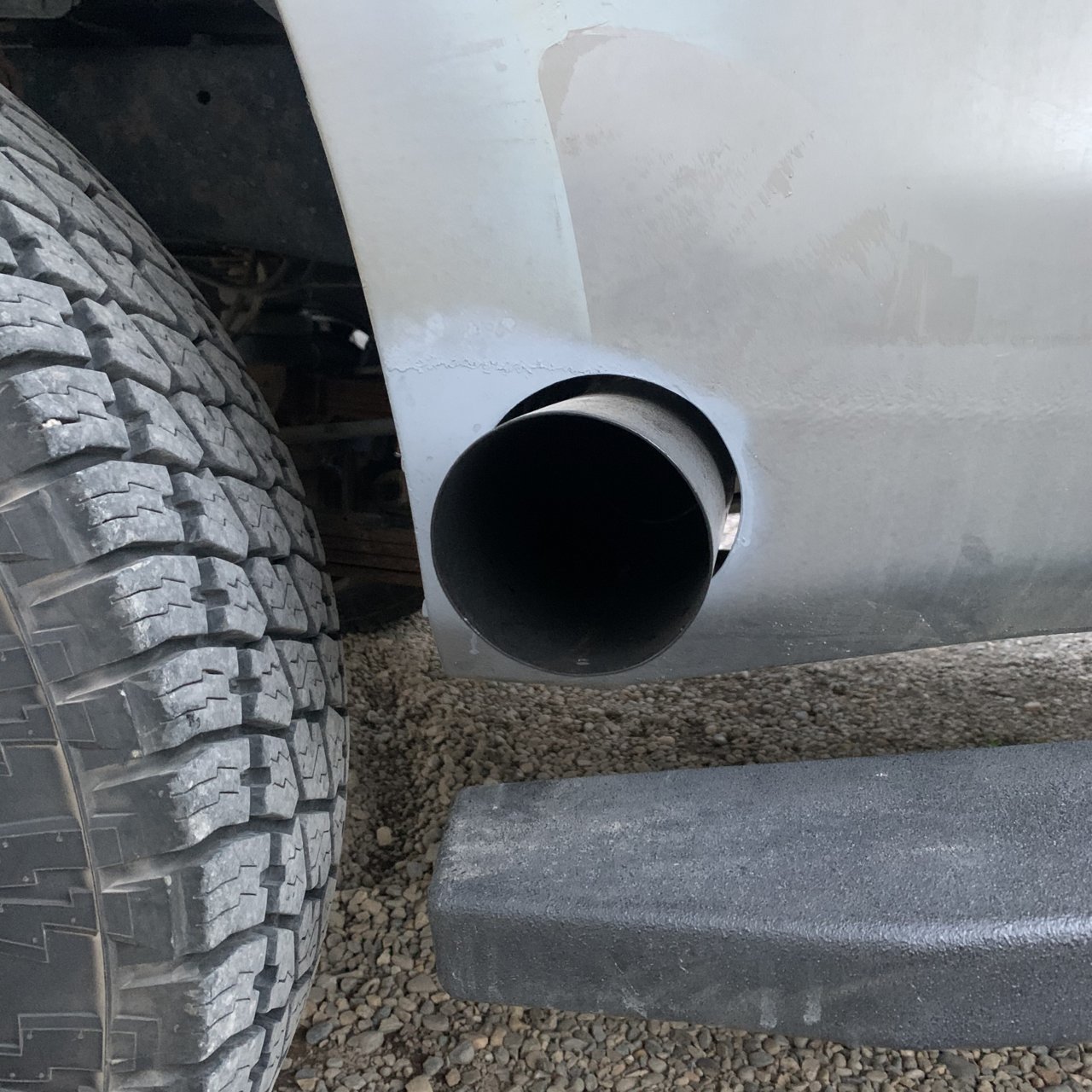

    Installed a 4” black exhaust tip then drove to the ranch with the fam :burnrubber:

    front end looking good !

    Thanks homie, it’s coming along nicely :). Also, I can’t stop staring at it haha.

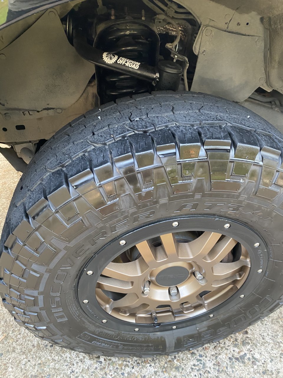

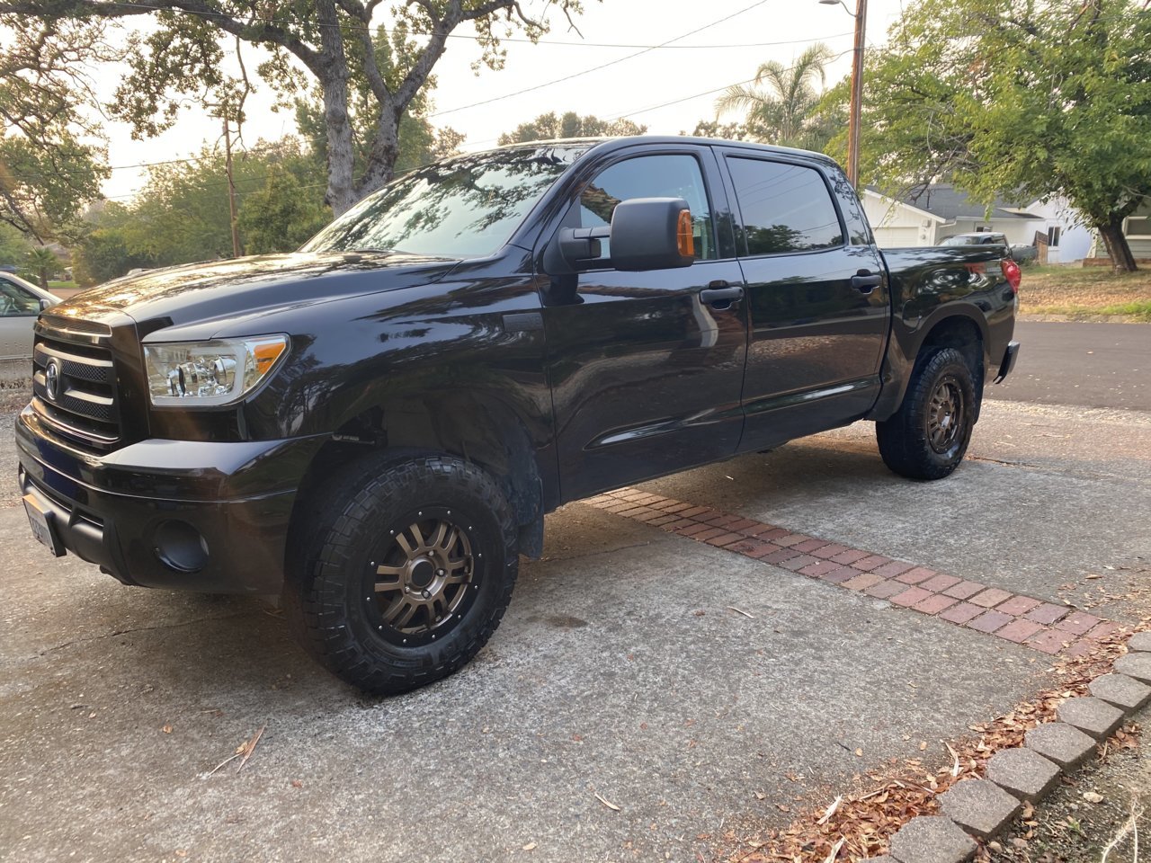

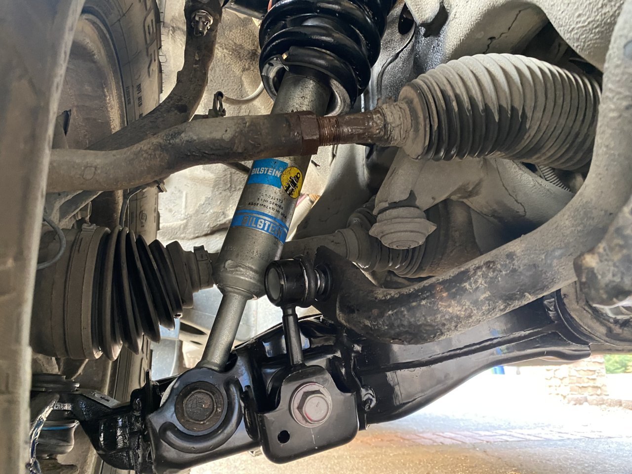

    Installed (by brothers shop) Bilstein 5100s top setting, Freedom Off road UCAs, Moog LCAs, front/rear diff service w/ royal purple and finished it all up with a bath. First time using the Griots 3-1. Absolutely love the product!
