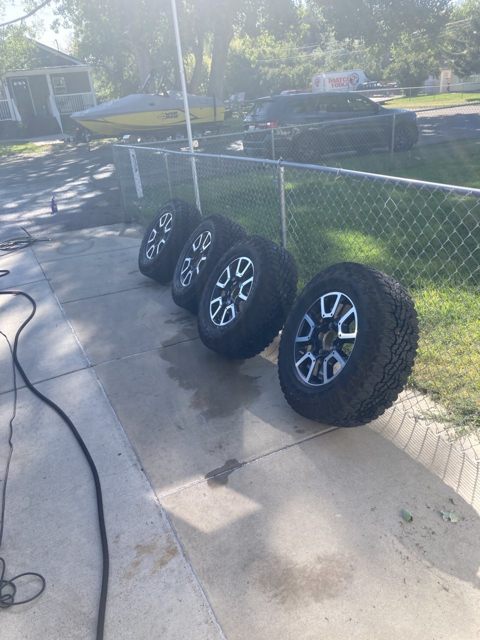

    Indeed, that’s all that’s left. Gonna plastidip them black soon. Want a new front bumper....but my wife says I have to hit something first hahaha....bring it on deer hahaha

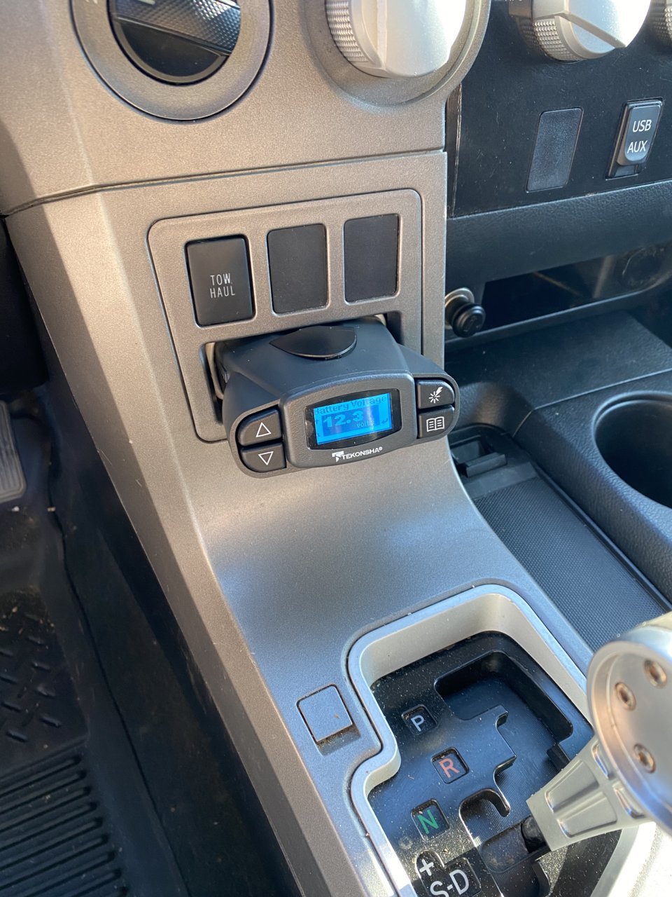

    Installed my new P3 yesterday. Not loving how close it sits to the shifter. Any feedback on that location? Will possibly relocate to the cigarette lighter cubby. Anybody have any experience with that?

    I have my prodigy p1 in the same location as you, slightly smaller controller but I love the location. It’s the best spot in my opinion for it. Close to the driver for emergency manual control. Yes, it’s close to the shifter when it’s in park but when you’re driving the shifter is plenty far away from the controller in my opinion.

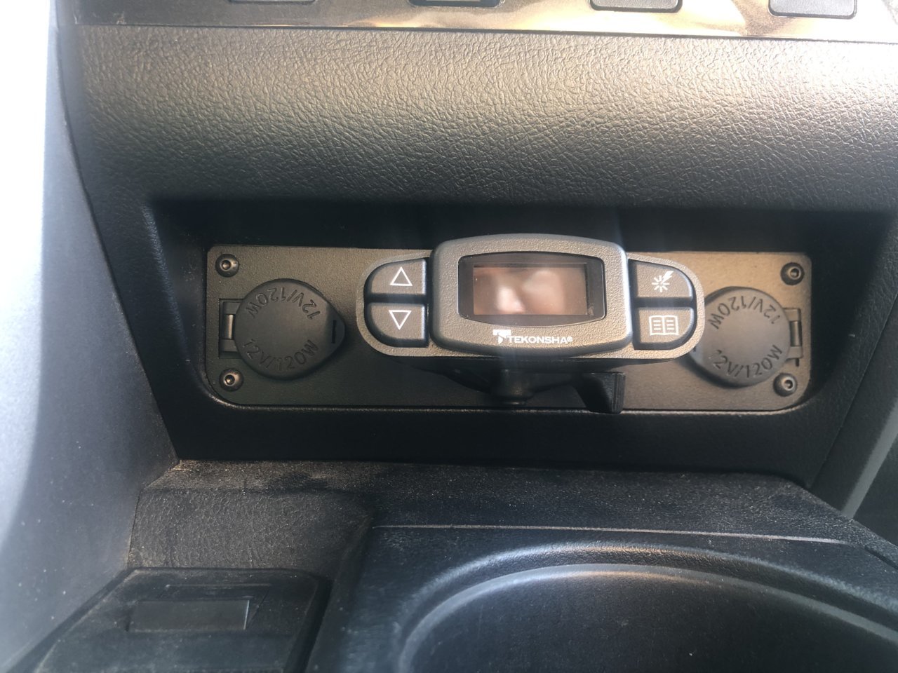

    Yea I extend the wire harness and relocated in between the 12v plugs

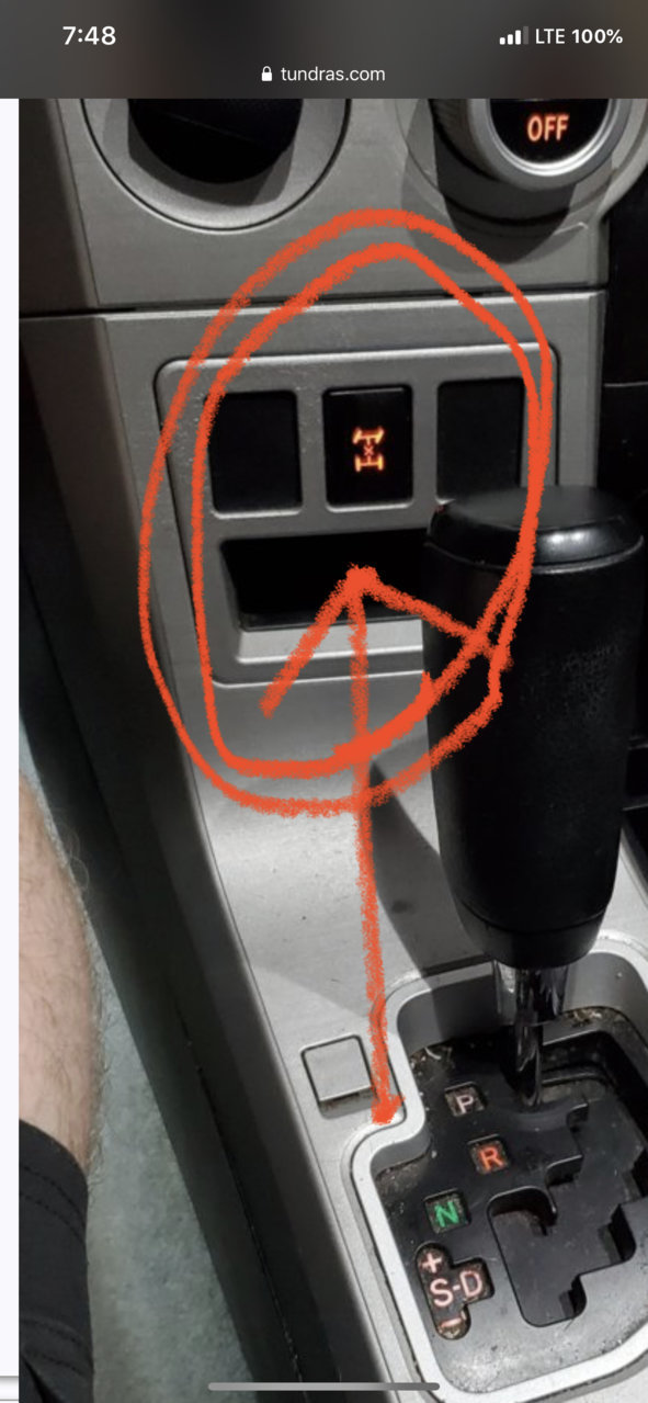

    Sequoias and Land Cruisers are equipped this way. And a very few of us that have done the transfer case swap only possible on 2007-2013 Tundras. The T-cases in the Seq/LC has a Torsen differential in them that can be locked and unlocked. The Tundras center differential is locked in 4H and 4L, that's why you can't be on a high traction surface and turn. The Seq/LCs can. :cool:

    It looks like a special faceplate adaptor. Where do you find that?

    Earl from ESP made it...it was a prototype but you don’t need it to install it. It just makes the finish look good. I haven’t seen it yet in his website but I’m sure you can give him a call and he can get you more info on production.

    are these oem tundra wheels? if so what year

    Correct, they are off a current TRD off-road package. Came on the truck when I bought it and I just plastidipped them. Used to look like this.

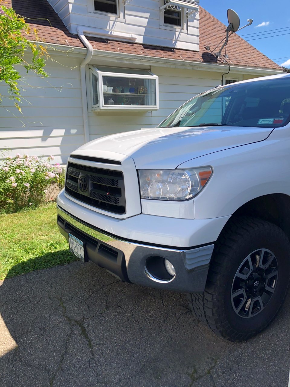

    wow what a real difference! didnt realize it was the same wheel
