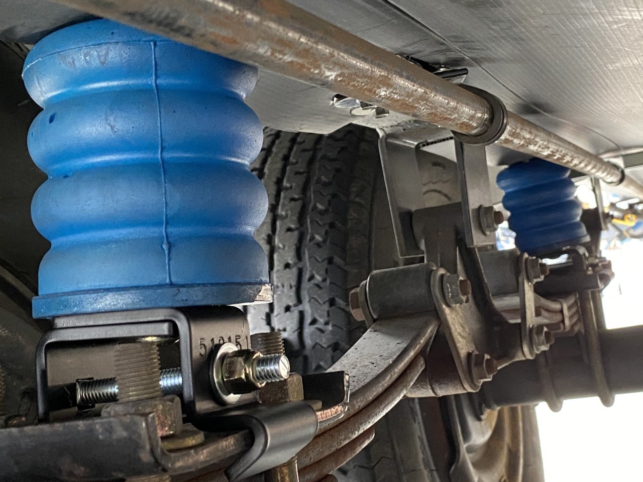

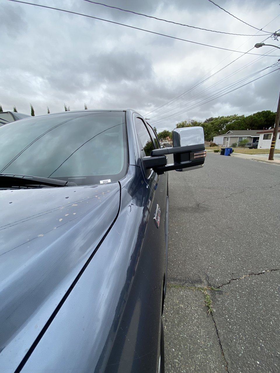

    Getting my rig ready for a trip to Gualala California. New sumo springs and tow mirrors. Hope to make it a smooth and safe ride. Four hours away from my location in the East Bay in Norcal.

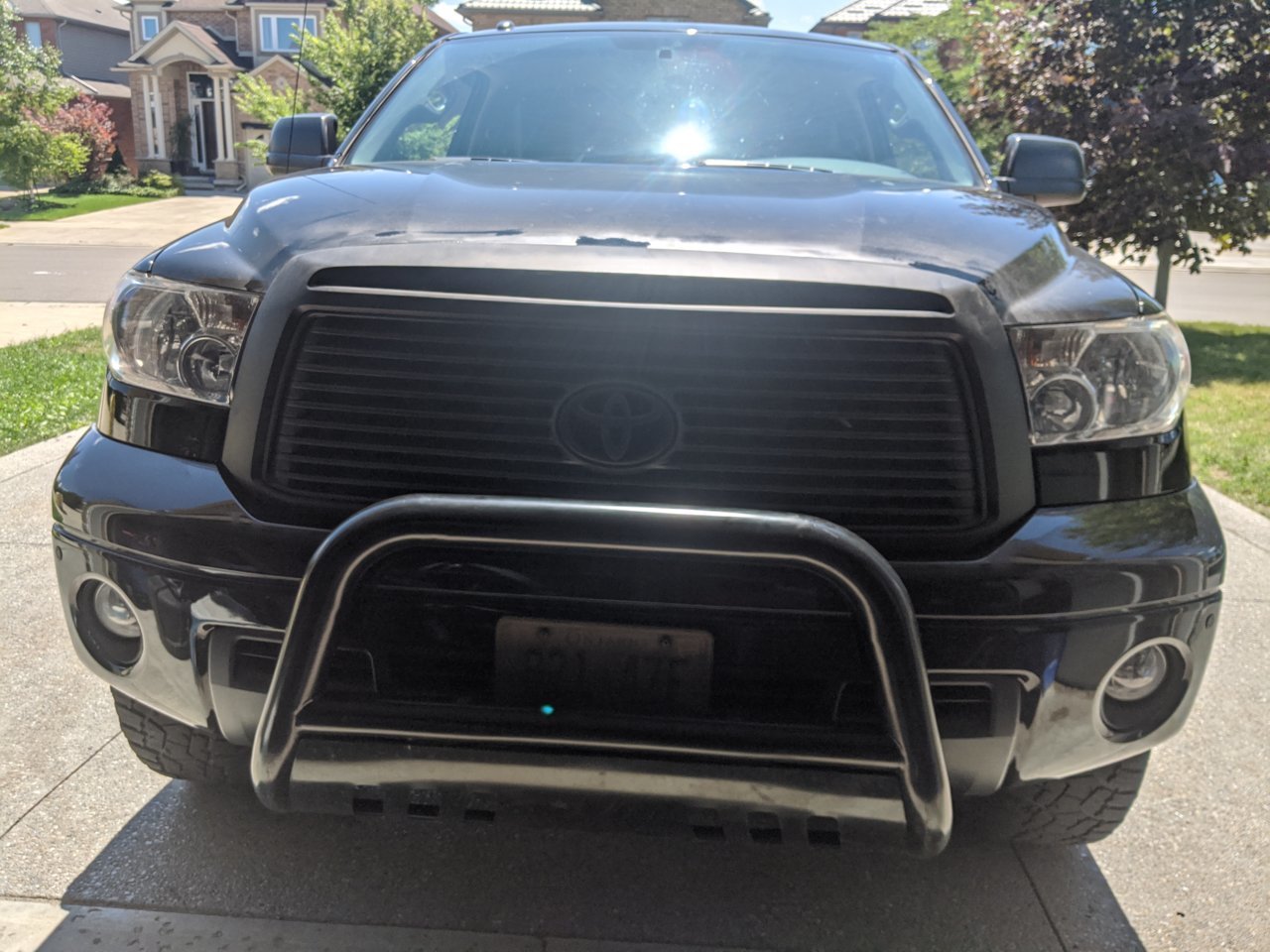

    Blacked out my newly obtained Limited grille on my RCSB

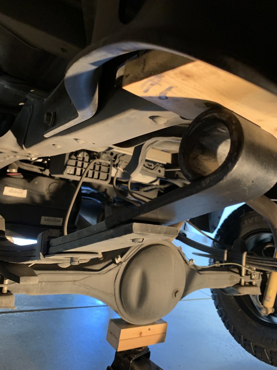

    Toytec shackles at 1 inch setting installed. Also replaced the rubber bushings with the poly from toytec. Rented the ball joint tool from advance auto parts and used impact gun. Before and after pics

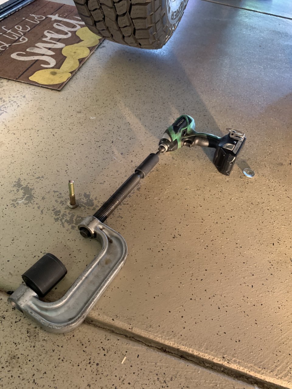

    Impact setup here , used the wrong adapter at first , it was too skinny and bushing was just running into it. Gotta use the short fatty one and they pop right out .

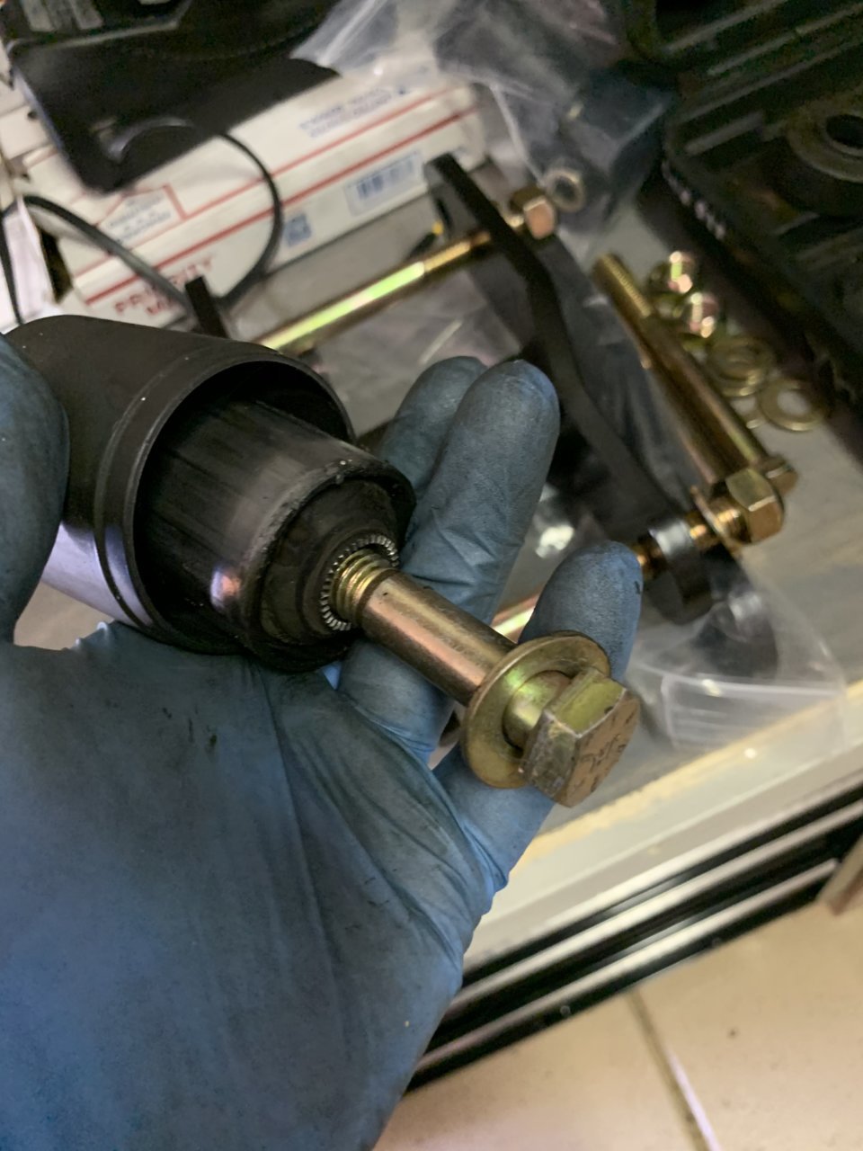

    Also ran a 1/2 inch grade 8 bolt and washer through the rubber bushing to give the ball joint tool something to push and the washer helps grab the metal sleeve.

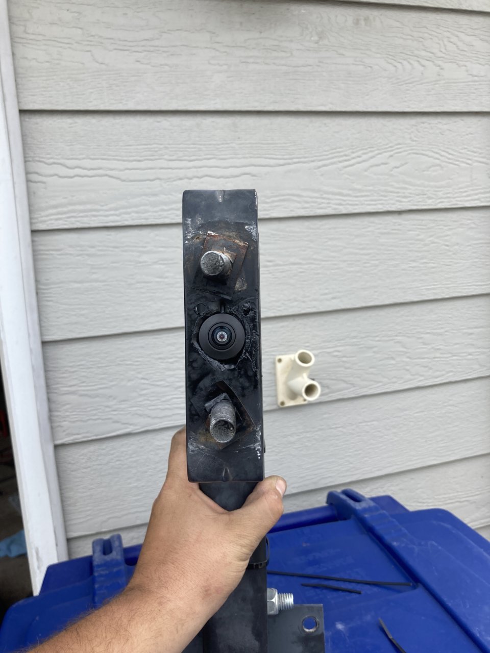

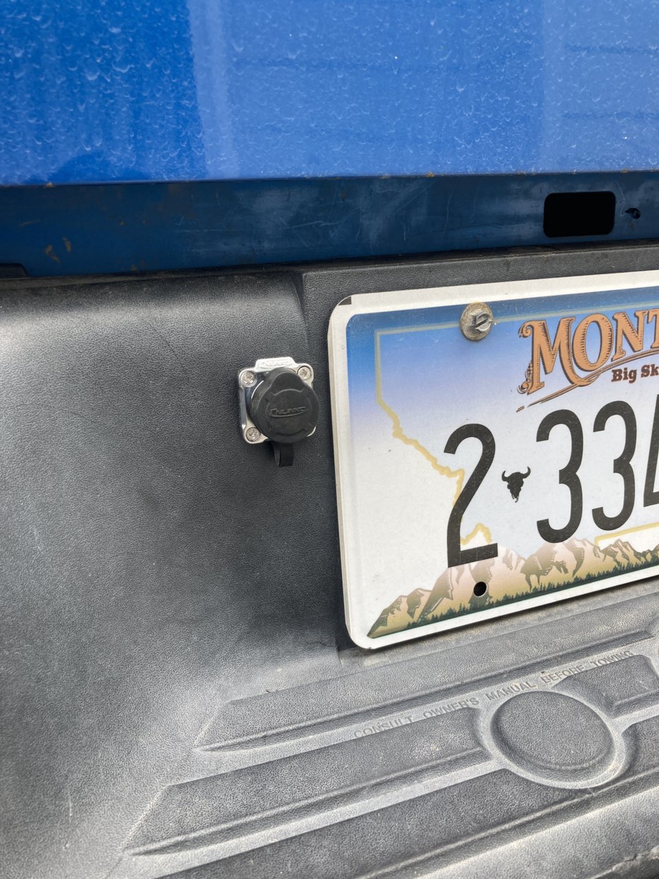

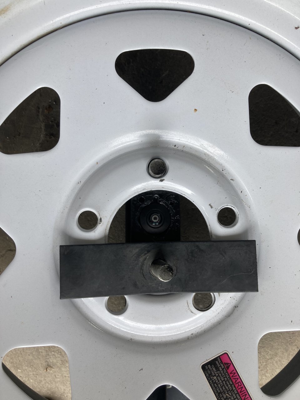

    Installed a waterproof, locking connector for a backup camera on the rear of my camper. This will be used to monitor the 4 wheeler when it’s in tow behind the trailer and assist in backing up. I mounted it in the spare tire holder, will mount it back up once the hitch is installed on the camper. My head unit has dual camera inputs so it will work out perfectly.

    Looks great. How did you do the grill surround? Did you (or a body shop) paint it?

    Thanks! I bought a new black plastic grill which I removed and separated the surrounding grill I wanted painted. Then had a local body shop paint to match along with a few other pieces.

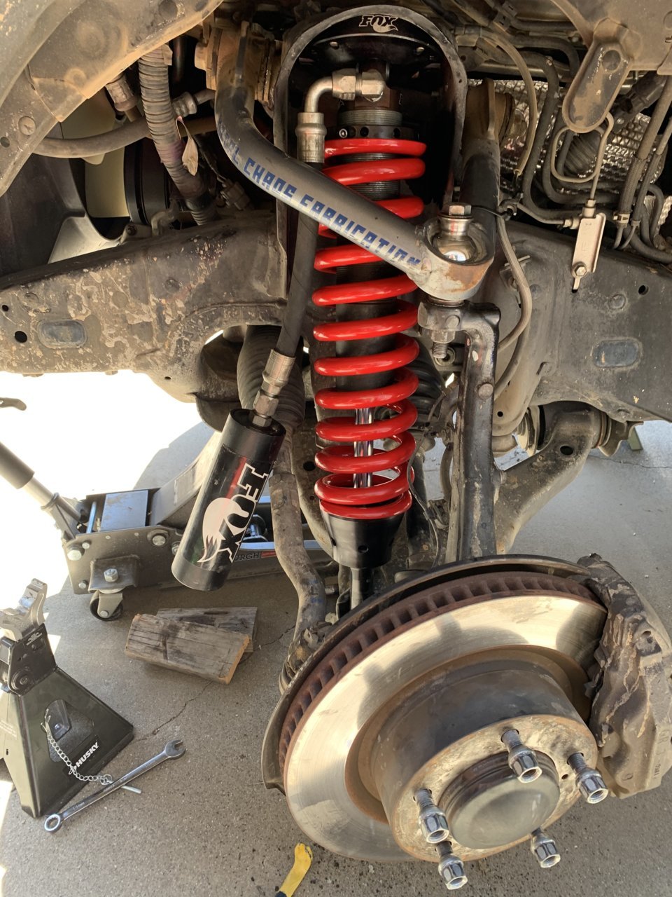

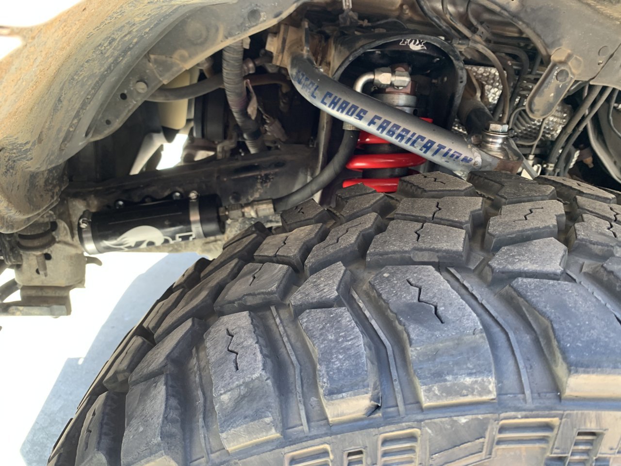

    Got my Fox 2.5 shocks installed yesterday. Thanks @TG705 for the helping hand!
    Was a bit of a process and things went wrong (like they always do) but out with the Icons and in with the new!
    48A3F9ED-0671-41A8-9F8B-B88E6E66493C.jpg 6C9F96D7-FF31-4CD0-AF3E-513ED69BE47C.jpg 8D03CC91-6DCB-4DFD-917E-E5FAF9EBD44F.jpg 1F12699E-9977-402B-891B-647B2E2A4519.jpg

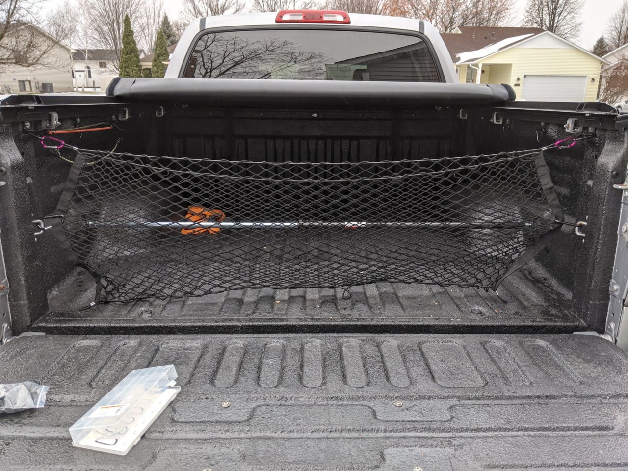

    Did you have to install those upper anchor points? Any you recommend? My 2006 does not have them. Thanks.

    I installed D rings in leu of the oem bed rail system. Used the threaded bolt holes.

    Thanks - so D rings is the term I needed that I was lacking and I guess that means it's safe screw them down w self tapping screws w/o puncturing the outside. Good idea! I'll also eventually get the same net now.
