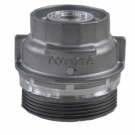

    Alot of them
    Switched to the aluminum housing.

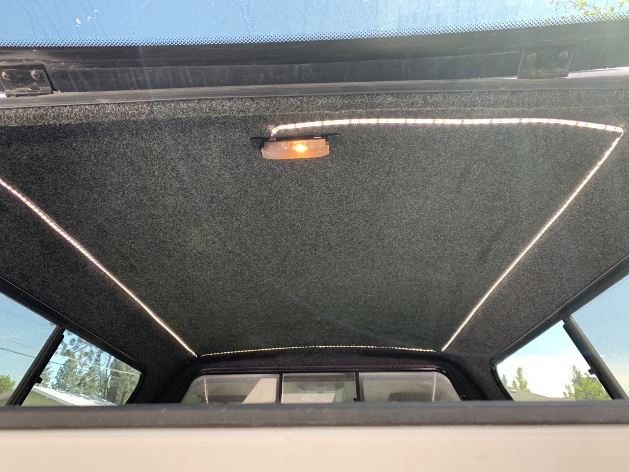

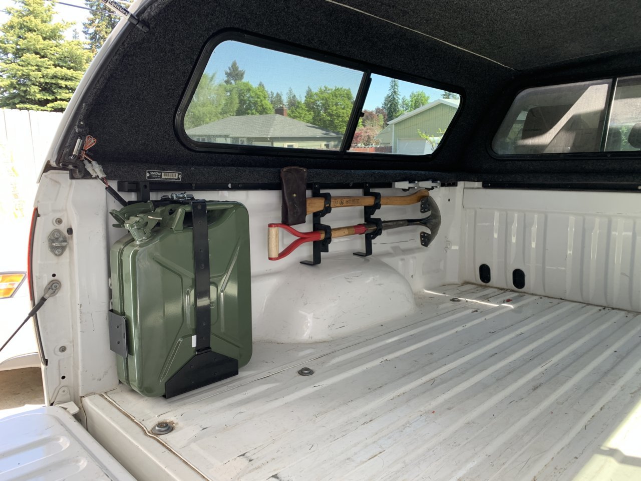

    Mounted a Wavian gas can, tools, and an LED strip.

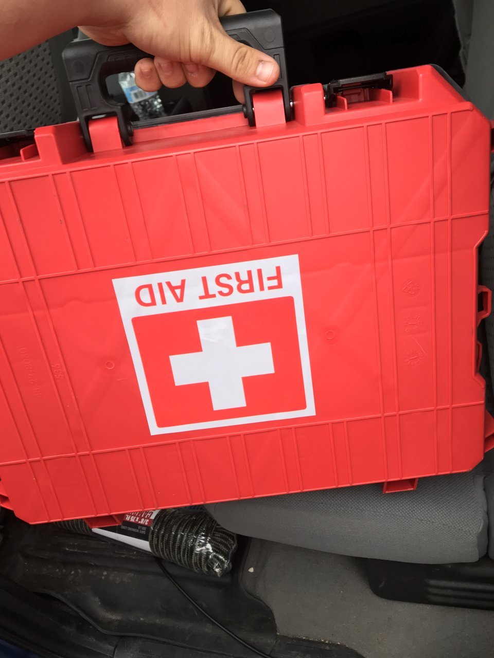

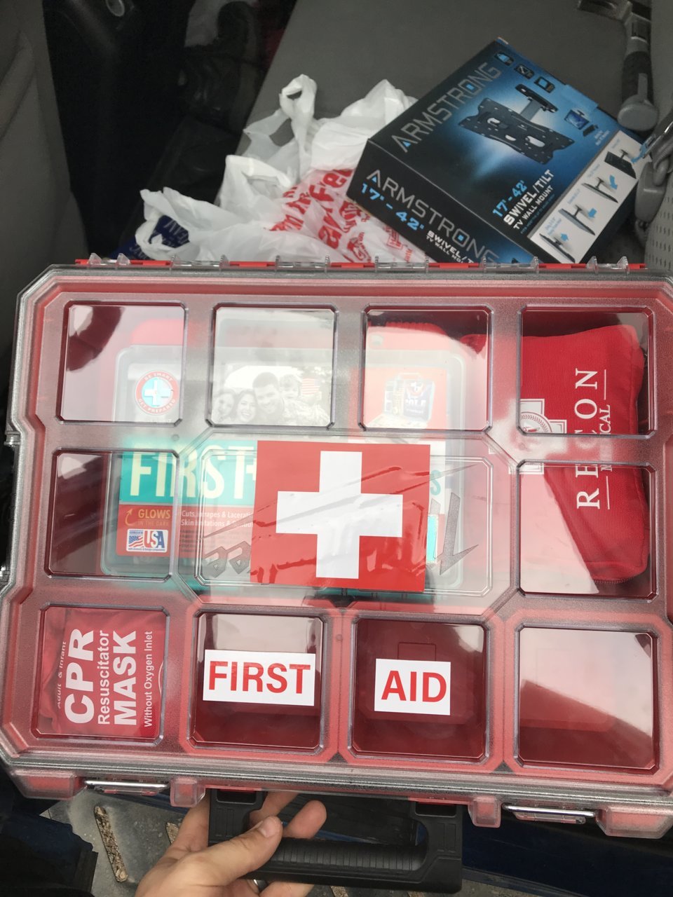

    Got a “grab and go” first aid kit made up housed in a Milwaukee organizer and put under the back seat. Contents are a Basic first aid kit (bandaids, gauze, cold pack etc), a bleed kit (TQ, Israeli Dressing, thick gauze pad, 2 packets of clot powder and trauma sheers), and an adult & child CPR mask. 3 additional storage bins fit and there is more room in the main compartment. I will be filling one bin with gloves, one bin with additional gauze and med tape, and undecided on the last bin. Thinking it will be a “mini pharmacy”. All the major pain meds, Benadryl, Tums, Imodium, etc. Will also be adding an additional flashlight, an ACE wrap, and a SAM splint. I keep 2 reflective vests right next to the kit as well. First rule as a first responder is keep yourself safe. In a major incident at night, vest is the first thing on, grab the kit and haul ass. Any other suggestions of stuff I should add?

    @kparrow I have a similar Dewalt case in my back of my crewmax but mines is loaded with "oh crap" spare tools along with a jumper pack and a few tow straps. Oddly enough, never used on my truck. Its for all the people who call me to save them.

    Same here. It was all in the cab but has been moved to one of my Decked drawers. Nice to have more room inside my back seat area now :)

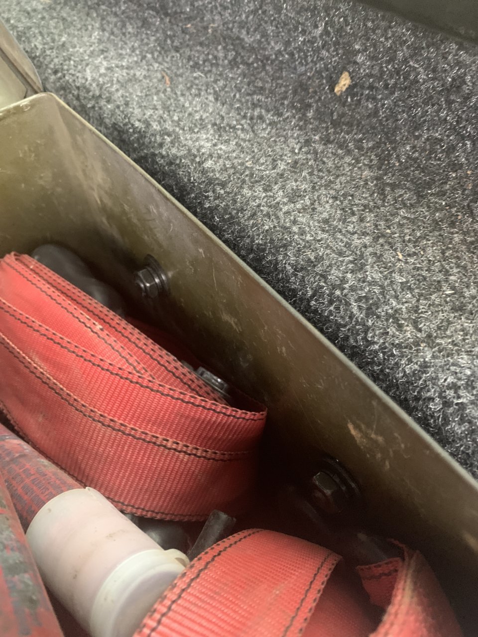

    Nice! I have 2 ammo cans that I plan to mount the same way. What hardware did you use?

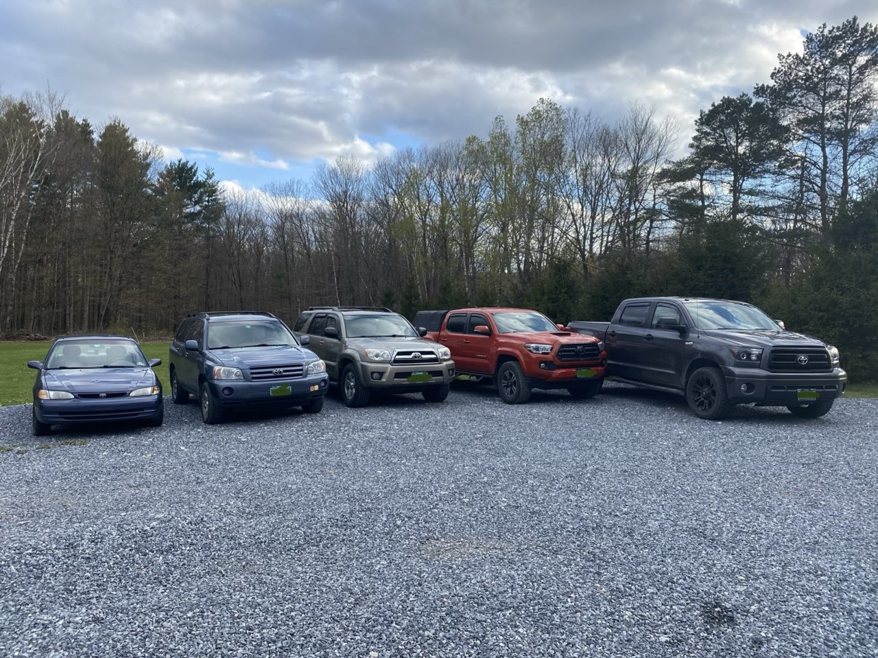

    Got home from work and decided to take a family photo:)F24DBD9E-41A3-41EB-BD52-1A9135D032DB.jpg

    oh this is nice. I need to do that, links for the mount and the jerrycan ?
    did you drill your bed ? thx

    It’s the Wavian heavy duty holder. Yes, I drilled two holes for river nuts and 10-24 screws. There is a side bracket that locks into the deck rail.

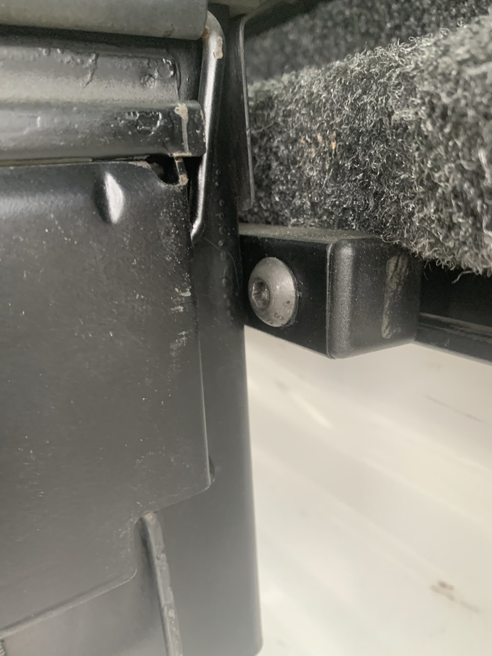

    I ordered T nuts through Amazon, and then picked up the hardware from Ace. I used 1” square steel to make a spacer so the topper lip didn’t interfere with the can lid. I mounted the can to the square tubing, with about 1.5” sticking out past the can on each end, then drilled that and ran my bolts through the tubing and into the T nuts.
