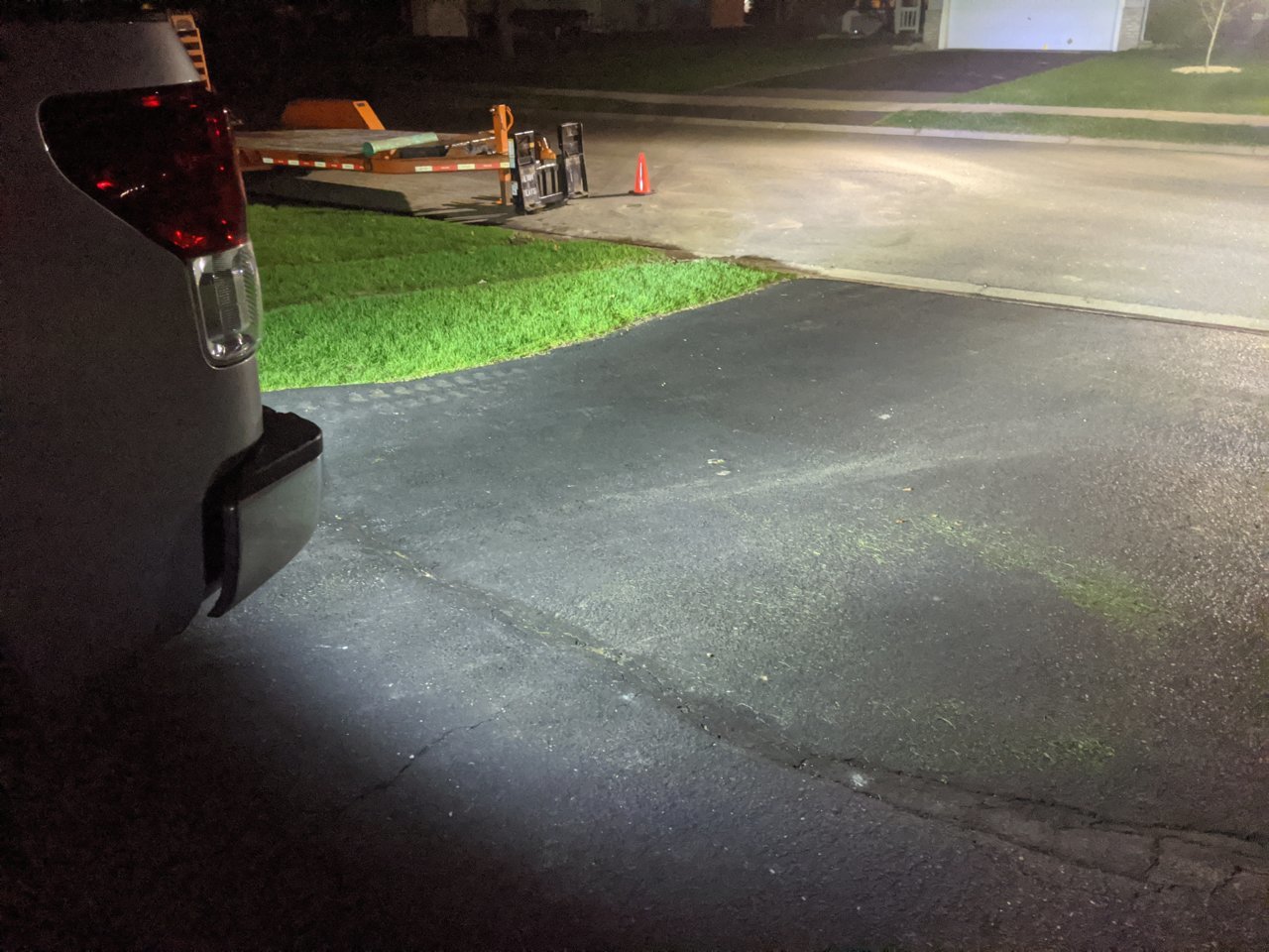

    Spent about 5 hrs yesterday going full send. Finally committed to cutting the bumper. Relay and 3 pole switch used for manual on /off / reverse.

    Nice work, I feel the 3 way switch is the only way to tie aux rear lights in. Nice work, looks good.

    Where'd you choose to run the harness into the cab?

    I followed my DIY pop n lock wiring and rear cam. Under the passenger side, pulled thru a grommet under the rear seats, into the kick plates up to the A pillar. Relay is mounted by the blower fan.

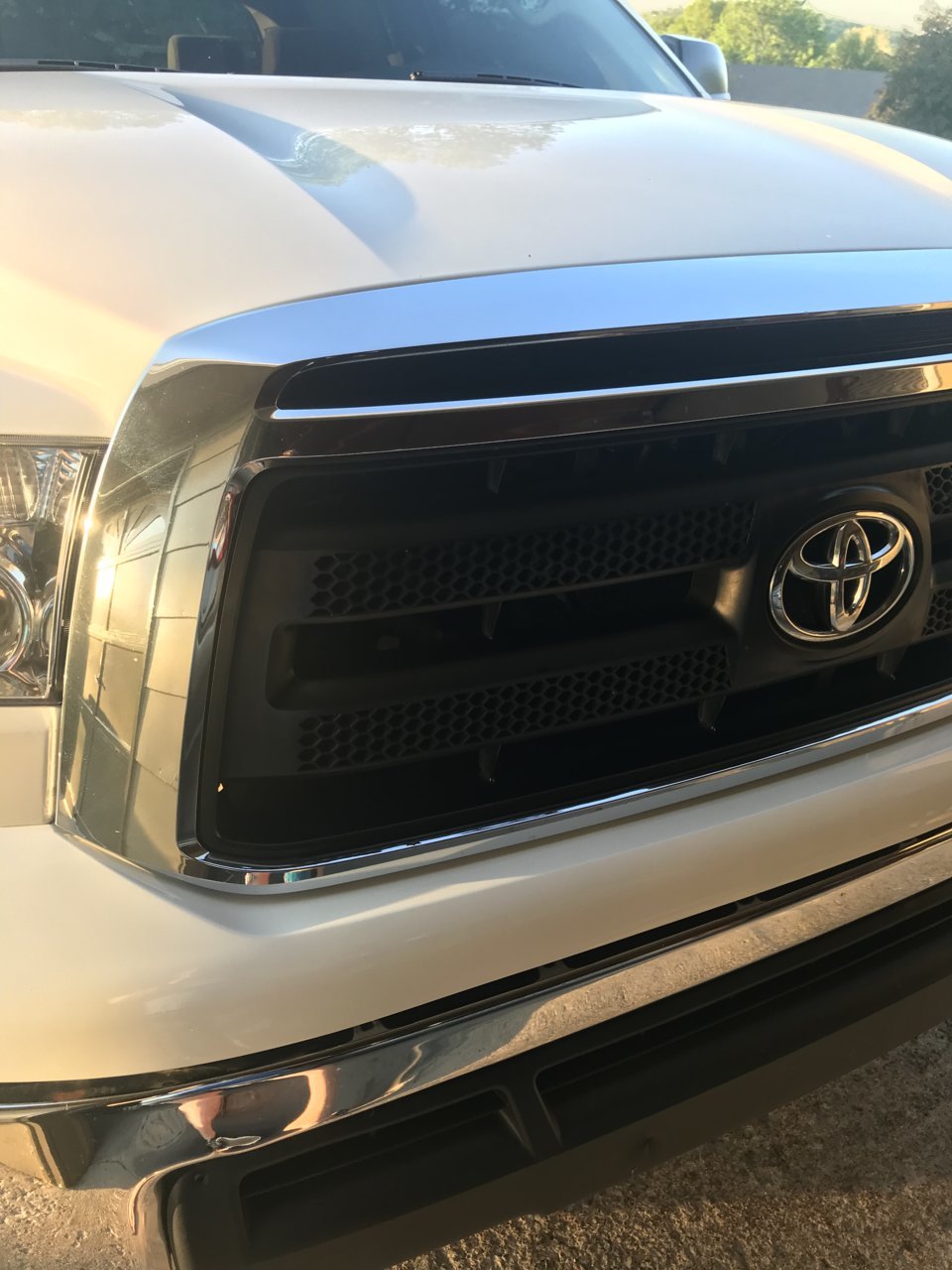

    So kind of random question but I ordered a new grill and was wondering what you guys thank I could get for my old one (no bubbling) 9F8301A7-6933-4523-B9A6-51617822FA29.jpgF7376E33-831E-4528-BC1F-D9469C98D114.jpg
    BigSkyTaco likes this.

    I would think you could get a Benjamin
    Mountun Goat likes this.

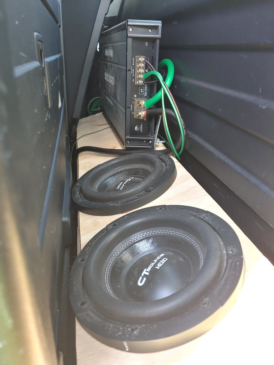

    Finally got my subs, amp, and door speakers installed. I didn't really take any pictures while working, because I just wanted to get it done. I will say though, doing from a DC to a crew max is awesome with all of the extra room. The rear seats still fully recline, however it's extremely tight.
    Subs are too beefy to mount them any other way, they have a mounting depth of 6.5" and the magnets ars almost as wide as the sub!
    The only real pain was pulling out the rear seats, as the bolts go through the floor and are exposed to outside elements. If you have any rust, it's a PITA. Especially trying to get any level of torque with a fractured arm :duh:.
    The door speakers were kinda dumb too, however thankfully I had enough wood to make my own brackets.

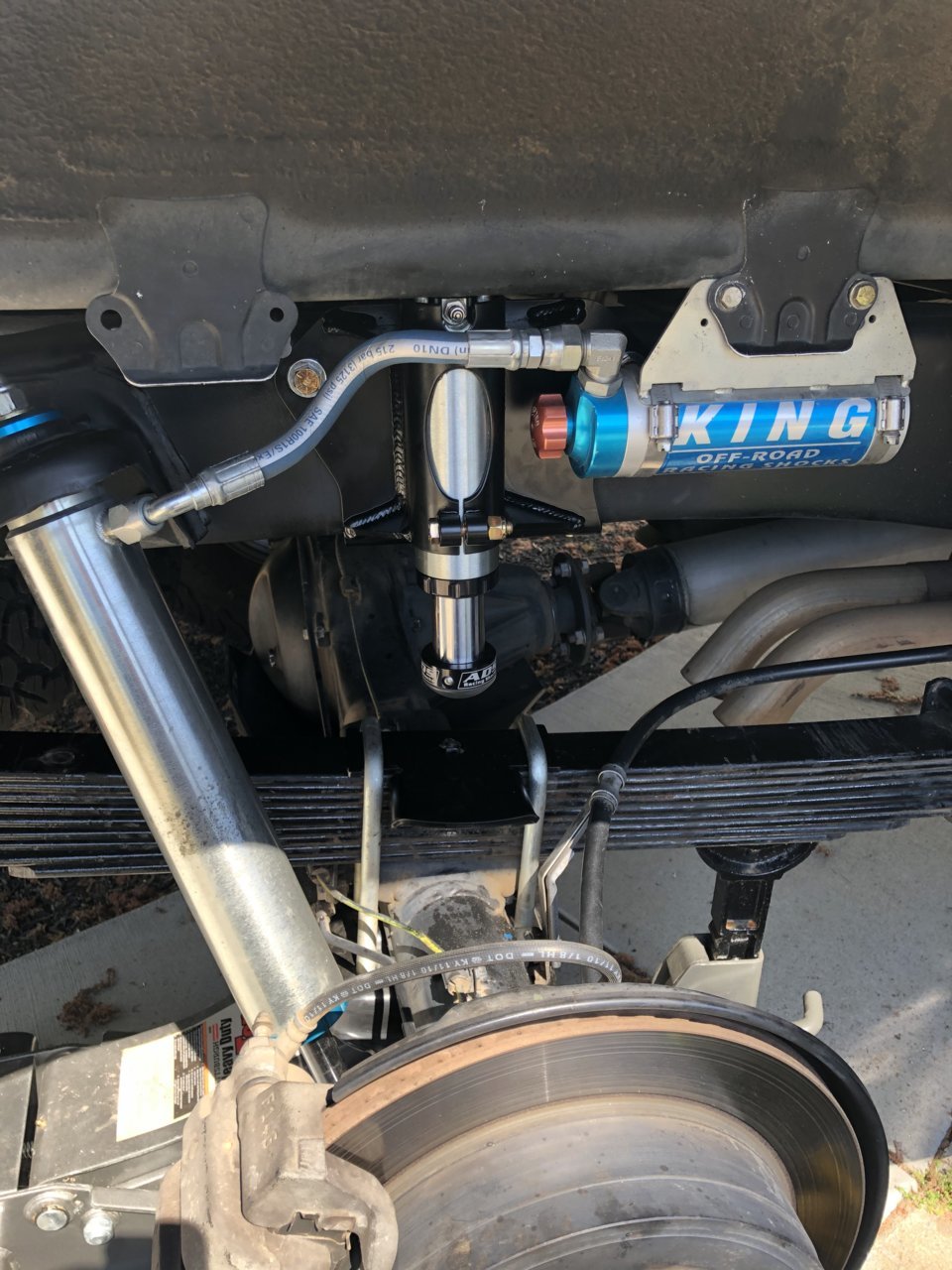

    ADS bumps installed today! Can’t wait to test them out. Bypasses coming soon!

    which bypasses you going with ?

    Not sure man, It’s a toss up Between ADS and the king 3.0s. I know ads has their shit dialed for the tundra and a lot cheaper. But love the look of the kings haha

    good choices. I have the ADS and they are nice paired with some Deavers. But yeah can't go wrong with KING blue either.

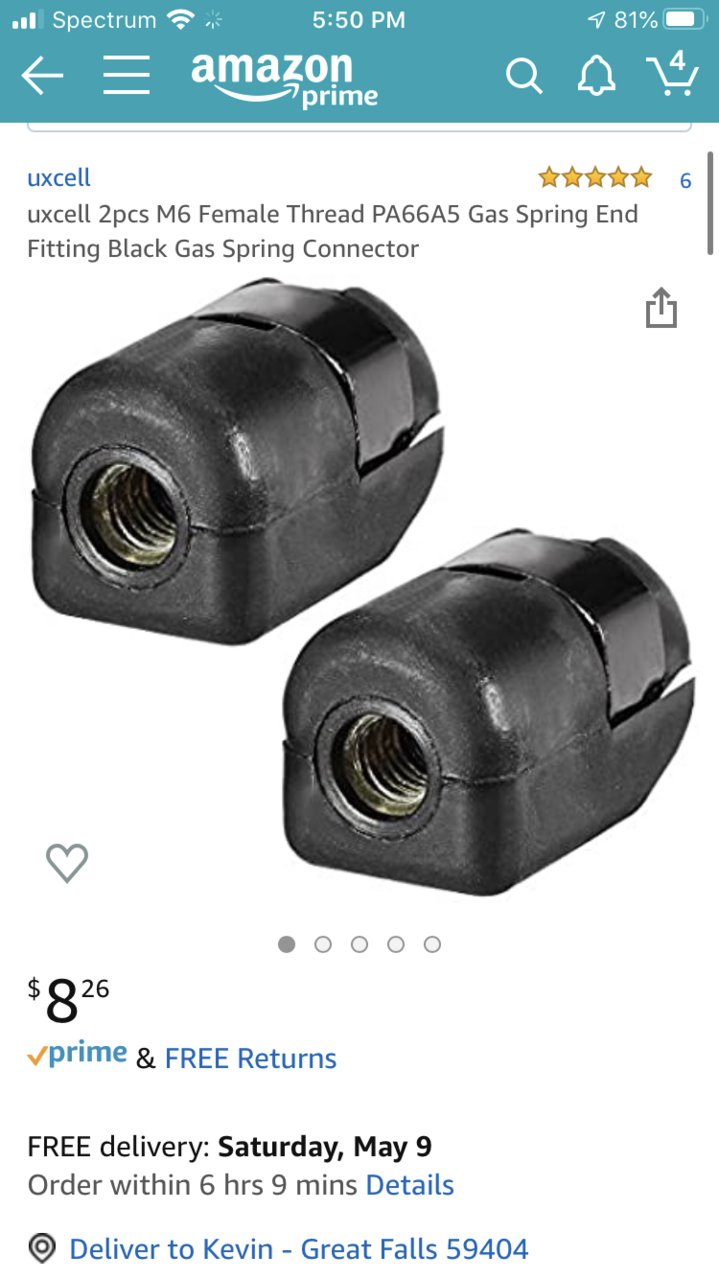

    When I took my tailgate assist strut off to bolt my Decked mounting eye bolts in, I broke it putting it back on. Thankfully.....the top ball socket is threaded on and a standard M6 thread. Repaired it for just over $8 instead of having to buy a whole new strut. Used these guys.

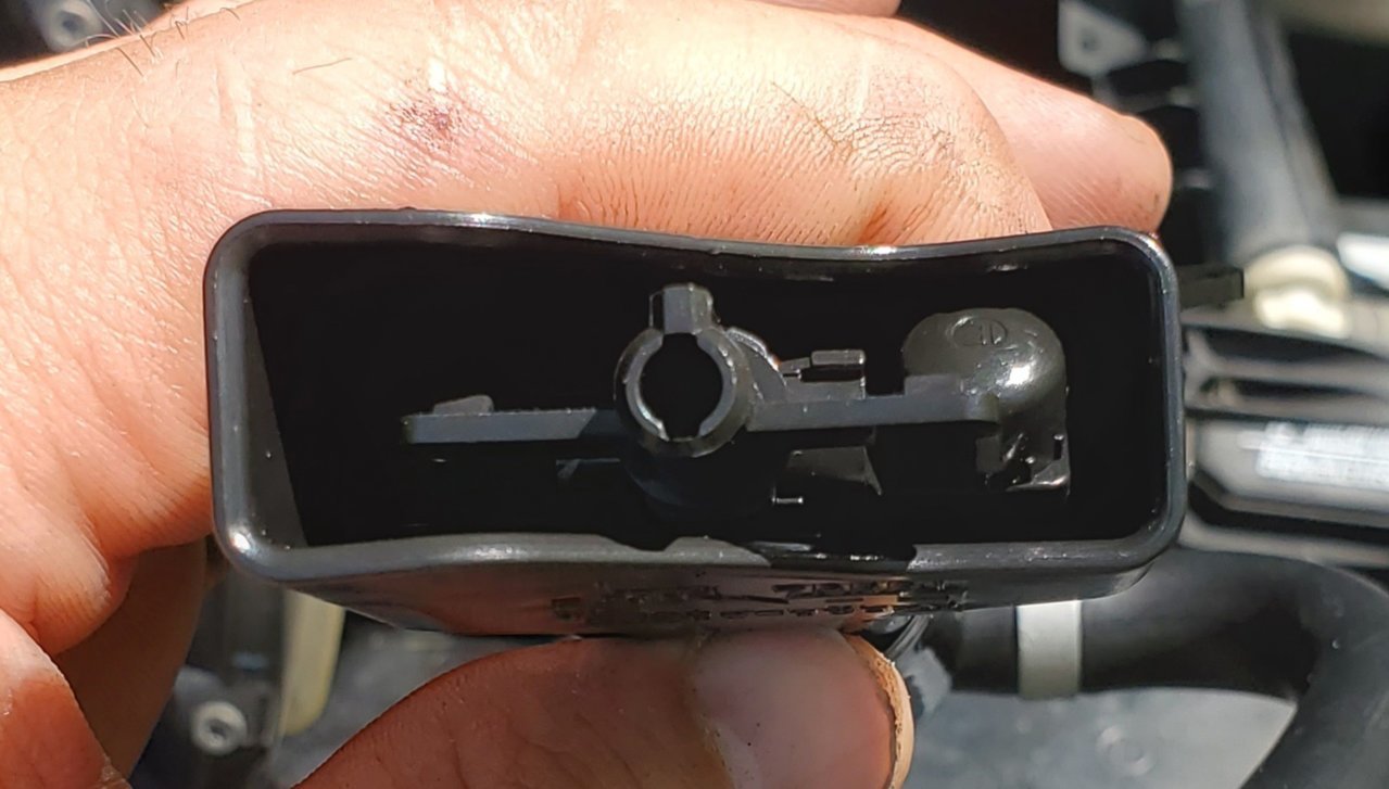

    Not sure if a 2008 sequioa will fit in with you guys, but I poured a little love in on Mom's rig today.
    Installed with new.
