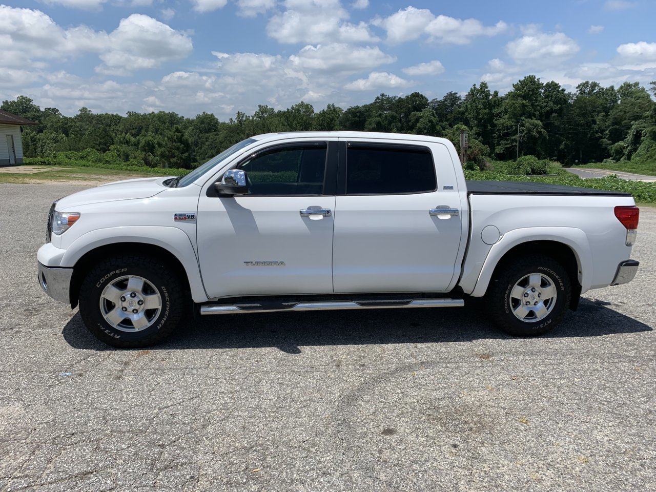

    F9D7FBD2-6E8A-499E-8330-939288041F3C.jpg Got some new shoes today!! 275/70 18 cooper discoverer at3 xlt’s...rides and drives GREAT!!

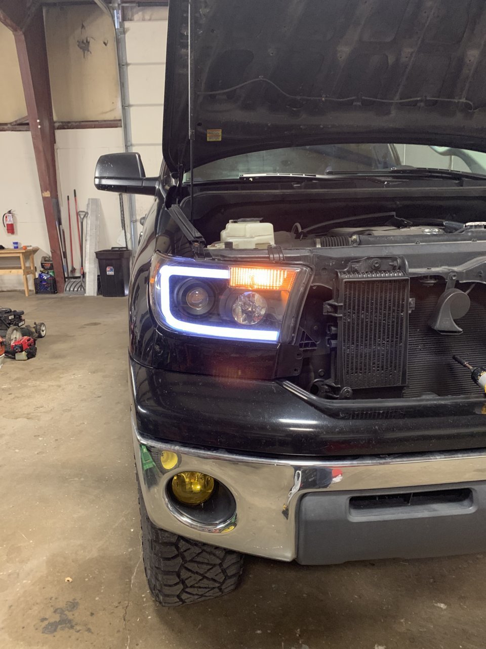

    Ok so update on these lights.
    Bulb already blew. I have led H1s but they don't fit in these headlights. The output sucks like Nate said. Even more frustrating when you had led H1s in stock headlights.
    So what are the brightest H1 flights like the pic since I have to go buy a pair anyway

    crap. i bought those headlights and then a 20 dollar pair of LEDs, their coming in tomorrow

    Had a long drive at night and can't deal with halogen since I've enjoyed my leds.
    Im tempted to buy the led fogs that use the spring clasp.
    Really no way to make my H1 leds fit this headlight assembly without cutting

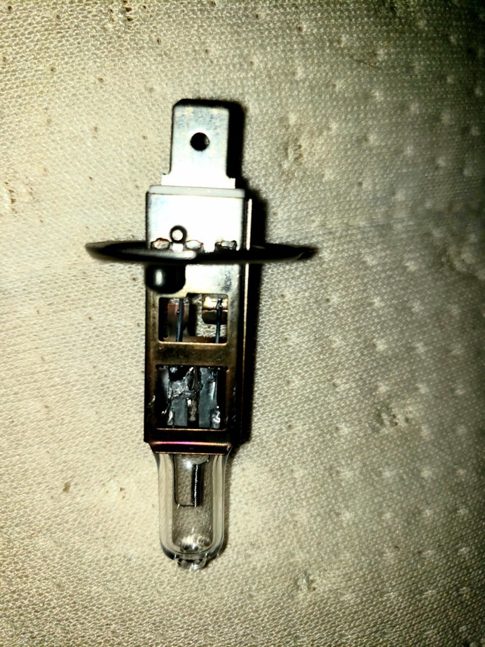

    Attached is the bulb from spyder system that blew already. They are replaceable.
    The problem is the LED you bought and like the ones I have don't fit inside the spyder hole. Only the metal pronged bulb does.
    I can't find any LEDs in that shape.

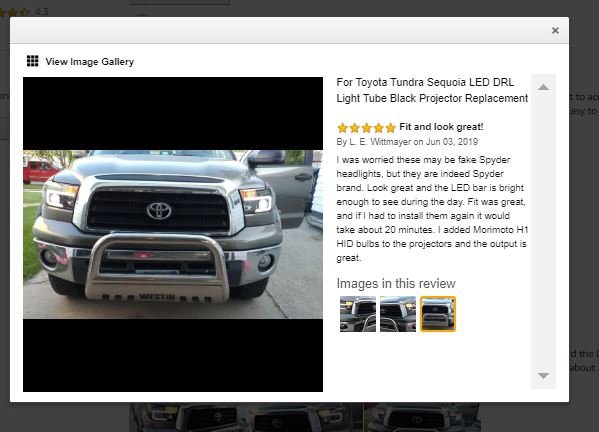

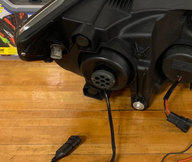

    Here’s a pic from the sale, I looked at our conversation and he mentions “Had to cut the boots on the back for led fans to breathe but haven't had any problems”

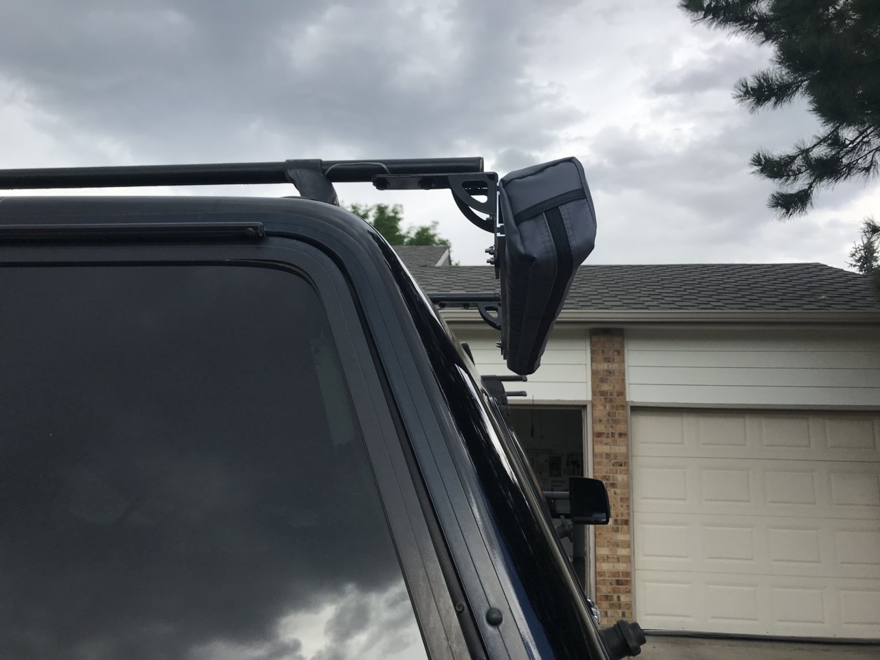

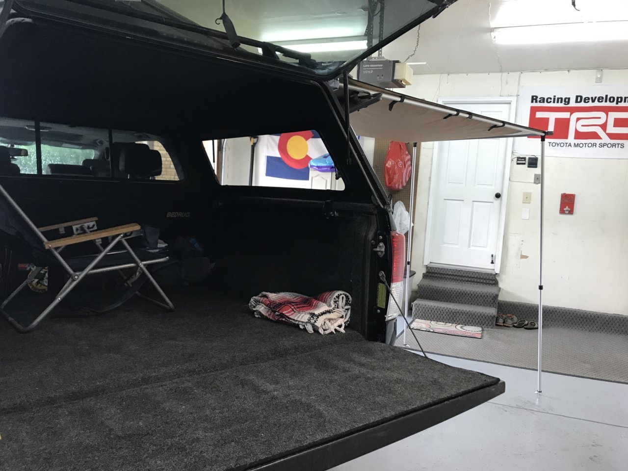

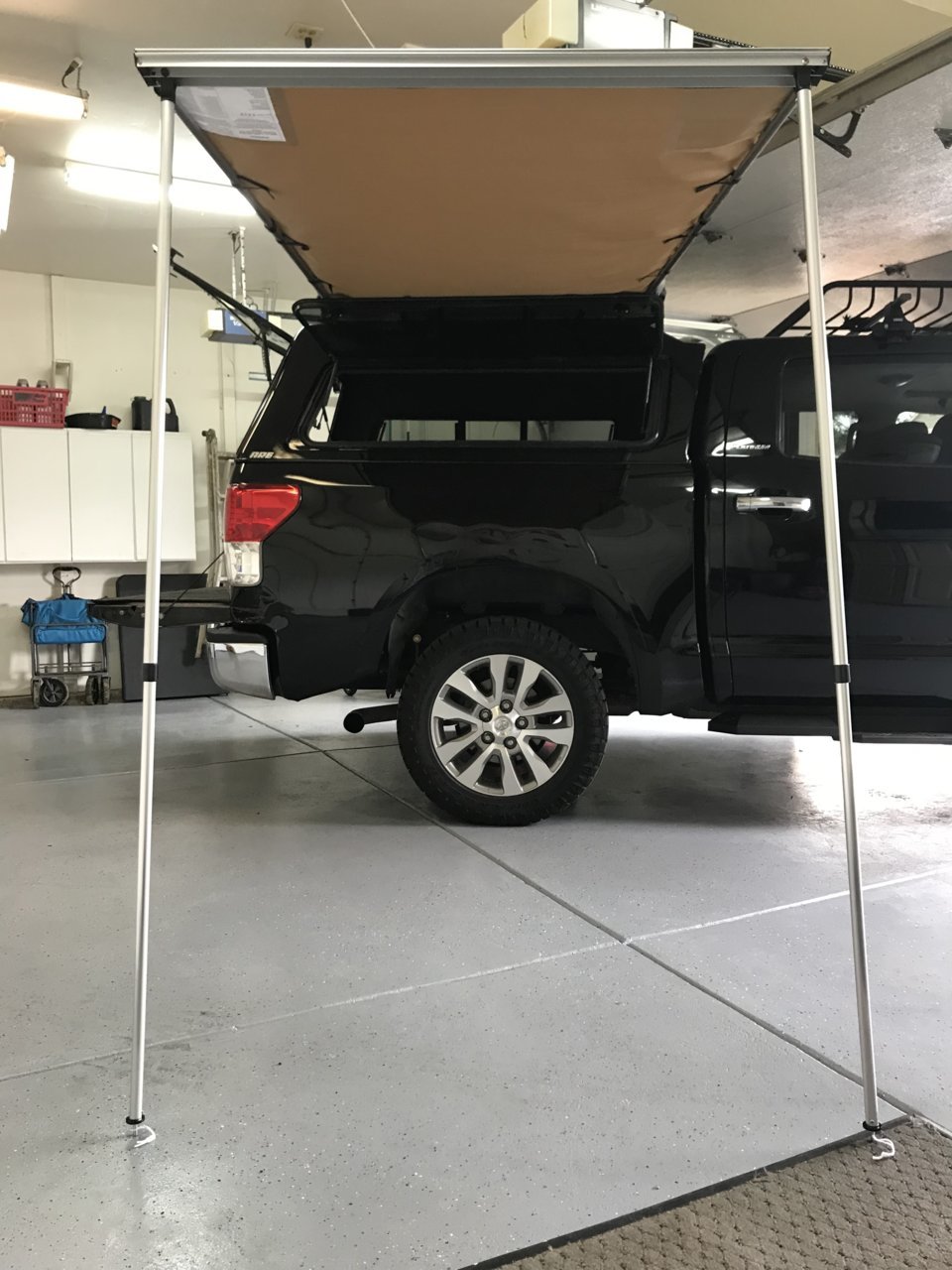

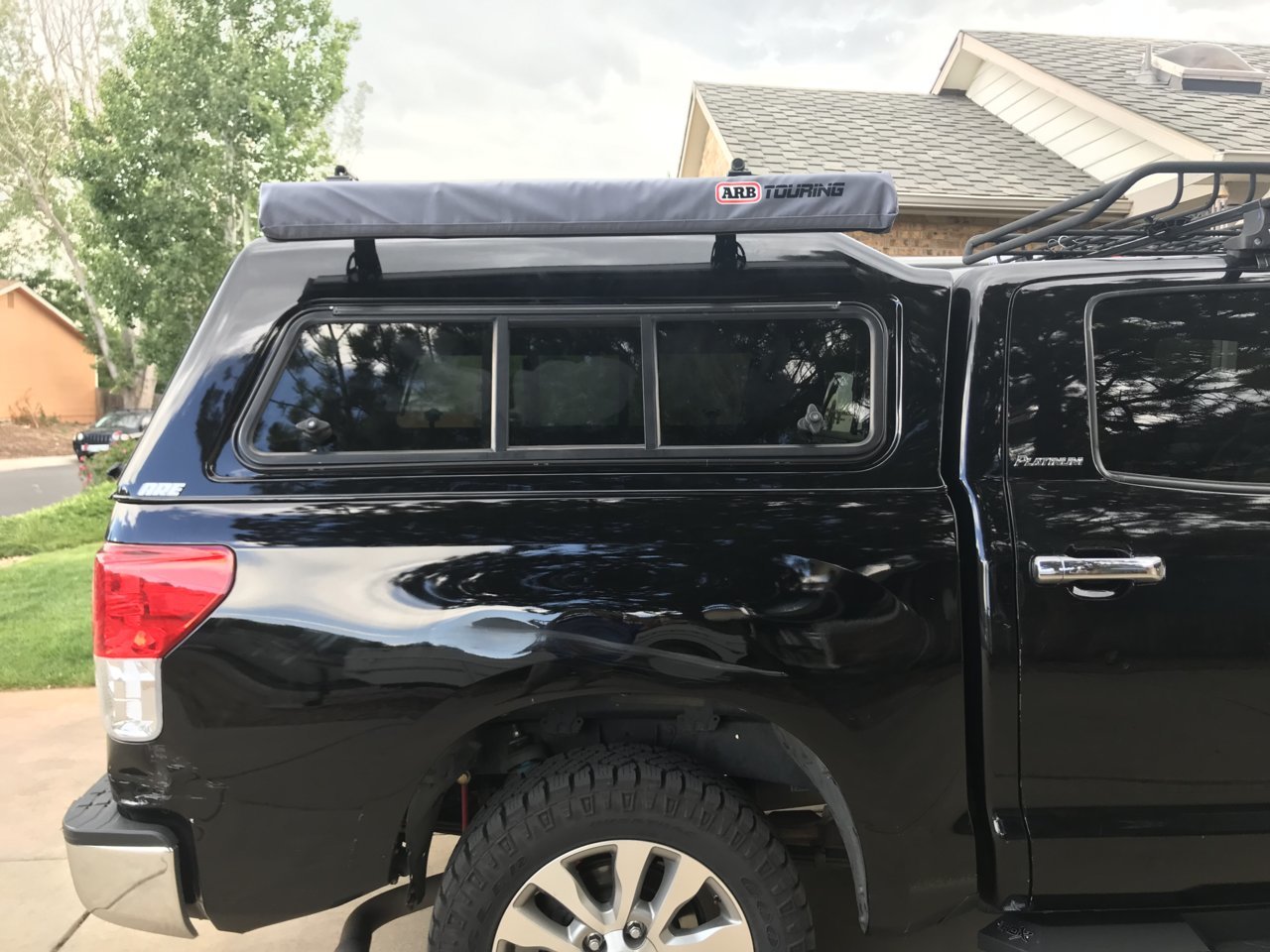

    Got the ARB awning installed

    These should fit with a little boot mod like jrharvey02 showsupload_2019-7-22_9-22-49.jpg

    if you cut a small enough hole in the boot, you should be able to press the bulb in stretching the rubber around the collar of the bulb, effectively just leaving the cooling portion of the led outside the boot. My thought is to plug the led into the harness first and position the boot around the Led in the place you want it, then put the led in. you should be able to fold the boot over to see and latch the bulb in place....ill admit i havent done it on the tundra yet, but ive done it on about 4 or 5 vehicles prior.
