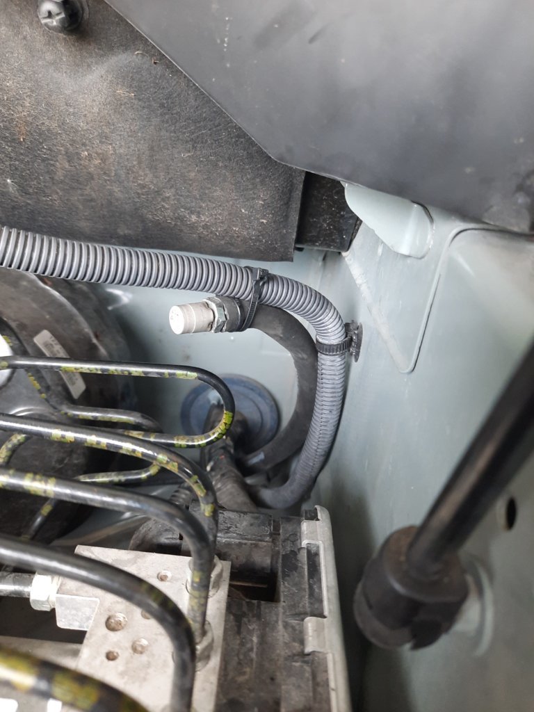

    Washed her yesterday.

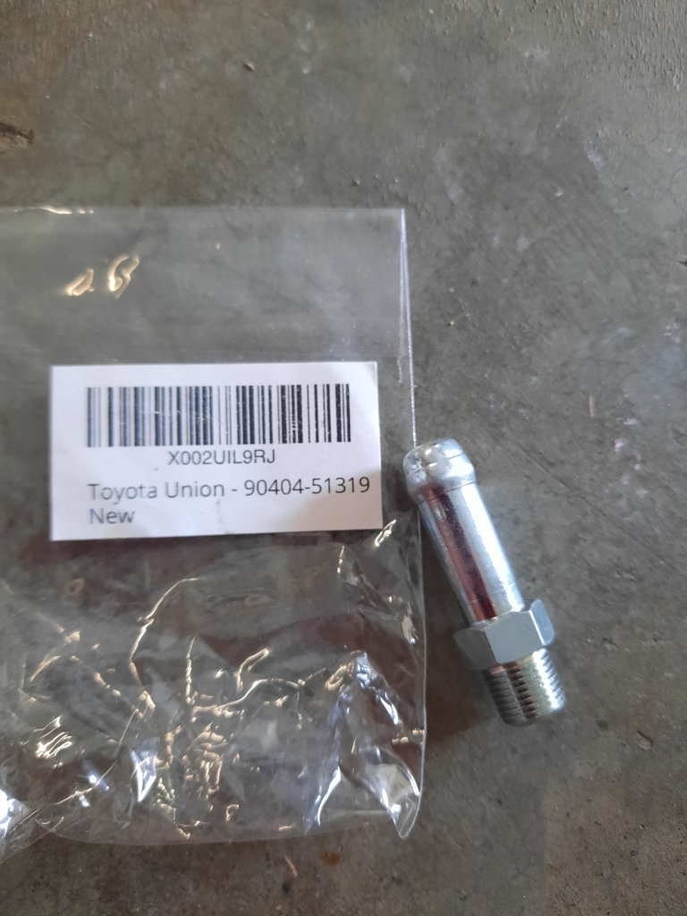

    But FINALLY did the rear differential breather mod.
    Had to rush since I'm doing it with the kids at home out of school, but at least did it.
    Bought the union off Amazon a while back I think. The hose was left over from when I did the same mod for my tundra.

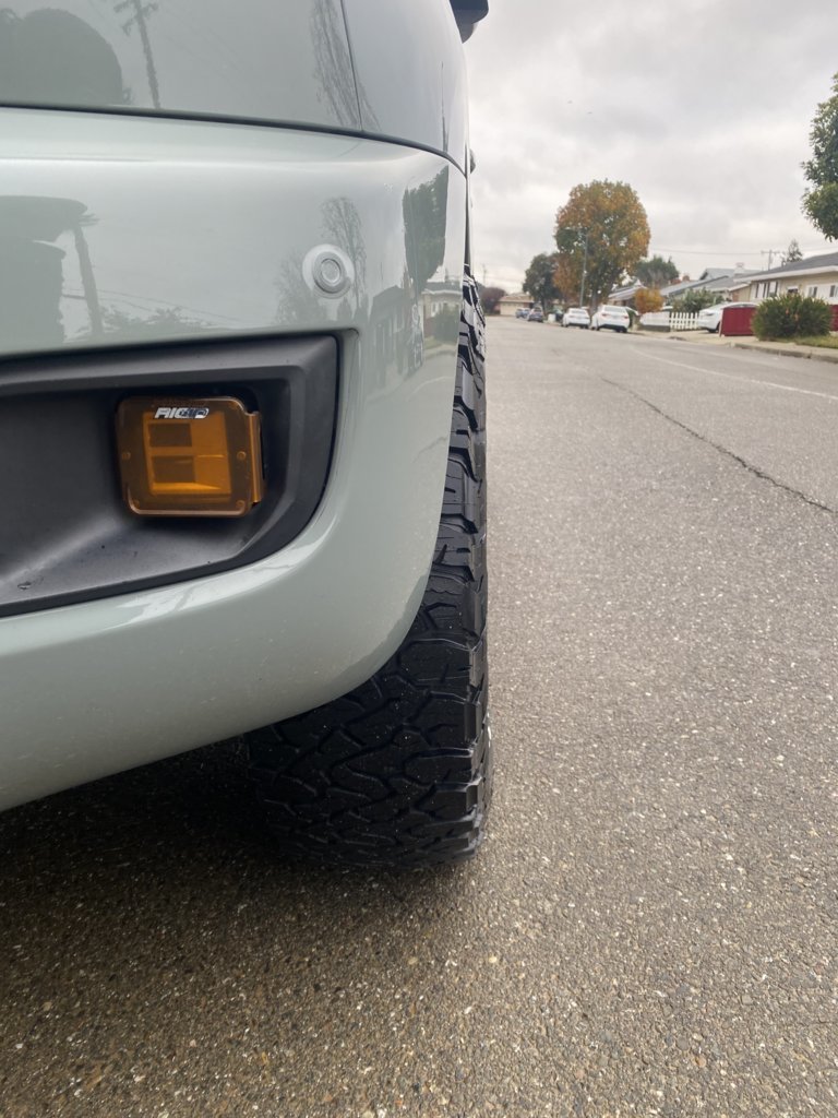

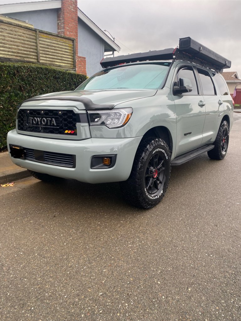

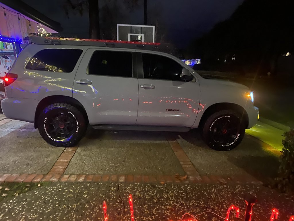

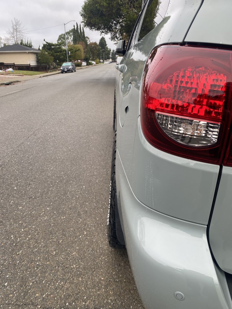

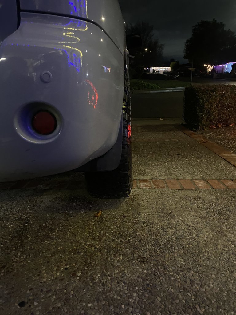

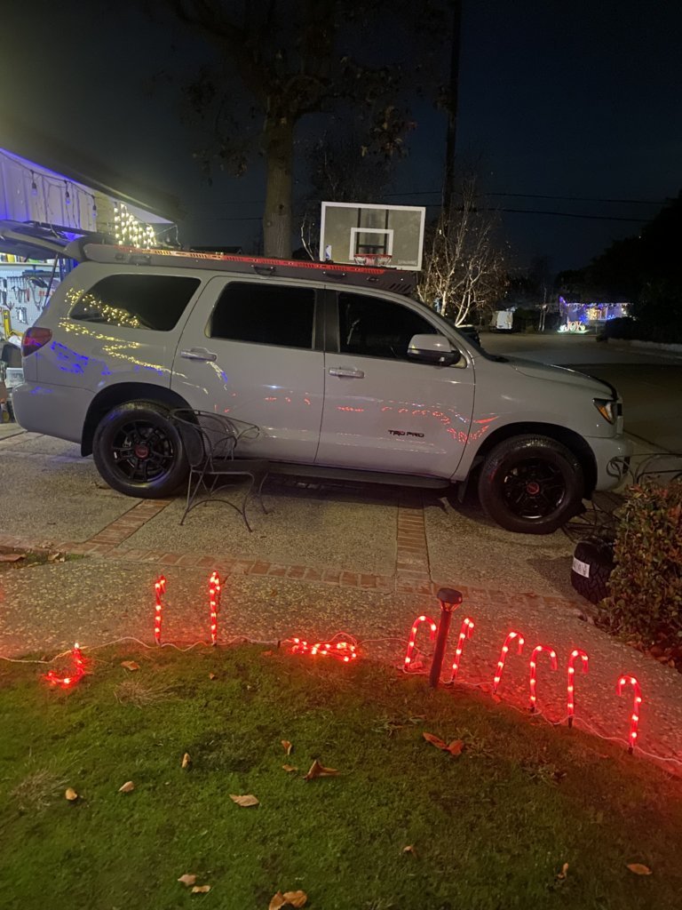

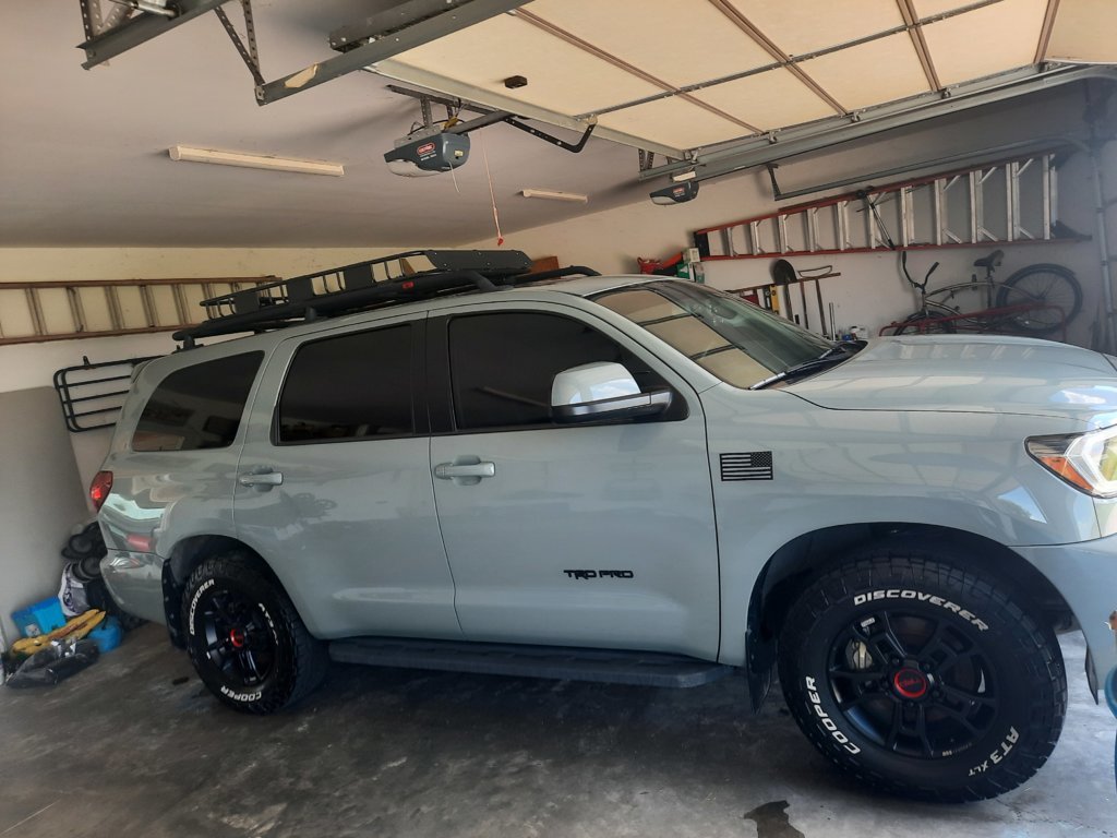

    Removed cargo boxes, gave Bertha a wash, lifted and fitted with some new shoes
    Poke anyone?

    Body or suspension lift?

    Suspension Sorry wasn’t clear.
    - Westcott Designs collar lift about 1.5/1 inch lift front/rear
    - BFG ko3 (295x70x18) about 2inch taller than stock tires
    - 1.5in spidertraxx wheel spacers

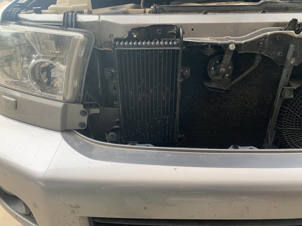

    Installed the Tundra transmission cooler . Smooth install , everything just bolts right up.A1274D10-F8B4-43A1-B023-2676CFD43045.jpg

    It’s for pulling an rv camper . I have the tow package , but that didn’t include the transmission cooler on 2012 Sequoias , which I think is wild. so parts :
    Tundra cooler - 32910-0c010 ( get it used on ebay)for $250 vs $600 new .& make sure it has the plastic surrounding.
    Thermostat - 32970-34030
    Inlet hose -32941-0c030
    Outlet hose 32942-0c040
    Hard line - 32907-0c020
    Hose clamps x8 -90466-16004
    Flange bolts x2 - 90080-10400
    Lastly for the hardline to the cooler I just picked up a couple feet of 3/4 hose from autozone ……

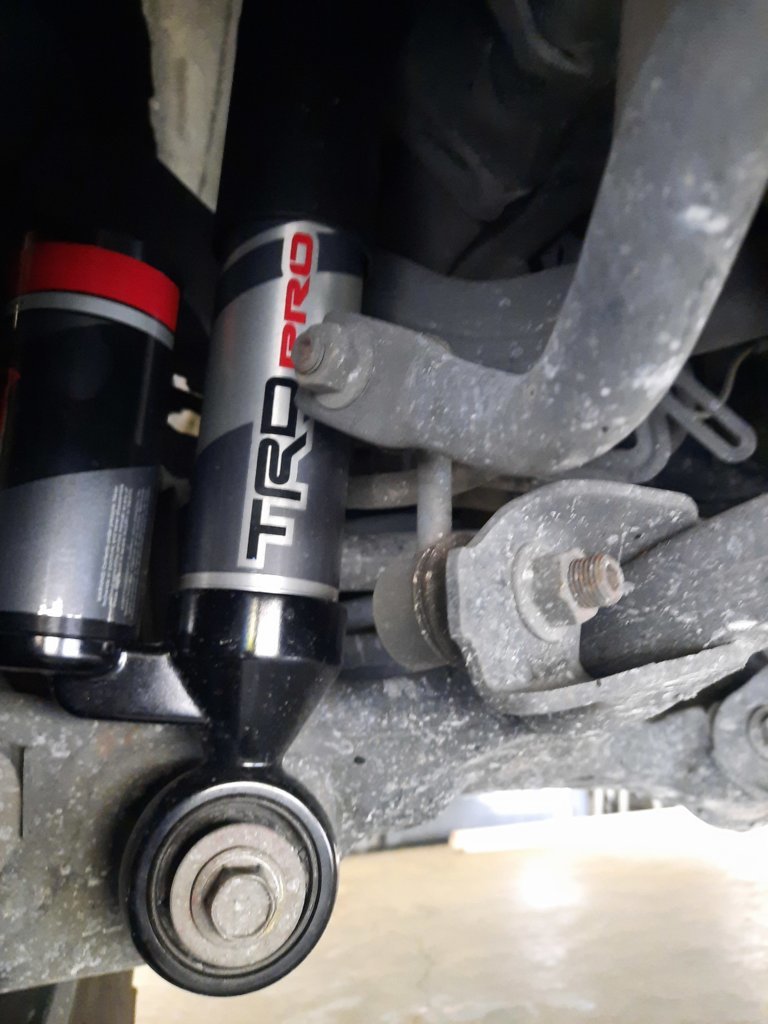

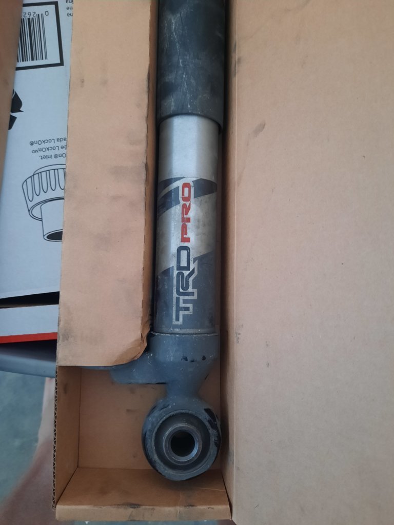

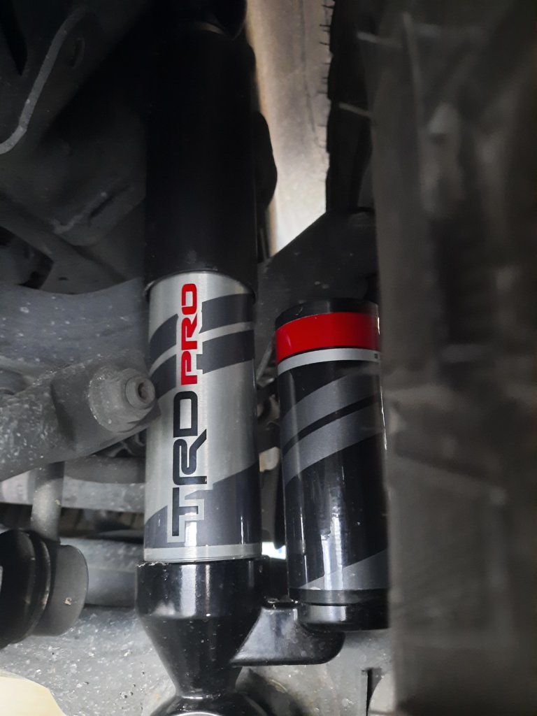

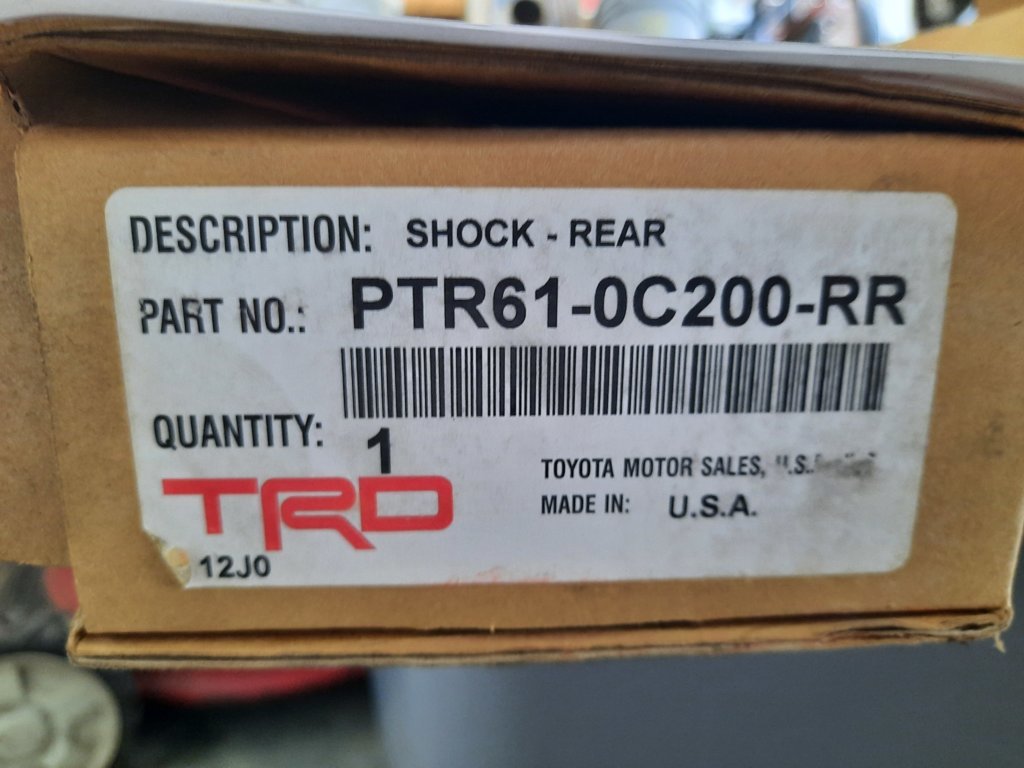

    Long story short, I FINALLY got my rear shocks in and replaced (under extended warranty). They let me keep originals since it wasn't factory warranty and didn't need to send back cores. It's been a pain to find, but they got them.
    Both right and left rears are the same part number

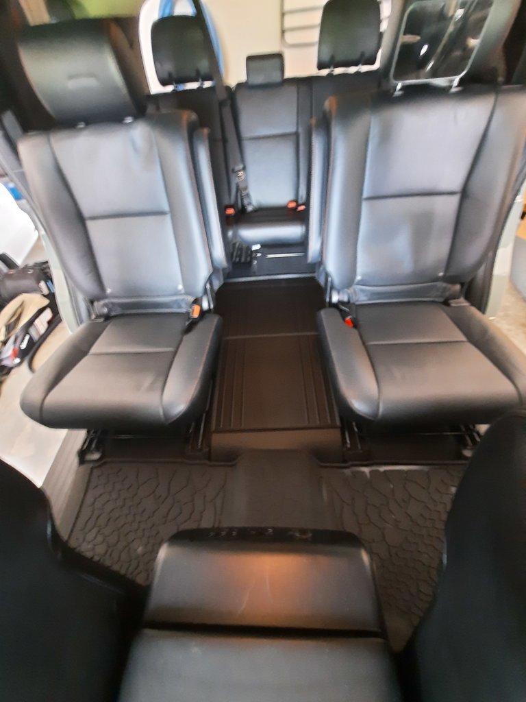

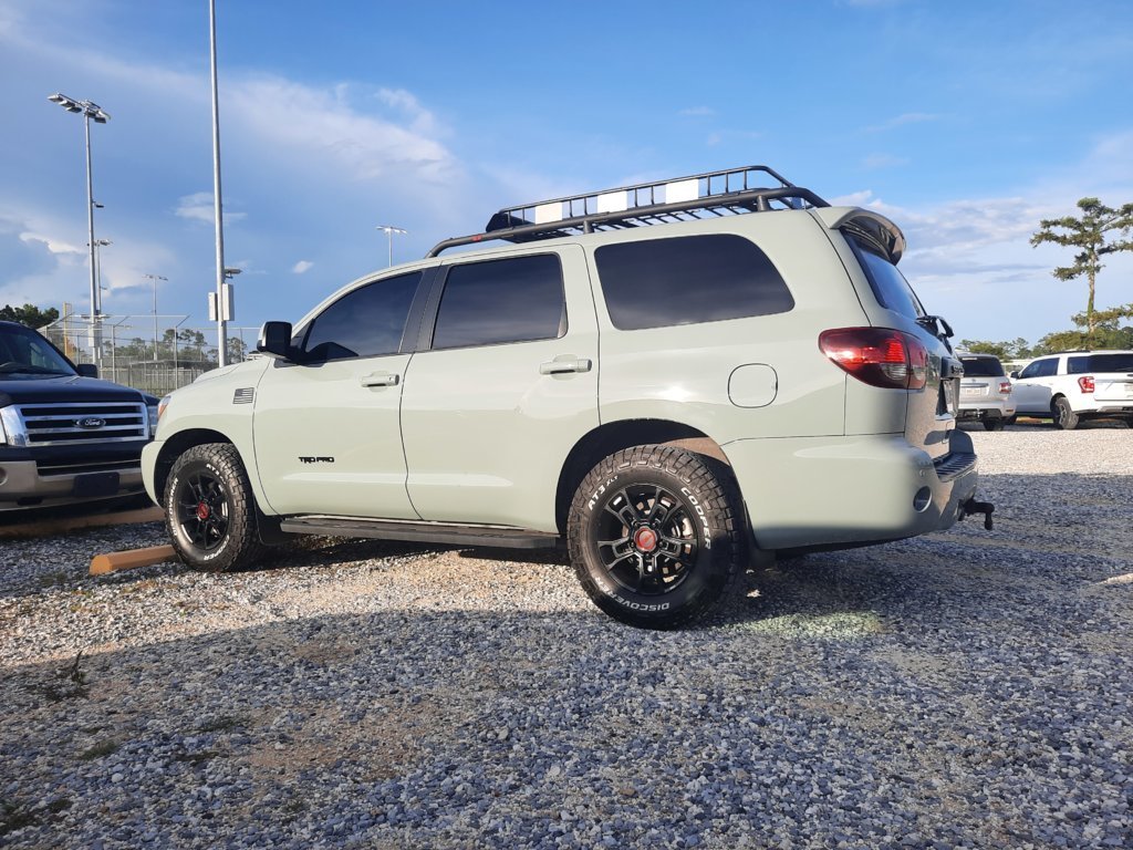

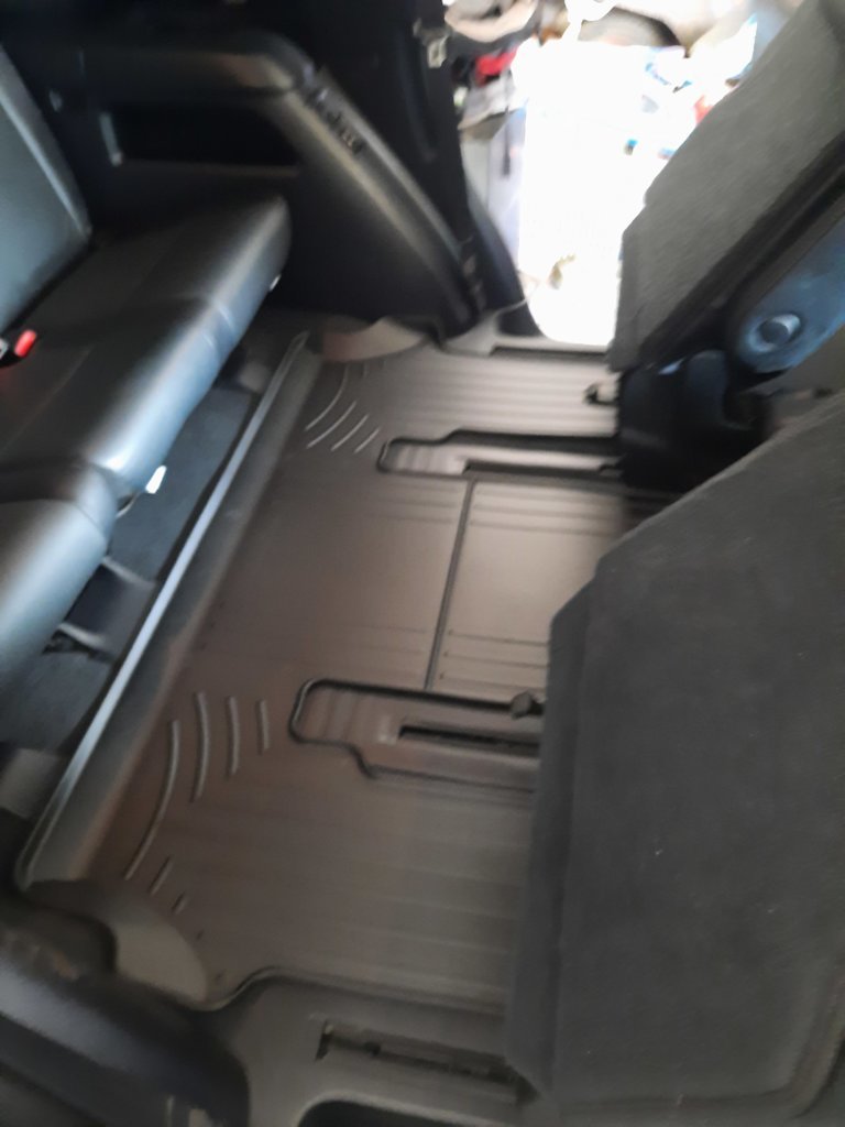

    Ball season wrapped up, so I finally had time to wash her. Got a roof rack in from bezo's mart to help bring stuff to functions. With 5 kids, there's not much room in the back for canopies, chairs, ice chests, etc. Plus it'll be helpful for other stuff here and there too without having to use the hitch carrier.
    Also got in, after waiting 4 years to order, the weathertech rear liner that'll cover the 3rd row as well as go under the 2 middle seats and cover down the middle between the 2 middle seats. The part in the middle was always just exposed carpets making it fun with kids and cleats. Both of these should be helpful for my family and I.

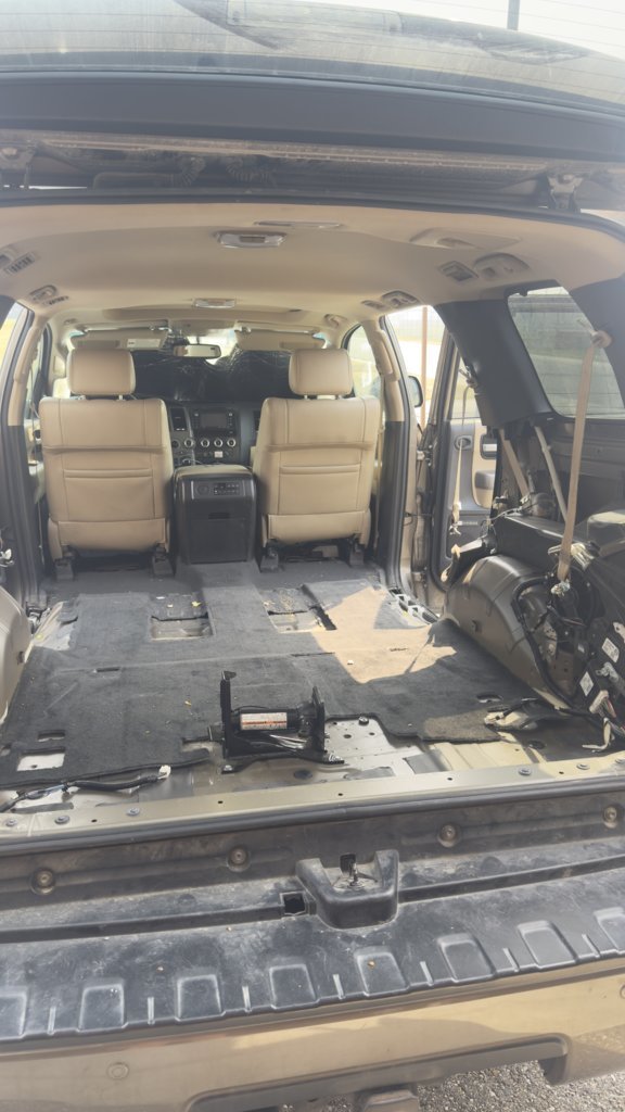

    Started with trying to fix the rear blower motor and then found dog food under the carpet in the back (I don’t own a dog) then then transitioned into me disassembling the interior and vacuuming out every corner of the car including under the carpet. Not included in the picture but I currently have drivers seats and center console removed too.

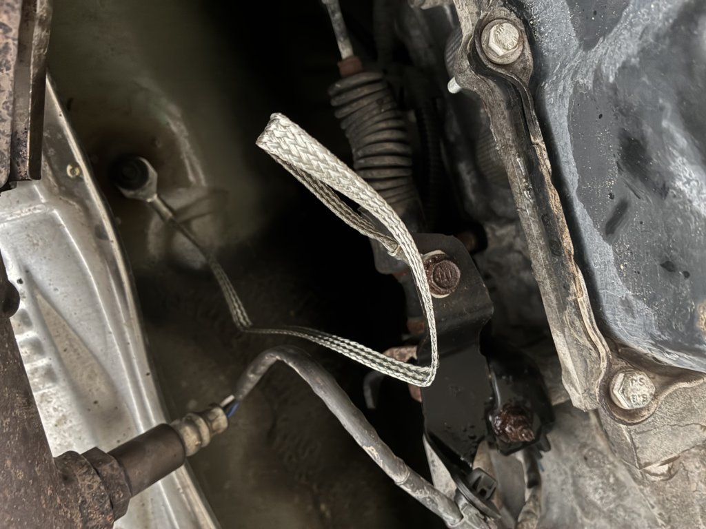

    After a cold rainy night up in the mountains I started up the Sequoia and my 4 lo light was blinking and It wouldn’t shift into 4wd . Drove fine other than that . 30 mins later the light stopped blinking & I was able to retain 4wd function like nothing ever happened
    . My first worry was the transfer case actuator $ 1,600 & you have to drop the xfer case and open it up to replace it - not something I wanted to do in my driveway in Phoenix in July.
    When I crawled under to take a look at the vent tube coming off of the actuator ( apparently these tend to break off and let water in ). I found my transmission ground wire green , frayed and decayed super suspect and hopefully that was the cause of the intermittent problem.

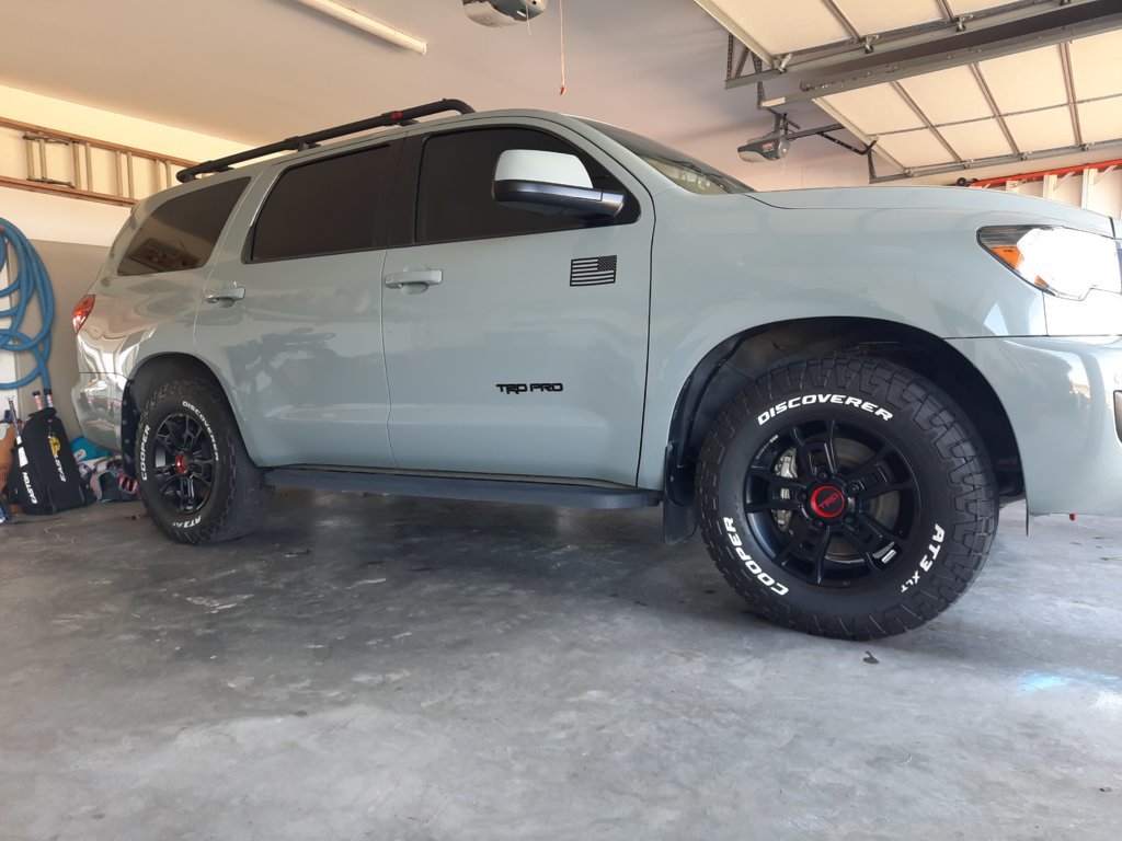

    The lift and alignment was completed last week.
    Lets try some wheels too:
