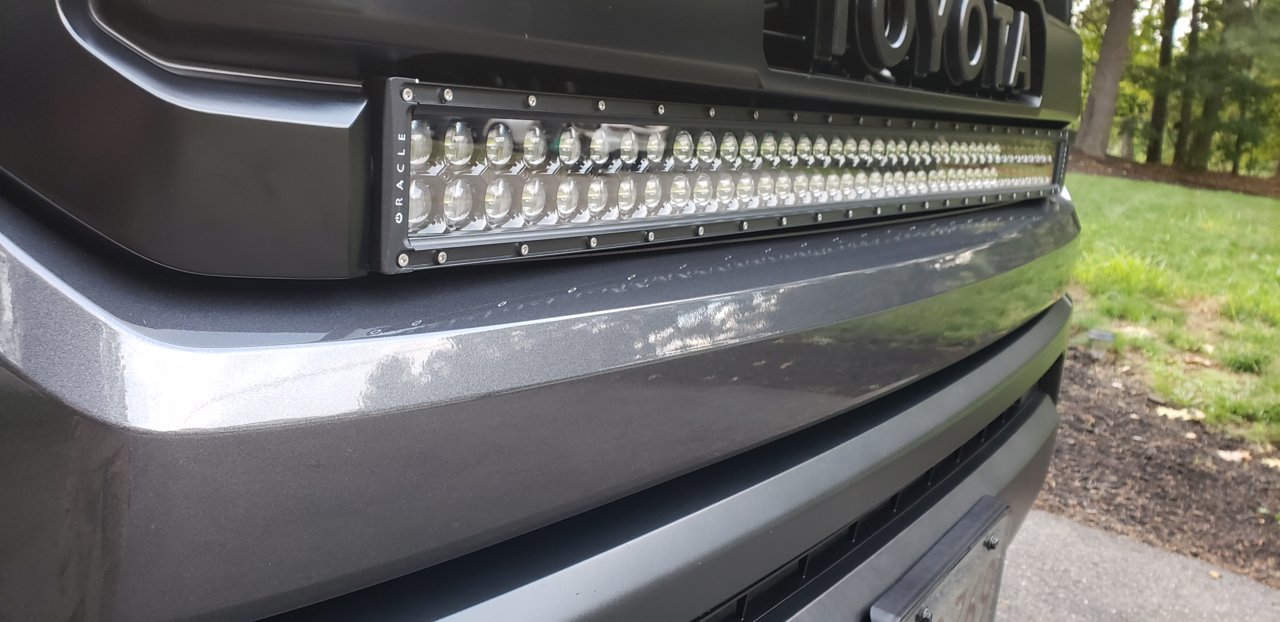

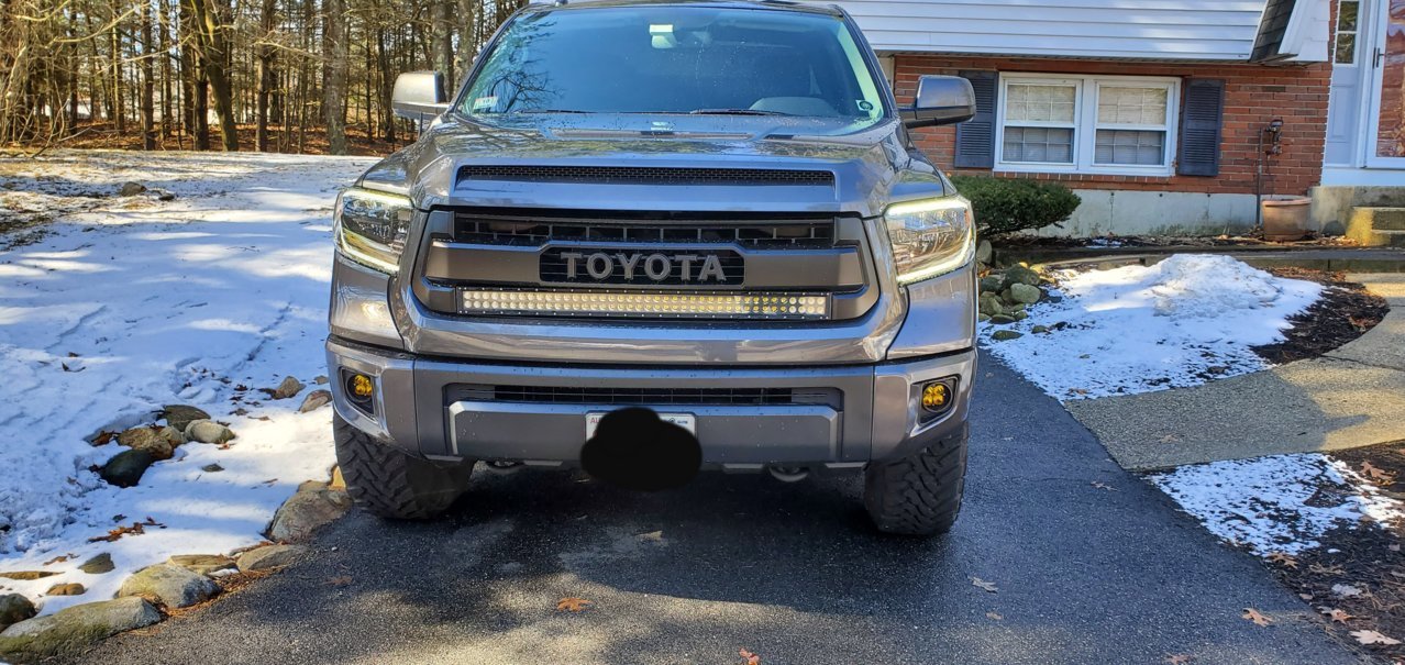

    Just the mesh with a dremmel to open the space up. You don't have to hack up the grill

    Any possible chance I can get some close up pics? Much appreciated
  3. Aug 22, 2019 at 11:18 AM
    50,813
    Was thinking aluminum angle bar stock?
    How much did you bring out? 3 in?

    Oracle was the old light bar. New light bar is a RC hilites.

    Nice! What's that? A 40"?

    Just about 3 maybe a little shy. You can sit the light bar in the grill and build backwards. Also some of the nose might need trimming depending on your light bar size. When you put the bar in you will see what I'm talking about.

    37 inchinch the brackets it's a 40

    One more question, is that light bar resting on that plastic grill?

    Yes sir. When you take the grill on and off you have to line the light bar up then slide the nose on around it.

    This is badass. I feel if you mounted it up top the emblem you’d get better ditch lighting. Do it so I can see what it looks like haha

    I wanted to do that originally but the bump around the Toyota emblem would have needed some serious surgery to get the light bar to sit in there hahah.
