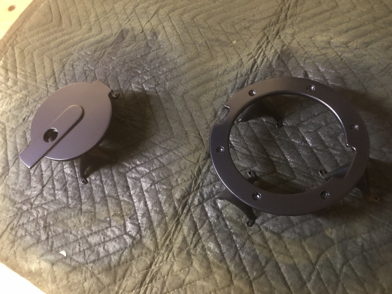

    More color match goin down. 622D6E41-94FA-4C8A-9A98-470F76B8D88B.jpg7A4781DC-997F-4DDB-8631-2290DC33B0CF.jpg

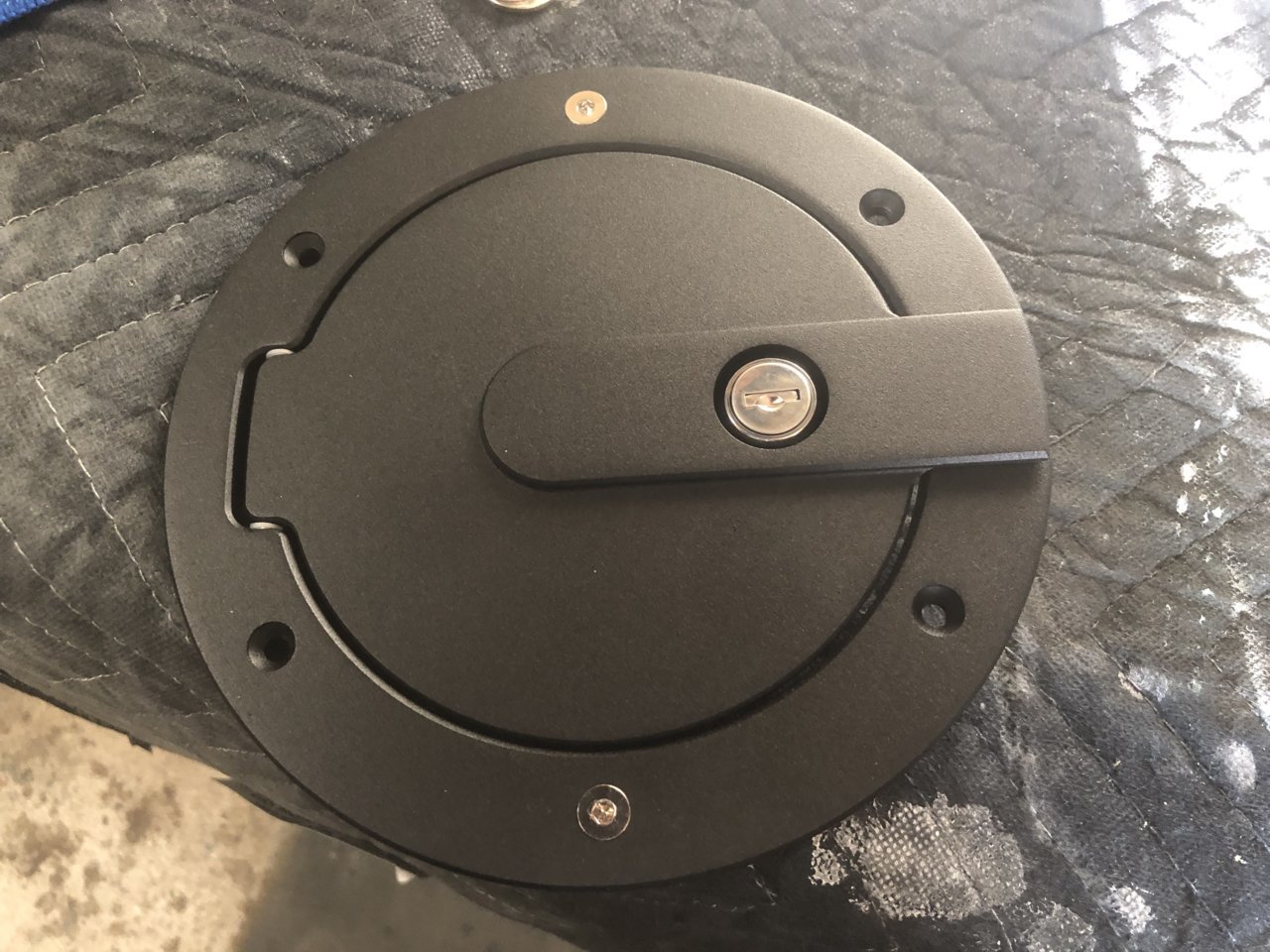

    Installed the handle and cleaned up the beast. 6084A4BB-7CF4-4111-B56B-0DF4549BA9CC.jpg

    Automotive touchup?
    I keep saying I'll but a full kit from them and then chicken out. I need to just do it and try a small part. I think its the sanding that scares me. Sandpaper on paint doesnt seem right to me but I know its necessary. I assume adhesion promoter is a must for these plastic parts? And do you use a 2k clear?
    CCLJ03 likes this.
  9. May 24, 2019 at 10:28 PM
    BlueRibbon4x4
    BlueRibbon4x4 Let’s color match it
    Aug 16, 2018
    #18204
    3,400
    Geno
    2015 Blue Ribbon 4x4
    Yes Automotive Touchup. Yes adhesion promoter. Yes 2k clear. I don’t sand between paint and clear. I sand after primer, then paint, then clear. Wet sand with 1500 grit then 2000 grit. Polish and wax.
    Plenty of people will have other opinions and techniques. I’m not opposed to learning more.
    Pudge[QUOTED] and Watt maker like this.
  10. May 24, 2019 at 10:33 PM
    BlueRibbon4x4
    Aug 16, 2018
    #18204
    3,400
    Geno
    Also, the first time you polish after wet sand, and see the results, you will be comfortable.

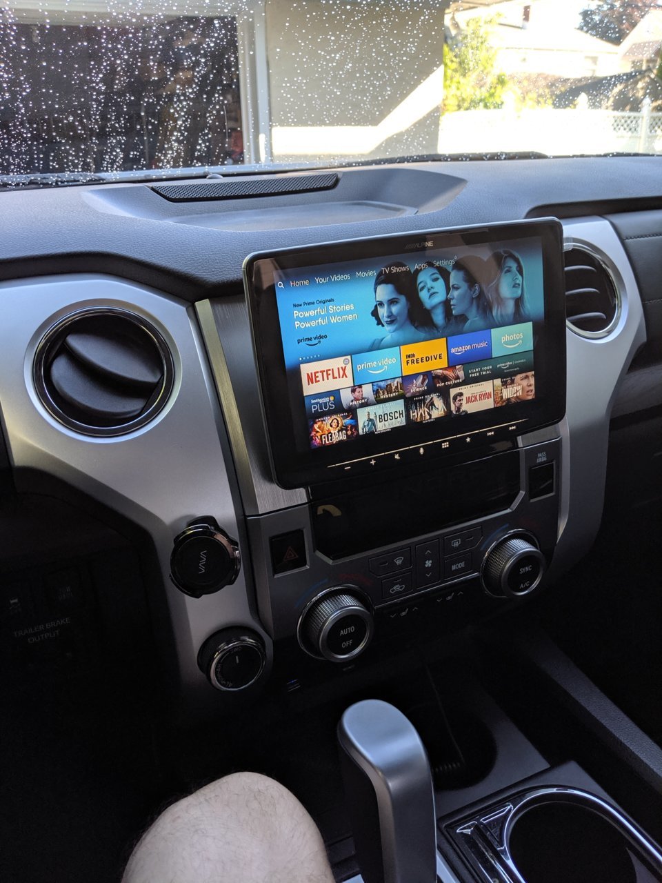

    Installed a Alpine Halo9 kit from tech12volts. After a couple of calls with James Randy, it was an easy install. Now the wife can watch her shows on long rides!

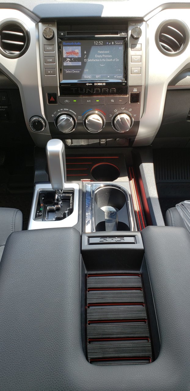

    Put on tufskinz vent cover and inserts. Look better than I thought it would! Probably gonna paint that terrible cup holder tomorrow.20190525_125227.jpg

    The cupholder is an easy job. It pries right off easily. Clean it real good and any plastic or trim paint should work. I didn't scuff mine up but its probably a good idea to do so, or maybe adhesion promoter, it gets dinged easily.
    Also that little chrome piece around shifter is easier than you'd think. That whole surround pries off and there are a few plastic welds that can be cut easily then paint it and use hot glue in place of plastic welds, huge improvement over the blinding chrome when you catch some sun glare.
