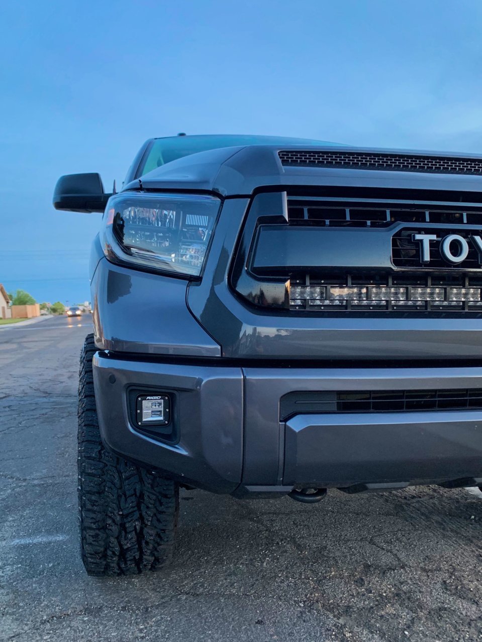

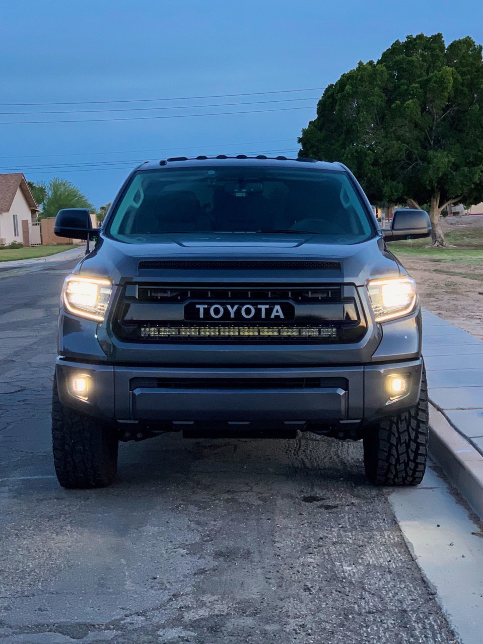

    This week I finished up my install for my 'Bulge Effects' light bar that I made. Now I'm on to real-world testing and hope it holds up to the weather and vibrations.

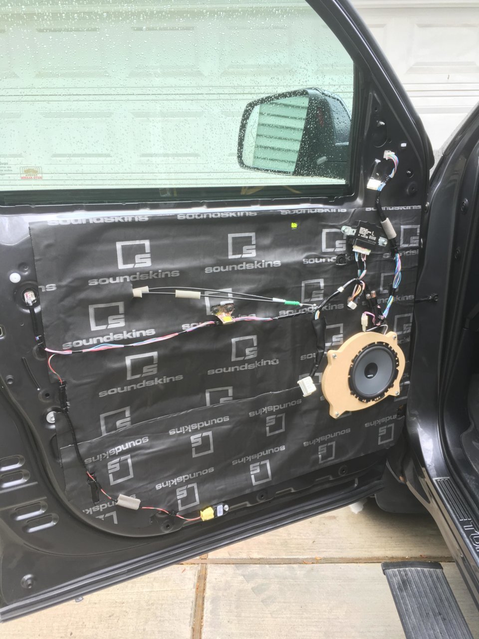

    Installed Tech12Volt speakers in the dash, and drivers door. While I am at it I am sound deadening the whole cab. Using a combo of Kilmat and SoundSkins. Only the back wall and drivers door complete so far, but already can tell a difference.

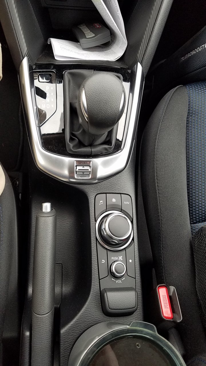

    Truck is in the shop. I have a rental, shitty little yaris. I do like the infotainment controls down near the armrest. Monitor looks weird and out of place though.

    In hind sight for me I would have tagged those wood panels black. I can see my wood brackets through the door panels

    Good tip I still have 3 doors to go, will do it for those and then debate if I want to rip the drivers door apart again.

    @Razorwyre I'm in the same predicament. I will more than likely take my doors apart again to paint the adapters. I haven't noticed them since the initial look through the panel, but I know it's there...

    Looks great. Did you use the combination of SoundSkins & Kilmat on purpose, or was it because you had both lying around?

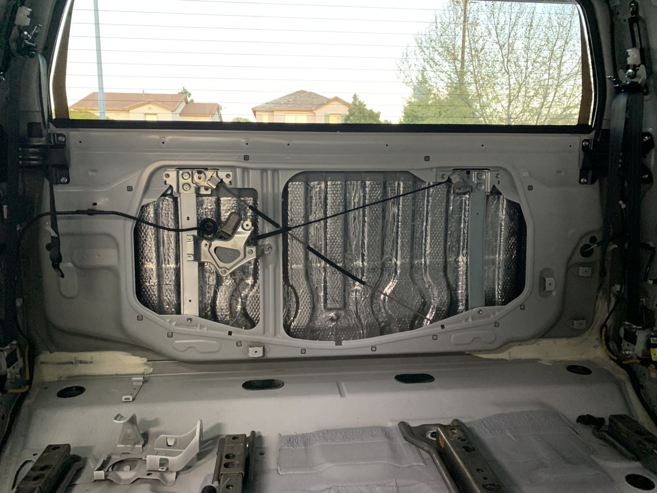

    Soundskins is fairly expensive, so I wanted something cheaper in areas where I am "doubling up" Along the bottom floor of the back wall I used the Kilmat because I hadn't budgeted for SoundSkin in that area and I wanted to make sure I had enough mat left over for all 4 doors.
    The sound deadening is addicting, I put some in my tailgate as well. Truck is already a heavy beast, this sound deadening isn't helping but I am looking forward to a quiet ride!

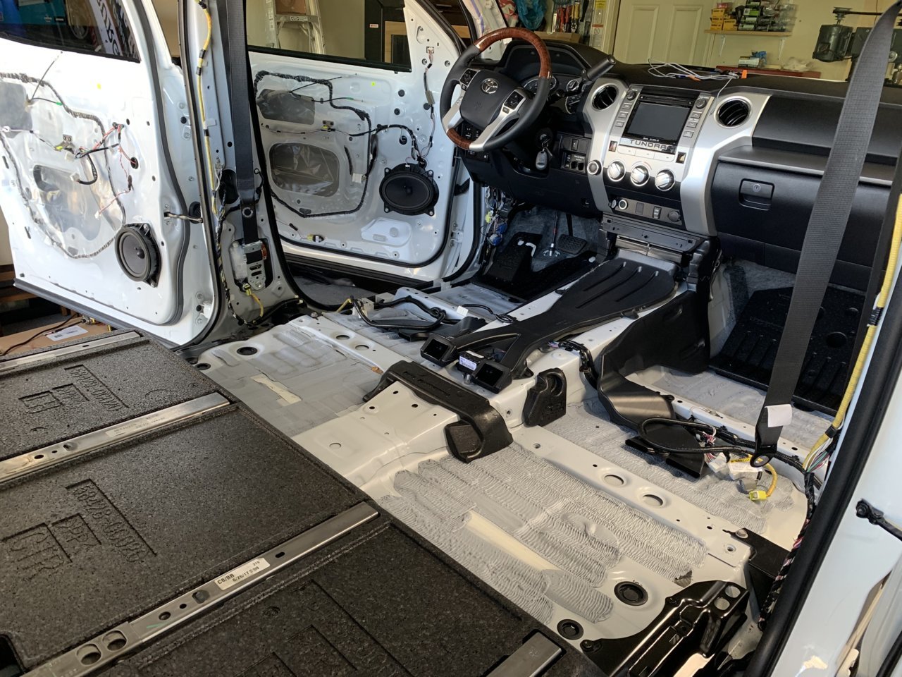

    Gutted the interior and started on sound deadening.

    How hard is it to get the headliner down?

    The hardest part about removing the headliner is removing the 3 ceiling grab handles. The caps on those handles are on very tight. I damaged all of them so I will have to get new caps but they are cheap. Headliner is held on by 4 plastic tabs in the back and rubber trim all around. Make sure you have two people holding the headliner so you won’t crease it
