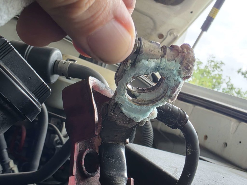

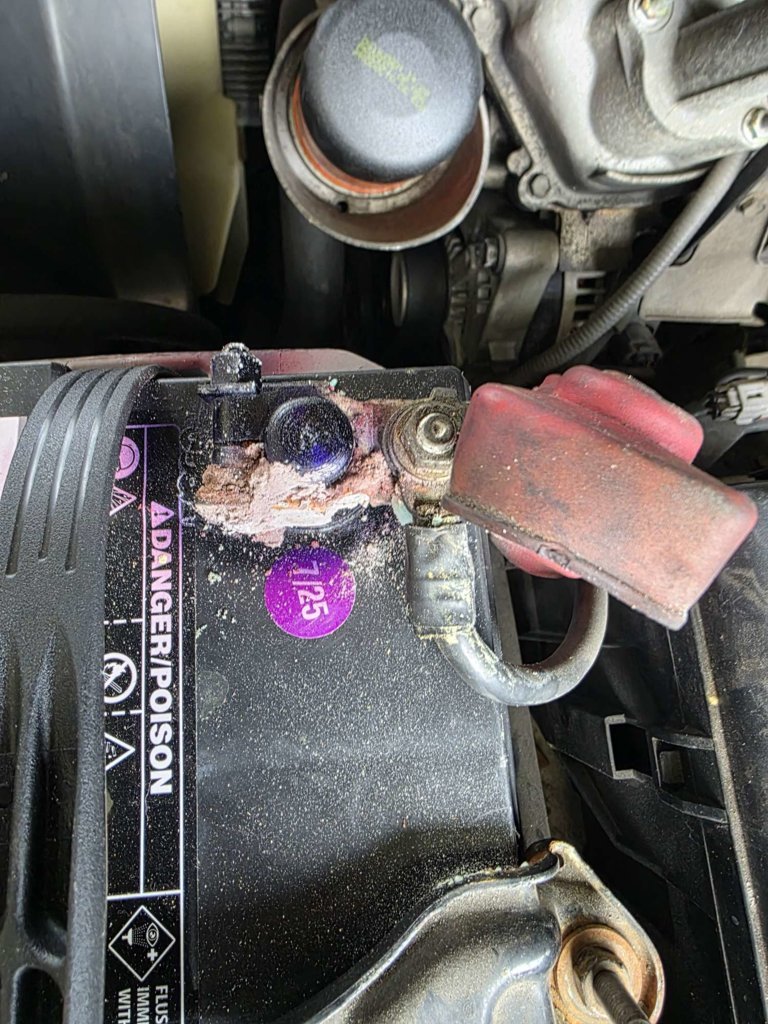

    Wow and on a new battery.

    Yep. Father in law changed the battery for her s few weeks ago and he said the terminals were corroded then. He cleaned and sprayed them. Once they get corroded you never fully get rid of it. I swapped the terminal out with a cheap one from AutoZone but will order an OEM one to replace it.

    I've always had luck cleaning terminals like that with a simple soak in some coca-cola. Once clean and dry or on new ones, I've always liked noco ncp2 spray.
