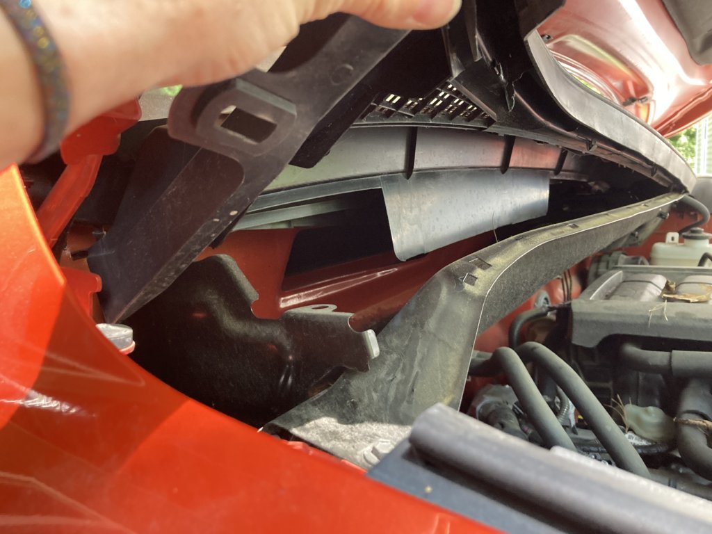

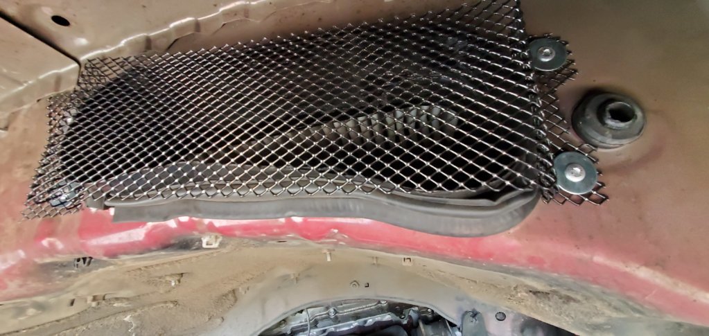

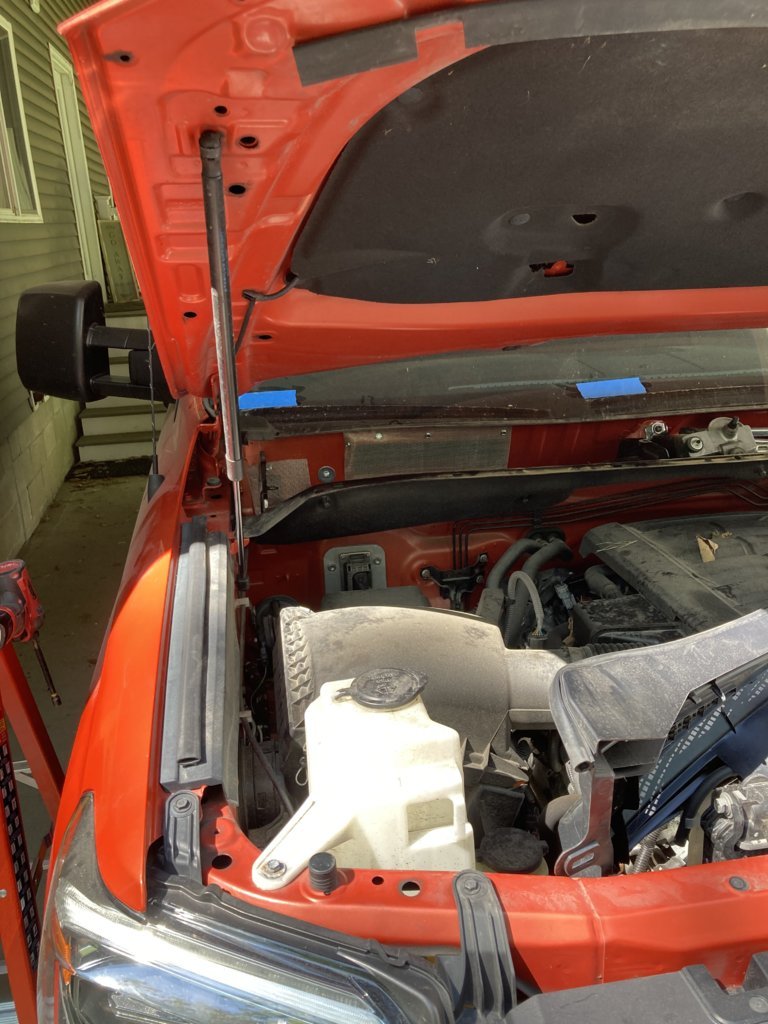

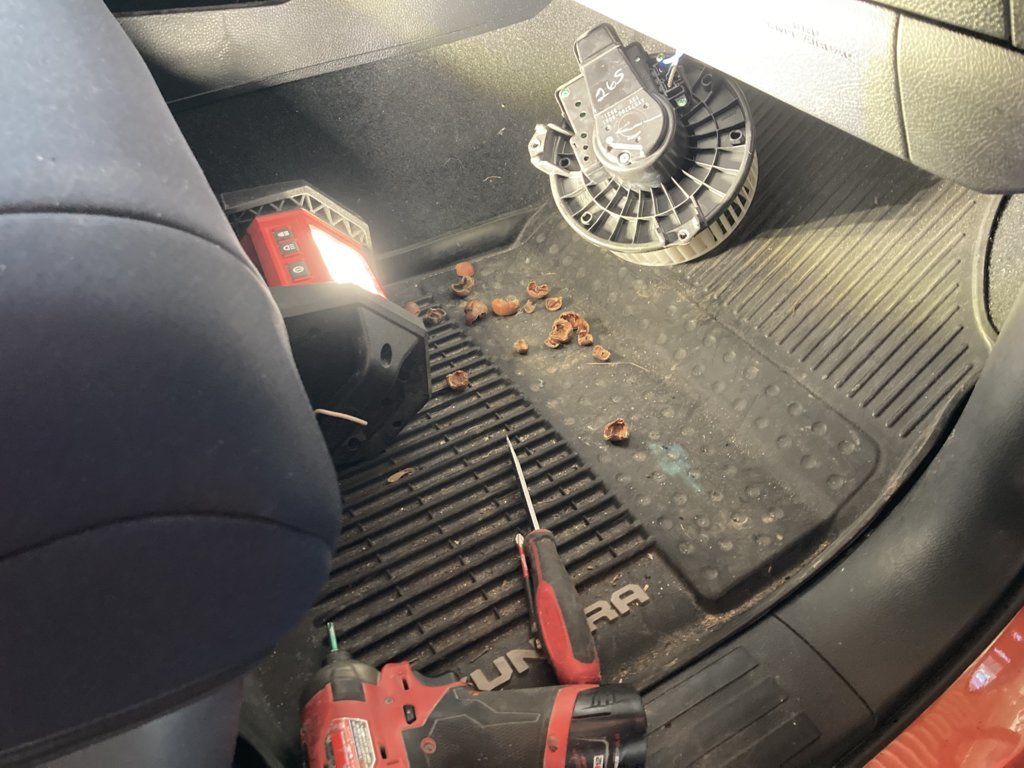

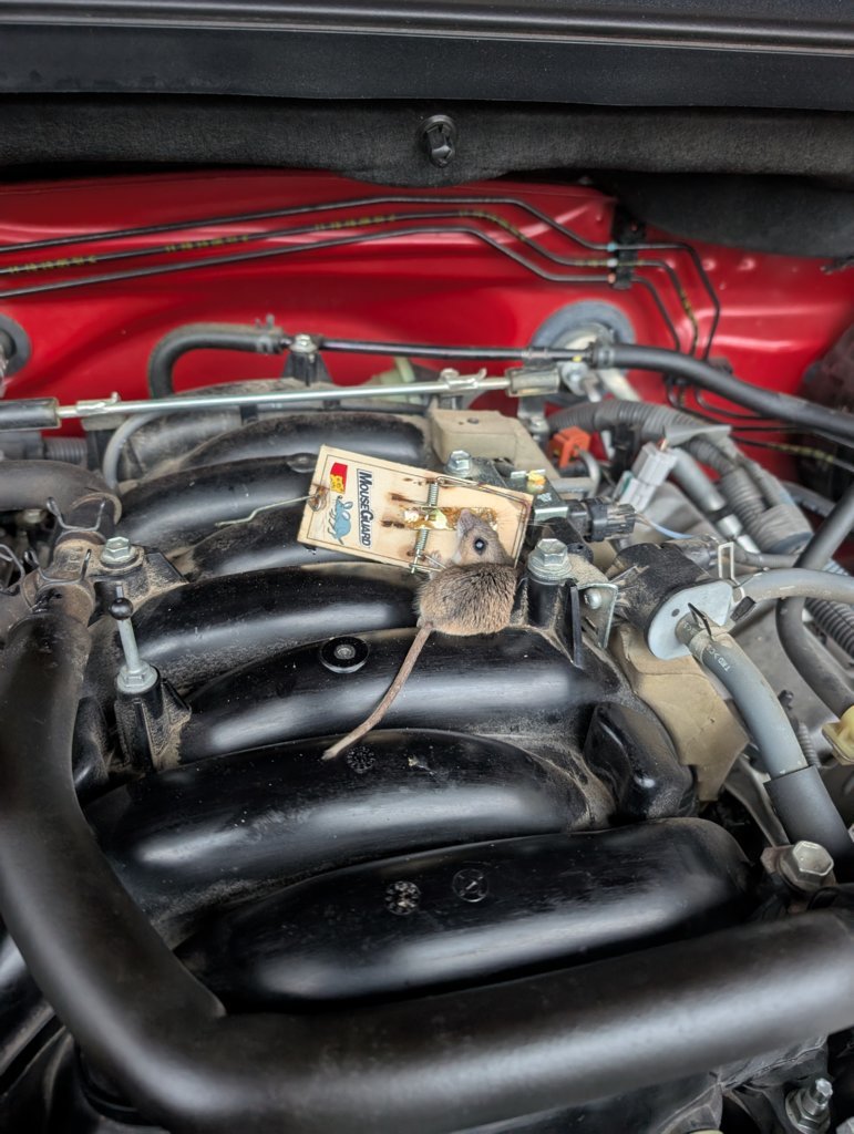

    Truck sat in the carport for three weeks while I used the work van. Went to drive it and got hit in the face with mouse piss smell in the cab that would gag a maggot. Finally did the rodent screen bs I had been procrastinating for five years. Air filter was being used as their restroom and vacuumed about a quart of acorns out of the blower and dash. Ran the inspection camera everywhere I could and didnt see any further-in condos. Little destructive bastards.

    One of those things that make you wonder why it didn't come that way from the factory......:monocle:

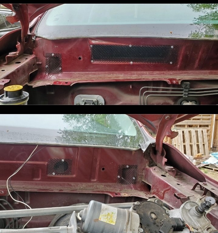

    It's a pain. Did you remove the wiper assembly? On the 2nd Gen there are 2 ports behind them. Not sure if on 2.5 gen?? I chased a chipmunk only to disappear behind there. I also had chipmunk in my intake under the filter filled with moss. On stock intake you'll have a smaller opening in fender well.

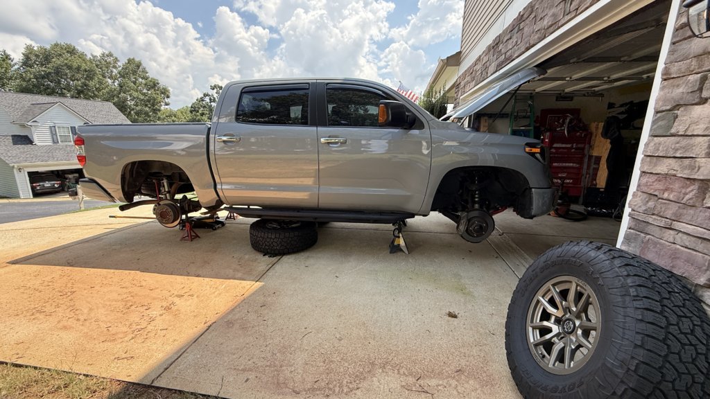

    Sweated my ass off!!!
    Was gonna flush brake fluid, but looked good and pads need to be done in about 6 months give or take, so I'll do the fluid then.
    Rotated tires/reset air pressure/torque lugs
    Cleaned inner fenders with simple green
    Wiped down inner fender plastics with alcohol
    Ceramic coated the inner fender plastics
    While rims/tires off used Adams wheel cleaner
    Still have oil/filter to do, trans drain/refill to do, skid plate arrangement to do (engine is under trans, and would catch, need to reverse that) RainX all windows, retorque drive shaft bolts, general inspection of boots, seals, etc, tap out the damn 12mm bolt under the front bumper caps and replace, check air/cabin filters.
    Ya know, general ~53k maintenance when you wanna keep it a while
