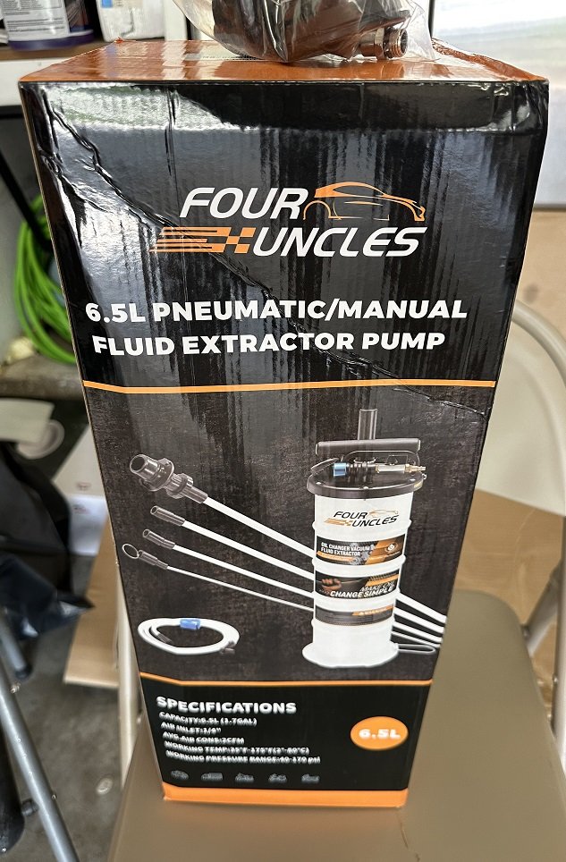

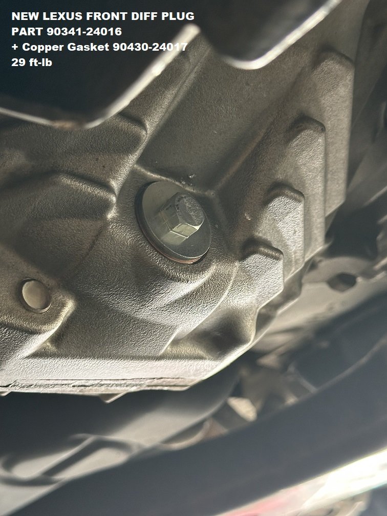

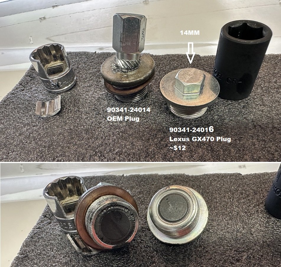

    Ambitious weekend of maintenance at 150k. Made it through the dirty stuff: front and rear differential fluid, transfer case fluid and power steering fluid. Hopefully do the spark plugs this weekend. Started off easy, rear diff and t-case fluids drained and filled no issues. (side note: the liqui moly 75W oil I got for the t-case had a built-in extension tube which was super helpful). The reason I couldn't get everything done was the dang front differential. Specifically the 10mm hex drain plug that I stripped almost immediately, which I found out was a common problem. Yay! The ensuing hours of problem solving led me to a thread on here that suggested replacing the plug with that of a Lexus GX470, which has a 14mm bolt head. After a couple trips to Harbor Freight and the Lexus dealer, I finally got the drain plug free with a 3/8" pipe nipple extractor and me kicking the ratchet like Bruce Lee. Why does it feel like every bolt or plug last touched by the dealership is tightened by Superman? Anyway, replaced the mangled bolt with the Lexus one, replaced the two rear diff plugs for good measure, and used all new washers. And made sure everything was torqued to spec!!!
    After all of that the power steering flush was a breeze. Bought a fluid extractor recently, hooked it up to the return hose of the power steering fluid reservoir and quickly pulled all the old fluid out while pouring the new stuff in. Another diy job that took longer than it should but will go much smoother next time.

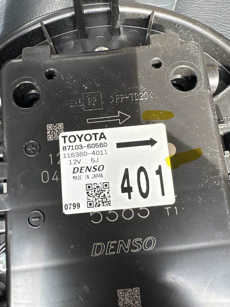

    HVAC motor fan upgrade

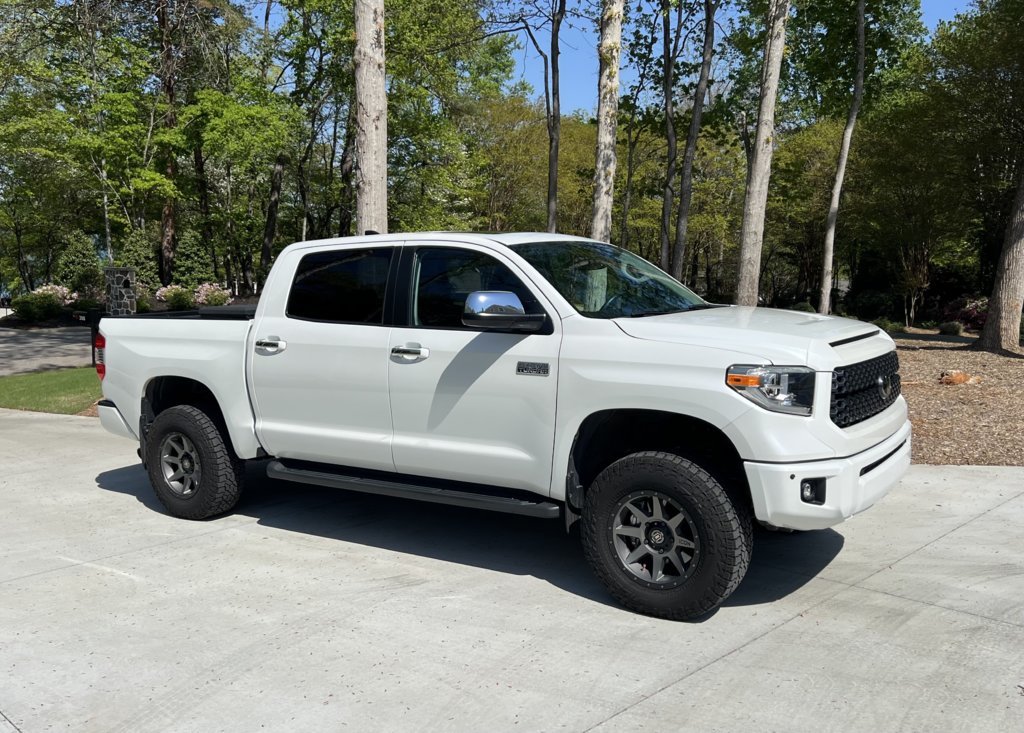

    Anyone have a Limited/Platinum with the stock 20" wheels and spacers? Trying to decide if that would give me the stance I want or if I'm going to need to go aftermarket.

    I dont have either of those trims but me personally I dont like the idea of spacers, just another component to fail that you dont want to fail while driving, not saying they are bad just more maintenance in my opinion

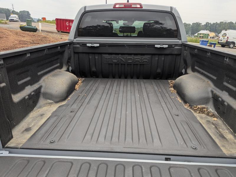

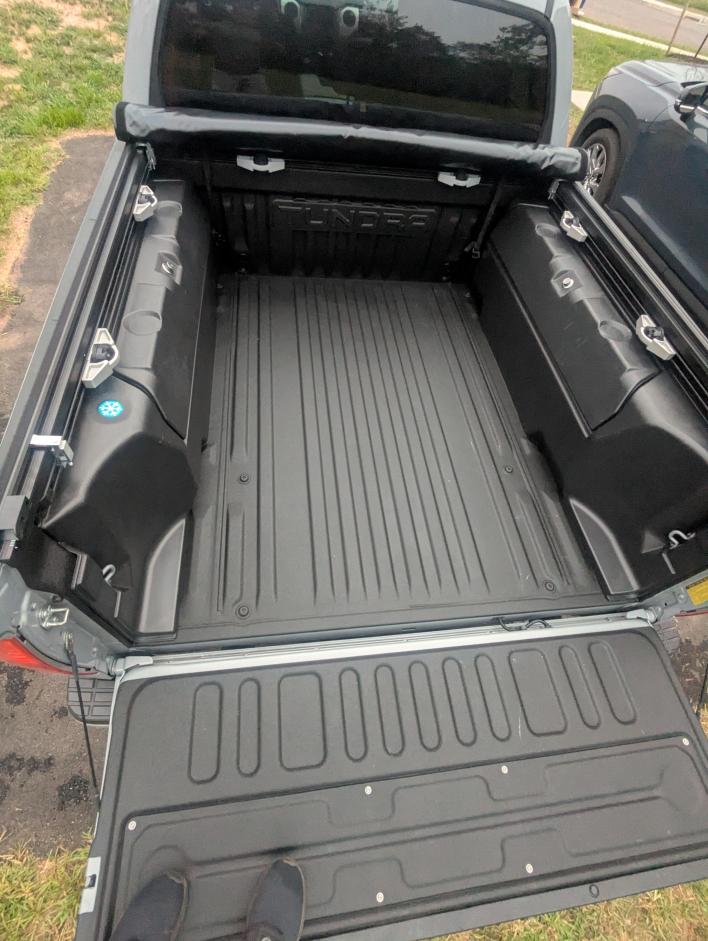

    This truck is a recent purchase, and needed a tonneau cover asap. The Tyger T1 soft cover arrived tonight. I pulled the rails and coolers to do a full clean-out. I then de-greased, dried, and brushed in 303 UV protectant. IMO it looks better than new. I am able to fit all my req tac gear in one side cooler, they fit a LOT.

    They came on mine, but didn’t suit what I was looking for. Went with Icon 18’s and Falkens.IMG_5100.jpg

    Great write up and pictures! Especially the part numbers!

    I have that same cover. IMO it’s great for the price. Seen plenty of rain and barely a drop has gotten in. Those coolers are neat, not seen those yet.
    Thank you! I followed some solid write-ups on here and YouTube.

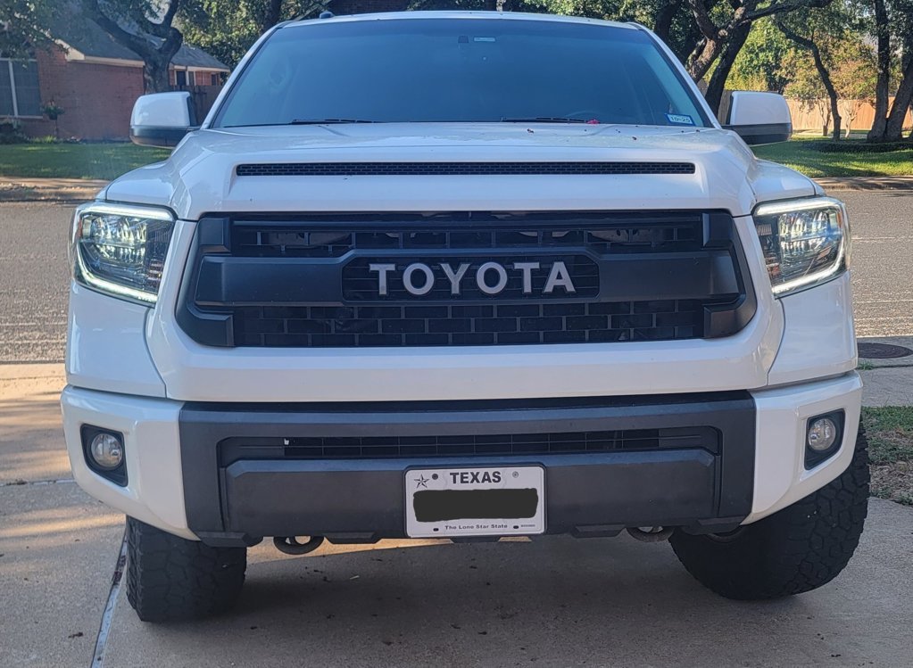

    I wish I had those last week! Cussed through the headlight removal more than I should have had to.
