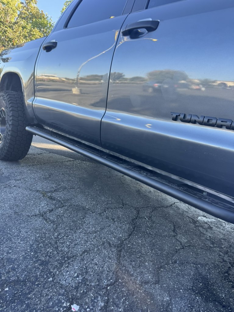

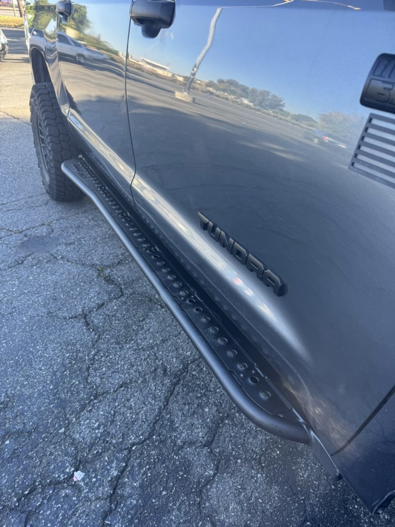

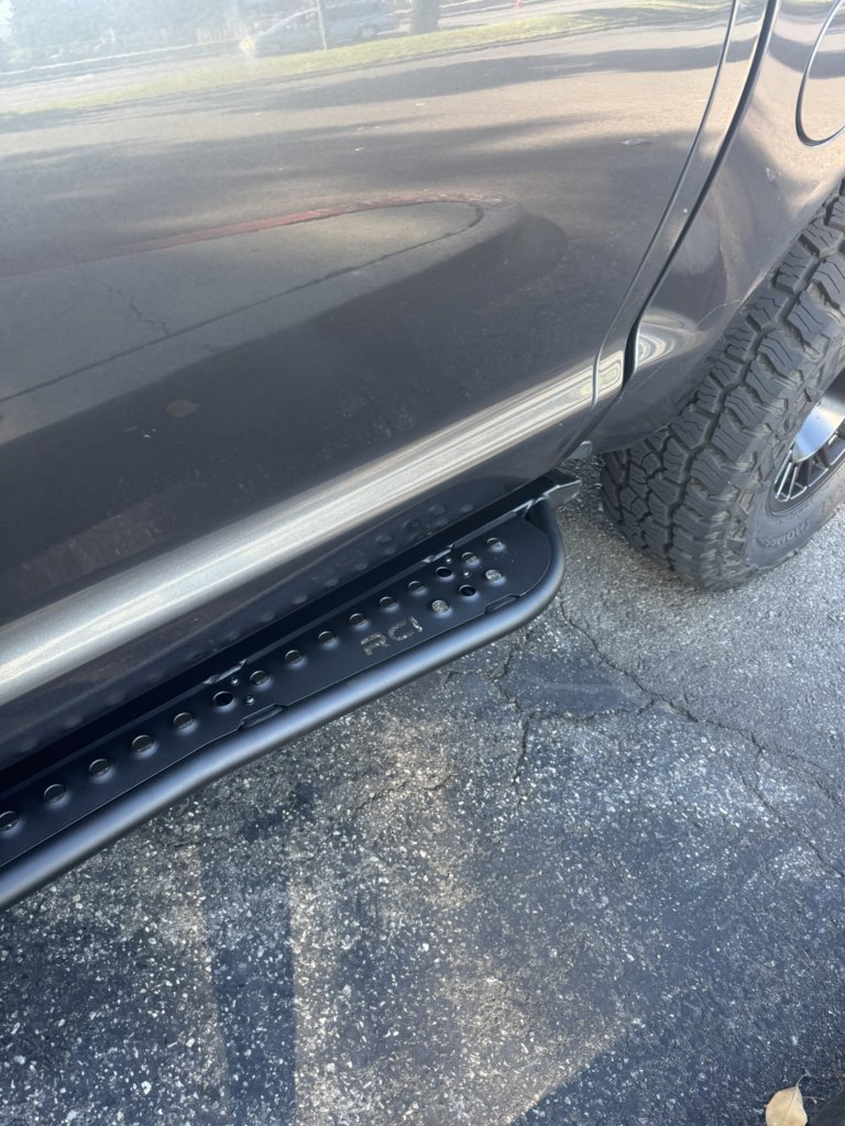

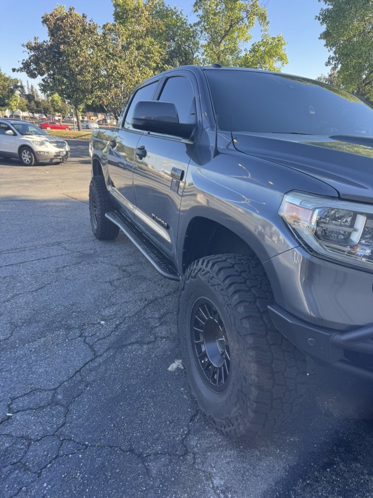

    Finally got my RCI rock sliders on! They look amazing and I now can get in and out of the truck with ease lol. Install was a pain in the ass, instructions from RCI are pretty bad and dont go that into detail. I ended up not doing the optional drilling into the bottom of the frame for the extra bolts for now. I plan on doing it later, but was dead after I installed them. For now they are plenty strong for what I will be putting them through. I am planning on going to Moab next year and for that I will definitely drill into the bottom of the frame though.
    Here are some tips for the install if you are doing it yourself that helped me.
    1: Make sure to have 2 3/8th ratchets. One will need a flex head in order to get to the bolts on the drivers side thats near the gas tank. This helped a lot. Didnt even need to move the gas tank or use a magnet like others did.
    2. For the small bolts make sure to have 2 13mm wrenches, ratchet are harder to use in the tight box end of the frame. It will help severely if one of the wrenches is also a ratcheting wrench!
    3. Get a buddy to help.... if you do it alone using jack stands it will make your life 10x harder than if you just get a buddy. Once you put in the first 2 bolts the frame will support the sliders and you dont need to hold it up anymore.
    Here are final pictures

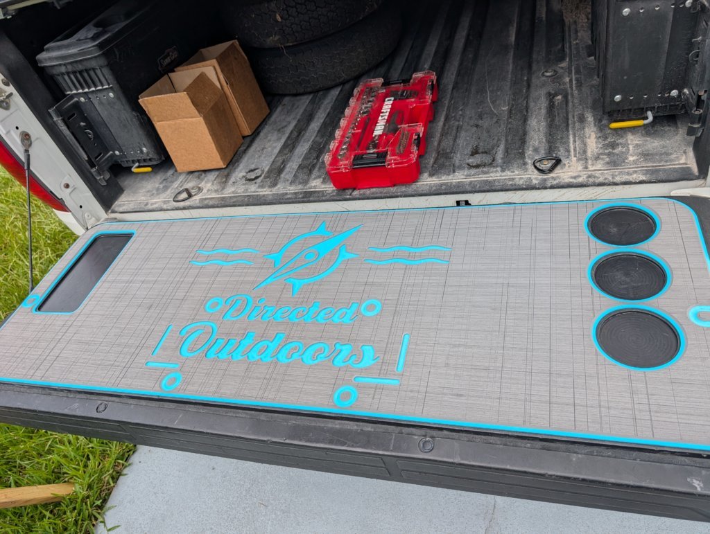

    Thank you! I am extremely happy with it as well! My baby will appreciate it during roadside diaper changes too lo....
    The most expensive part is the mountain hatch cover, I am working on finding a way to reduce the cost and offer customer solutions. If you have the cover already, dm me and we can talk through it.
