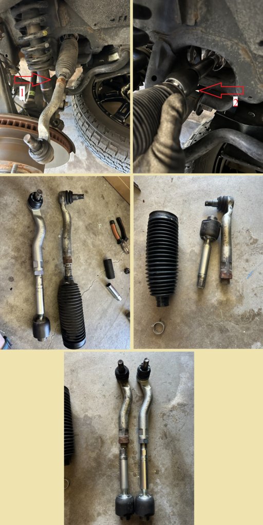

    Replaced the inner and outer tie rod on my passenger side. Neither tire shop nor dealer could break loose the jam nut to complete an alignment. Dealer wanted $960 to replace it. Nope nope nope. Tried my hand at replacing it myself, first time. Used OEM parts. Dealer had good price on the outer tie rod (45046-09560) the inner was expensive. Found it on Amayama (45503-0C030) which was way cheaper even with overnight shipping from Japan (any Fast and Furious 1 fans here?).
    Because the outer part was stuck, I couldn't remove the inner's boot and had to just pull it back while trying to grip it with a pipe wrench. Thankfully it broke free pretty easy. Still had to get the boot off though if I wanted to reuse it. Used cutoff wheel to cut the outer part off and slide the boot out. New parts went in easy. Took it back to the dealer the next morning and had them finish the alignment. Thankful it's done!

    Did the exact same thing a couple of weeks ago. Such a pain in the ass.

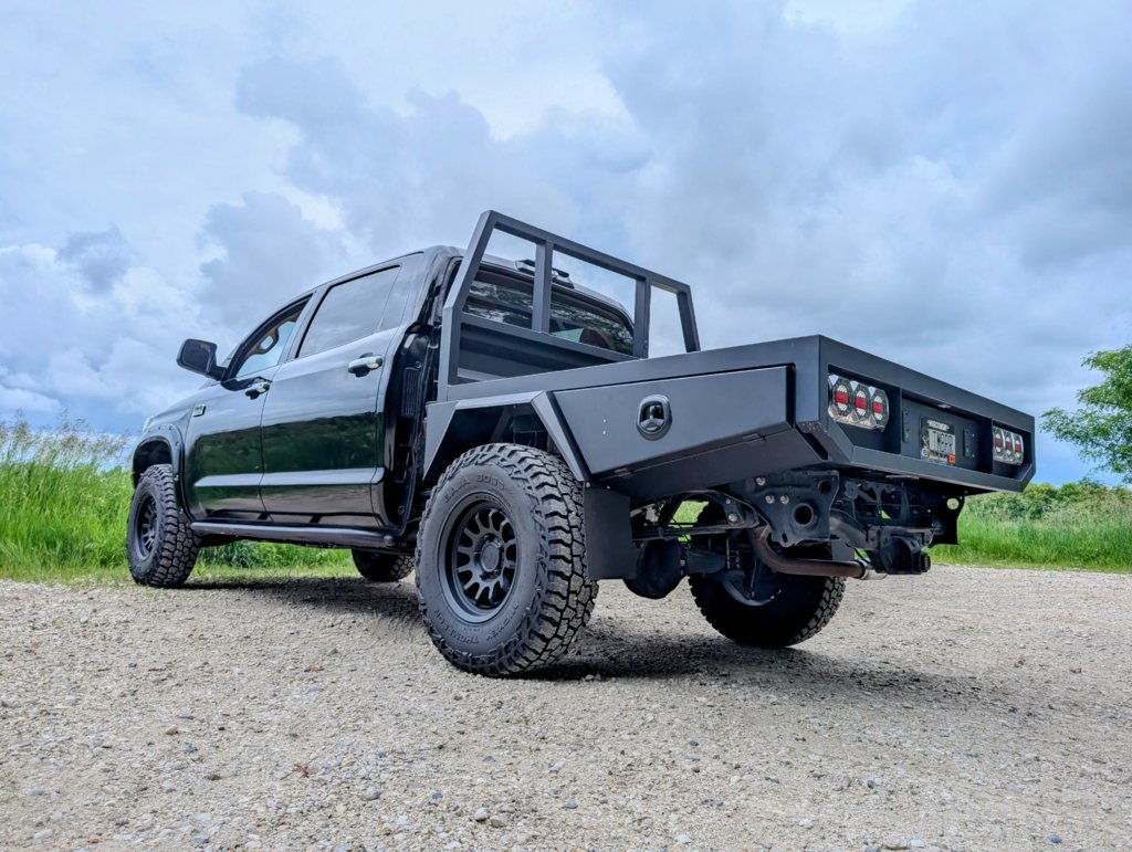

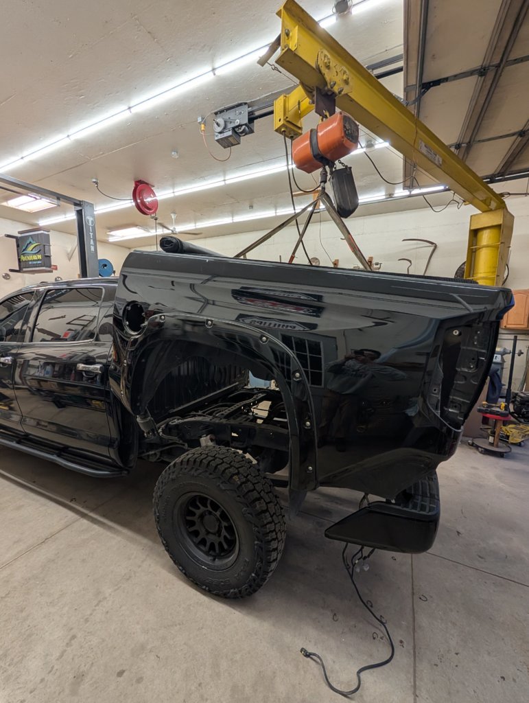

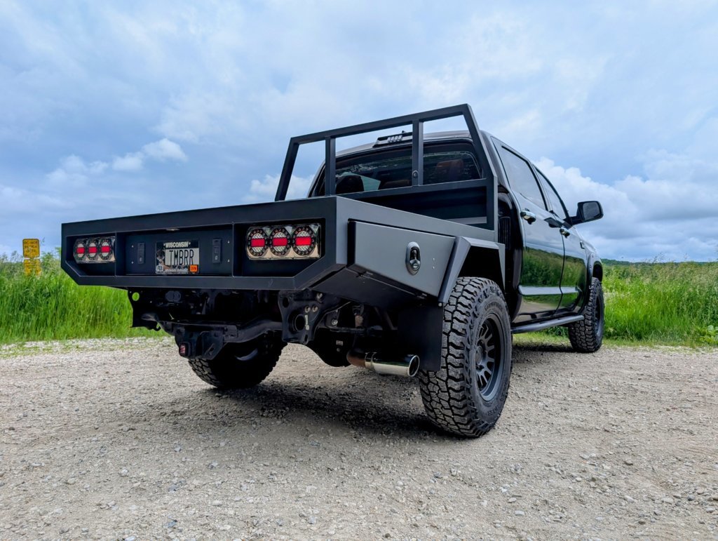

    Bye bye bed...

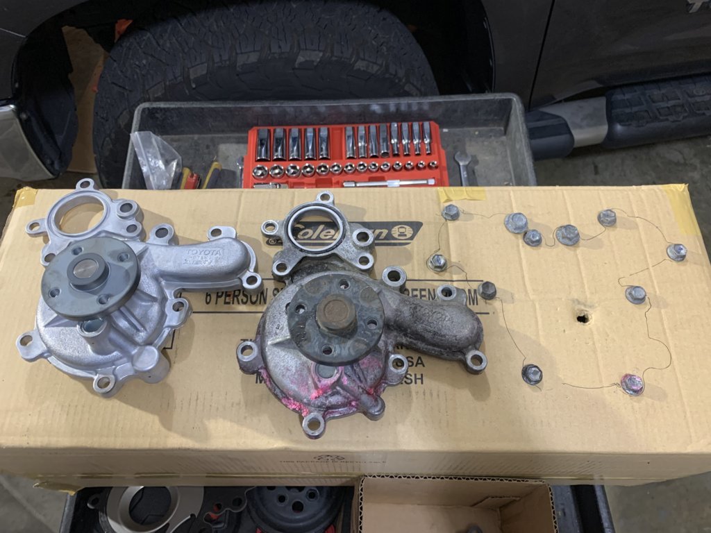

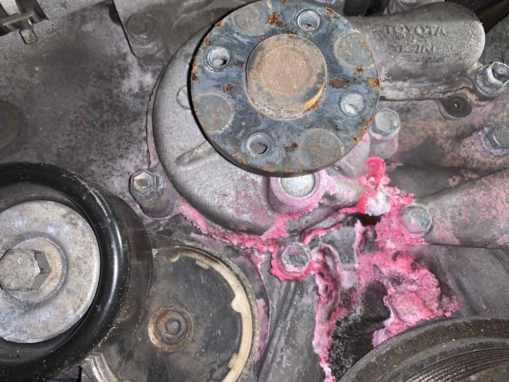

    Swapped out this crusty SOB today and got a coolant drain and fill in at the same time, it was fun

    At how many miles on the odometer did you notice the leak?

    Probably right around 85k if I remember correctly, I had been putting it off for a while and just rolled over 100k
    Edit: It was actually right at 93,000 miles I guess when I first noticed it leaking, just found an old post I made right when I first discovered it. Feels like I’ve done a lot more driving since then. I bought a little Acura gas getter I had been driving to commute with so that has helped keep some miles off the tundra this last year and 1/2.
    https://www.tundras.com/threads/coolant-leak-just-showed-up….133215/#post-3382835

    Who makes the flatbed? Rough cost? I'm wanting to do this but I think its above what I want to spend to do it.

    Looks awesome. When you start to think about it, a flat bed make way more sense than a standard bed..
