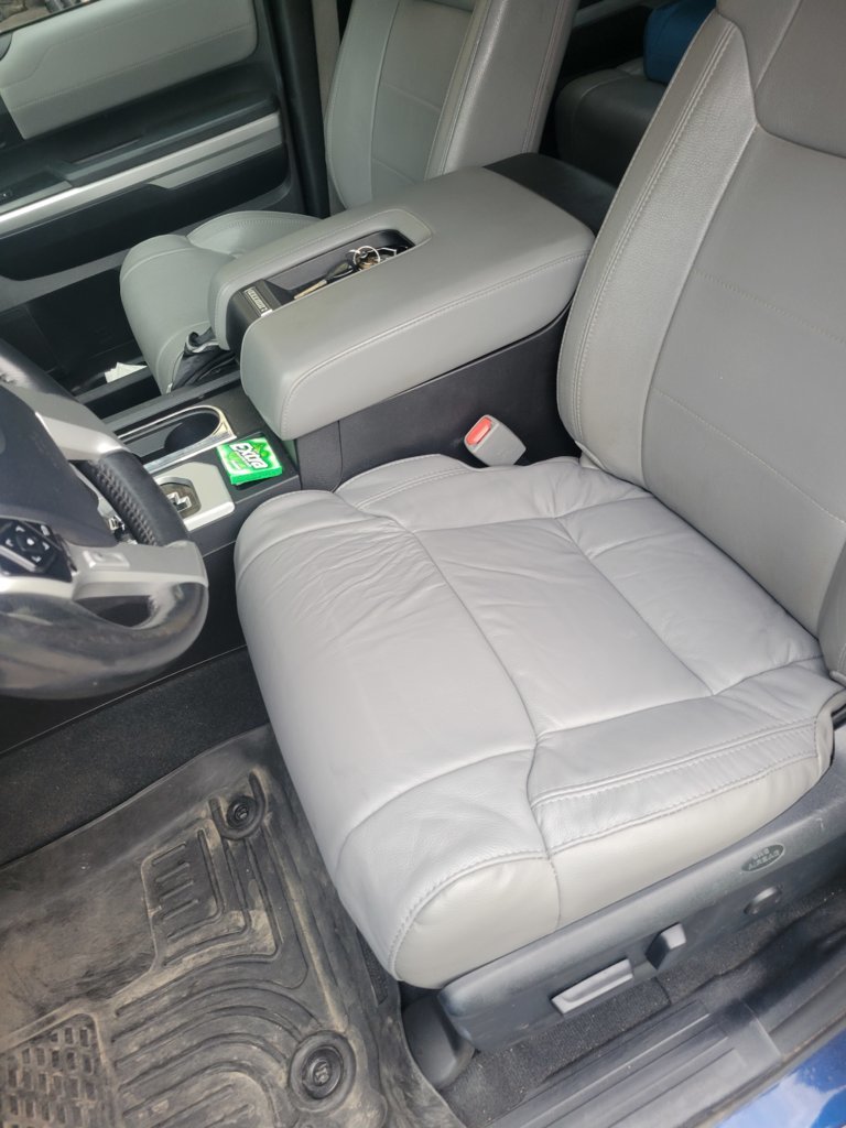

    Threw a new seat cover in where I drag my ass over the bolster... color is right and the material is better than I expected for $150. If I cared more I'd consider rocking the stream to tighten it up more... but the day's sunshine is helping.

    Such an upgrade! It looks so much better. :thumbsup:

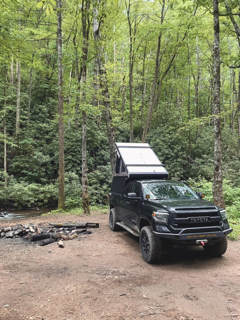

    Finally got a chance to break in the GFC. Absolutely love it. Compared to my RTT and rack, this was like being in a hotel. We were solo so I wish I was able to get some more pictures of some of the trails I went down. Really pushed the truck and it did excellent. One of the trails was through a large river crossing and then up some very steep rocky and muddy switchbacks. I ran into a group of Jeeps at the end who were all on 37s+ and heavily modified. They all looked at me like I was crazy. I was definitely nervous through a fair bit of it. My skids and sliders took an absolute beating. Ended up camping out near a stream.

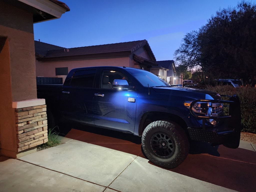

    I purchased the kit that replaces the OE puddle lights: no drilling - plug into OE wires in mirrors.

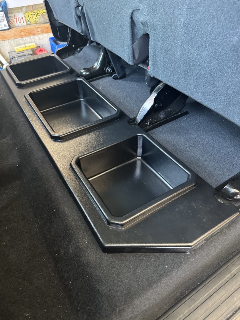

    Purchased an ESP storage box from @Jorgy1 and had time to install it this morning. Much better use of space!

    heck yea. my name is ryan. and im addicted to LED lighting mods :)

    Looks great man!

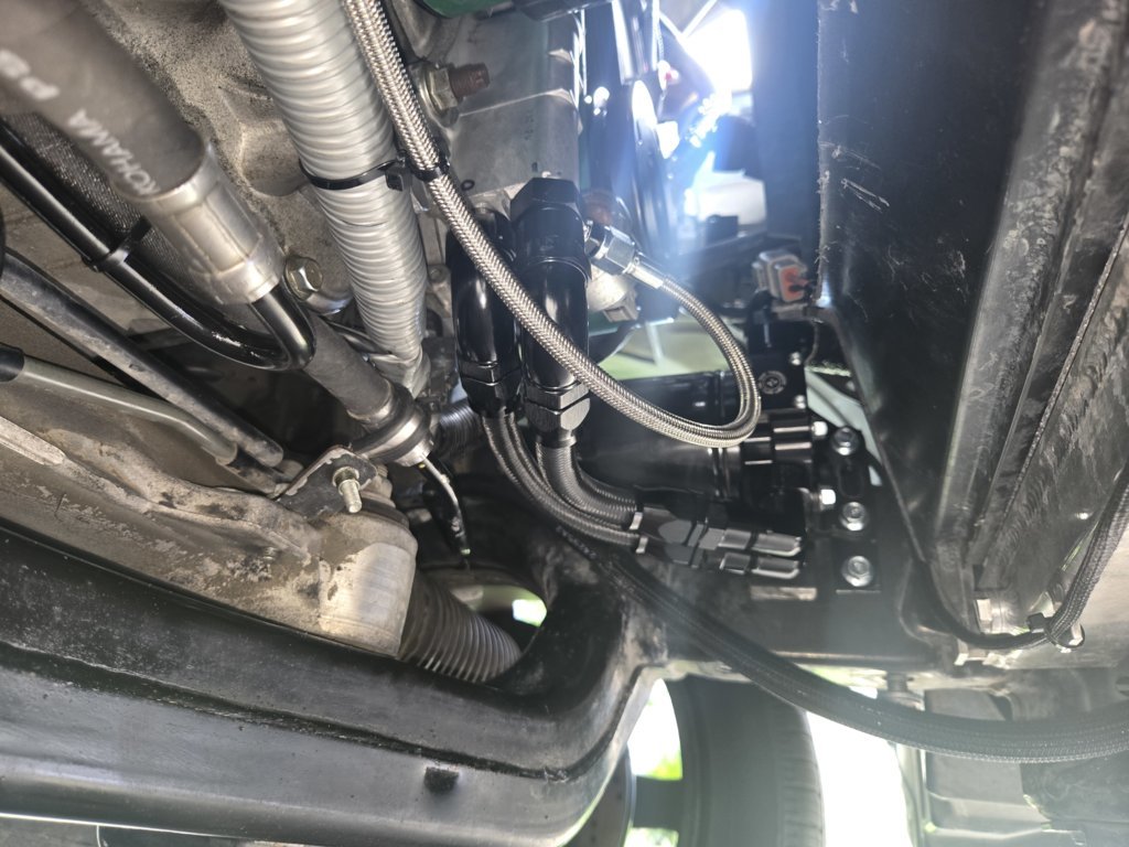

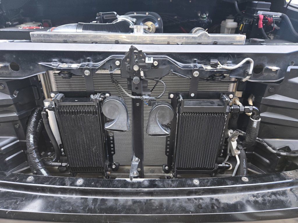

    Installed my oil cooling solution to match my transmission cooler

    Have a link?

    I put it together from the parts list below
    Modified GX460 1UR 4.6 V8 oil filter bracket
    Vibrant 10AN PTFE hose - 41.5" - ~7oz capacity
    Earls 419 Oil Cooler - 0.4qt capacity
    Improved Racing Thermostatic Oil Filter Housing (160* open)
    Wix 51085 filter
    Haltech pressure sensor with remote mount line
    engine oil adapter (Vibrant 10AN hose end 90* with 8AN ORB end) out to oil filter housing (Fragola Swivel 10AN 90*) - 7.5"
    oil filter housing (Vibrant 10AN hose end 90*) out to oil cooler bottom port (Vibrant 10AN hose end 45*) - 10.5"
    oil cooler top port (10AN Male to Female Sensor adapter, Vibrant 10AN hose end90*) back to oil filter housing (Vibrant 10AN hose end 45*) - 17.5"
    oil filter housing (Fragola Swivel 10AN 90*) to engine oil adapter (Vibrant 10AN hose end90*, 10AN to 8AN ORB Sensor adapter, Vibrant 10AN hose end 90*) - 6"

    Awesome, thank you! Been looking into something like this

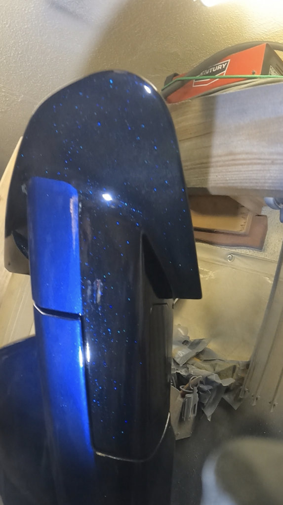

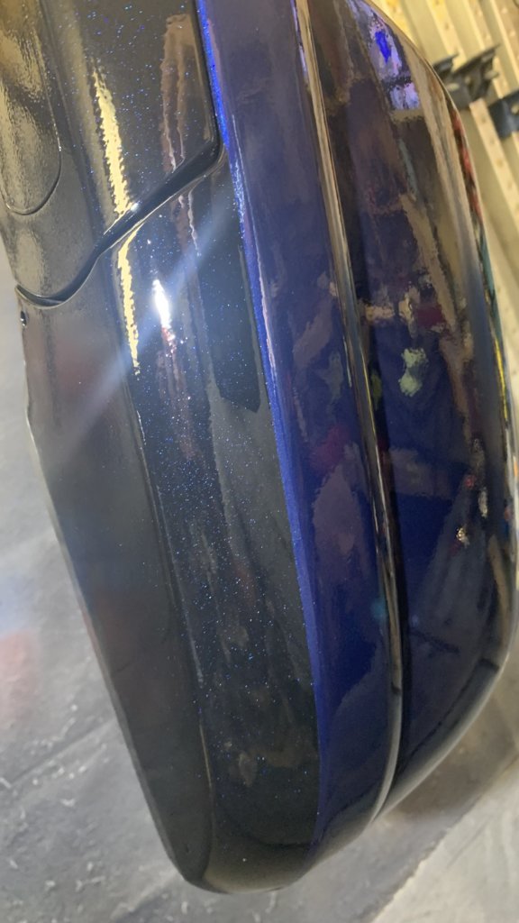

    In the interest of matching the upcoming hood paint project, I did the mirrors first. I sanded off the texture and added a black base, then proceeded with a light coat of candy blue pearl, blue ribbon in a new paint scheme, then 2k clear over everything. In the shade the black looks black, in the sun the blue pearl really pops.
    Install in a couple days after they cure.

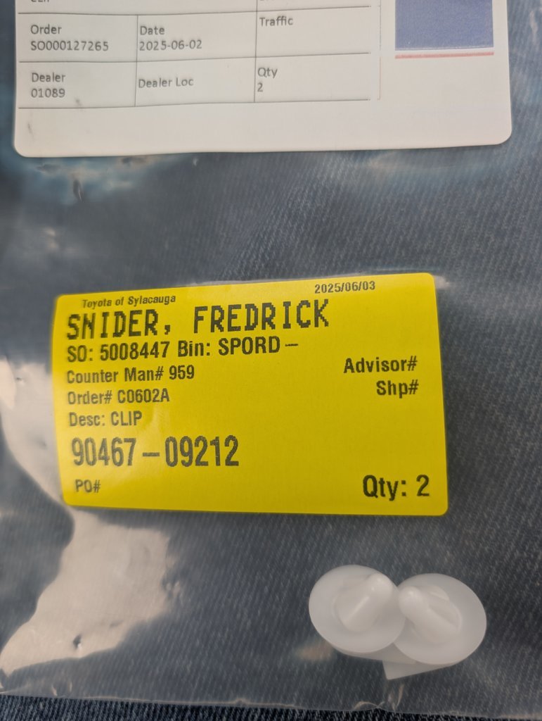

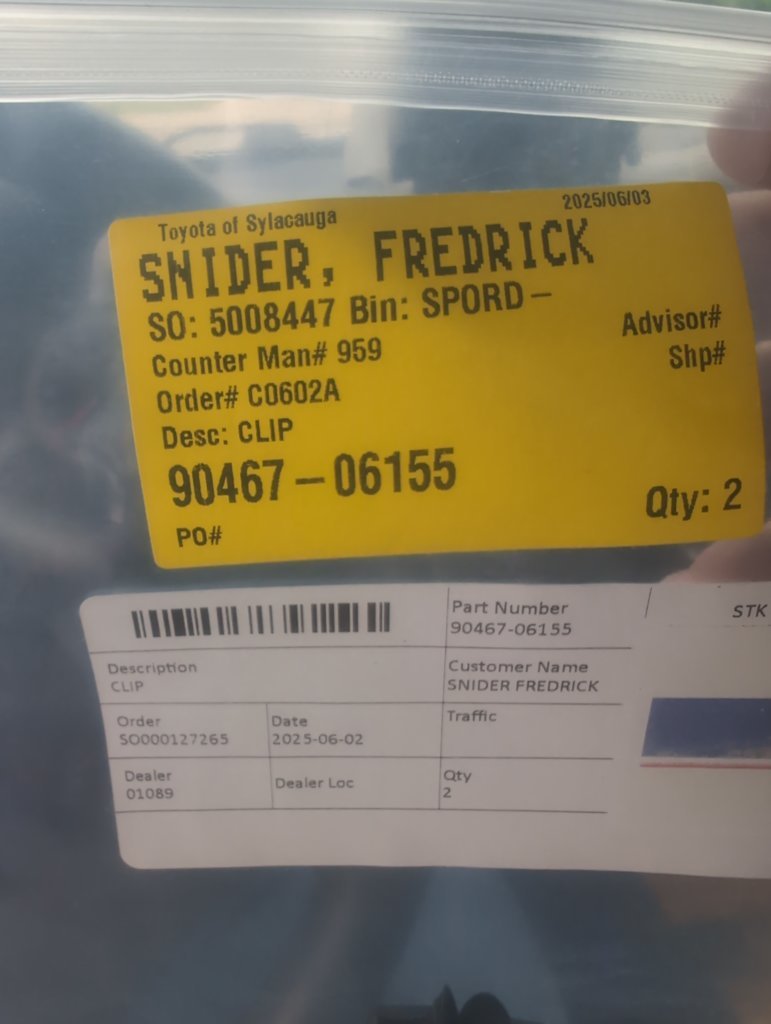

    Hey for anyone needing the part numbers for the plastic nut and funky pins for the interior kick panels (my words) on the right & left sides of the floor board here they are PXL_20250610_140916085.jpg 17495664327943386795214313630882.jpg

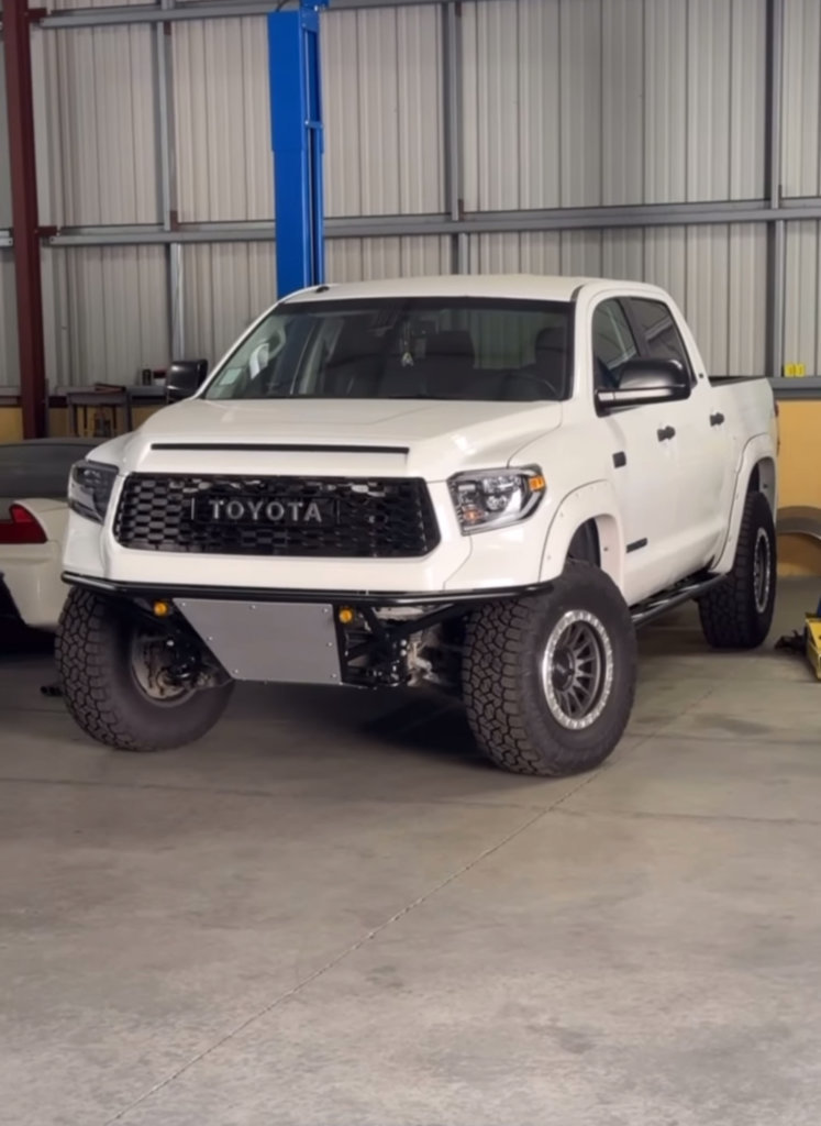

    Drove it to the lake.

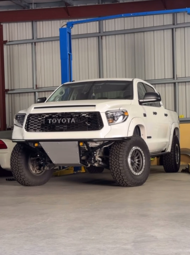

    Killer looking rig! Love that classic prerunner style.
