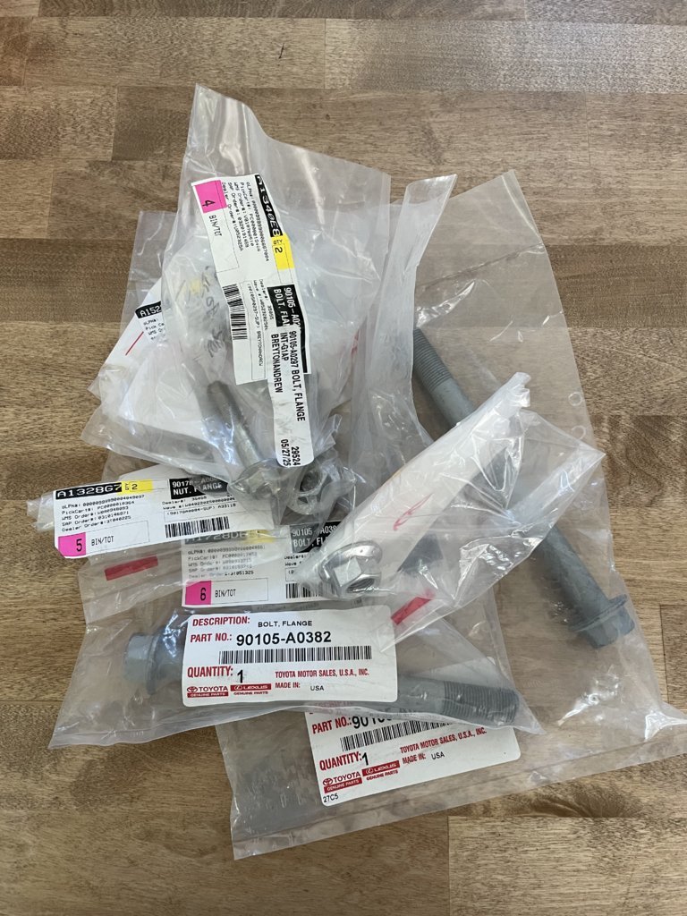

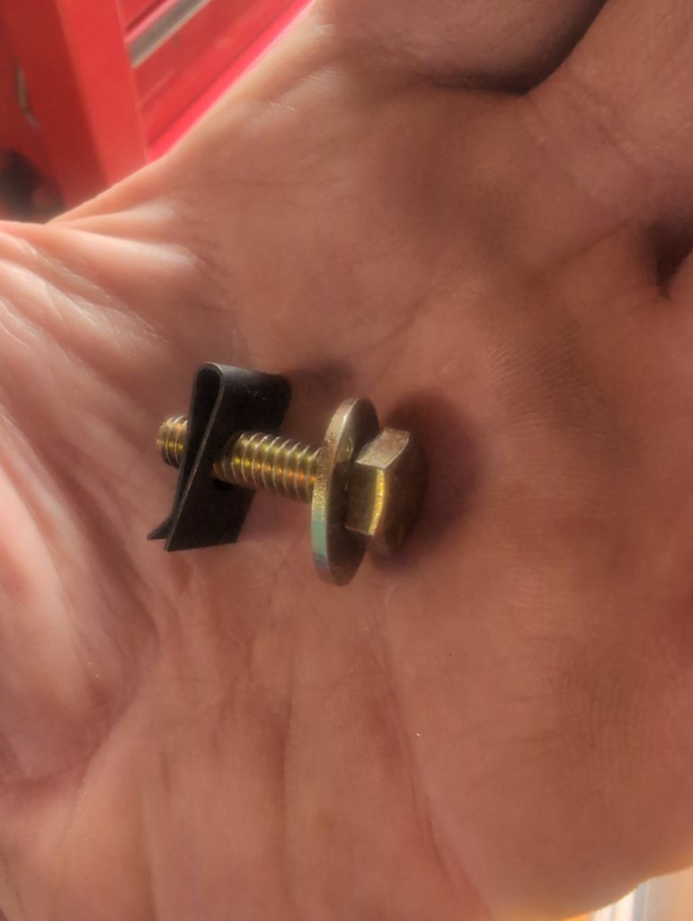

    MORE BOLTS
    Officially have everything I need to install all new suspension aside from the time to actually do it lol. And some anti-seize, but that’s easy to get.

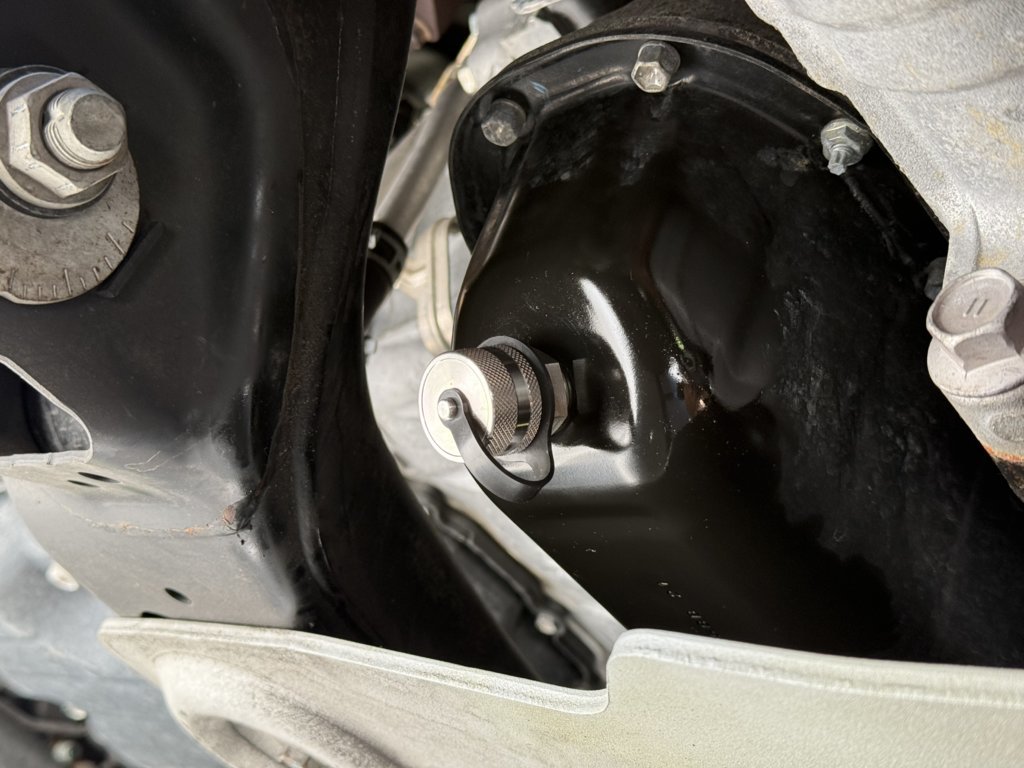

    First oil change on the Tundra as well as first oil change I’ve done in a decade or so.
    Pretty straightforward except for two small issues:
    1. As the oil slowed down coming out of the pan it started dripping onto the TRD skid plate, so much so it was dripping out the other end towards the front. I’m due to pull that off anyways as I’d like to clean it and paint it black with SEM Trim Black and also to swap front sway bar for TRD sway bar. I ended up jacking the truck up on drivers side to help it finish draining a bit faster and avoid more mess to clean on the skid plate.
    2. The filter drain plug didn’t come out, instead the entire filter did, so a bit more mess. I didn’t have a vice or filter wrench to get the drain plug out after I pulled the filter so just punted it to the next change. Figured it only needs a new gasket if I had actually pulled the drain pug off.
    Also I looked carefully and everywhere for the crush washer and could not find it, so further confirmation it’s better to do it myself (also dealership will have me sitting for 2-3 hours sometimes for an oil change).
    Finally I installed the Valvomax drain plug - with the skid plate issue this seems like a really good idea for next time.

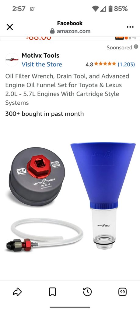

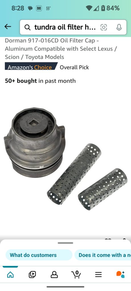

    Get this setup Screenshot_20241214-145727.png Screenshot_20241229-082854.png
    And I installed a Fumoto valve but I like the one you added also.You can also order a pack of the crush washers off Amazon

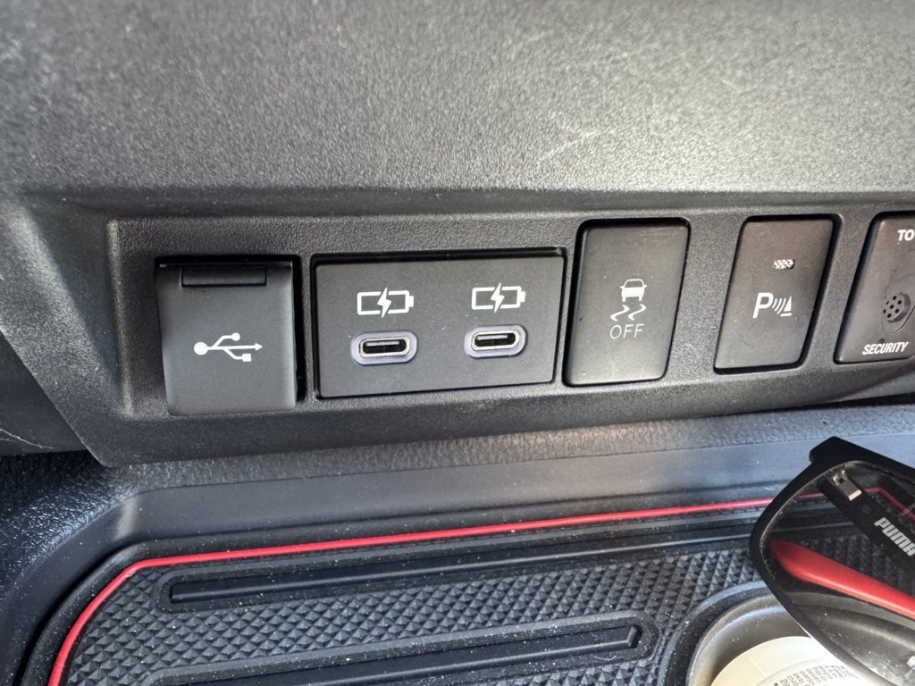

    Installed the dual USB-C ports

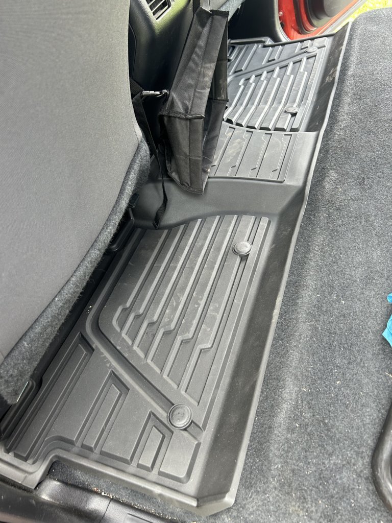

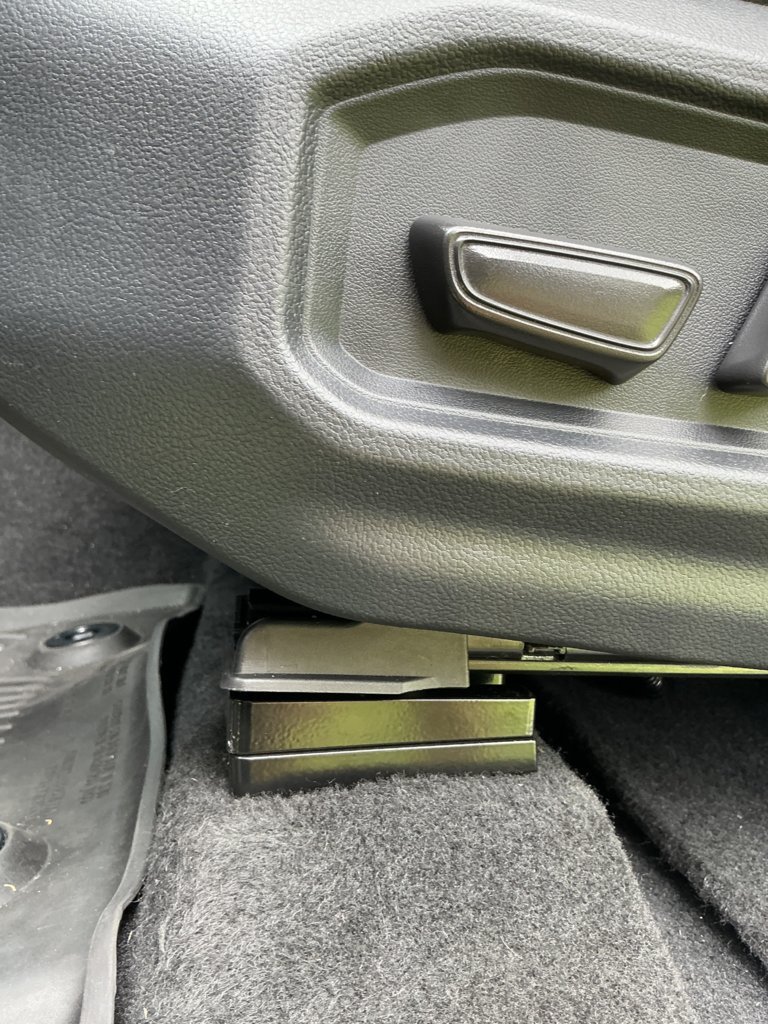

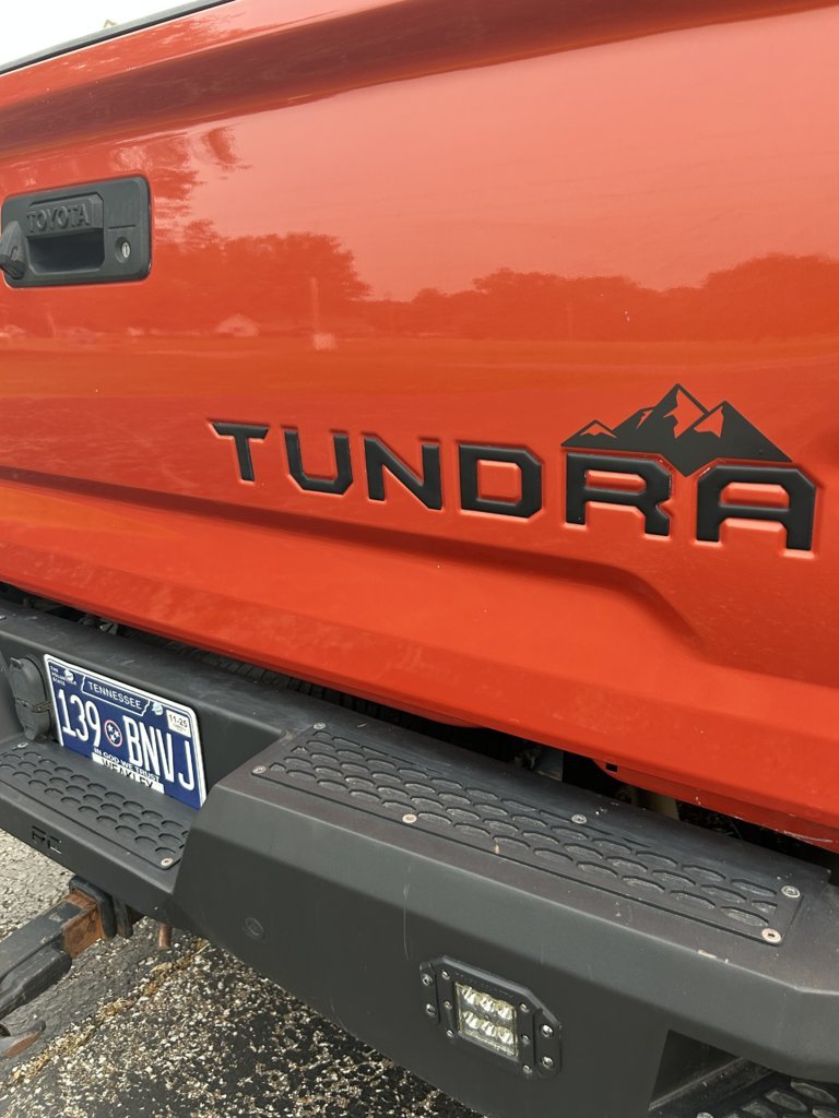

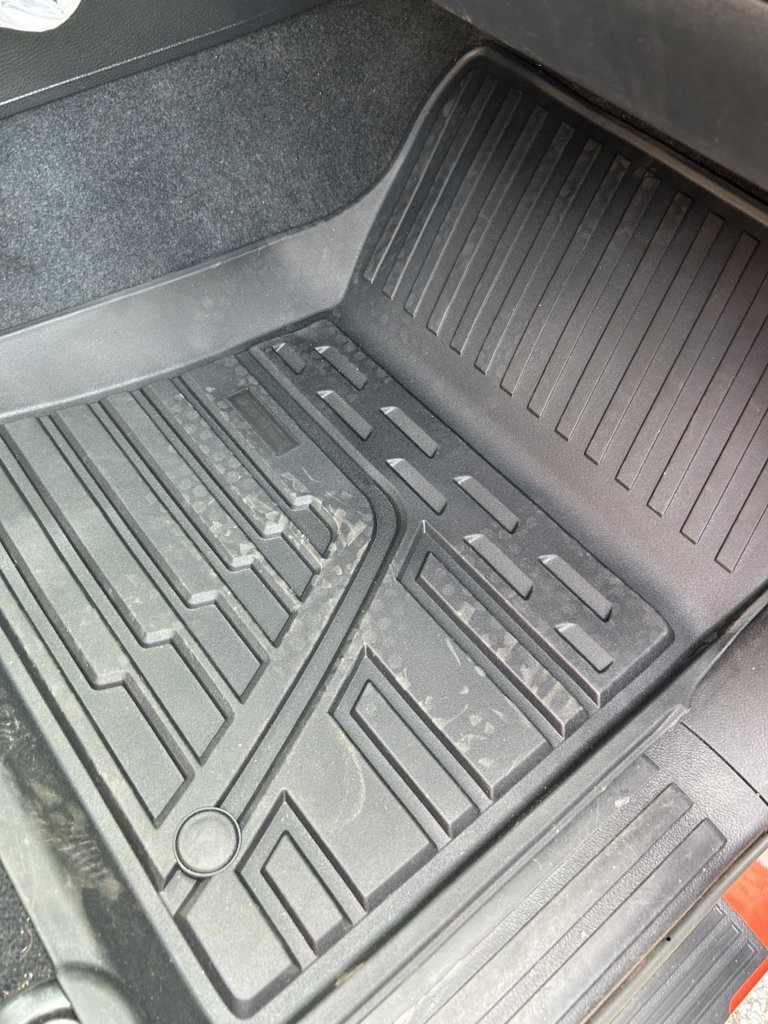

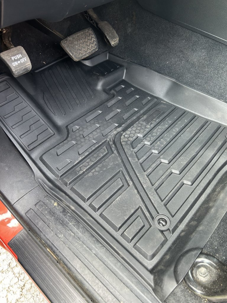

    Gave her a bath and cleaned the inside after our camping trip. Got an awesome Memorial Day deal from Amazon on these floor mats https://a.co/d/bYfrZlj for $20 and installed them. Also put this little decal on as well. IMG_4816.jpg IMG_4817.jpg IMG_4818.jpg IMG_4821.jpg

    Those look like they function way better than the Toyota junk I’ve got. May have to snag those.

    Awesome! Link or part #?

    Yep I have - filter wrench fit perfectly and the screw in funnel also made it super easy to fill. Didn’t get to use the filter drain tool unfortunately.
    I watched a vid from the car care nut talking about not switching to the metal oil cap. Seemed a bit overly cautious. What benefit do they provide other than not being plastic?
    The Valvomax came with its own washer so didn’t need. My dealership also sticks one in the box when I buy a filter there. Was more concerned that last oil change didn’t put one on.

    Someone else on here found it.
    It is a Toyota part (for the Prius but fits 2.5 Gen Tundra exactly with the same connector) 85532-48080.
    It is pricey $94, so best to buy during one of the 25% off sales - hopefully July 4th - for $71.
    Edit - credit to @Gtboosted

    I can’t vouch for durability but they seem nice and for what I assume was a price error was a good buy. They fit really well too.

    Yeah I didn't think about not needing the washer anymore....duh...I watched the same YouTube from the Car Care Nut and had the exact problem getting the dang plastic filter housing off after the dealership I bought the truck from did a presale service.Glad I had the metal filter housing on standby and that's what is on my truck now with no issues

    Are you sure you weren't referring to the lower control arm bolts?
    Those fuckers always sieze!
    In the last 25 years of Toyota truck ownership, every truck has had at least 1 siezed bolt.
    In fact, my '21 has both rear cam bolts froze up. SMH.

    Both actually! I’m tabling messing with LCA bolts until I pick up some oem LCA’s and just replace the whole thing instead of doing bolts and bushings.

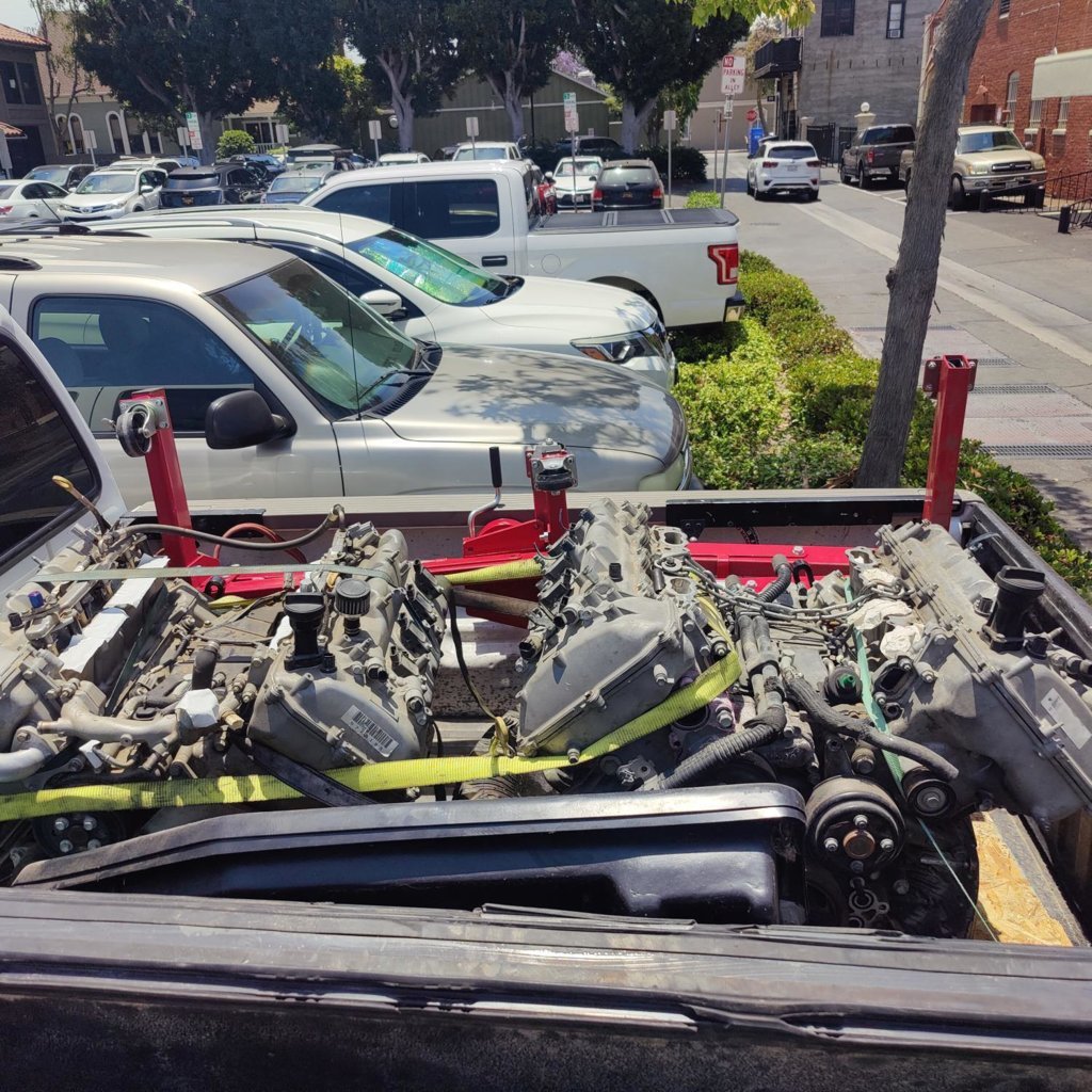

    Too many mods to come
    Road to revival continues

    Oooooooooo........please tell the story Mr.! What is going to be done to those 2 beauties?

    So the new motor on the left is a special spec motor straight from TRD. The one coming out of my truck will get fully built to hold 800-1000hp.
    I had a buddy who was having a spec race truck built by terrible herbst team/1nine. The team ordered it but then they went to get it cleared by the racing org and they didn’t want to add a Toyota motor to the class so they pulled it out. The motor on the right I’m giving to Snivilous for parts R&D for the community.

    Wow man, that's a whole bunch of awesome!! 800-1000 HP? Good Lord!! That's incredible. Now is that TRD engine a 5.7 like ours? I mean, I'm sure it would have cams and pistons and all rhe good internals. But is it or is it something bigger?

    Yep 5.7 3URFE with some modifications to fueling.

    Wow, I had no idea the block and heads could handle 1000 horses. Wow, that's impressive. I like things to be overbuilt. That's how I make my knives.

    The stock motor can’t handle that but can be built to handle that. The crank would remain stock. Upgraded pistons and rods etc would happen to hold 800-1000hp with lower compression to be more boost friendly. Stock motors about 700-750 is about the limits. The transmissions the weakest link but there’s upgrades to those or even transmission swaps happening by a few
