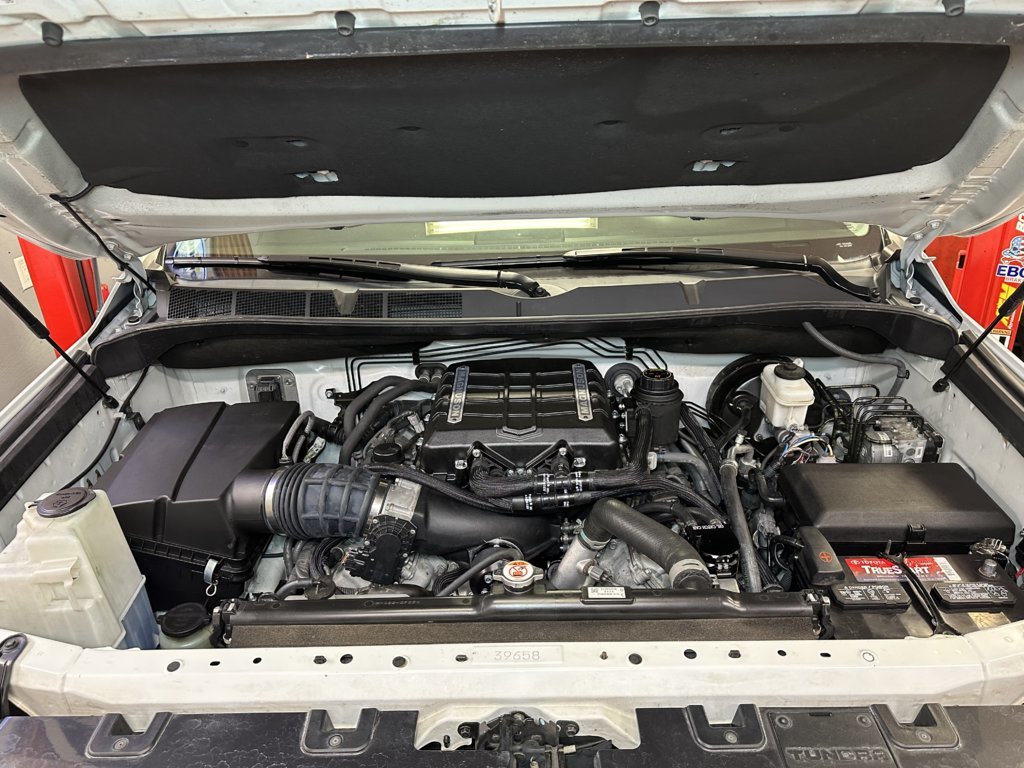

    So awesome! Sounds like the SC might be worth the cost?
    Tripleconpanna likes this.
  2. May 25, 2025 at 11:07 PM
    bmw345
    bmw345 New Member
    Jan 24, 2022
    #73610
    340
    CT
    2018 Platinum Pro, Pro Fox's TRD Skid
    Yes it is worth every penny!

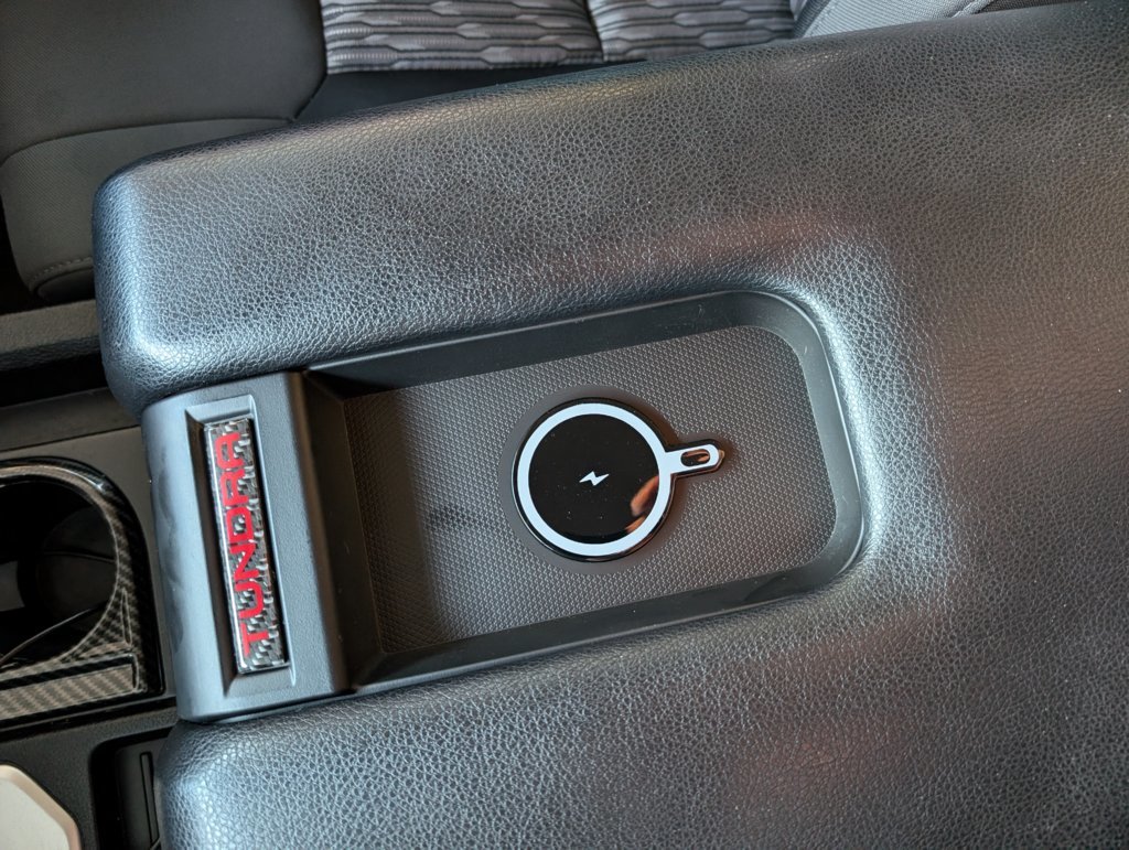

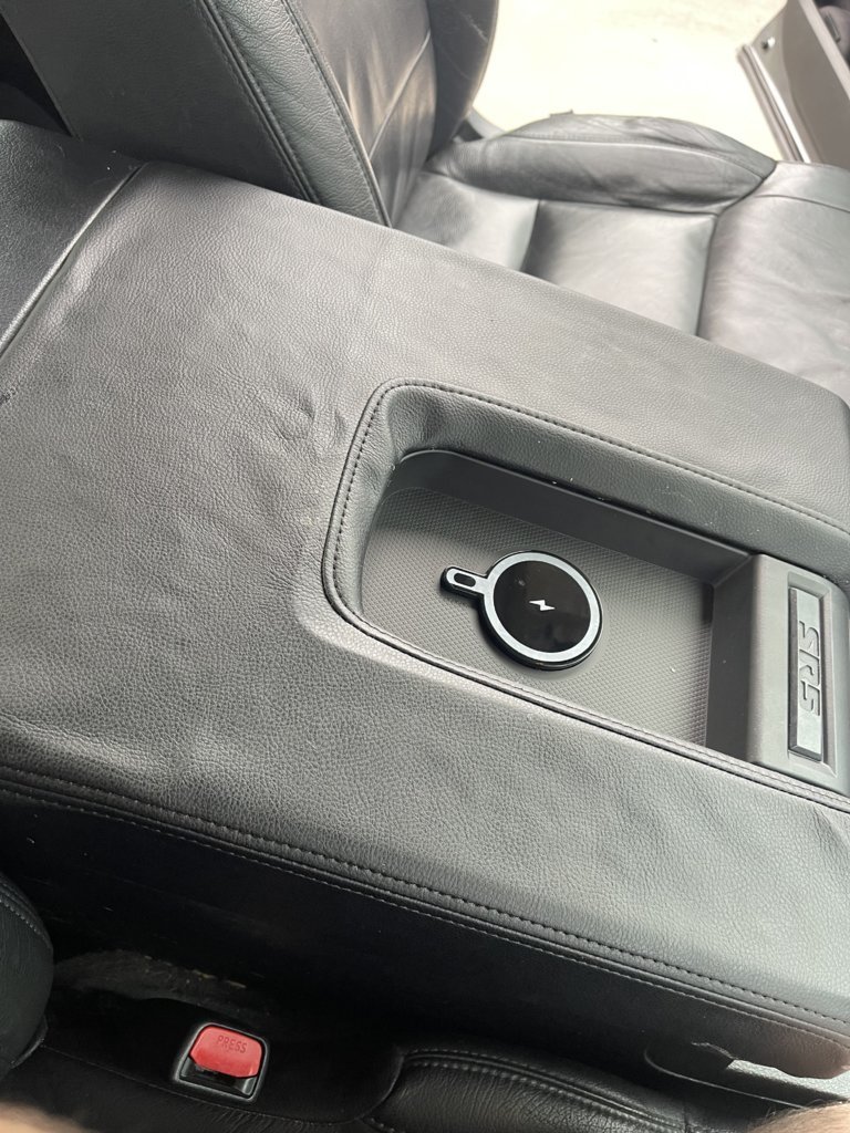

    Im pretty sure I put the charger in my cart on Amazon the day you posted it.

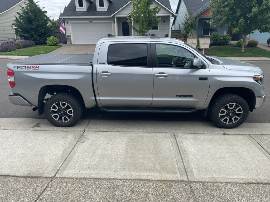

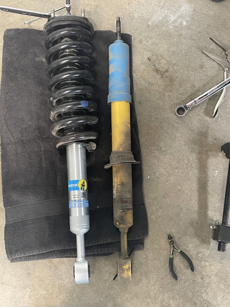

    Finally got my 5100s installed. Top setting with one inch shackles in the back. Just a little bit of rake. Now need some bigger tires. Thinking 295/70/18s.
    Also swapped in my sequoias old front sway bar that was replaced with the TRD bar on my wife’s rig.

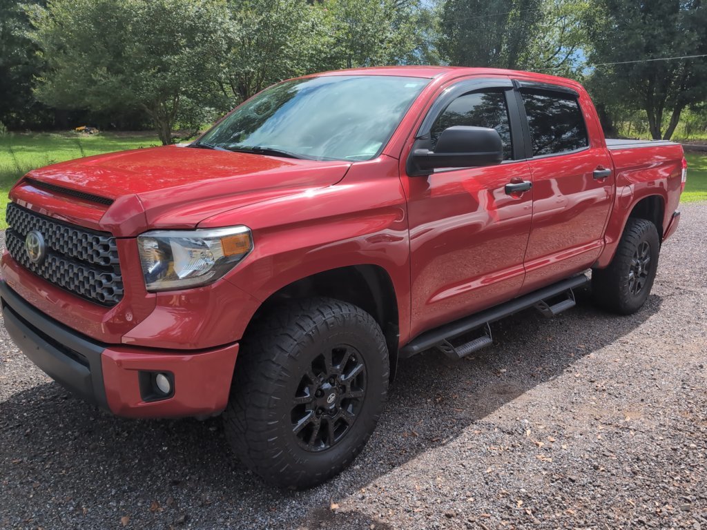

    I have 6112's on the 3rd setting and Coachbuilder Shackles+2 on the rear with 295/70 18's6a2d6fbc-239c-40af-8b7c-fa2c9c69595d.jpg

    Have a link to this one? I need to replace my wireless Toyota one with a MagSafe version.

    https://ebay.us/m/sQXj0E
    Link from eBay

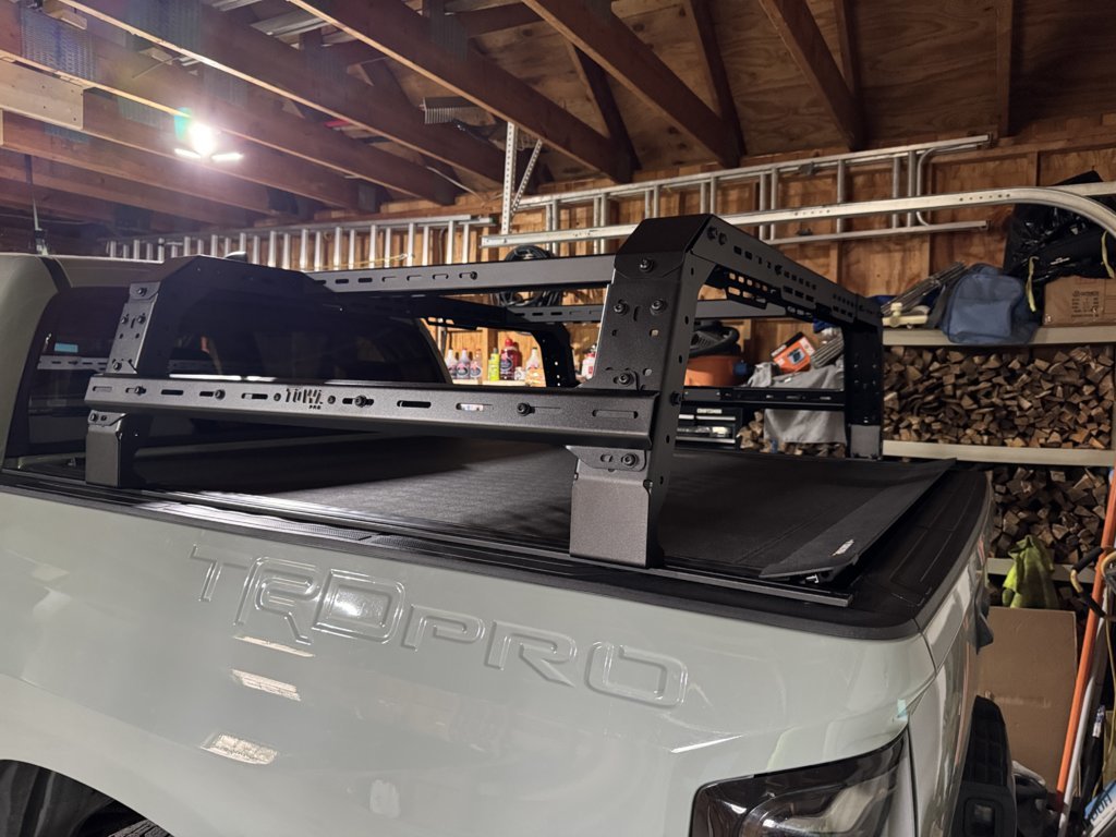

    Added a TUWA rack for my tent after installing a BAK Revolver X4ST tonneau cover. Keeping my Diamondback cover for winter. It was hard to get stuff out of the truck bed with the tent on that cover. The BAk Revolver gives me easier access to the bed when camping. Should take more pics but feeling lazy right now! Lol!

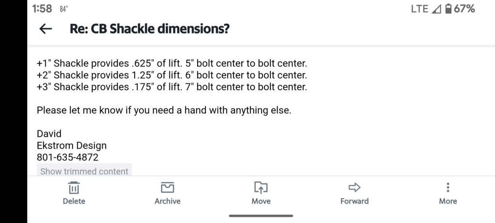

    Did you add any Shackles to the rear? Coachbuilder+2 will give you a little over an inch or drop the 5100's down one setting
