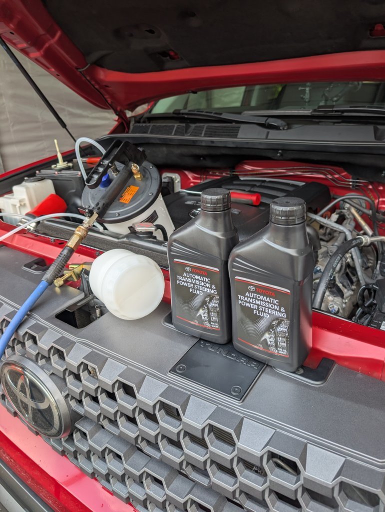

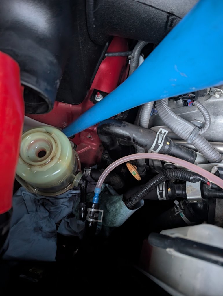

    Not too bad and used almost 2qts. I had plenty of shop towels to catch spillage.Tools needed:
    Vacuum pump/ bleeder with attachments
    Rags
    Pliers for the stinking clamp
    2qts of Toyota Transmission and Power Steering fluid (not WS)
    Air supply for the vacuum pump
    I also have a Stillen CAI so I had to remove the tube for the front air dam to access the lid for the power steering so flat head screwdriver for clamps

    Try to find an attachment that fits the power steering line fairly snug or it will suck air and take a little longer :)

    My Four Uncles vacuum was actually a brake bleed kit but hell a vacuum pump is a vacuum pump but all the attachments are for a brake bleed which is next

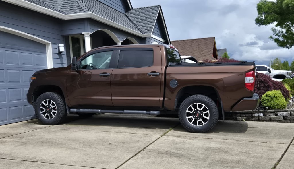

    Here’s the current setup which is still a dual resi shock setup. But the new kit has some bigger benefits. Stronger, longer shocks/larger shocks, more travel etc

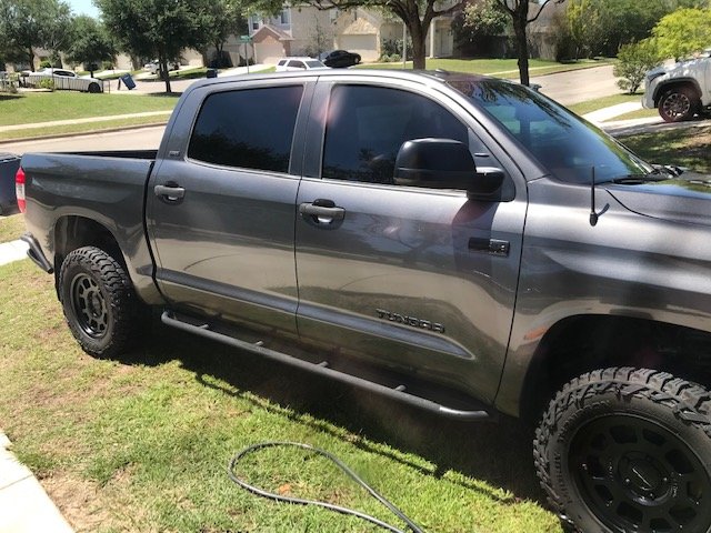

    What are the running boards on your truck? Link?

    These have been great for me; I put skateboard grip tape over the steps and have to replace it every year or two. Takes 5 minutes. But these are sturdy, the powder coat has held up exceptionally well and couldn’t be happier (especially for what I paid). YMMV

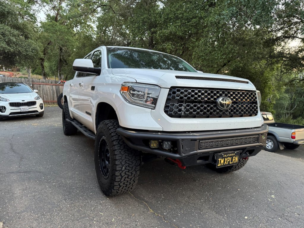

    I picked up both pairs of shocks for $2500. The coilovers are tuned by Accutune and have the 500lb Eibach springs installed (stock 700lb Fox springs came with/included in the deal). Rear shocks are stock Fox valving etc..
    Dude threw a pair of TC upper arms in for $500 everything had less than 2000 miles on it. Not sure if I am going to install them yet or not.. The truck really isn't lifted all that much maaaybe 2". This truck is my daily driver and I am so happy with the way it rides and drives.
    I will say that when mounting up the new wheels it seemed like the new lug nuts only grabbed like 3-4 threads of my wheel studs before thet were ready to be torqued them down? Seemed a bit scary.. Anyone else out there experience this??

    Not sure where you're located but I'm going to be pulling the Toyota nerf bar style steps off my 2020 double cab if the rain stops for a few daysPXL_20250328_154603021~2.jpg . I like the Tyger steps Shawn has but it looks like they're only available for Crewmax trucks. If you're in the northeast and are interested in the ones I've got.

    here you go:
    https://www.vividracing.com/tyger-a...MIus-ii_SijQMVP2dHAR0JUxVNEAQYAyABEgIG8fD_BwE

    @Stone Chingon' Sweet set up! Not sure which brand of wheel? Method, Racine, SSW? I would reach out to the manufacturer and ask about lugs. I hit up Method about torque and my MR701's are 85-91 foot pounds with a minimum of 7.5 turns. Make sure you have the right type of lugs as well.
    I recently had UCA's installed and it made a night & day difference on handling- I recommend getting those on.

    @UTAHRTK Thanks man great feedback. Wheels are Raceline "Rouge" +35 offset ya I need to get ahold of them and let them know my situation.
    And I'll probably give it a little more time before I decide to install the UCA's or not.. Everything just feels great currently Thanks!
