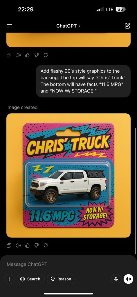

    I used the ChatGPT app. These are the screen grabs of what I asked for to get the picture to give you an idea of what you can do.

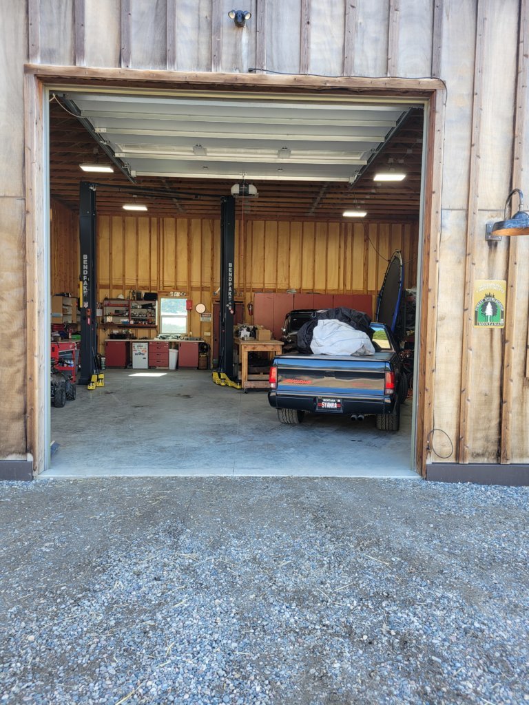

    I see a lot on this graphic, but where are the posts for the lift? What am I missing?

    This is what I’ve been thinking for when I build my shop. It’s going to be a combo woodworking and truck wrenching shop so putting a 2-post in the middle just doesn’t work. And my FIL had a two-post and it was frustrating for all the reasons you just mentioned.

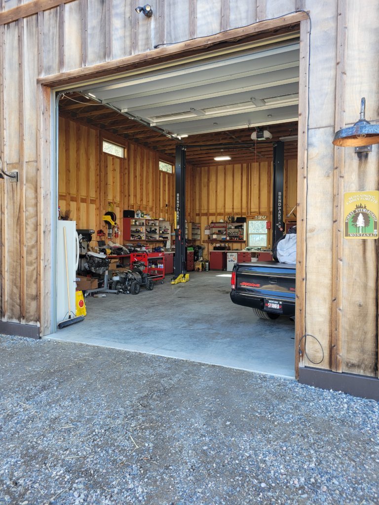

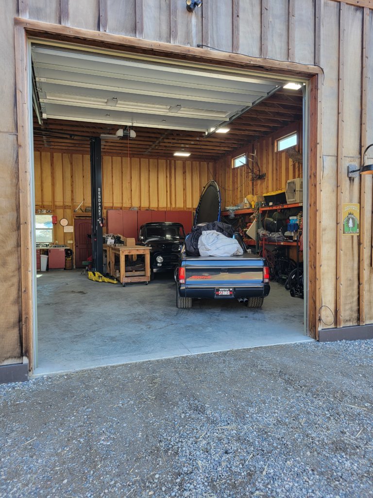

    Yup, sorry about that...the blue rectangles represent the columns for the 2-post...north west corner (upper lefthand). I poured 12" concrete in the upper left "quadrant" of the shop so I had the entire area to make adjustments on lift placement. One only needs thicker concrete than 6" if it's new construction; concrete older than 3 years will be cured and hard enough to work. Having taller ceilings allows you to use the "Z" axis for storing cars, too...I'd consider a 4-post with movable posts for the $600 up charge so if you need, you can move it around outta the way.

    So you pull in between the columns so they are still blocking your doors? What's the advantage of making it catty corner in the garage/shop?

    I gave it much thought. I just could not bring myself to install my 2 post lift at an angle. My OCD would not allow it.
    My only requirement was having enough distance to pull the wall side axle.
    Tripleconpanna likes this.

    You gain feet of room and maneuvering over squared up...doesn't block any doors...
    The back service door is 8ft from the column...

    Oh, OK. I see the benefit. I was thinking of something different when I first read your description.
