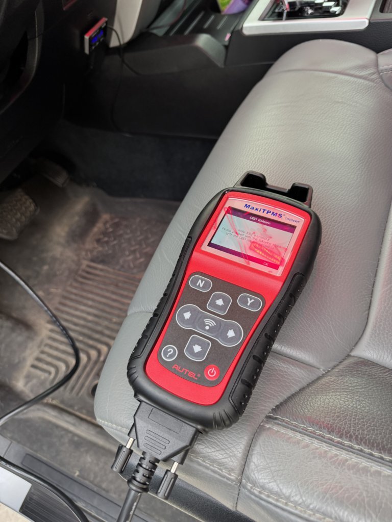

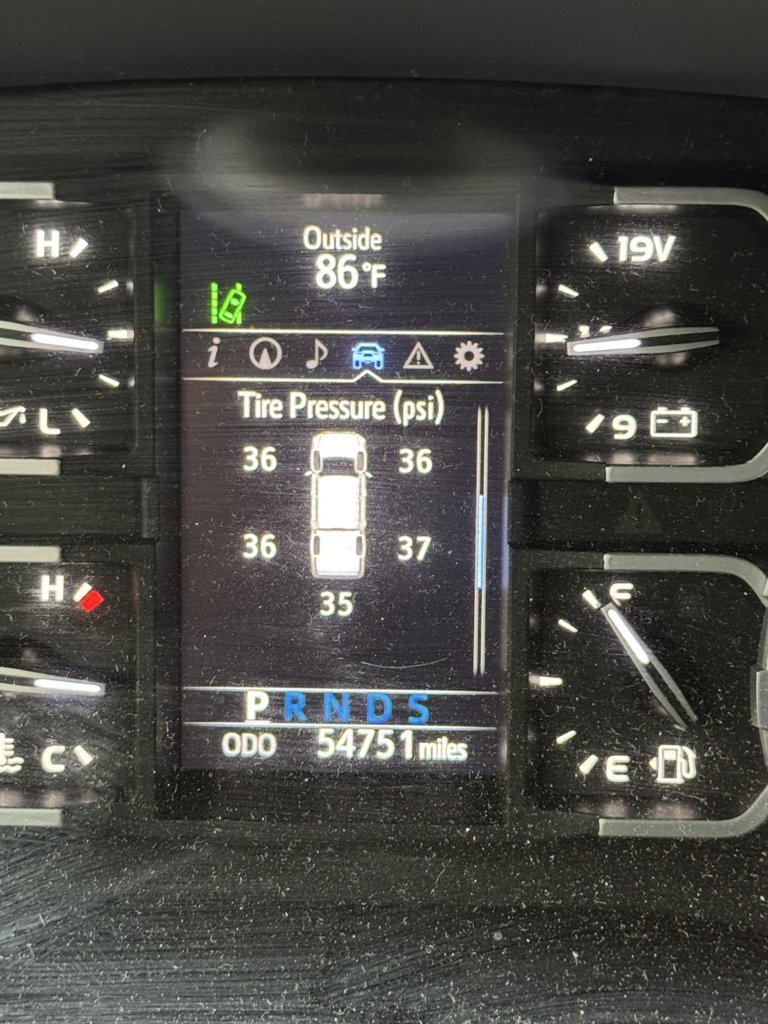

    Used my new Autel to perform the TPMs relearn and add my spare tire pressure to the display. Started a five tire rotation a few days ago with the new tires so will perform the relearn each time.

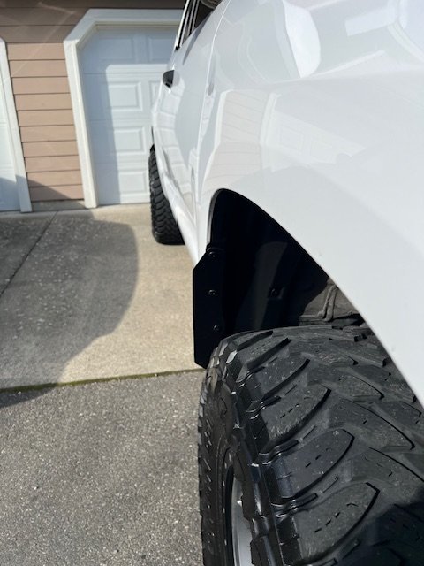

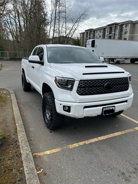

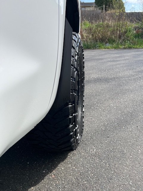

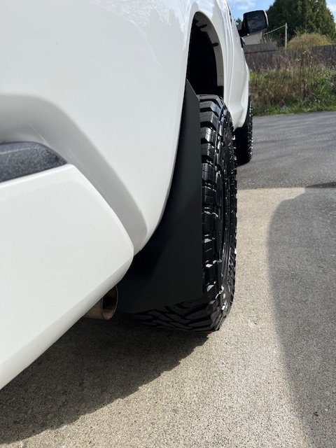

    Not today, but this weekend I finally washed my truck for the first time in months and added some Ark Micro Flares and rear mudflaps. Love the look, low profile and nice styling.

    Damn they're proud of those SOB's

    Nice! I've been eyeing that combo with the micro for the front and the full size for the rear. Looks sweet :thumbsup:

    Not cheap but Amazon put it on sale so it was sub $200 for a bit. If I use it every time I rotate the tires at home for the next couple years it will be well worth it. The TPMS button doesn't work worth a damn.

    Definitely happy I went with the full rears. I thought they would look large relative to the fronts but I think this should be the standard kit tbh. I'll get some more pics this weekend in case anyone wants better lighting/angles. I want to get a build page started since I got so much inspiration from others pages.

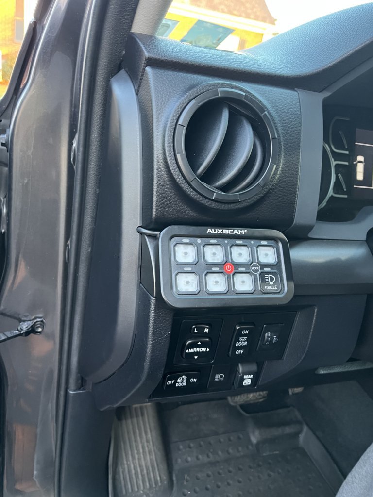

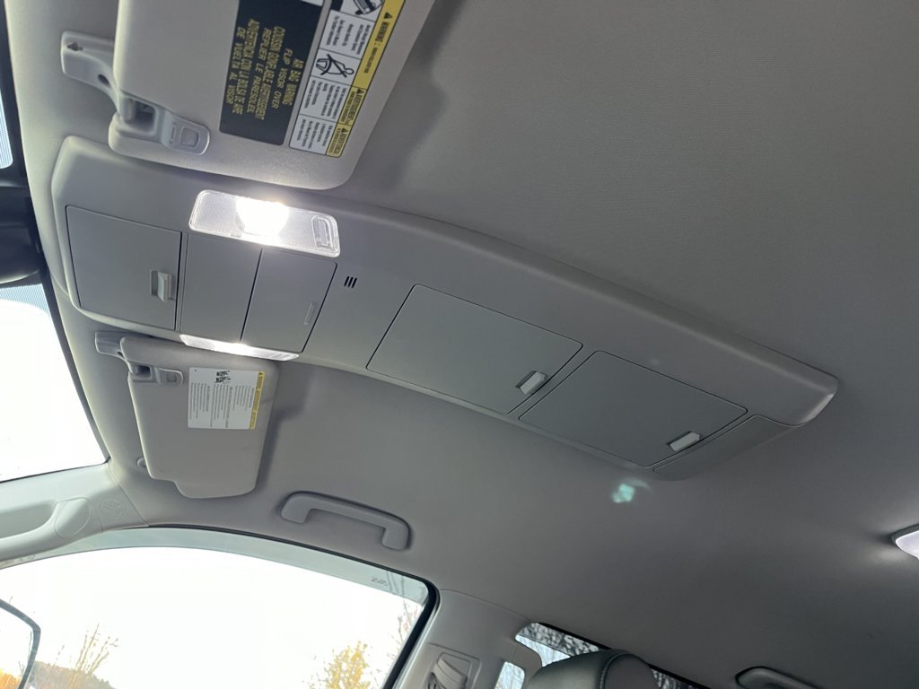

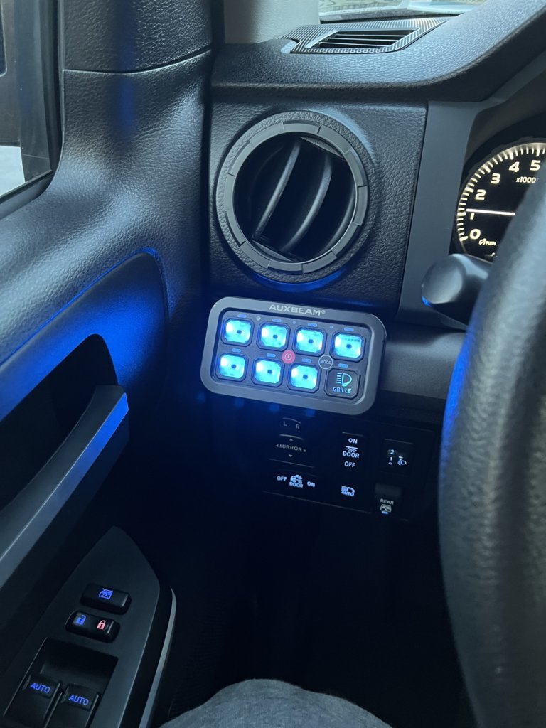

    Got the full length overhead console installed along with an AuxBeam 8 switch panel.

    Hell you can get a 12 pack of tacos in that overhead console :)

    That would be nice. What is the model # on that?

    Autel TS508WF This model can get updates via WiFi so no need to plug into a computer for updates. Looks like Amazon still has it on sale and I think for about $9 less than I paid. I tried to read the manual but it was easier to watch a couple of YouTube videos on how it works.

    Cool, thanks for the info. :hattip:
    No problems with it recognizing the sensors?

    No problems at all. Four of the sensors are the original OEM that came on the truck and the spare one is OEM I bought from the local dealer before my new tires went on. Since my spare just had a standard rubber stem I also had to buy the fitting kit from the dealer which is a the rubber washer, metal washer, and the tall nut for the TPMS stem. I already had a TRD OR wheel takeoff as my full size spare so other than being very dirty from under the truck for 50K miles it worked out great.

    I've been looking at these but am curious how it attaches. If you can get a picture of the fronts from inside the wheel well I would really appreciate that.

    I got one of those autel. How easy was it to add the 5th tpms to the display?

    easy if you have push button start, simply scan the sensor in your spare after you scan the other four and the OBD rewrite will take care of it. doesn't seem to work on keyed ignition vehicles.
