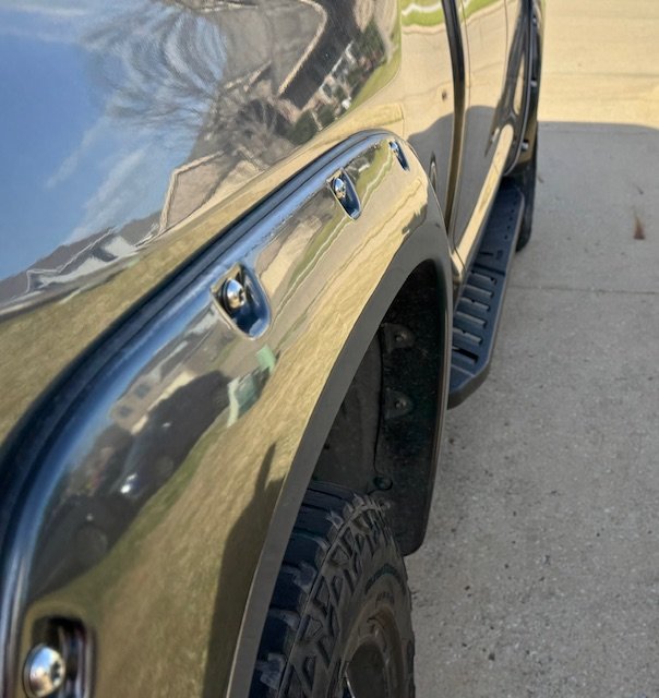

    Magnet is a great idea... my plastic ones crapped out on me probably a few months after install. I called customer service and they advised it was a known issue and sent me the new design, which are metal slide in units but the 'clip' is made of a fairly dense rubber...
    So far, so good... but if the rubber ones fail or end up stretching out, I'll be stealing this idea from you!!! :hattip:

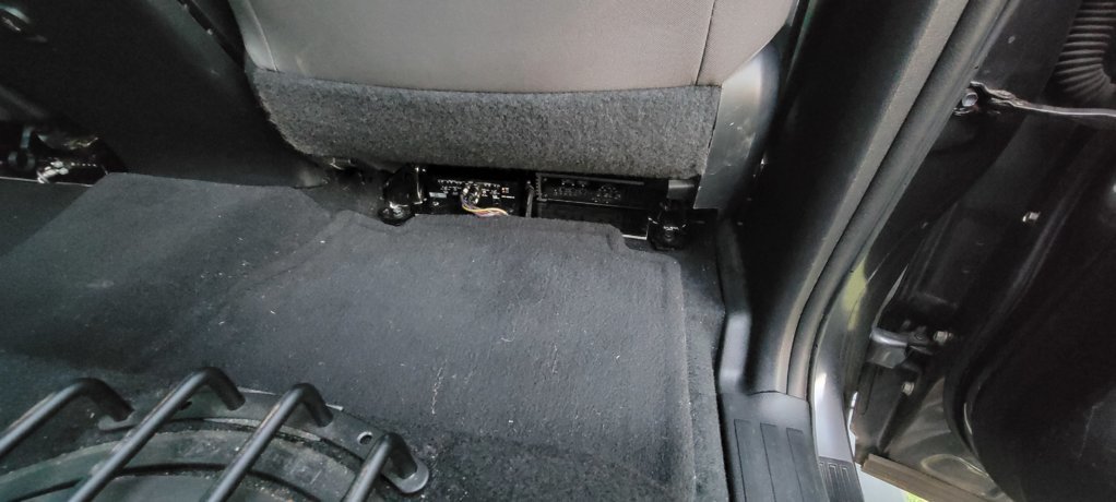

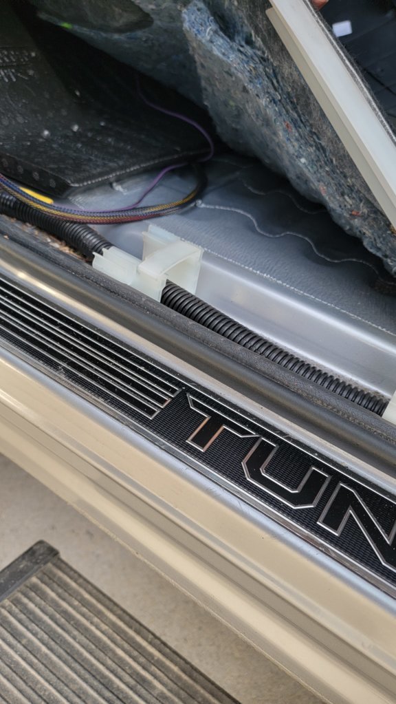

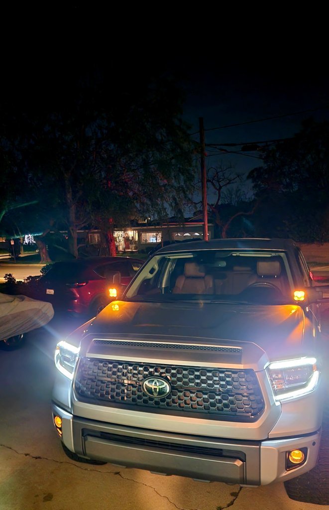

    Diode Dynamics SS3 Pro Amber ditch lights and also amber Elite fogs came in yesterday. Got them installed tonight after work.
    Ran the wires to the grommet underneath the drivers floor. I didn't want to cut the firewall grommet yet.
    Currently I have the amber backlights turn on automatically when I turn on the truck. I'll add a switch to them later when I figure out what switch set up I want to go with.
    These are the back lights and drls only.

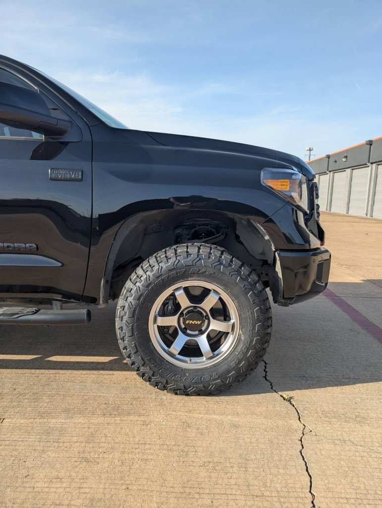

    Nice wheels, Dustin @ FNWheels is pleasure to deal with

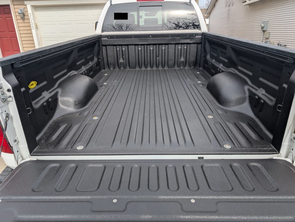

    Linex bed liner, Retrax roll-top bedcover, Ranch Hand Summit brush guard, SDHC ABS sensor guards, Interior LEDs, Cargo lamp LEDs, Reverse Light LEDs, Rear TRD sway bar, Valhalla's Shield Cat plates, Husky floormats
    Added Road Active Suspension (heavy duty) to the 2018 Platinum Crewmax (stock suspension).
    Ground to uppermost radius of rear wheel arch = 38.25" (stock) and 39.75" (after), I used the black disc.
    Had my son and son-in-law do it for me. Two beers and 50 minutes including putting up all the tools.

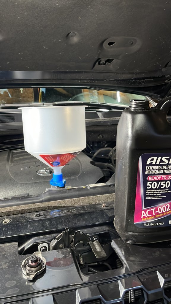

    DD ss3 max led fogs. interior and exterior leds swapTRD Shift knob.
    Coolant drain and fill. At 51k already. Feel better about it now.

    I ordered coolant, need to order the no-spill funnel next. I'm waiting another month or so for warmer weather to do mine, plan to do the power steering as well.

    If you can, get the rubbery hose like the one i have draining into the homedepot bucket. It slip over the draining port real easy and no need to drop the skid plate. I tried using the 3/16 and 5/16 ID clear hose and they do not fit. The 5/16ID hose was used on the passenger side port. It was loosey goosey. Got it done but it dripped some on the floor, little extra clean up.

    What was the size of the hose that fit correctly?

    So probably get a 1/4" ID hose for the block drain then?
    What size hose fit the radiator drain?

    I’d say 3/16ID if rubbery, will fit fine. I can get the size tonight after work.

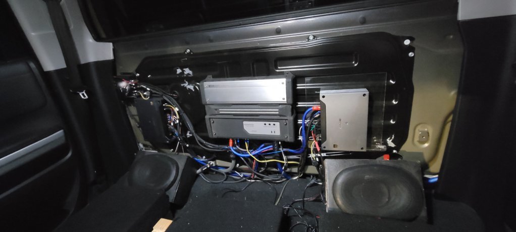

    Got everything moved, rewired and going again changed out the kenwood sub amp for an audiocontrol epic2000 and one of the kenwood 4 channels for a stinger mt600. 20250319_194551.jpg 20250319_194651.jpg 20250319_194714.jpg 20250316_202343.jpg

    Damn that looks nice. Perfect setup
