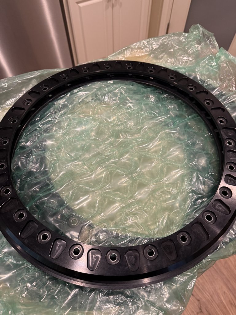

    Didn’t love the other protection rings so swapped them out.

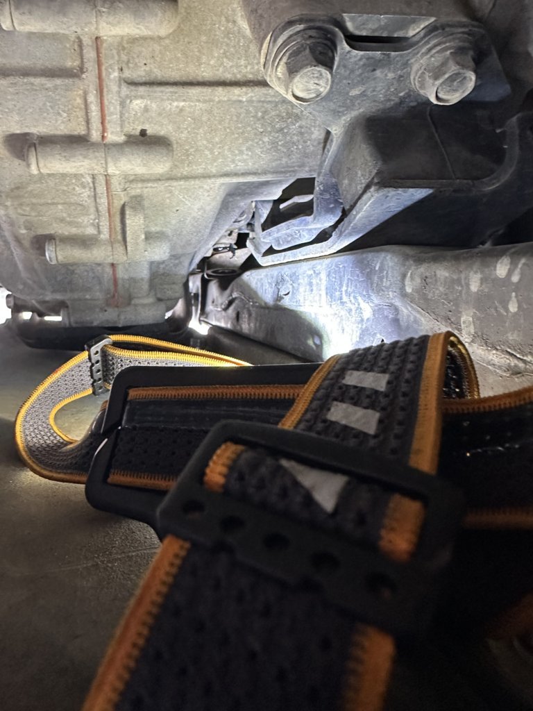

    Greased the u joints. Had to get creative with the one going into the front of the transfer case due to the RCI skid plates.

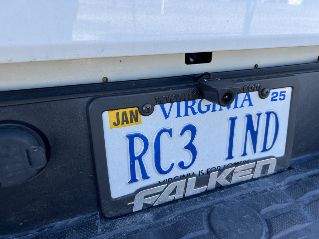

    I have an 840s and a softopper - I mounted the rear camera right at the top of the license plate frame and drilled a small hole in the plastic bumper cover to run the wire. Will post a pic shortly but it works great with the cameras large field of view.

    I wanted to get it in that gap under the tailgate but it barely hits when fully down. This is more than likely temporary but better than I expected.

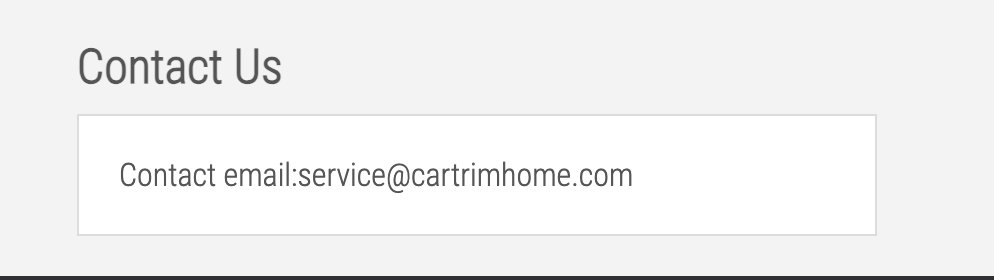

    Only contact on their website. They have a youtube installation video or two, could maybe message via that as well. Good Luck. I think mine was a week or two until delivery before Christmas.

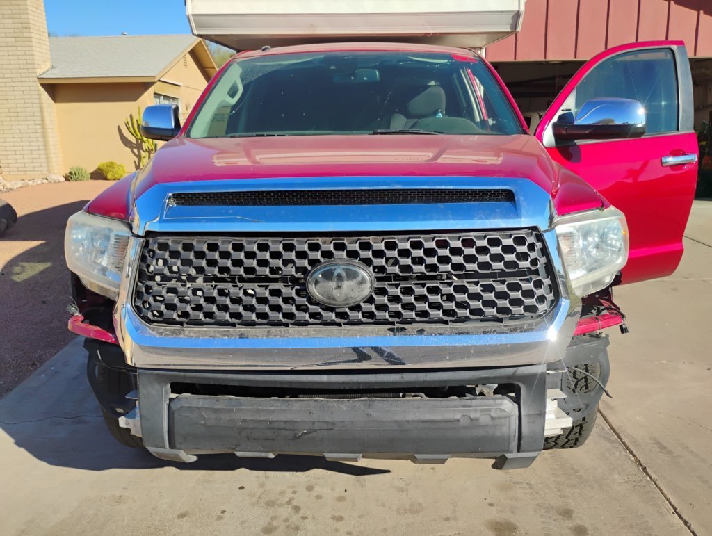

    Before and after courtesy of @Bergmen
    Thanks again for the smokin deal!!

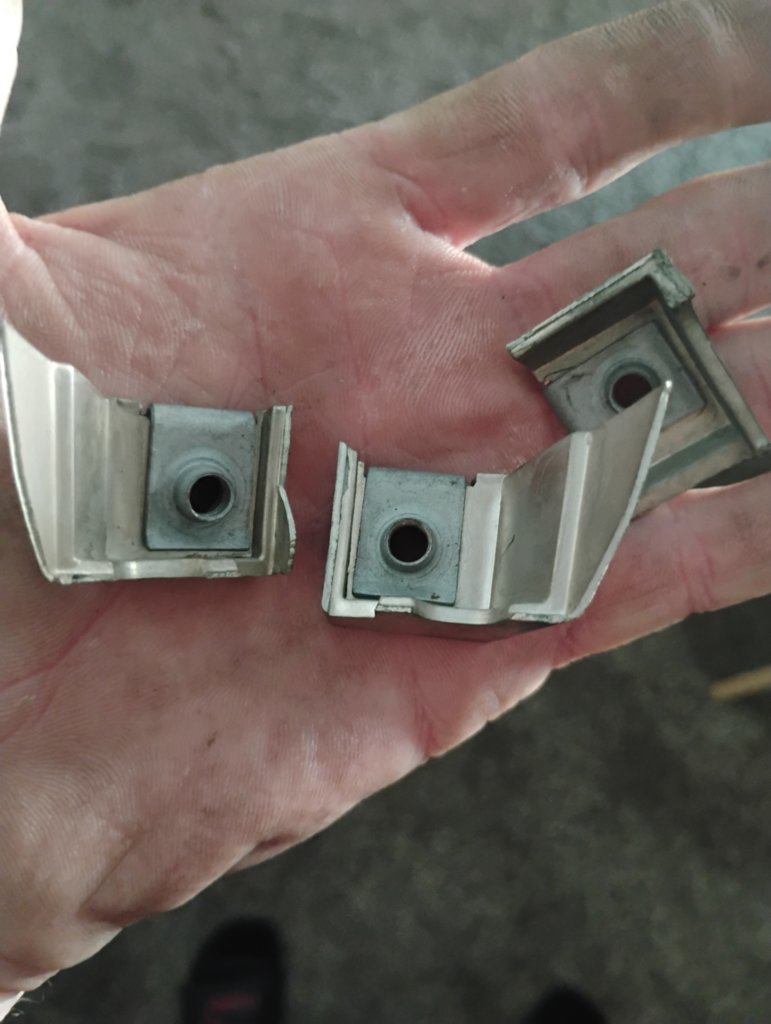

    Oh ya, this was all that was left of the original. Gotta admit it was kinda funny when it happened, that thing LAUNCHED itself across the highway and up an embankment into the great beyond. LOL

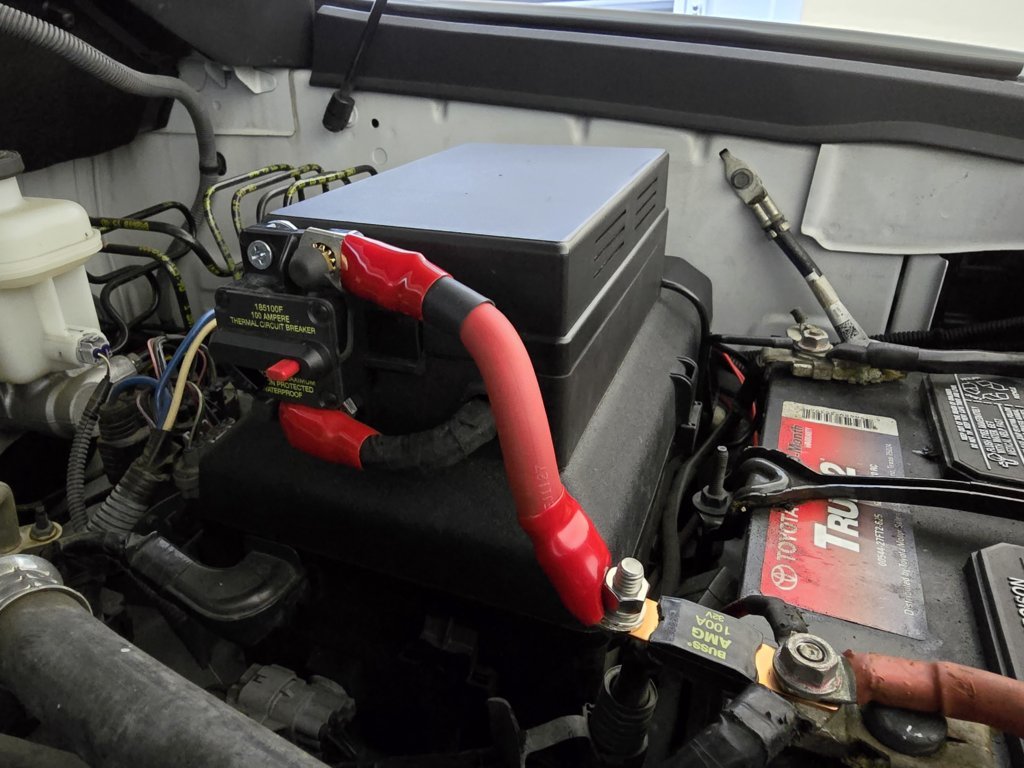

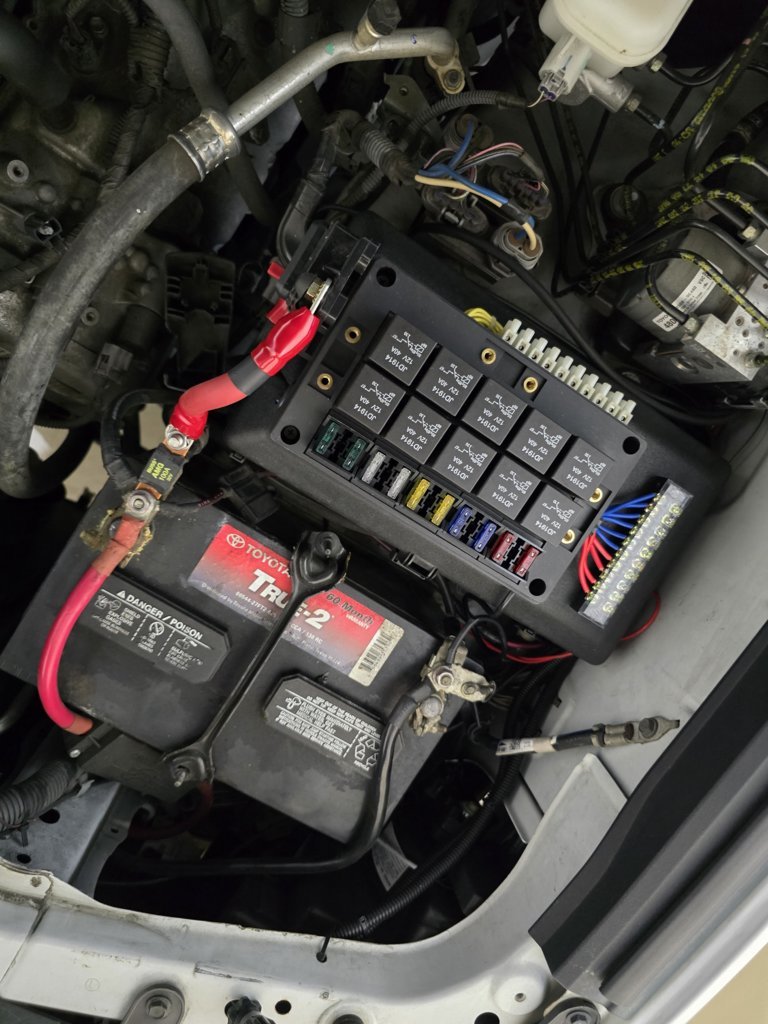

    Quick update:
    Connection to the battery done.
    Top view
    Top view without cover

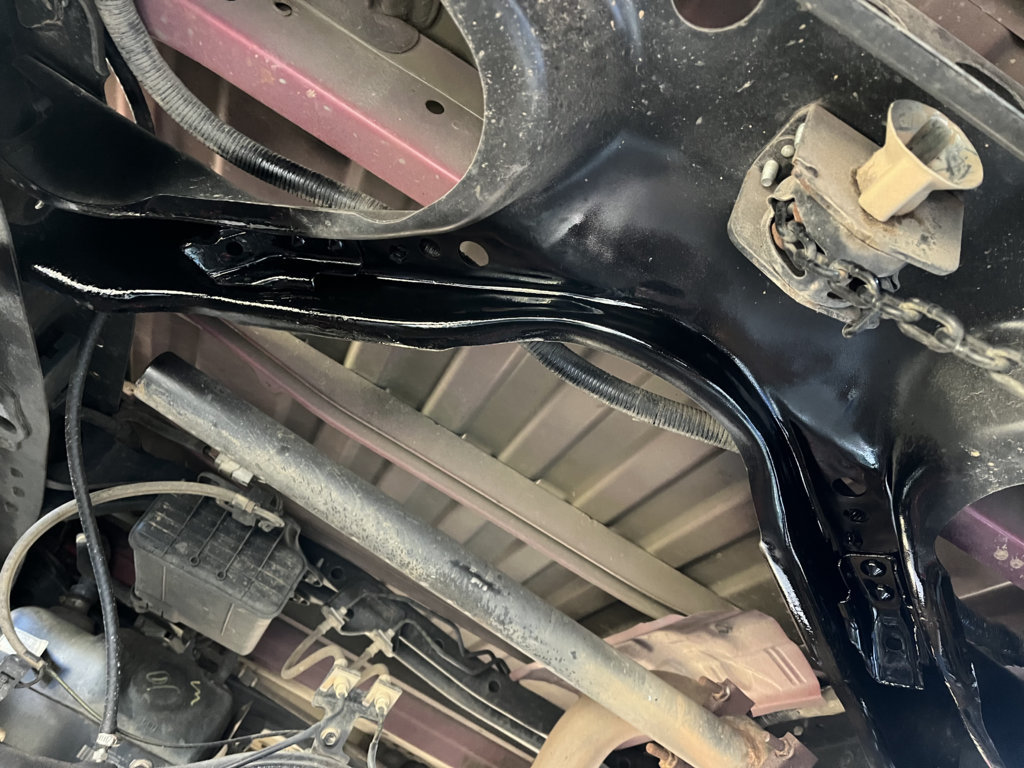

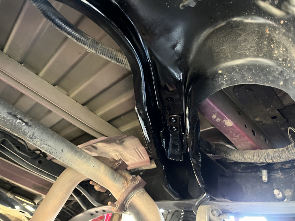

    Trimmed off the guide tabs and touched up paint so I could fit a 295/70R 18 in the spare tire space.Tight but it fit IMG_20250115_165746.jpg IMG_20250115_165741.jpg IMG_20250115_165655.jpg IMG_20250115_165700.jpg

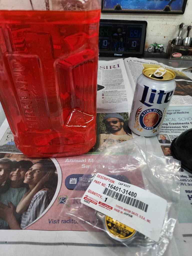

    Did a coolant and power steering fluid exchange today after 11 years and 75,000 mile (don't judge me). I did it my way (lazy), drain and fill, not flush, kind of like the transmission. Coolant drain from the rad, a bit over 1.5 gallons and will do again in a few months. For the power steering, I got a bunch of big syringes from Amazon and used them suck out all the fluid (TWSS), fill, start truck, turn wheel a bunch, repeat. Anyways, that's my lazy ass way of doing shit, better than not doing it at all. Old coolant looked brand new, power steering fluild was a bit dark but not bad.

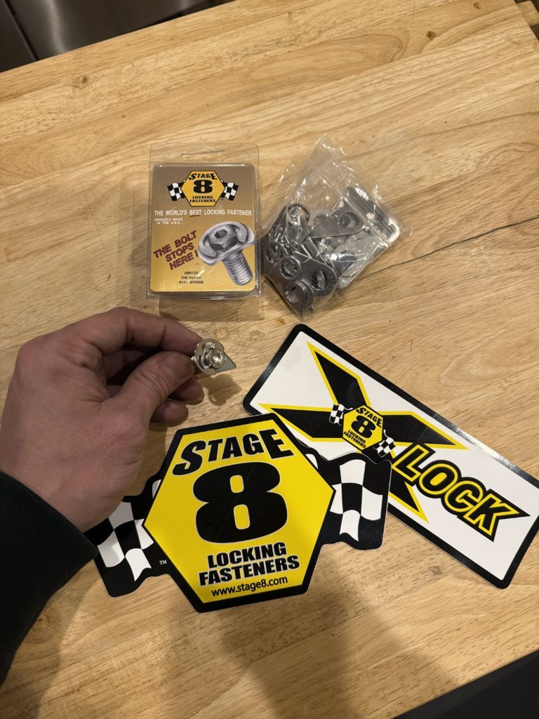

    Stage 8 header bolts arrived. Waiting for the headers should be in sometime this month allegedly.
