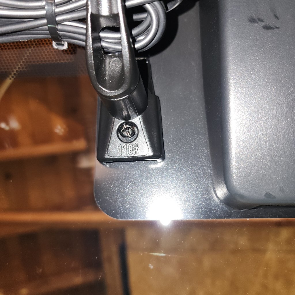

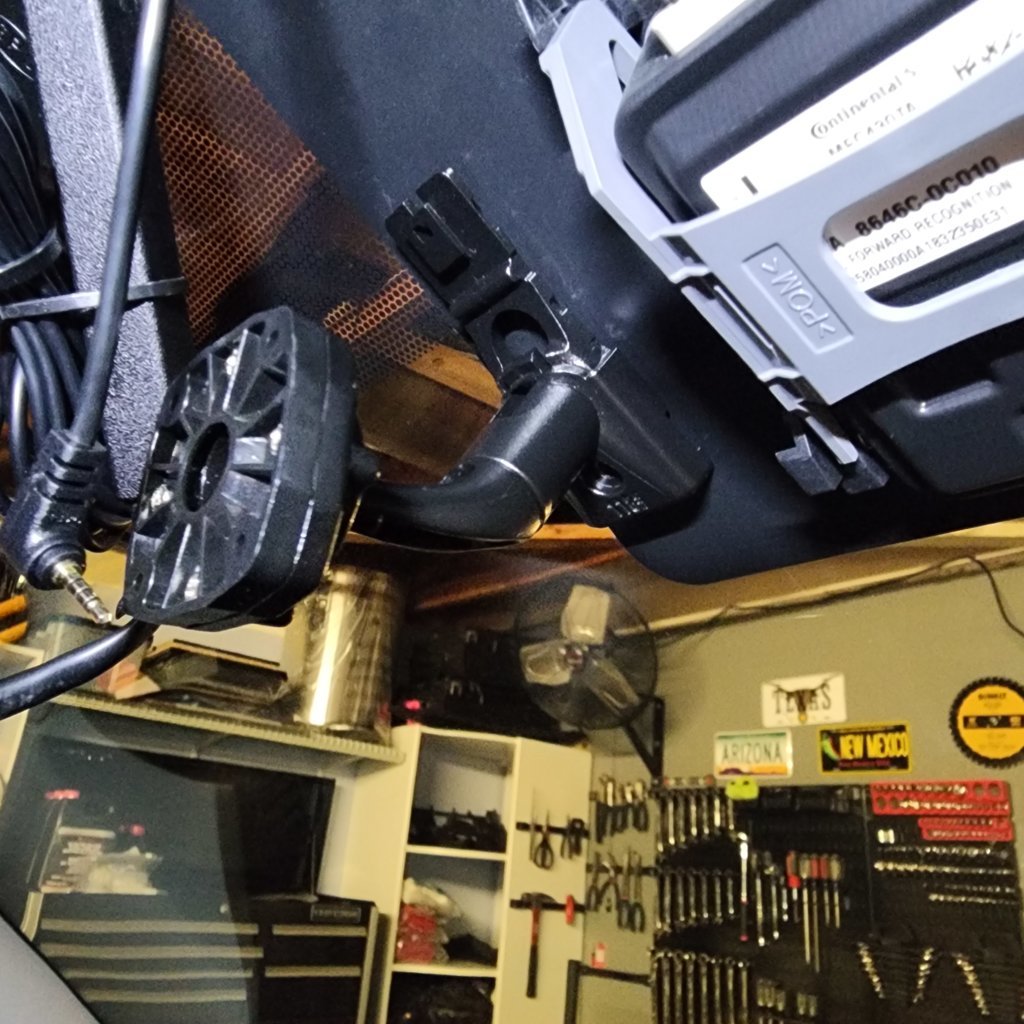

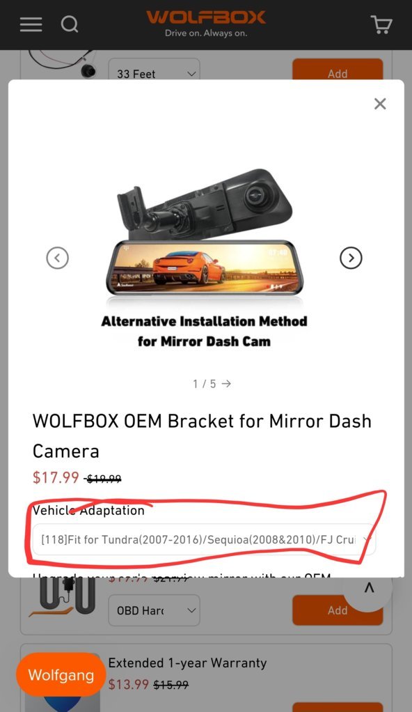

    Very good, I called Wolfbox to get a couple questions answered during my install, they told me they don't currently make a bracket for my 3rd gen. I'll check the website here and there. Thanks for the update.

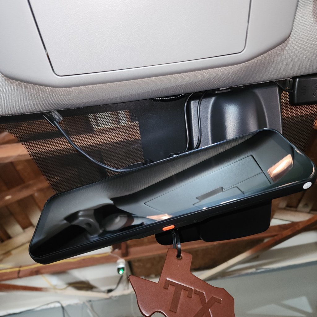

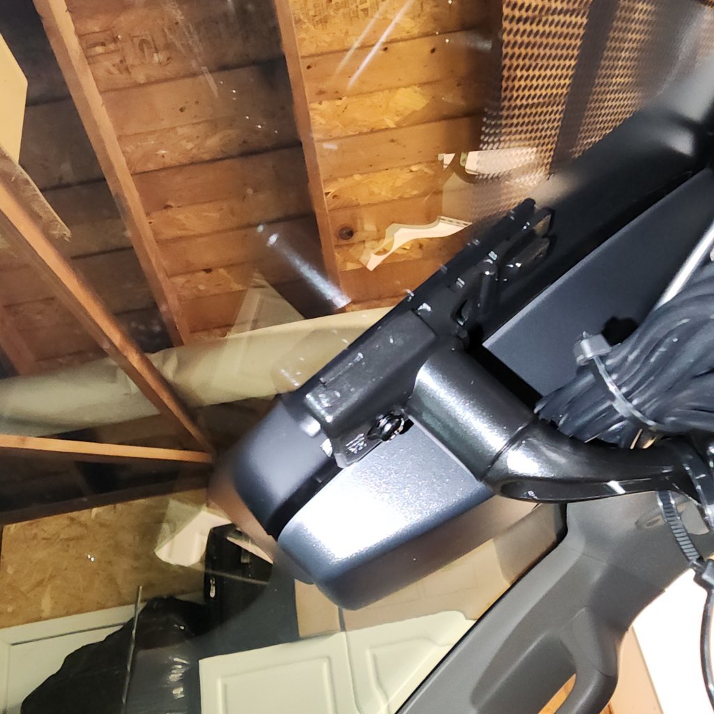

    I did the same thing. I gave them a call and they told me the bracket doesn't exist for my truck yet but I went ahead and ordered one anyway and it worked. :thumbsup:

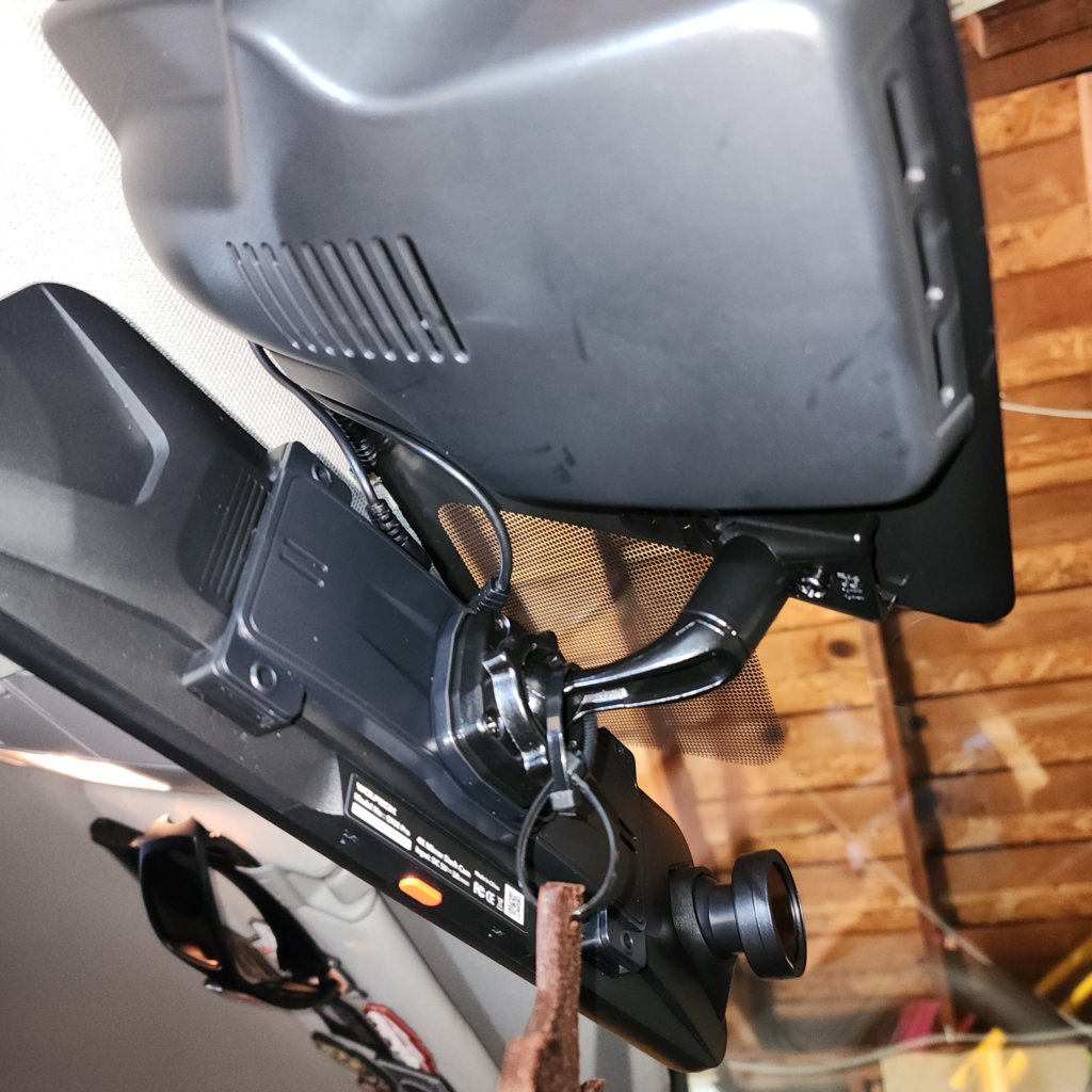

    Does this replace the original mirror ? Does it plug into the factory mirror plug

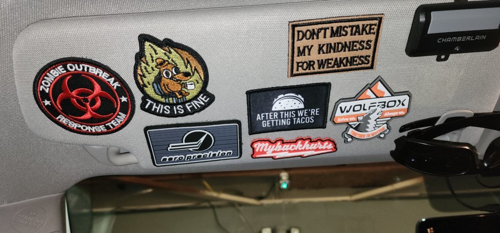

    A word of caution, the patch game is a slippery ass slope...

    Yes, it will replace the factory mirror by either strapping over it with supplied straps or if you decide too buy the OEM bracket from WolfBox(sold separately), it will completely replace it all together. Either way, you would lose functionality of your Toyota Homelink if that is your concern. It does not use the factory mirror plug so you would need to tuck that away.

    Not worried about the factory mirror just want to keep it as clean looking
    as possible dont want a bunch pf wires and plugs if i can eliminate the factory stuff

    Oh yeah for sure, I don't really like the look of all those wires either. Check out my post yesterday..
    https://www.tundras.com/threads/wha...5-gen-tundra-today.713/page-3303#post-3814323
    Hope I linked that correctly but yeah you'll definitely have at least 1-3 wires coming down from your headliner to plug into the top of the mirror. I say 1-3 because 2 of them are optional(rear cam and GPS) .

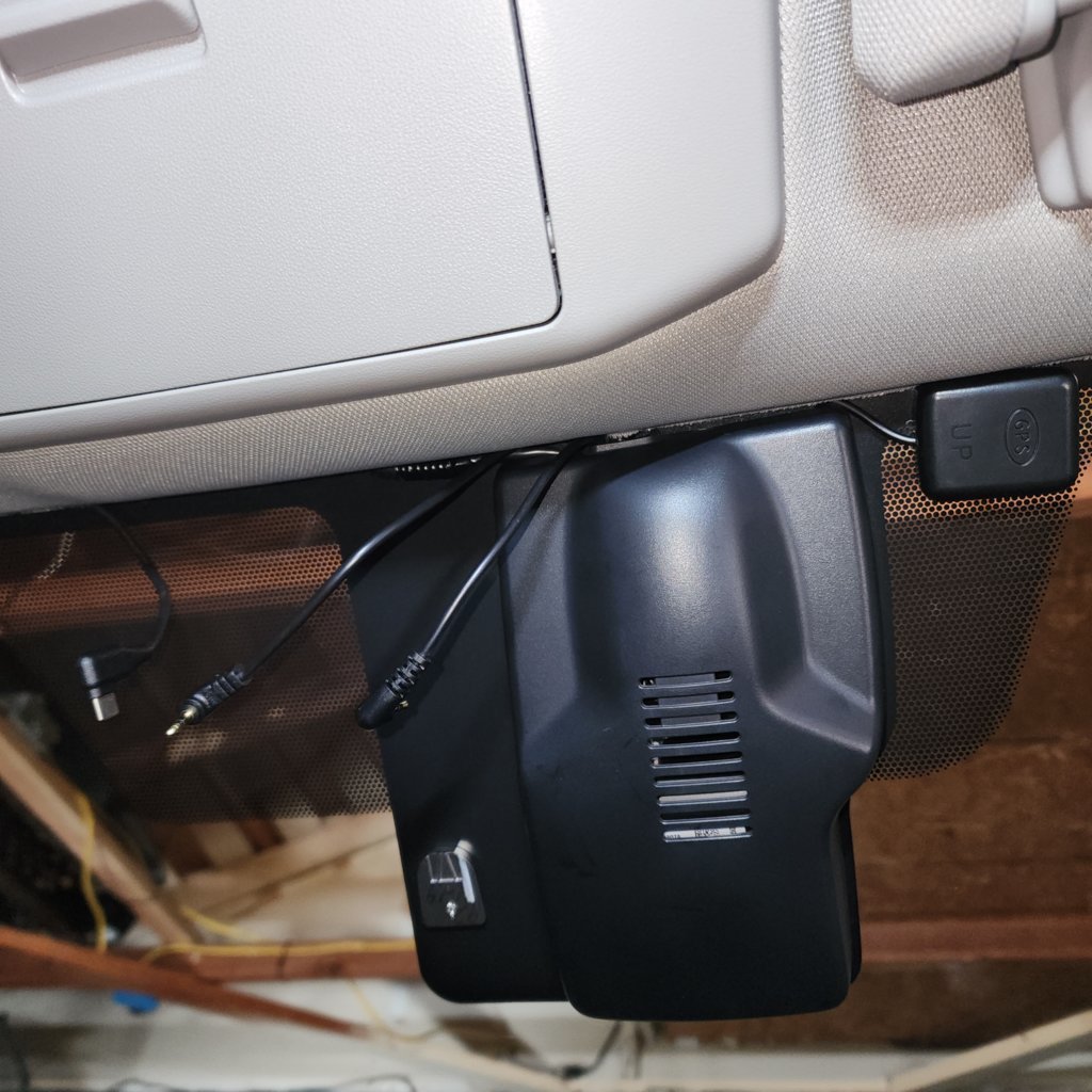

    Is that black box in the picture u linked the gps?
    What is the purpose of the gps for the mirror cam ?

    Yea, not my girlfriends favorite. It's over on my side so that the kids don't read it lol. There's a few other good ones scattered in there.

    Yeah, the small black box in the top right corner is the GPS. It provides information on the mirror itself as well as the video playback. Provides GPS coordinates, speedometer, and compass all on the mirror. Each of those can be enabled or disabled in the settings. I'll snap a picture or maybe try to upload a quick video this evening.
