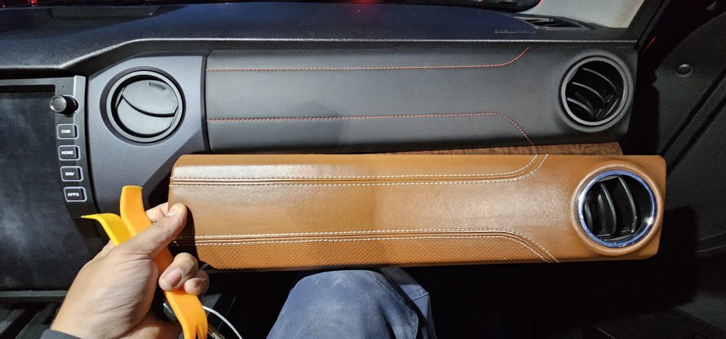

  11. Jan 4, 2025 at 9:41 PM

  12. Jan 4, 2025 at 10:13 PM
    68 RS/SS
    68 RS/SS New Member
    Aug 3, 2016
    #4073
    313
    MIke
    New Hampshire
    2020 TRD Sport DC
    Just saw this, if you don’t mind how much did the pro trim set you back?

    I believe it was around $180 part number is 55064-0C011-C4. Only issue is the air vent is chrome so I had to buy the black trim from ebay.
