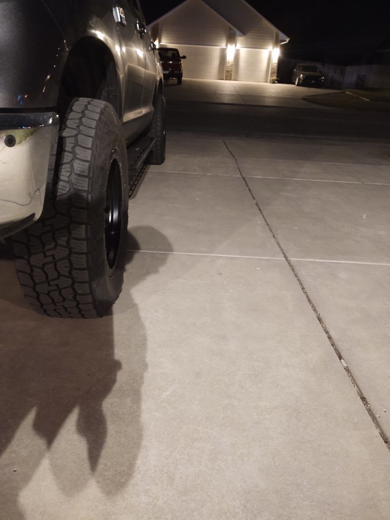

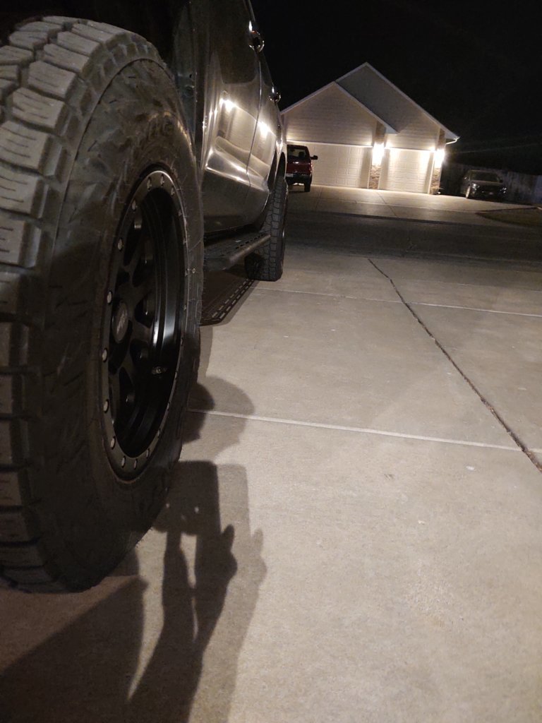

    here is some pics from the frontIMG_20241223_200959295.jpg IMG_20241223_200934095.jpg IMG_20241223_200959295.jpg IMG_20241223_200934095.jpg IMG_20241223_200935343.jpg

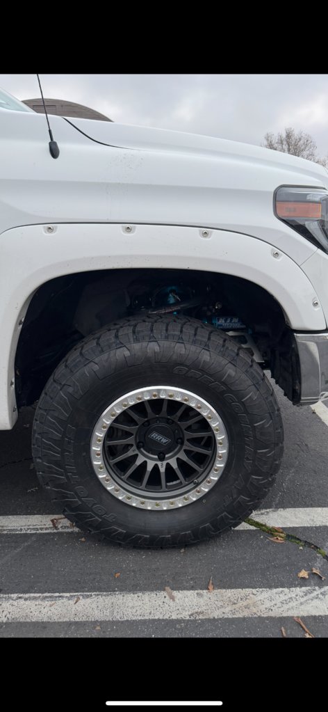

    CD8D6E05-B3DF-41CE-80B4-E3F182785E78.jpg IMG_8721.png IMG_8722.png Finally got my setup on. King 2.5’s, Camburg UCA, RRW, Toyo open country 35’s.

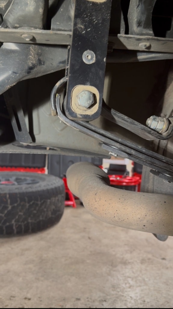

    For information - this is how the RAS interfaces with the Icon RXT leaf pack. You can see how the second spring turns up in the back and that keeps the RAS "hook" from properly engaging the eyelet on the top spring. It also pushes it up against the cross-bar on the CB shackle.
    So today I got back under there and played around with a few ideas. I ultimately decided to remove the RAS and stick with the Coachbuilder +2 shackles combined with the RXT leaf pack.

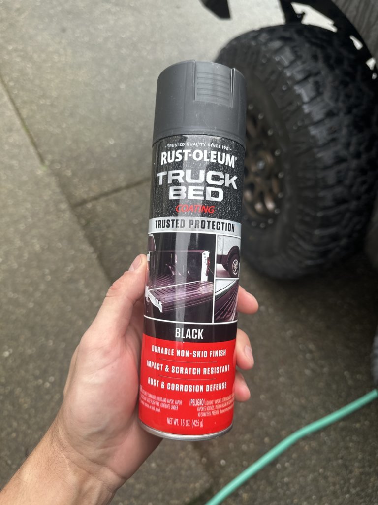

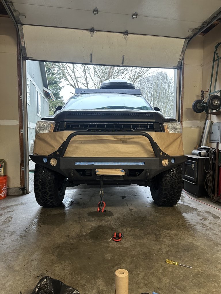

    Lightly sanded and bed lined. Bumper is like new. Waiting for the rain to stop to do the rear.

    No more ST Travis bumper???

    Which bedliner did you use?

    That is his original bumper. I’m just touching it up. Had a lot of rock chips.
