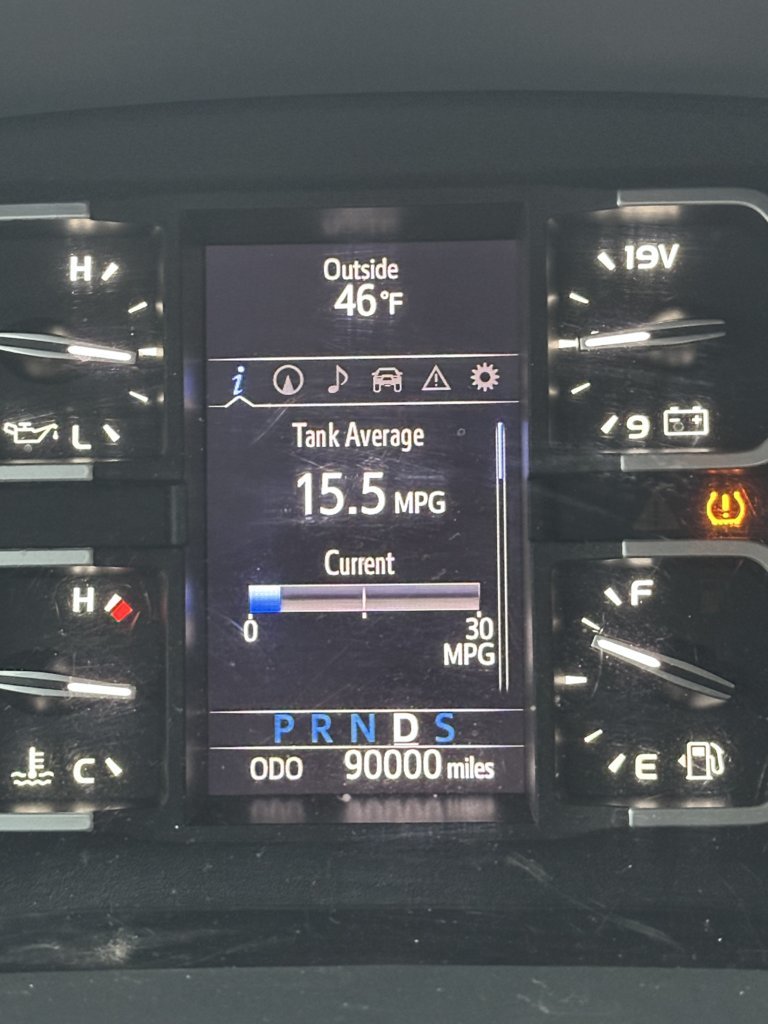

    Truck is off for at least 15 minutes. Key in position II (no engine started yet), press TPMS reset button located by right knee 3 times within 3 seconds. It will say "TPMS recalibration". Drive for 10-30 minutes at moderate speed, making a few left and right turns.

    Yes. The key is to see that recalibration message. And park for at least 15 minutes before driving to relearn IDs. You may need to erase error codes in TPMS module first. Battery disconnect will clear them as well.

    I was one step away from buying it. Forcing the truck into ID learn mode was not straightforward at all. The official procedure is rather long and it mentions weird things, like driving at 37 km/h (eh?) and avoiding backing up (eh?).
    What I did precisely:
    - found which sensor is bad with OBD Fusion + paid Toyota block. The bad one read very incorrect pressure and temperature
    - replaced the sensor with Toyota OE
    - erased TPMS codes with OBD Fusion, just TPMS. Erasing all codes will throw OBD monitor readiness out of window, and I'm long due for MA yearly inspection
    - key in position 0 then II
    - pressed TPMS reset button 3 times within 3 seconds, the tire pressure light blinked 3 times, the display showed the recalibration message
    - turned off truck, waited for 15 minutes (overnight, actually)
    - drove for about 10 minutes, the light disappeared, tire pressures were still dashes, but they went away in another 2-3 minutes
    Done.

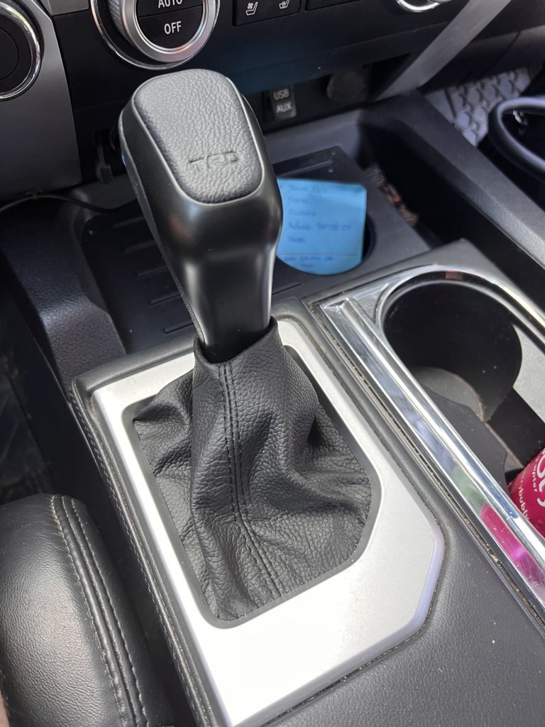

    The surrounding trim pops off easily with a trim removal tool. I used a leather boot that was referenced somewhere here on the forums. I can’t remember the details unfortunately. But it looks good, at least to me!
