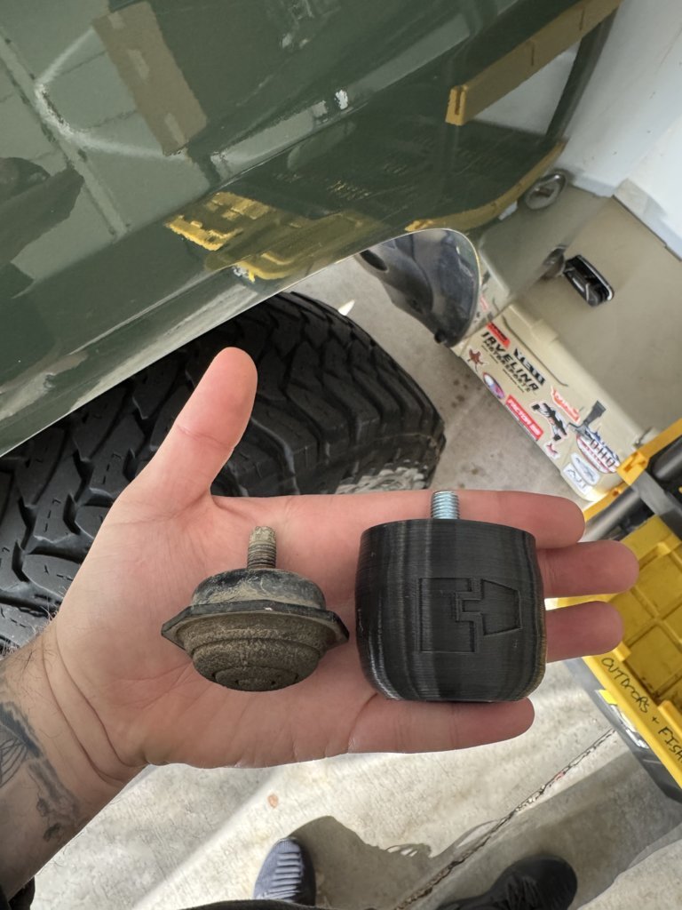

    Gotta teach them young lol. In my defense, just installed new ceiling lights from Costco in my son’s room. It’s the brightest room for a good picture.

    What tool and/or method did you use to remove the stock bumps? I've got a set of superbumps I need to put on.

    Just a set of channel lock pliers- they came off pretty easy.

    Big pair of channel lock pliers and for me it was easier with the wheel removed for more room to work

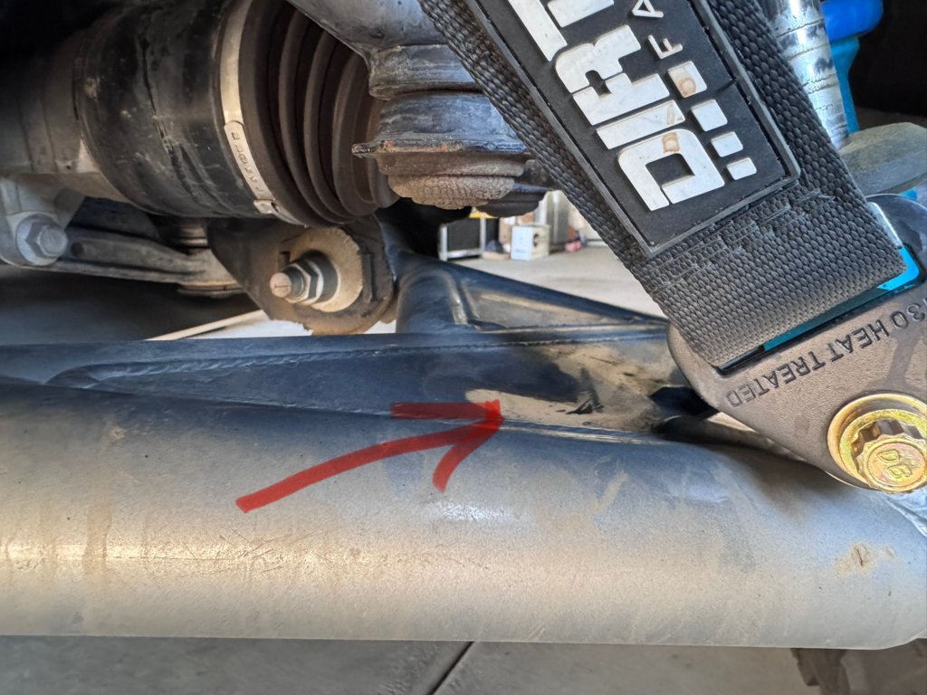

    I agree. Noticed a pattern resulting in damage on trucks used very hard, enough to remove mine (in hindsight there was no reason for me to have them with a secondary shock). Probably fine for most uses.

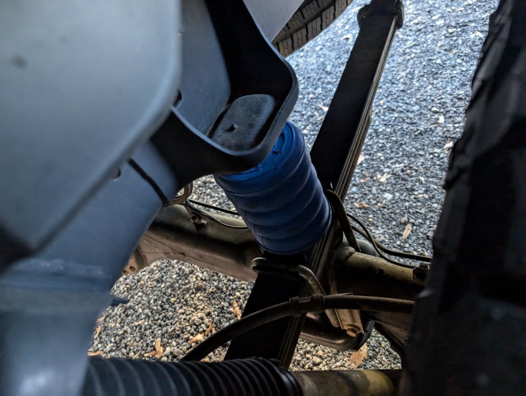

    I have 4 on the front of mine. Wheelers in the back and Perry parts in the front.

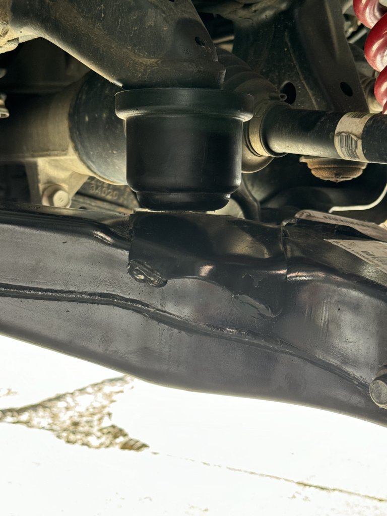

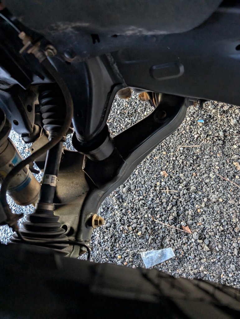

    I've got Wheelers Super Bumps up front and Sumo's on the rear PXL_20241020_212847189.jpg PXL_20241020_212833905.MP.jpg

    Pattern? What are you seeing? I went back and forth on trying to understand why the front bump stops only came with 1 for each side, but after discussing on here and with the vendor I was under the impression that was the intended use. Are there others suggesting the need for 4 up front?

    Broken motor mounts and bent frames, I did both when my truck was MT (3” lift Fox coilover) running aftermarket bumps. But again on trucks used hard, likely beyond the design limitations of the chassis. My truck is LT and heavily reinforced front and rear now. This is a pic from when I ran one of the popular bumps that dented (red arrow) a very strong LT lower control arm before the front oem bump engaged. IMO this supports the torsional load @Fobroader mentioned. No idea if 4 is the correct choice, never gave it a thought after reinstalling the oem bumps.

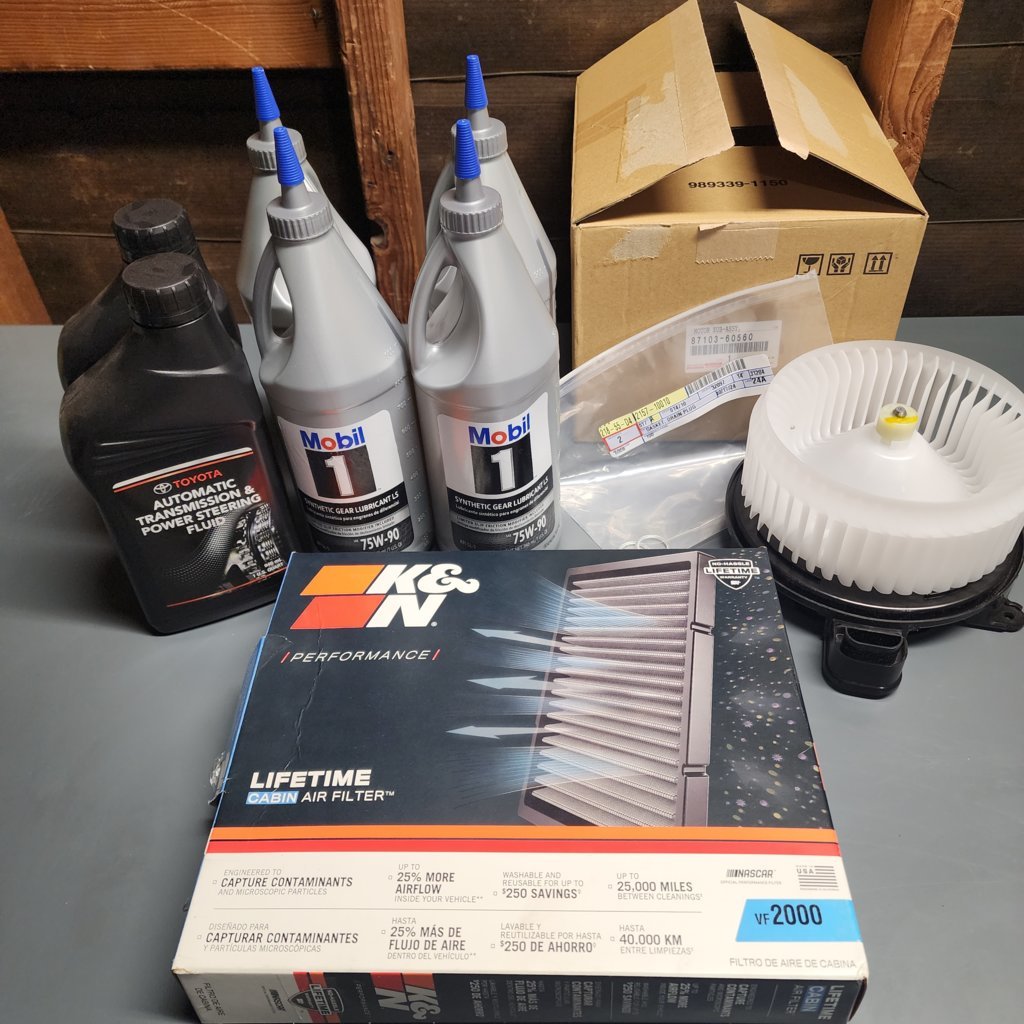

    Accomplished a bit of DIY maintenance today. Rear diff drain n fill, power steering drain n fill, and HVAC blower motor upgrade w/ K&N cabin air filter. :yay:
    Blower motor upgrade is by far an amazing improvement!

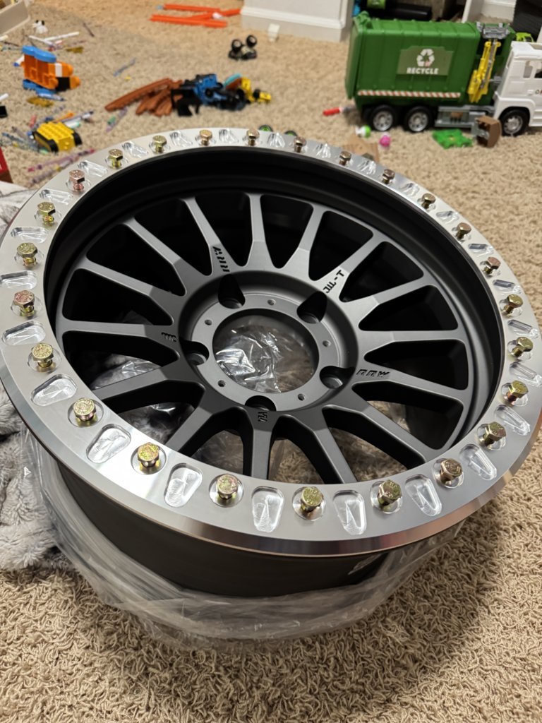

    Painted the sliders for the 4runner and picked up a brand new cvt mt Shasta for the Tundra. Couldn’t pass up the $500 deal!

    How was the Power Steering drain and fill? Been tossing around the idea of doing this soon as well

    Super easy! Get yourself one of those fluid extractors. There's a few good brands out there like MightyVac. I got this one by Four Uncles because it seems like you get more for less..
    https://www.amazon.com/dp/B0836GH3G7
    Then I used this video as a guide as it seemed to be the better of a few that I watched...
    https://www.youtube.com/watch?v=_FOYgaNMeZc
    Just make sure that the reservoir doesn't go empty while extracting.
