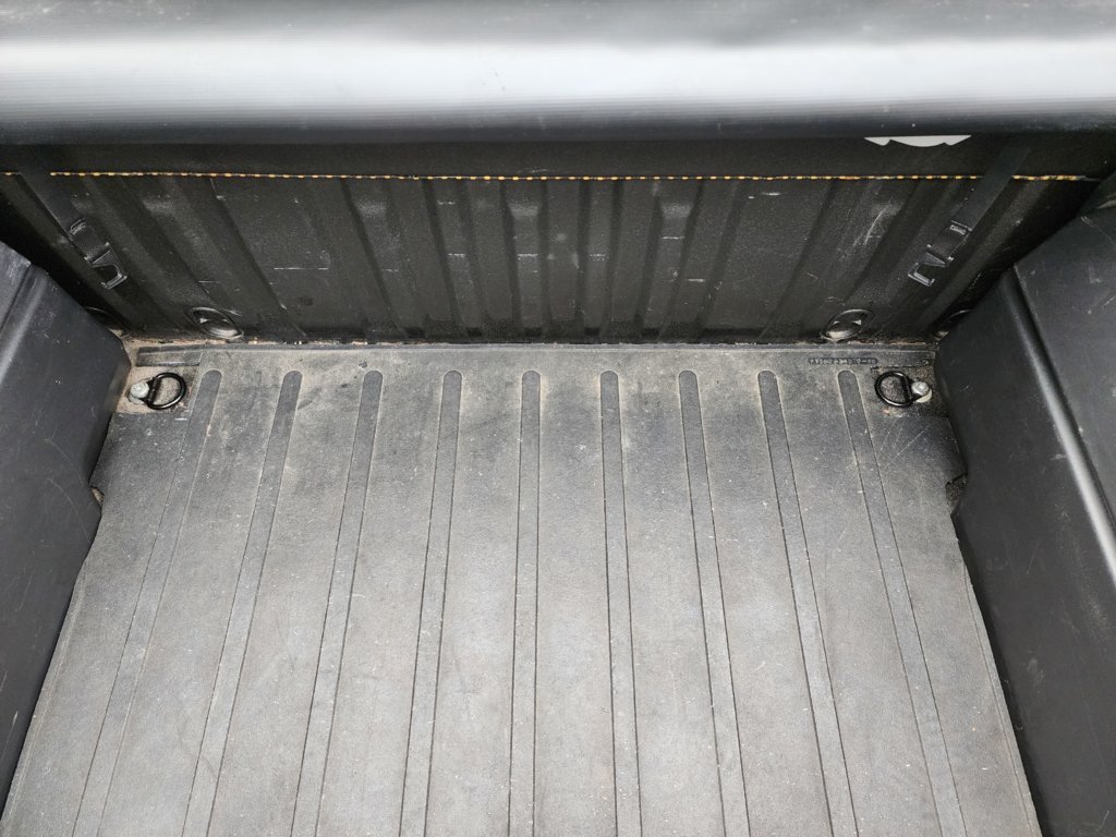

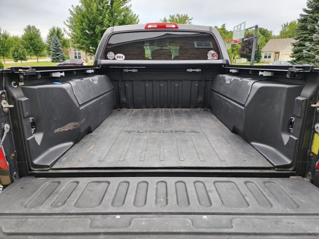

    Finally got around to installing the trail edition storage boxes that were laying around the garage. Added Mopar tie downs since you lose the front ones with the boxes installed. Then trimmed the bed mat to fit. Done for now. I think....

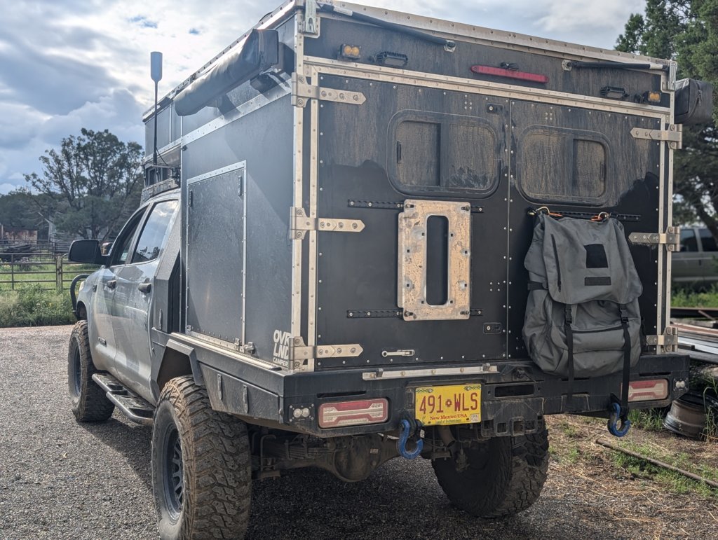

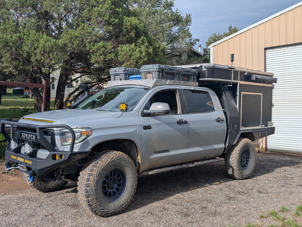

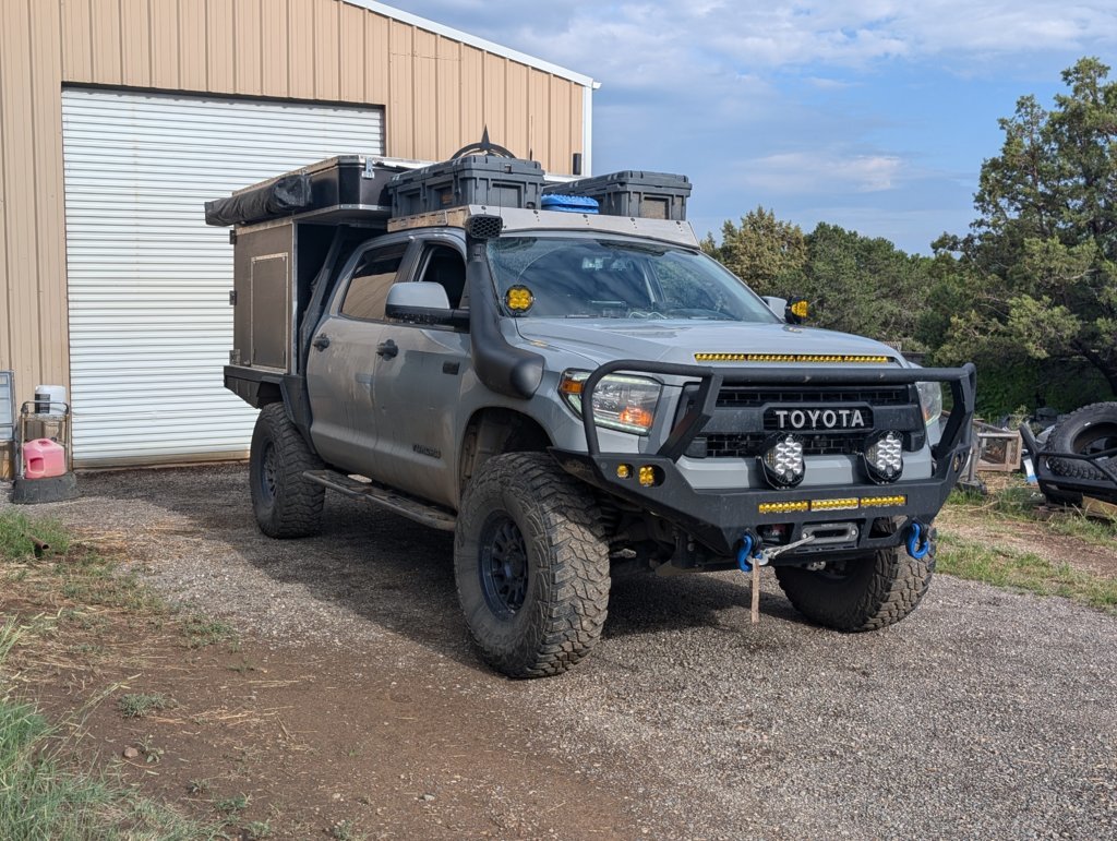

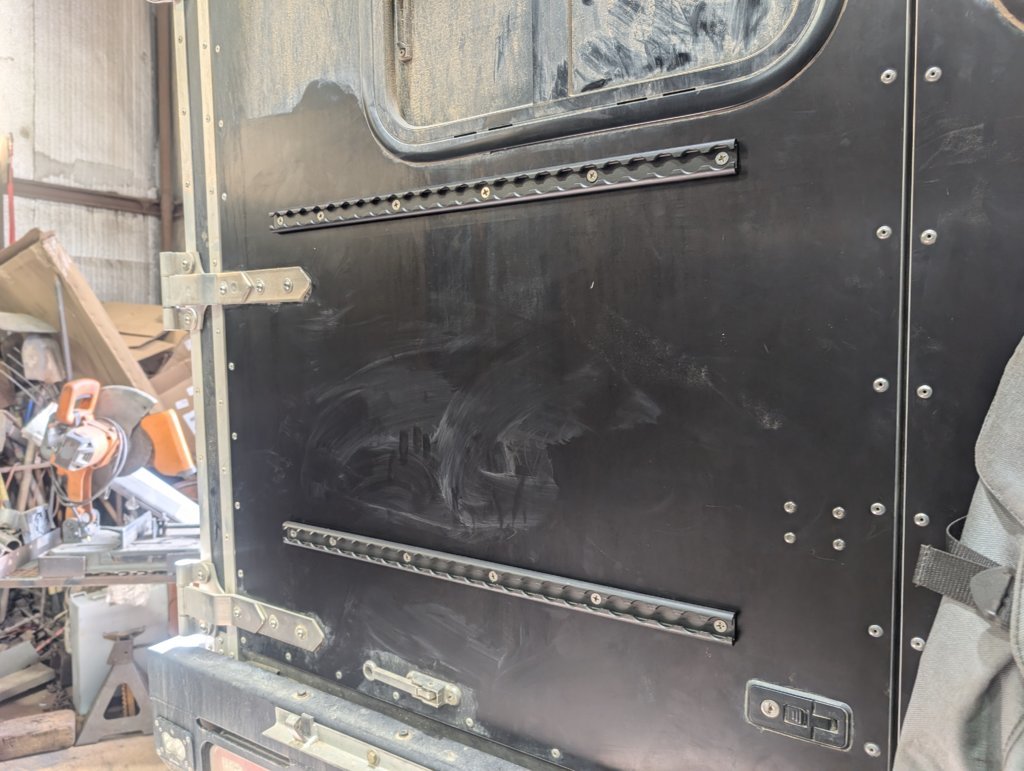

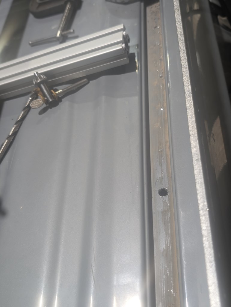

    I had some time the last couple evenings to make some progress on the roof rack extension and rear door mounting.
    I decided to just add to the current rack instead of build a new one and it worked out great. I scored a couple huge ROAM cases a while back on a trade so I mounted them up there and had to turn my traction boards and move my radio antenna but it was a pretty simple job. What's two more holes in my non leaking roof??
    Next up was drilling a ton of holes in the rear doors of the camper to mount a couple pieces of L track. I just used rivnuts and 3m tape to mount these. The passenger side will have the trash bag and a 10# propane tank. The driver side will have a case with my water heater, hoses and other miscellaneous water stuff and then a second 10# propane tank.

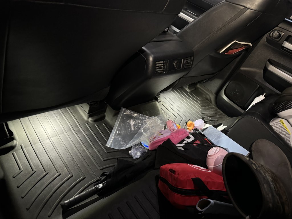

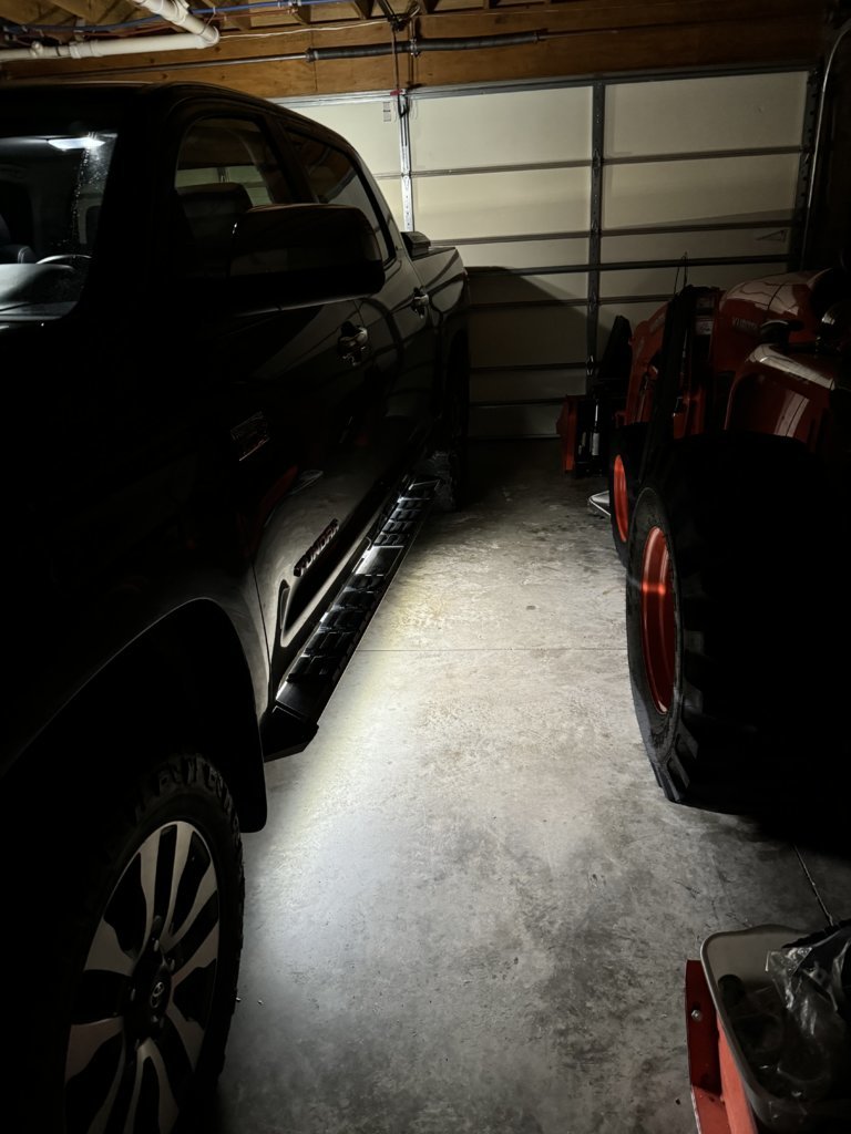

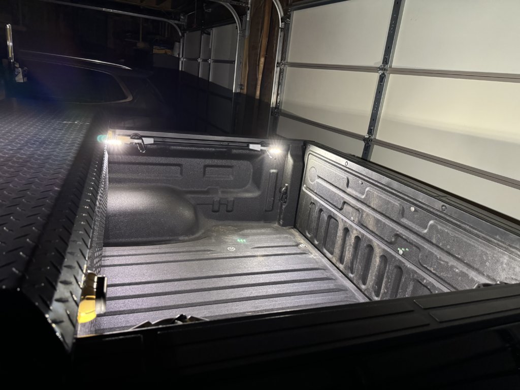

    VLED bed lights
    FYI for anyone who finds this in a search.. the instructions they provide are for a Tacoma. You will have to mount the relay/grounds by a self tap or drilling. The cargo switch wires will need to come up through the drivers rear footwell grommet. Other than that… plug and play!
    Wired the mictuning 60” strips to activate with cargo/bed
    VLED footwell lights front and rear

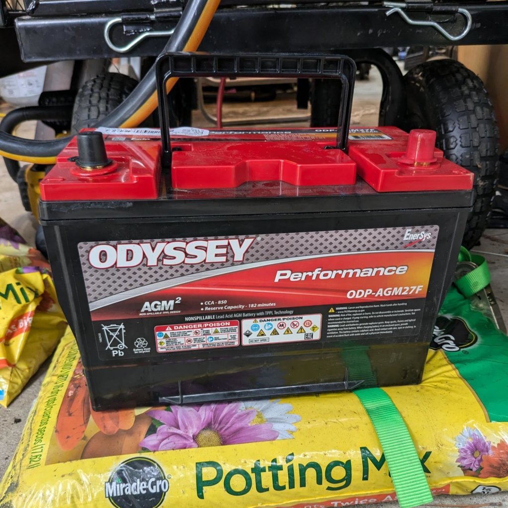

    Slapped this bad boy in after work yesterday and hooked up the trickle charger to top off.
    Noticed on my drive to work today the battery light didn't go off and I'm still only running on 13.2-3V.
    If the diode isn't working anymore, I'm assuming the alternator is only pushing stock volts which could trigger the light? Hooked up an inline fuse so that could be blown too.
    Either that or the alternator is going out.

    Isn’t stock volts 13.8v? On a full charge for my X2 power, I get 14.6v on start up. Then as I drive, I’m around 14.0-14.1.

    Alot of them
    My stock averages 13.3

    Yeah I think my charging system is no bueno
