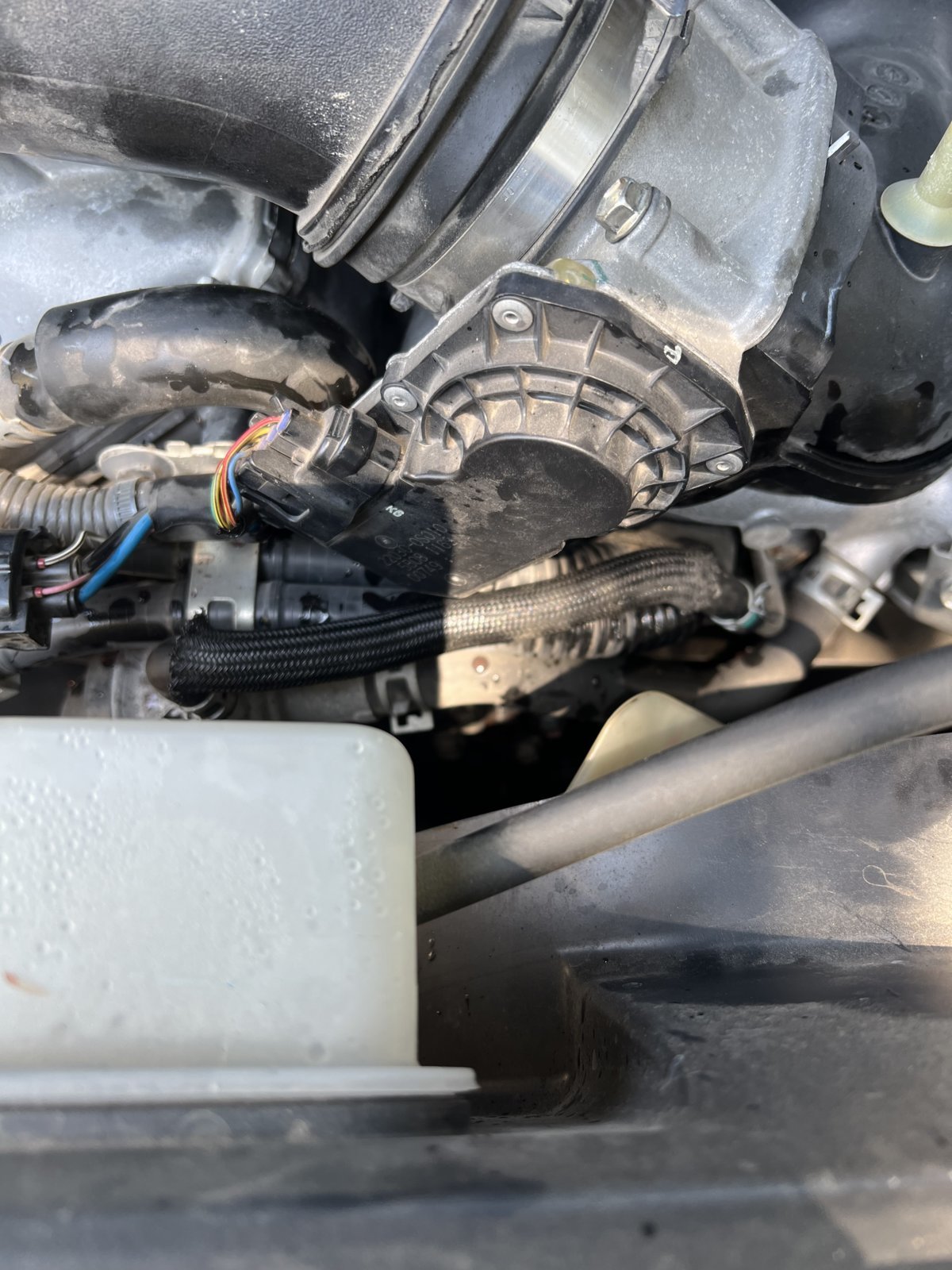

    Do you have to plug the holes in the throttle body? Wil any air get into the coolant system when you disconnect and tie the hose together? I am assuming you are using a coupler to joint these 2 hoses, do you know what size by chance?
    Any other info we should know about?

    If any air gets in there it’s minimal. No need for a coupler. Just use one of the hoses to connect the two ports. See the braided hose in the pic? That was going to the right port on the throttle body. Pulled it off and then connected it to the other port. I haven’t capped off the throttle body ports yet but haven’t noticed any issue driving around.

    I'm still confused ... If IAT is measured at airbox how can air temp at throttle body be confirmed? Surely inlet air at throttle body doesn't hang around long enough to be excessively heated?

    I'm wondering what temp should I be concerned and re-hook up the hoses to the throttle body here in the valley? If it freezes, or does it need to be a lot colder than that.

    Something is missing here. I cannot discount your experience or the data that you are collecting. However, everything that I have ever learned about engines and fuel injection says that you should not be seeing a gain here. I don't think that you will see a loss either.
    Not running coolant through the throttle body should make zero different on coolant temps. The flow and heat transfer to/from the throttle body is nothing compared to the rest of the engine and your radiator has enough extra capacity that this should make no difference.
    The amount of air flow through the throttle body is high enough that it will not pick up much temperature at all from a warmer throttle body. Now if you heated the entire intake manifold that might be different. Maybe?
    Warmer intake charge will be thinner and as such should be using less fuel to run at 14.7:1. But again, I just don't see that little throttle body making that big of a difference.
    I may be missing something????
    Cold with high humidity conditions like engine braking down a mountain pass could very well find you with problems if you eliminate this circuit. Be careful if you try this because you could very well lose engine power if the TB freezes. This would cause the loss of power steering and power brakes.
    Be careful if you are doing this.
