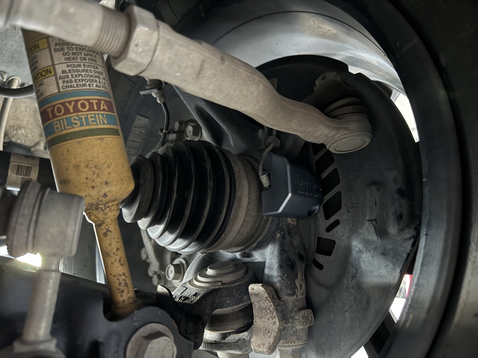

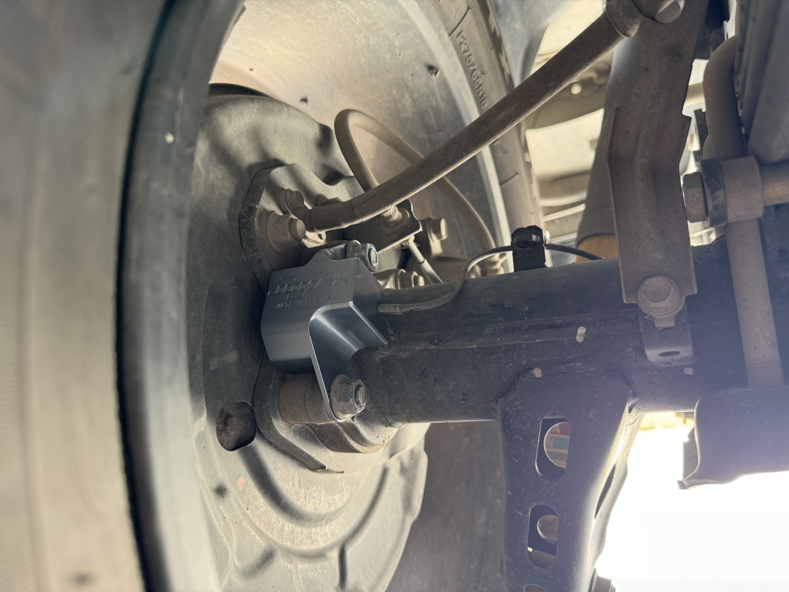

    North Florida
    2017 1974
    Brought her back to the gas station, topped her off and then loaded her down. I load the food up in the AM and then head to our campsite for the week.... Looking forward to this already.
  3. Jul 28, 2024 at 8:49 PM

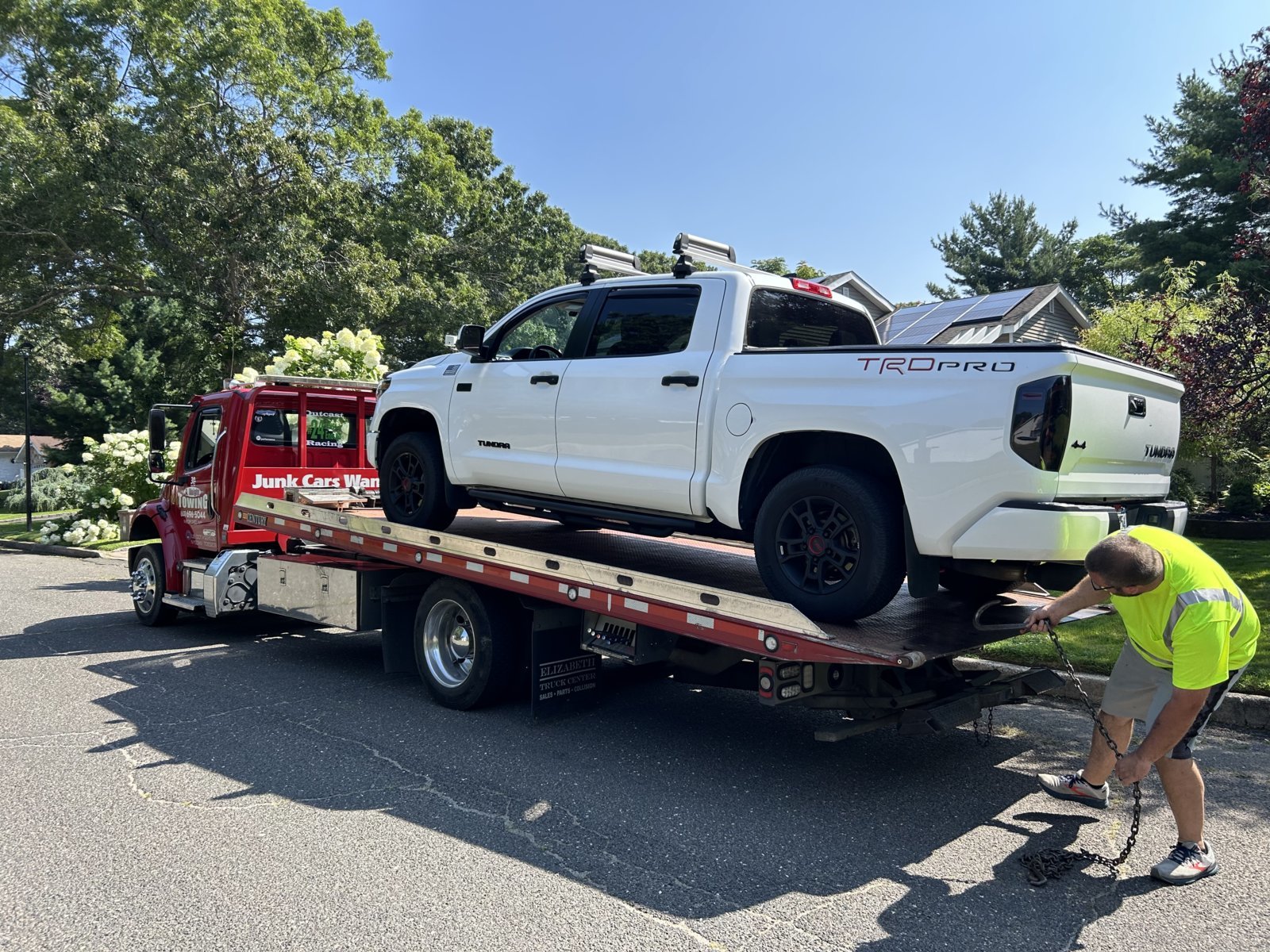

  5. Jul 29, 2024 at 3:29 AM
    Xcumminsguy
    Xcumminsguy New Member
    Oct 15, 2023

  6. Jul 29, 2024 at 4:18 AM
