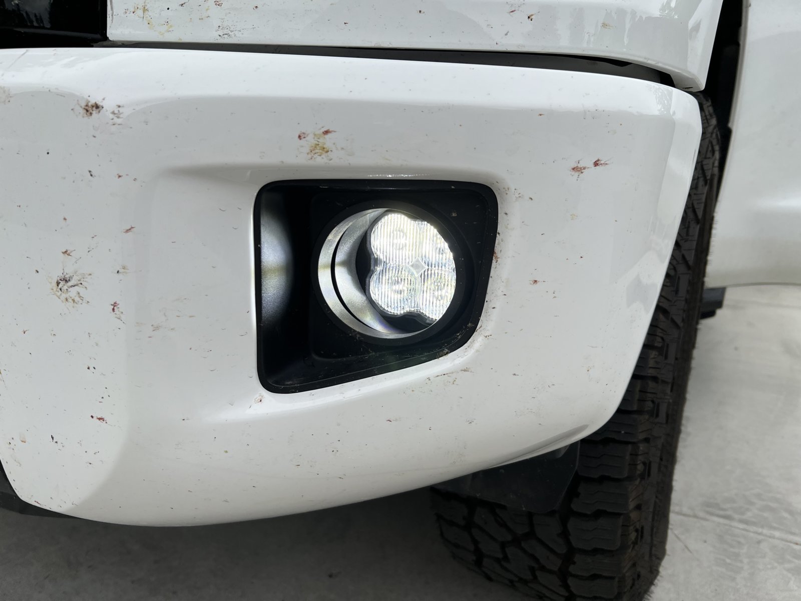

    Come to think of it, it may make some sense why the fog light is not working if they’re tied to the tail light fuse. The original resistors for the tail lights were each 15 Ohms (which cause the turn signals to hyper flash), but the updated resistors are now each 7.5 Ohms. Perhaps the tail lights have too much resistance? :monocle:
    My next plan of action:
    - unplug tail lights, try again
    - unplug headlights, try again
    - replace headlamp dimmer switch, try again
    - replace tail light resistor with updated one, try again
    - put all lights in “standard” mode instead of “sequential” mode, try again
    - bypass the relay and wire up a manual switch

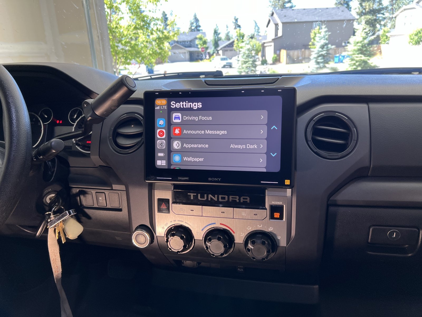

    One step closer to a fully blacked out interior!
    - Sony XAV-9500ES Plug N Play Kit
    - OEM Black Instrument Panel Sub-Assembly (55405-0C020-C1)

    I’m a bit confused here… I checked the tail light 15A fuse, but I’m not getting 12v. I swapped out the fuse for a spare, but get the same result. However, my tail lights are still working. Am I missing something?

    Does the brake pedal have to be pressed for 12v to be sent through the fuse?

    It appears that terminal is not getting 12v regardless. Checked with key in the on position and with and without the brake pedal being pressed (brake light still turned on).

    Did you pull the fuse and check at the terminals themselves? You can't always depend upon what the fuse says.

    Finally figured it out! It was the license plate bulbs… replaced them with LEDs and accidentally reversed the polarity on one or both, which was preventing the wiring harness from completing the circuit. :frusty:
    Remember kids… when engineering a wiring harness, always tie your front fog lights to your rear license plate illuminating lights.

    That makes zero sense. I don't even have license plate lights and my fogs work fine. You must've just had a fluke and it fixed itself when the Sun aligned with the pyramids or something.

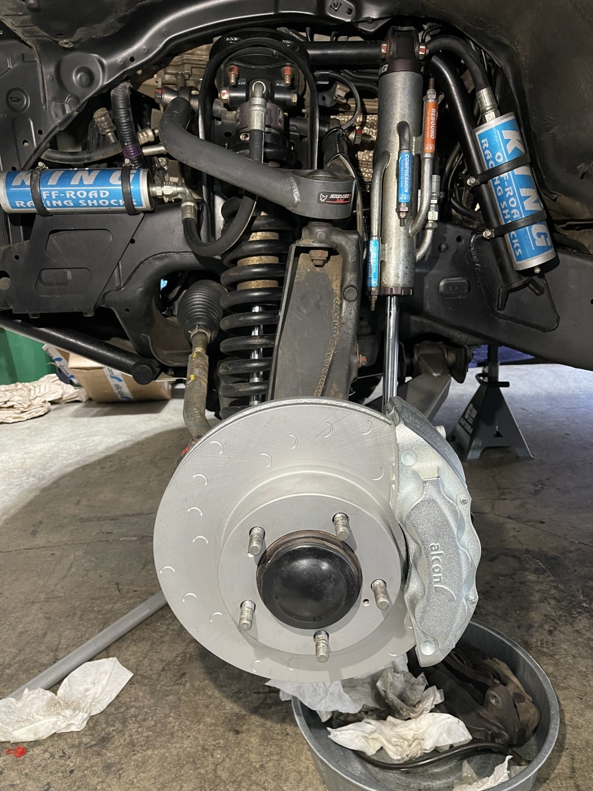

    Yep I had 2.5 king triple bypasses up front now moving to the 3.0 triple bypasses with custom valving etc. Old 2.5s pic attached

    Nice when you have room. I cannot fit a nickel anywhere in the front end without an issue. One of these days the Icon set will be up for sale. Talked with their ‘team' so many times and I never get any solid information from them and rarely do answers come quickly. If hindsight were 20:20
