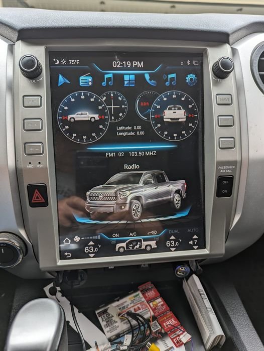

    Did a thang over the weekend - its used so i got for a decent price.
    We will see how it goes.

    I remember playing video games in the early 2000's on a TV about the size of that head unit. Crazy how far technology has come since then

    What year does that come out of? And is it plug and play?

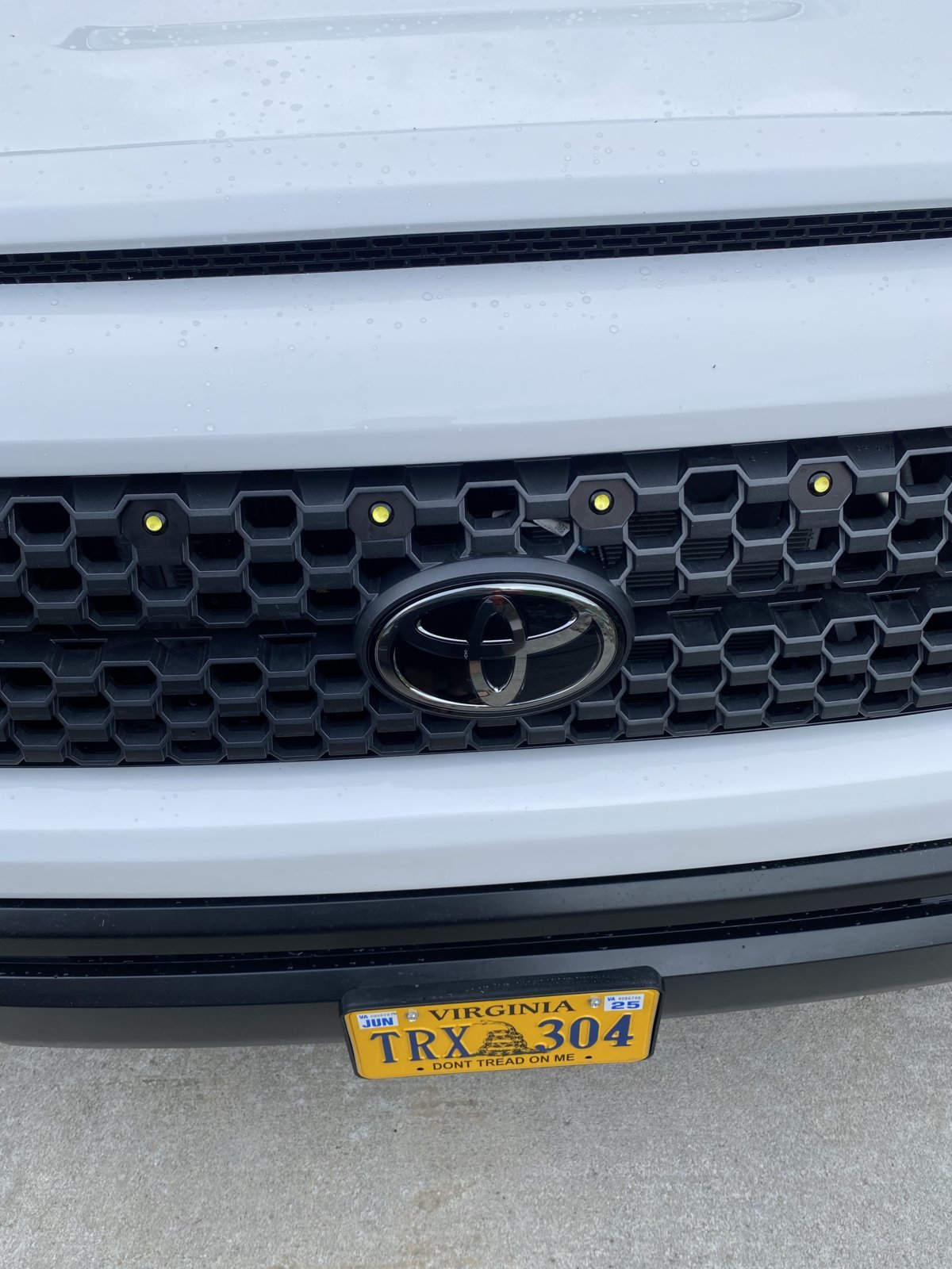

    This evening's installs - YotaLEDs and VGate terminal clamps

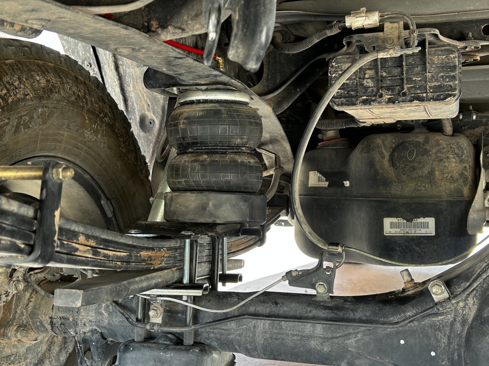

    Wife bought this…
    So I added this..
    Went with the Torque kit and cradles. The install was easy and all parts are working, no air leaks. The truck has 5160’s and Icon leaf paks, but with the shell, drawers and assorted heavy stuff the leafs were flat with the trailer hooked up.
    Dropped the bags to the minimum 5lbs and ran over the whoops behind the house. The ride was great with no bottoming out and no bounce.

    Iove my bags! I don't see a down side. Air up when towing, air down when running the truck only.

    Same. I run 5-10 psi when not towing and 40 psi with our travel trailer.

    They were just so bouncy for me when unloaded. I couldn’t find a PSI to run them at when empty without them being super bouncy. Switched to RAS HD.

    I wish the name brands would release something like that built with known/quality components and decent firmware . There’s so much there to like, but also so much BS dealing with janky Chinese firmware on those things. In my 20’s I was up for that challenge…now days I just want shit to work.

    im the same, but i dont mind tinkering if it works out. So far it hasnt been to bad. Plug and play and 30 minutes later its all working (i think - lol).
    Only time will tell and if it doesnt work out, im not out a bunch of money and will just sale it to the next guy.

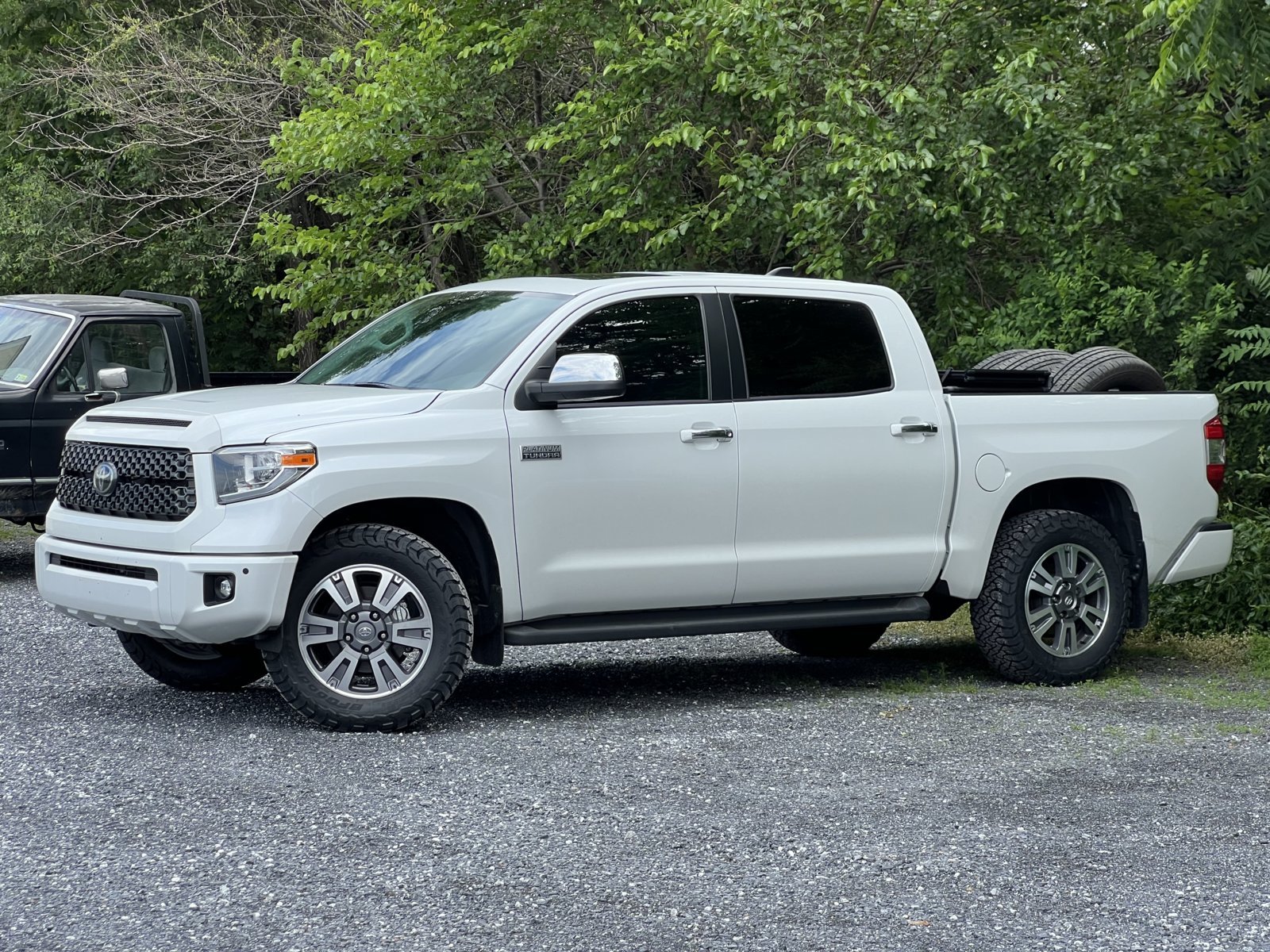

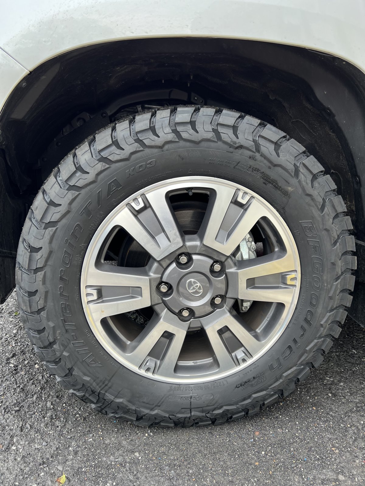

    Got KO3s in 275/65 R20s mounted…no rub at all!
    So far they perform much better than KO2s in the rain!
