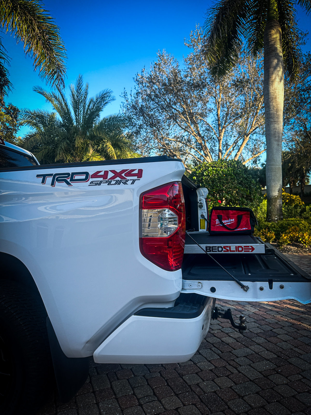

    What's in the BAG? :rofl::rofl:
  28. Feb 28, 2024 at 4:27 AM
    ToyoMafia
    Nov 8, 2019
    #38453
    13,412
    Magic carpet.
    Cool slaps and plastiDip
    Shhhh
    Damie Street[QUOTED] likes this.
