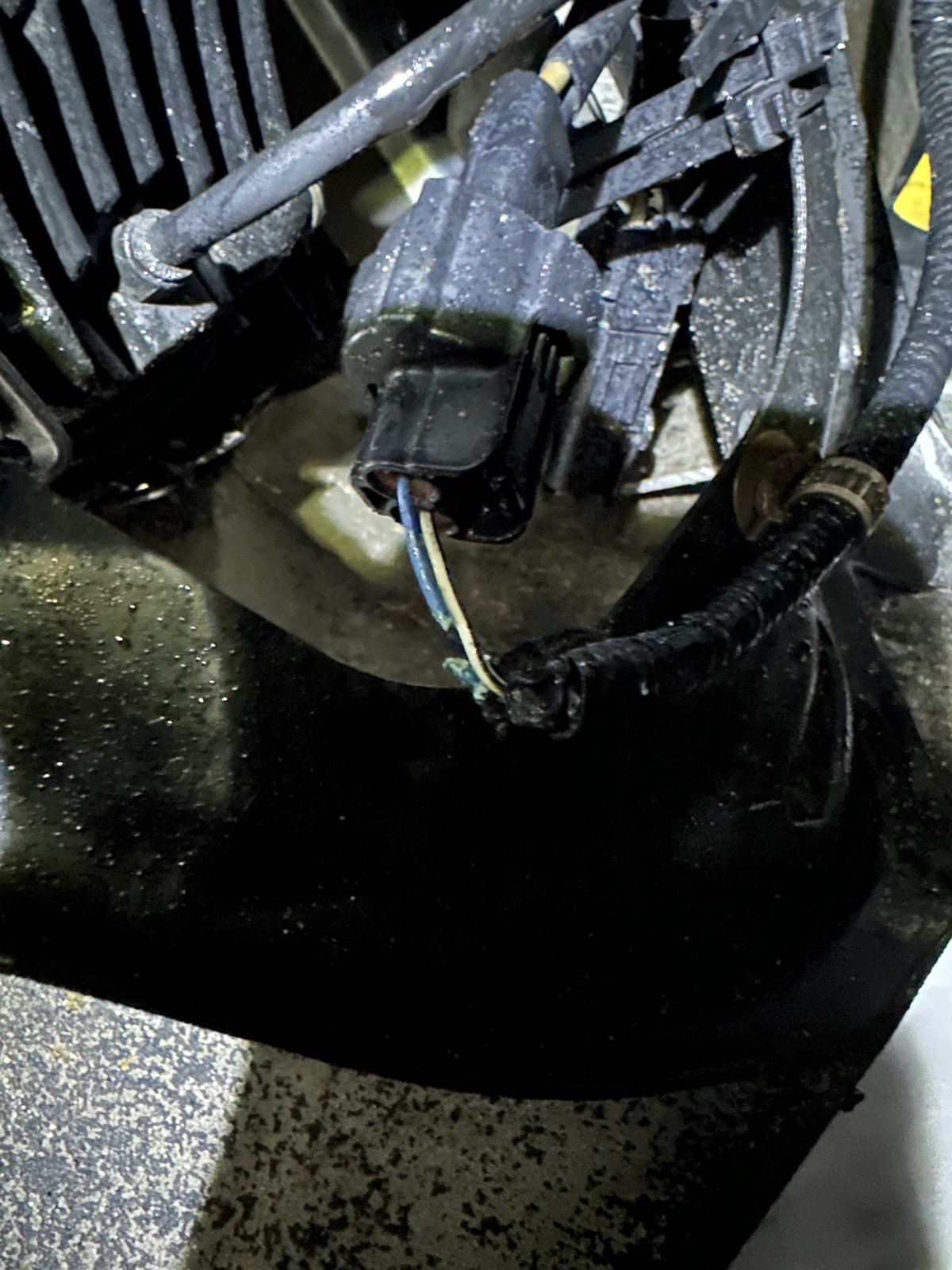

    :mad: FFS. Looks like something bit through it… what’s the fix here? :confused:
    That blue wire comes out from the factory fog light harness.

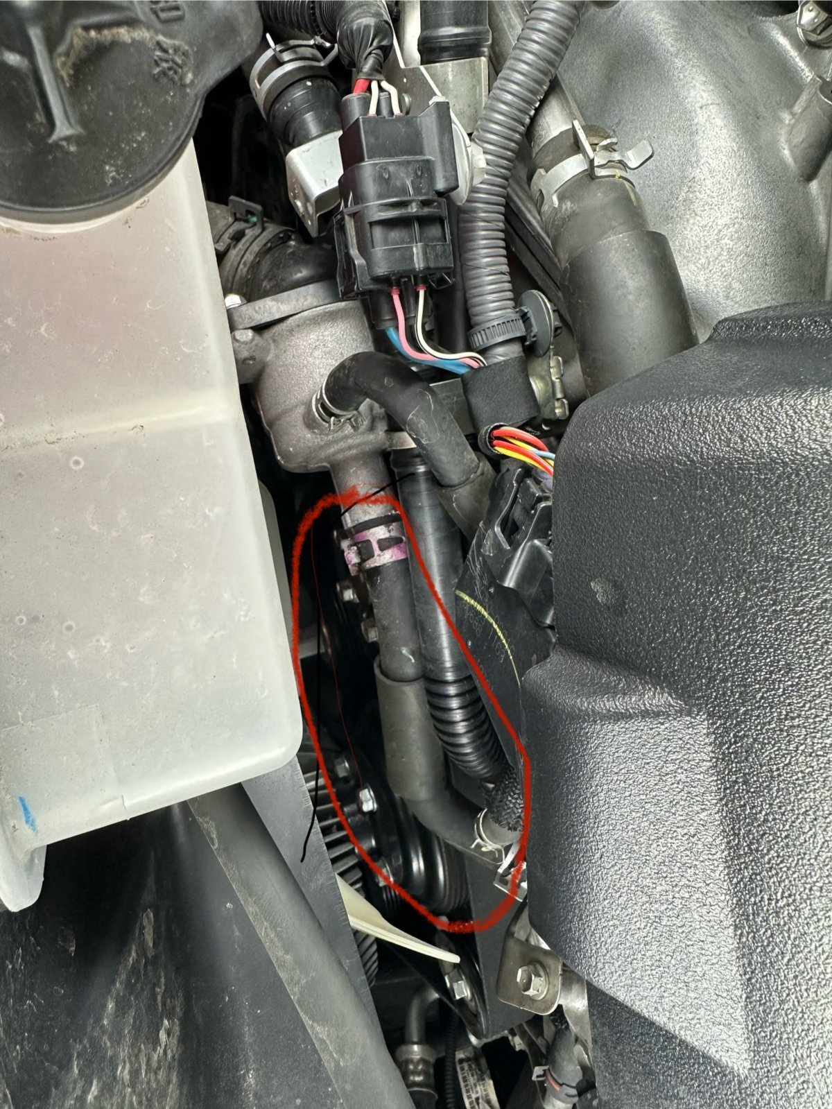

    #58409
    561

    Splice, heartstrings, and a roll of that anti-rodwnt tape. I don't remember the name of it but the Honda dealers sell it I believe. Most likely Amazon as well.

    Unpin it, rewire solder, wrap and continue on

    That looks like abrasion damage from the internal metal bumper end cap brackets…

    Honda Capsaicin Infused Tape…aka Rodent tape…
    https://www.collegehillshonda.com/product/4019-2317.html
    Having the critters thinking…

    Cheaper than a harness replacement.

    Until they chew a hole next to the tape and you’re still replacing/repairing a harness anyway.

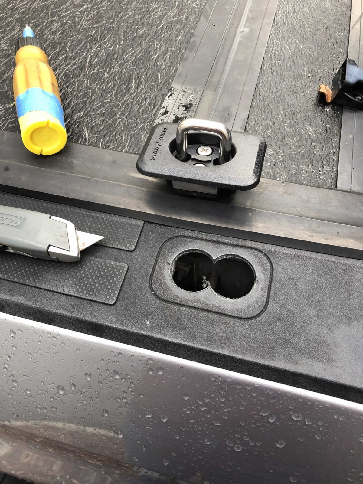

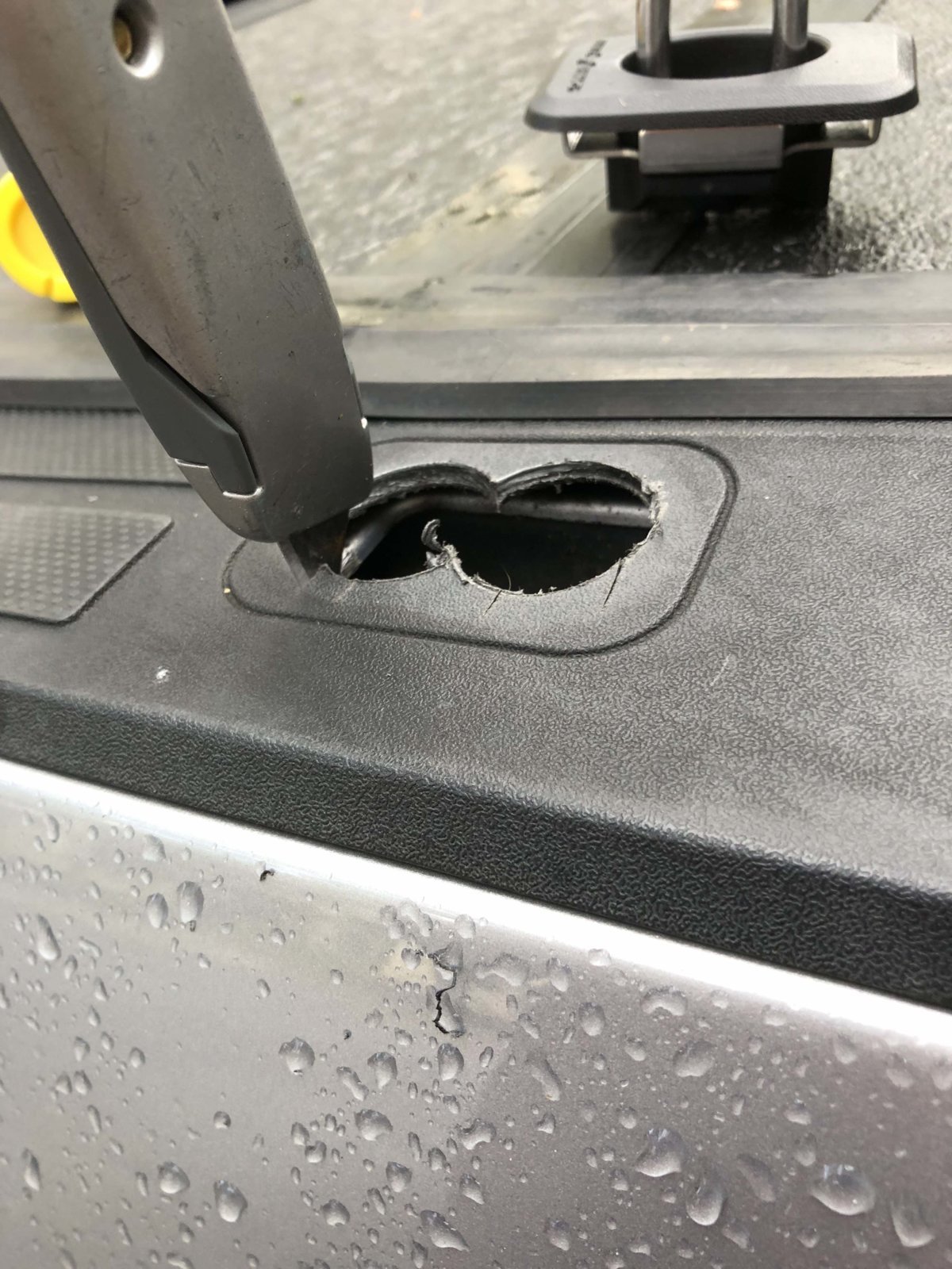

    Bull Ring Raised Fit Retractable Truck Bed Tie Down Anchors installed. 1) Cut holes by hole saw. 2) Expand space by cutting, plastic is soft. 3) Drop BullRIng in the hole. That's it.

    That's what I was thinking too, lol. Started the truck this morning, then went to brush some snow off and saw that one of the squadrons were out....

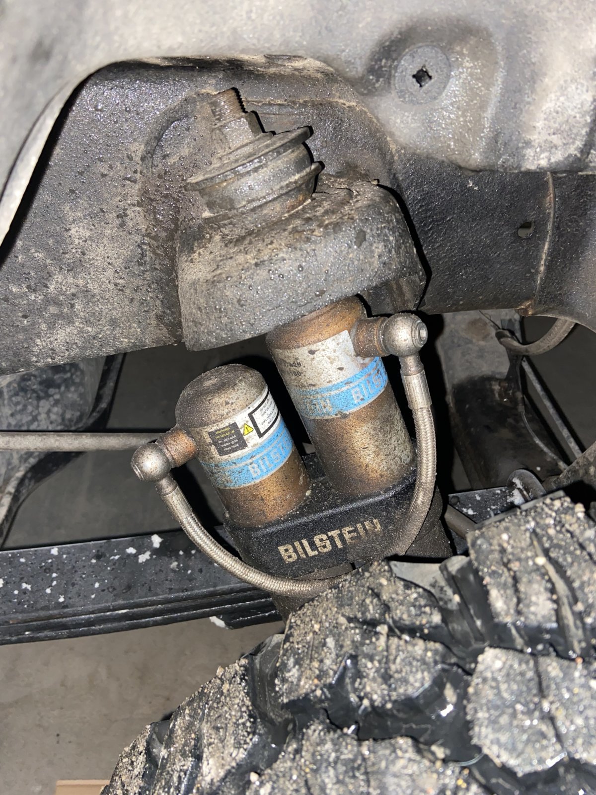

    TRD Rear Sway Bar Bilstein 6112/5160 Pop Lock, Kenwood MX 1057 XR, Pioneer amp/speakers/subs, Tech12Volt dual sub box
    can you elaborate on why you would not recommend them? Pre-mature failure and no warranty? Crappy ride? just curious.
