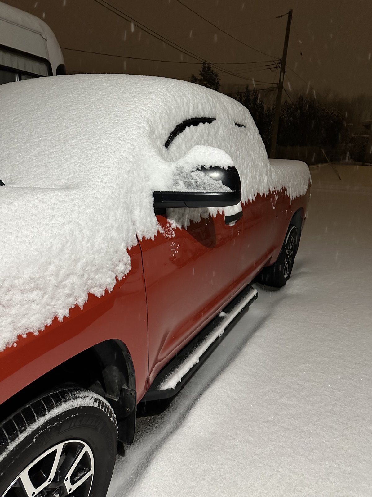

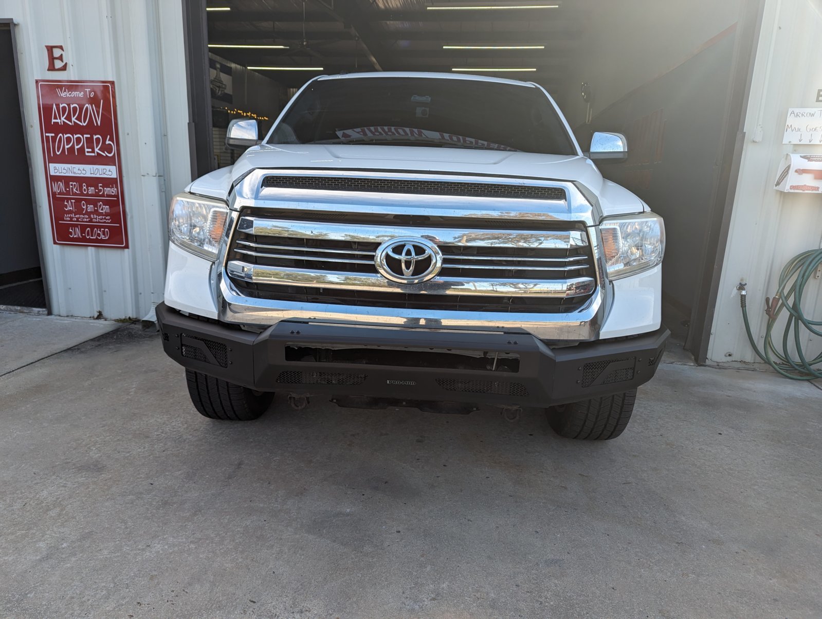

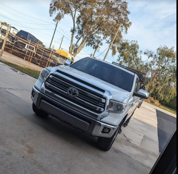

    Picked her up. Amazing how different these look versus online. A lot more exposed profile than I expected but, hey; I like it!
    Now we are waiting for the "fog lights" and skid plate

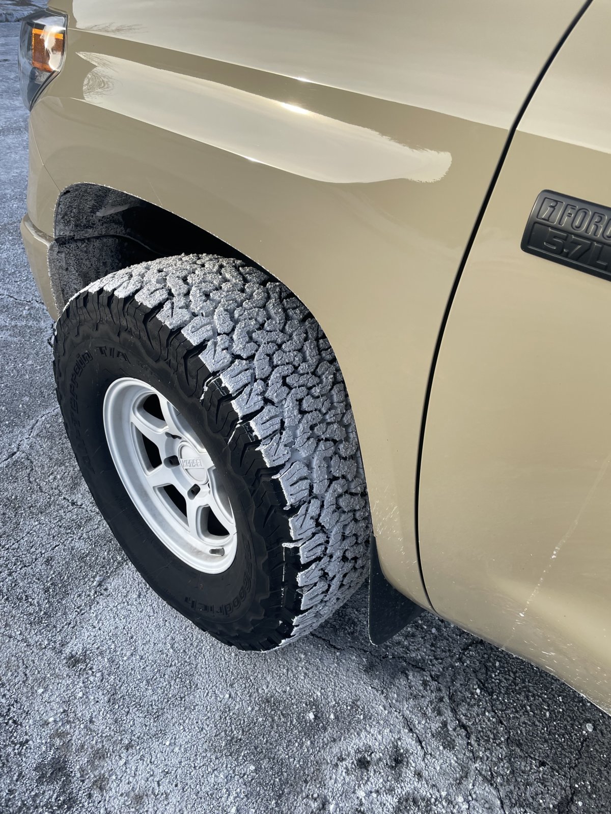

    White tire tread blocks. New trend? upload_2024-1-17_16-26-9.jpgupload_2024-1-17_16-26-19.jpg

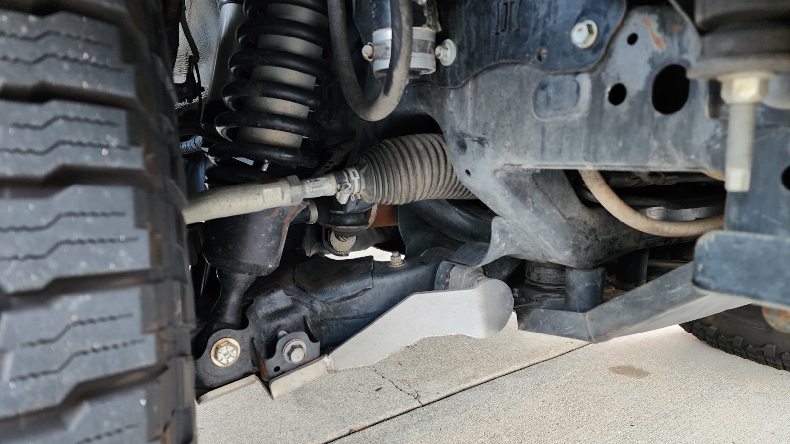

    Front Sway Bar delete. no more rubbing those 37s... or the swaybar links hitting the lower shock buckets on the ICON 3.0 Coilovers.

    Do you like the way it handles? Bad? Not bad? So so?
  12. Jan 17, 2024 at 8:02 PM
    SAGE63
    Dec 9, 2020
    #55939
    3,721
    San Diego County
    I will find out this weekend... Going to Superstition mtn over by Seeley. literally did this today.

    You have the 3.0's in front like I do, I adjusted them up a bit to a more firm setting to compensate for the loss of the sway bar. Mine has been off for a year now with no looking back. I also have a secondary front shock so I am not missing the bar

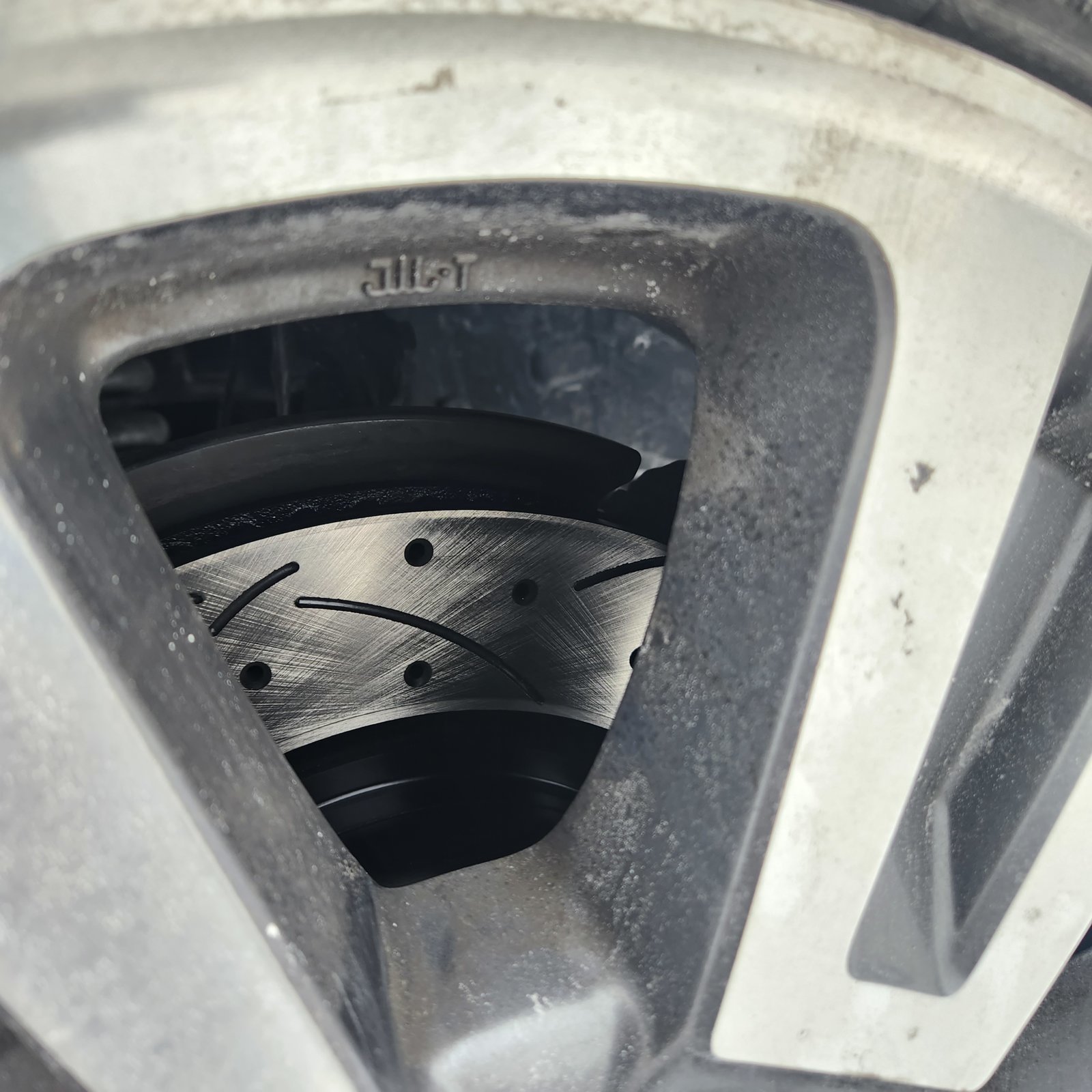

    Installed some ebay brakes and rotors.....hope the 70mph steering wobbles goes away. Will try later on highway...........update. it really is the damn rotors....after this change steering shaking 95% gone at 70mph.....there maybe a very small wanna wobble feel but its mostly gone. Am happy for now. I dont know how the rotors got warped

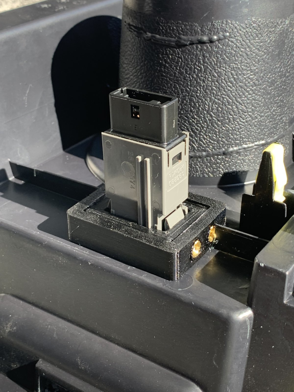

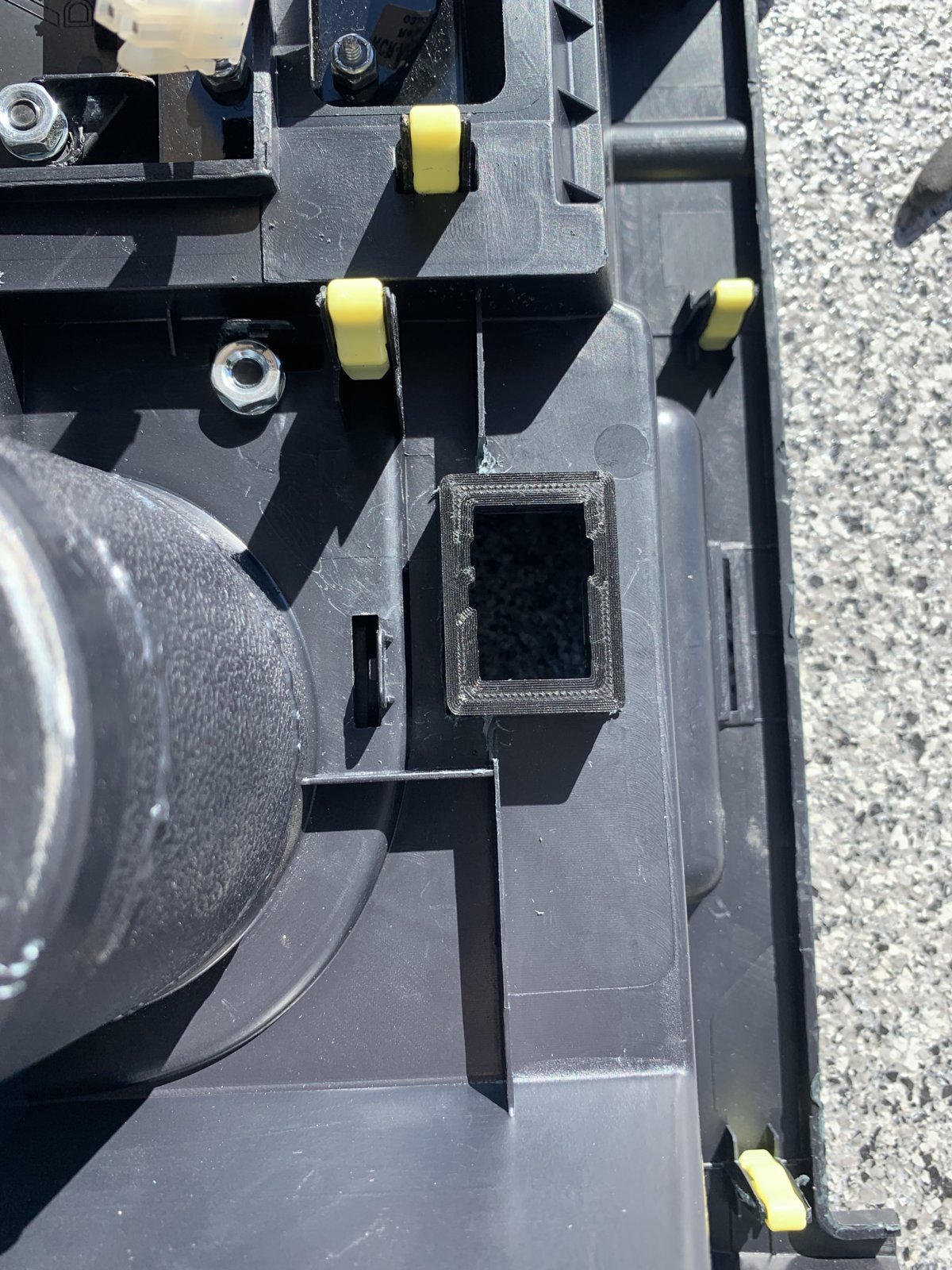

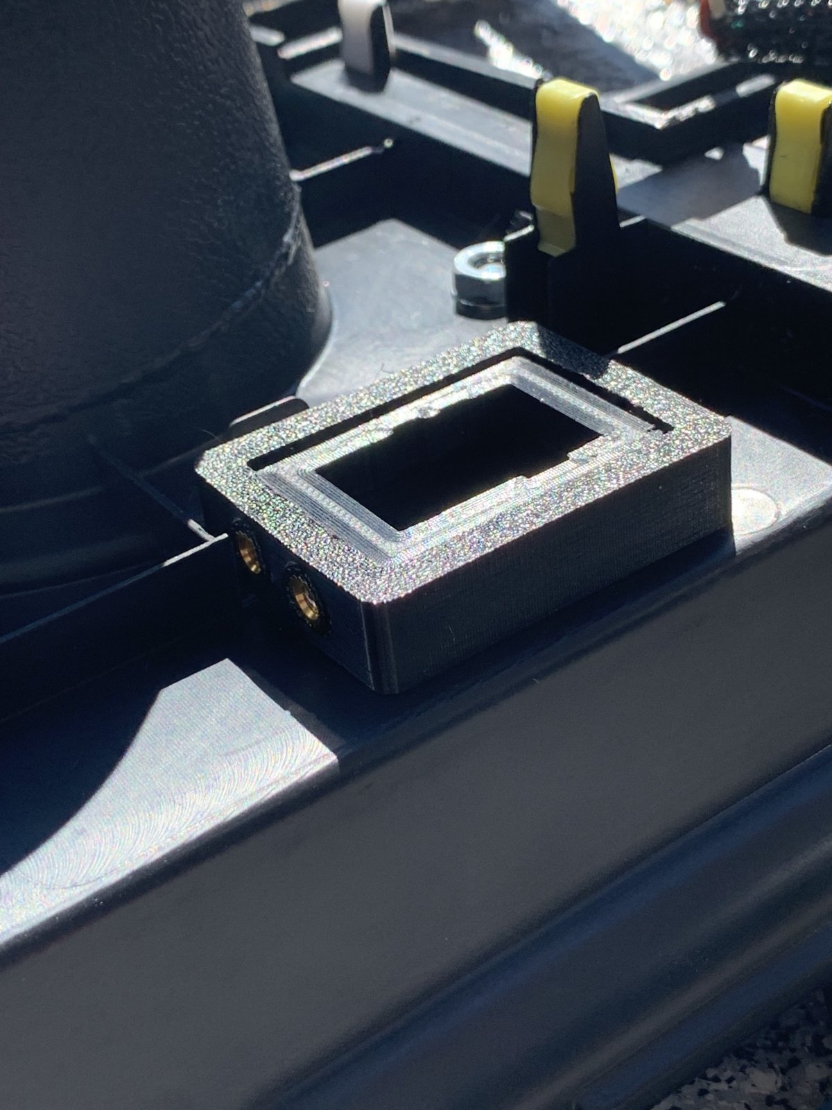

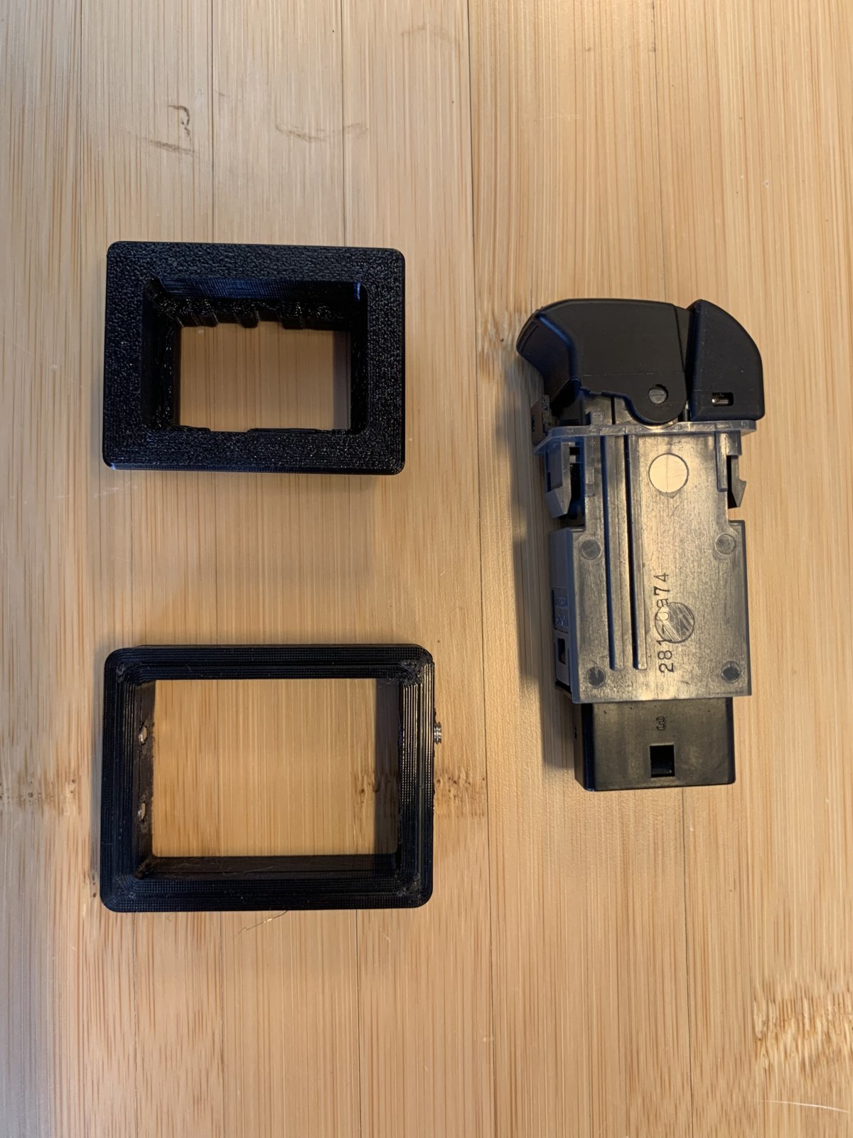

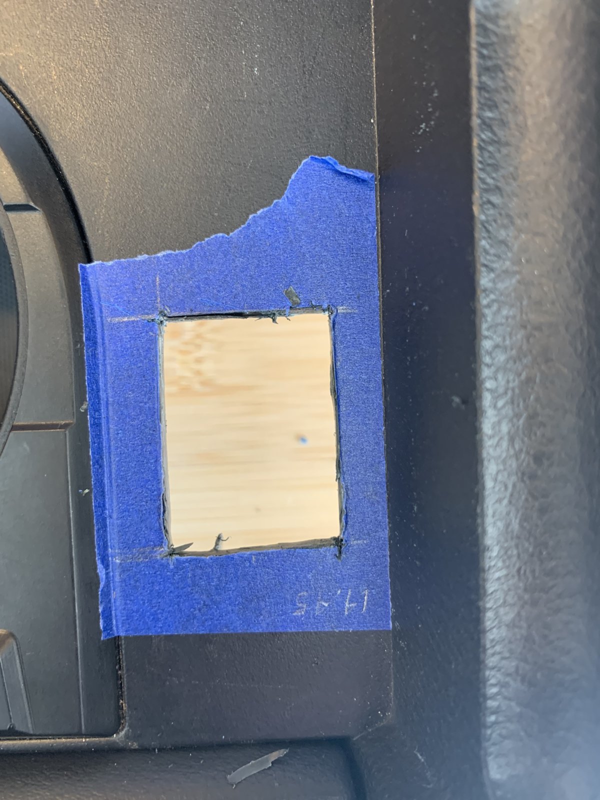

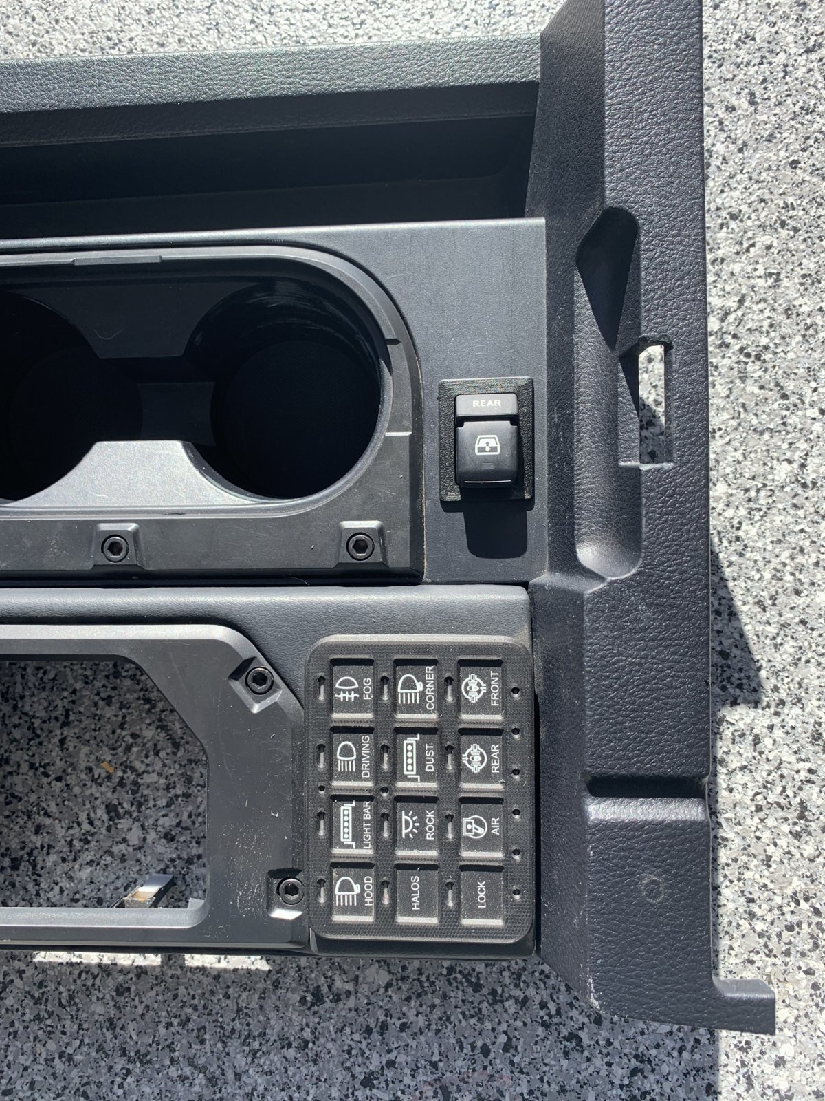

    Well I have been wanting to relocate my rear window switch but the only options I see is the space just in front of the console lid. I have my SwitchPro console there so I needed a one switch mount that I could not find anywhere. I bugged a few people with no interest so I made a post in the 3D section and time went by but I got someone that was interested. He needed some more dimensions because he did not have them all so I went to work and the end result is I have my wish!!!
    A BIG Thank You goes out to @Gaston

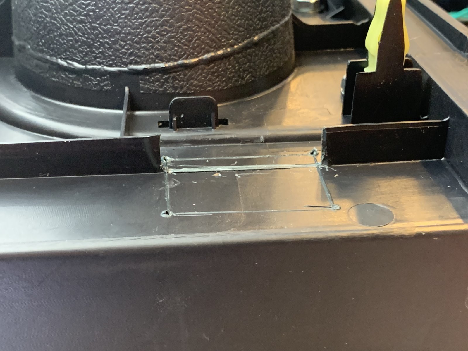

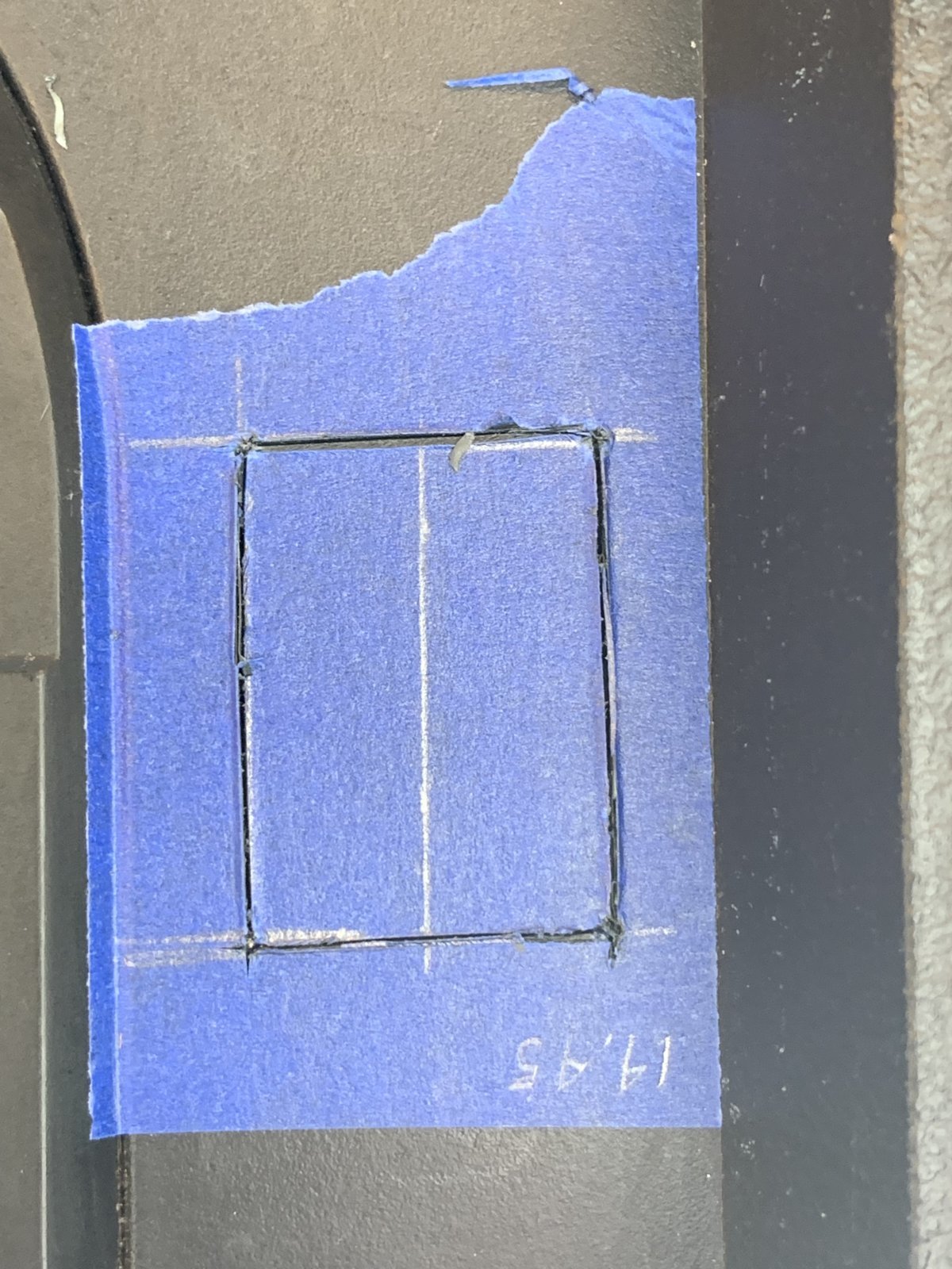

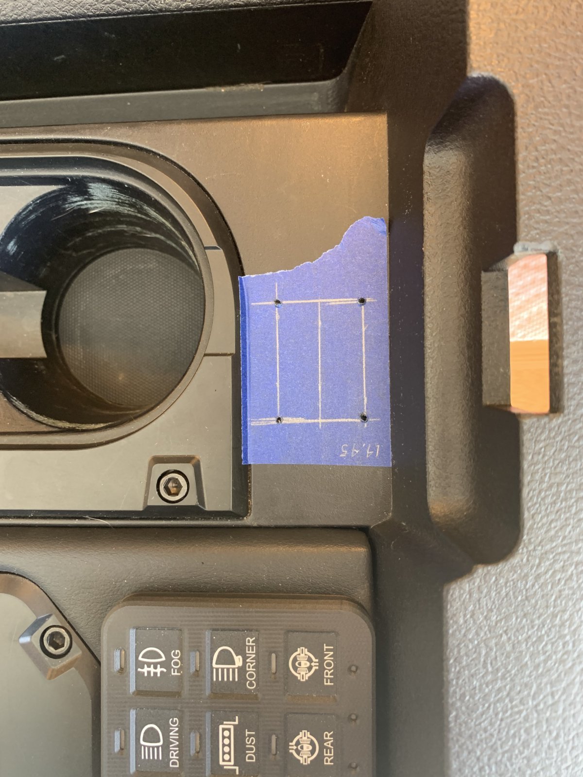

    Then the initial prep work
    Start the cut for my placement
    On the rear side there is a rib that needs to be trimmed
    Then we have a gash to work on fitment
    After some cutting and trimming the top piece went in then made sure it was flush and put on the rear piece to hold the first piece in
    Then put it all together. I did spray the top piece Matt Clear to get the sheen down a bit, very happy with result

    Looks good! I'm glad you like it, it was a fun project. Thank you for the help with dimensions.

    Not a problem, I had a caliper and Draftsight so why not! Thanks again for the help, after I bought the cable to relocate I was bummed I had no place to mount. That is a perfect spot for my right thumb to roll up and down :thumbsup:
    BTW I had zero issues with your print. The switch went in like it was stock and snapped in place. Very nice!

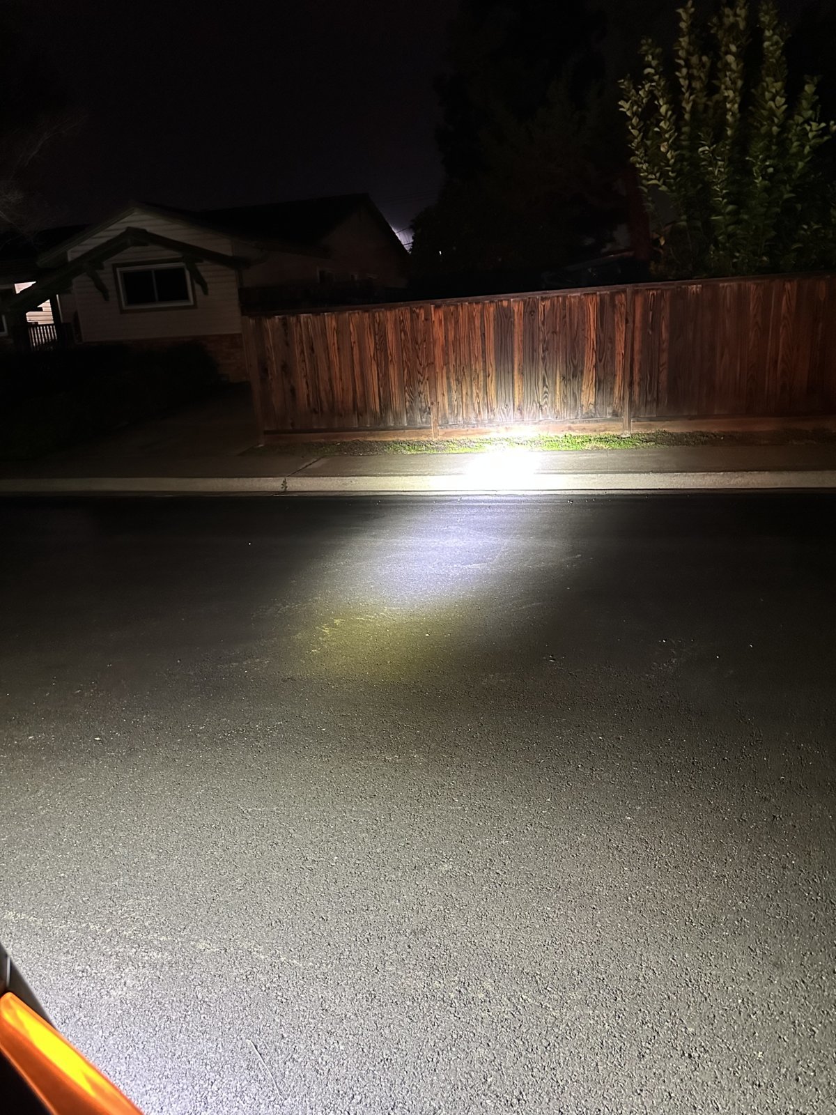

    Not sure how much I’m digging the rough country spectrum light bar, it said it was a spot flood combo and that what I have on my other truck, this seems more of just a spot light. Beam is bright just very narrow. IMG_6373.jpg
