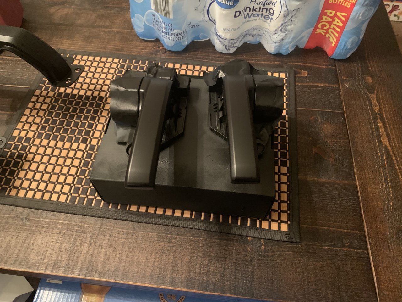

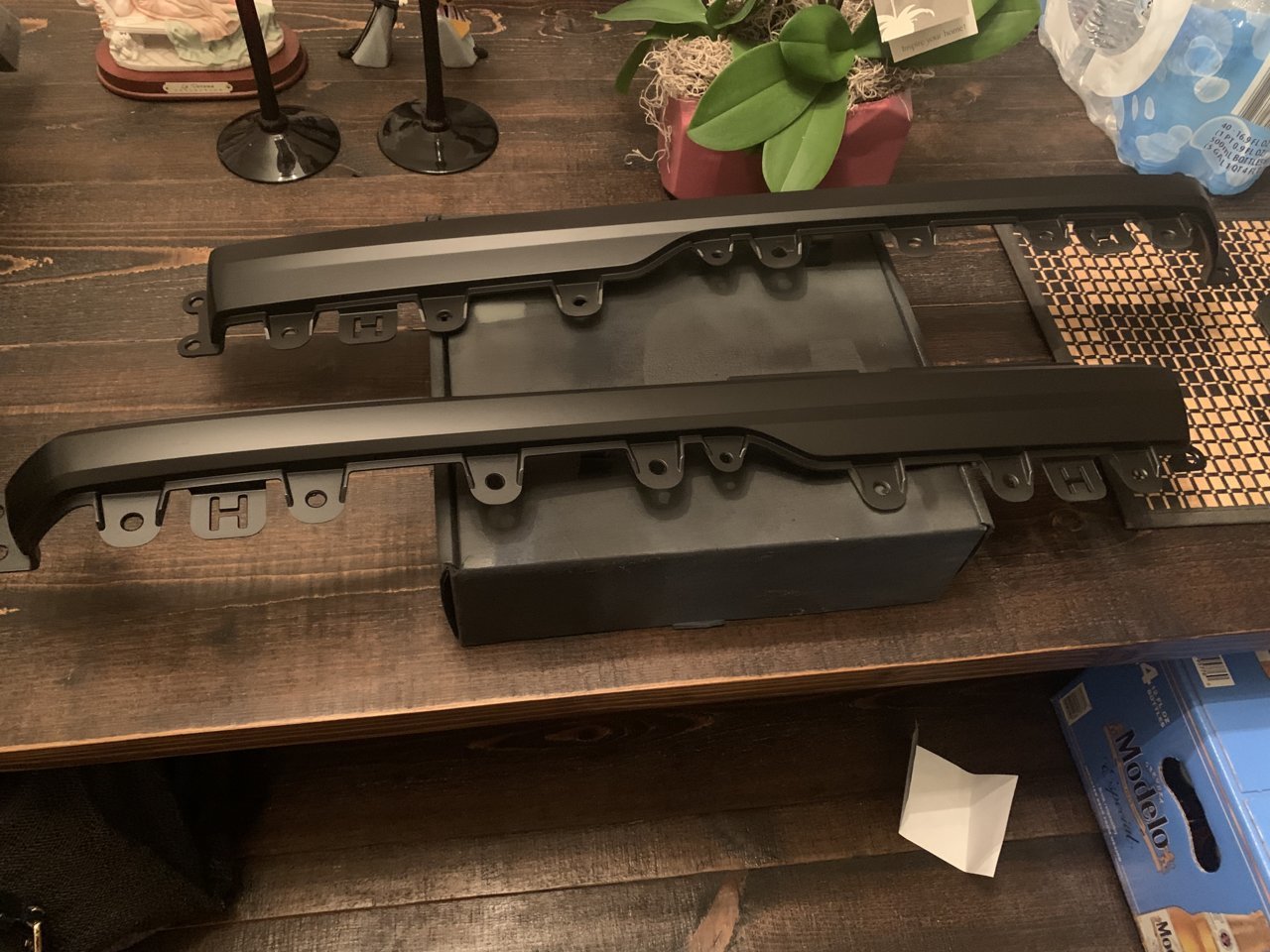

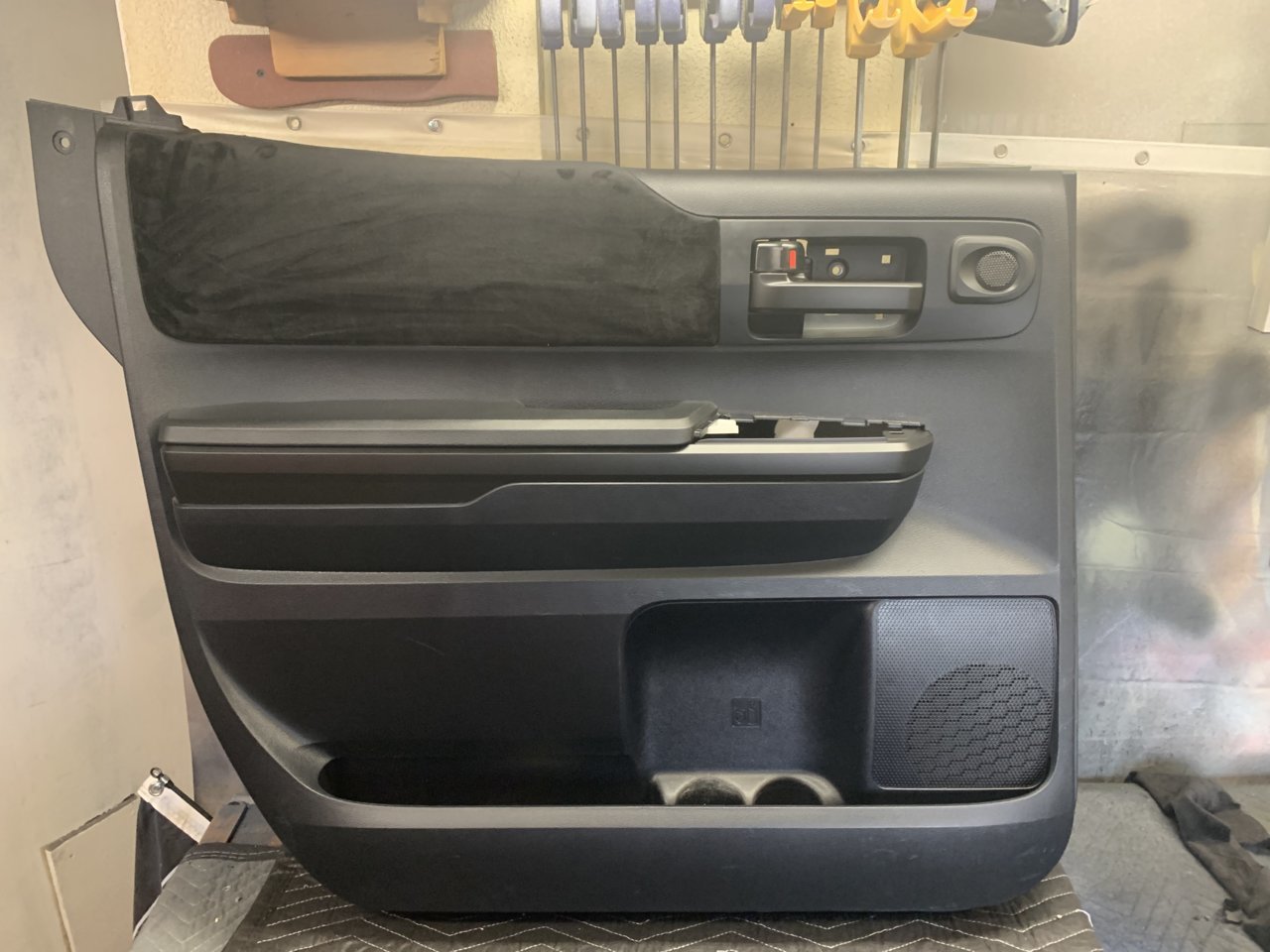

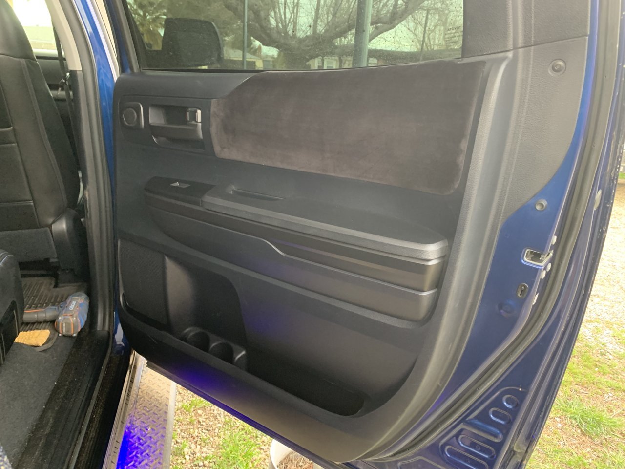

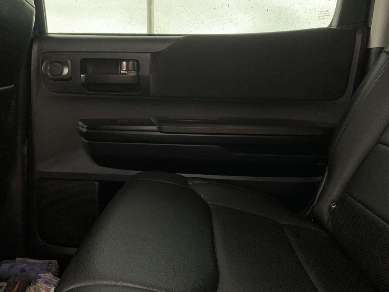

    Nice. I have some SEM so I should use it on my door trim.

    Over time it will get glossy due to natural oils from your hands. It may be fine if a flat clear coat is put over it.

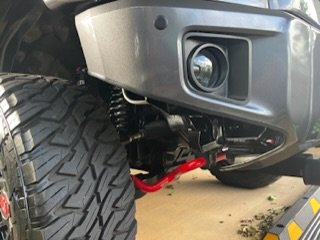

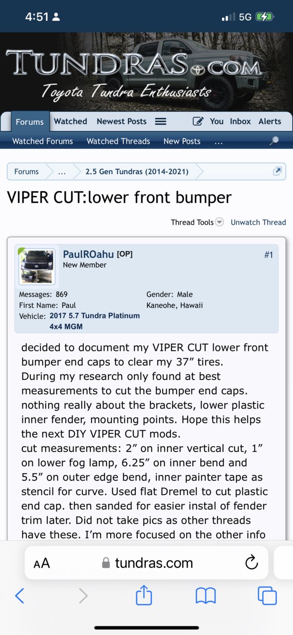

    Is an aftermarket bumper out of the equation? Plenty that provide the "Viper cut" clearance with out having to hack up your truck.

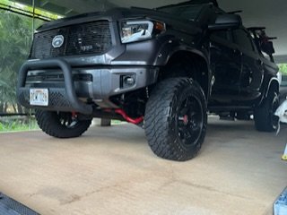

    here is the thread i made…. enjoy you DIY

    It’s not necessarily out of the question, but the viper cut is nearly free to do, and I am one of the few that doesn’t love the look of the black metal front bumpers.

    Gotcha. Assuming I grew the pair necessary to jigsaw my truck, I know I would get it 90% right, and the 10% that was just barely off would drive me crazy.

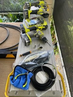

    these are the tools used. notes use painters tape to mark your cut line(measure 3x, cut once, sand cut area).

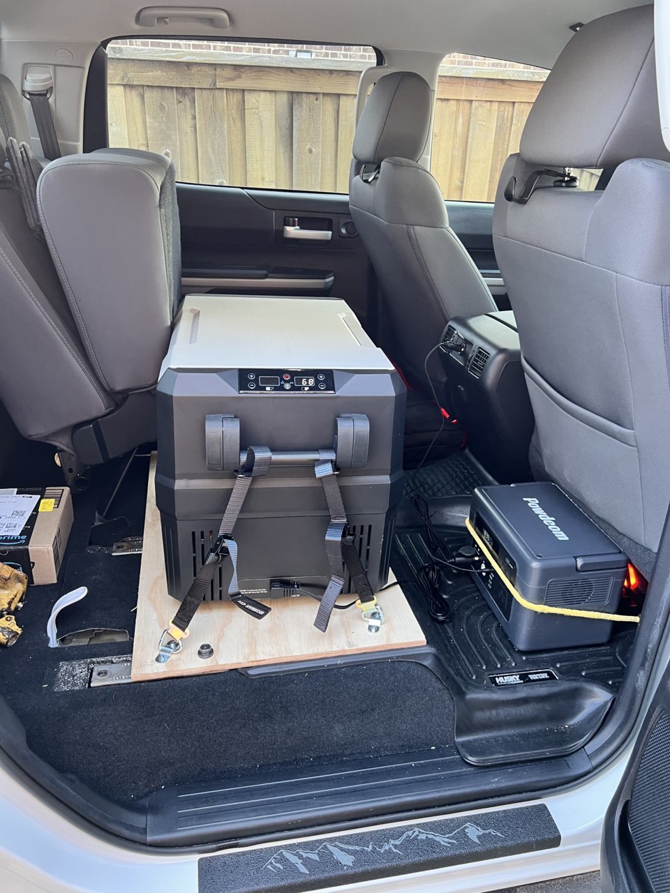

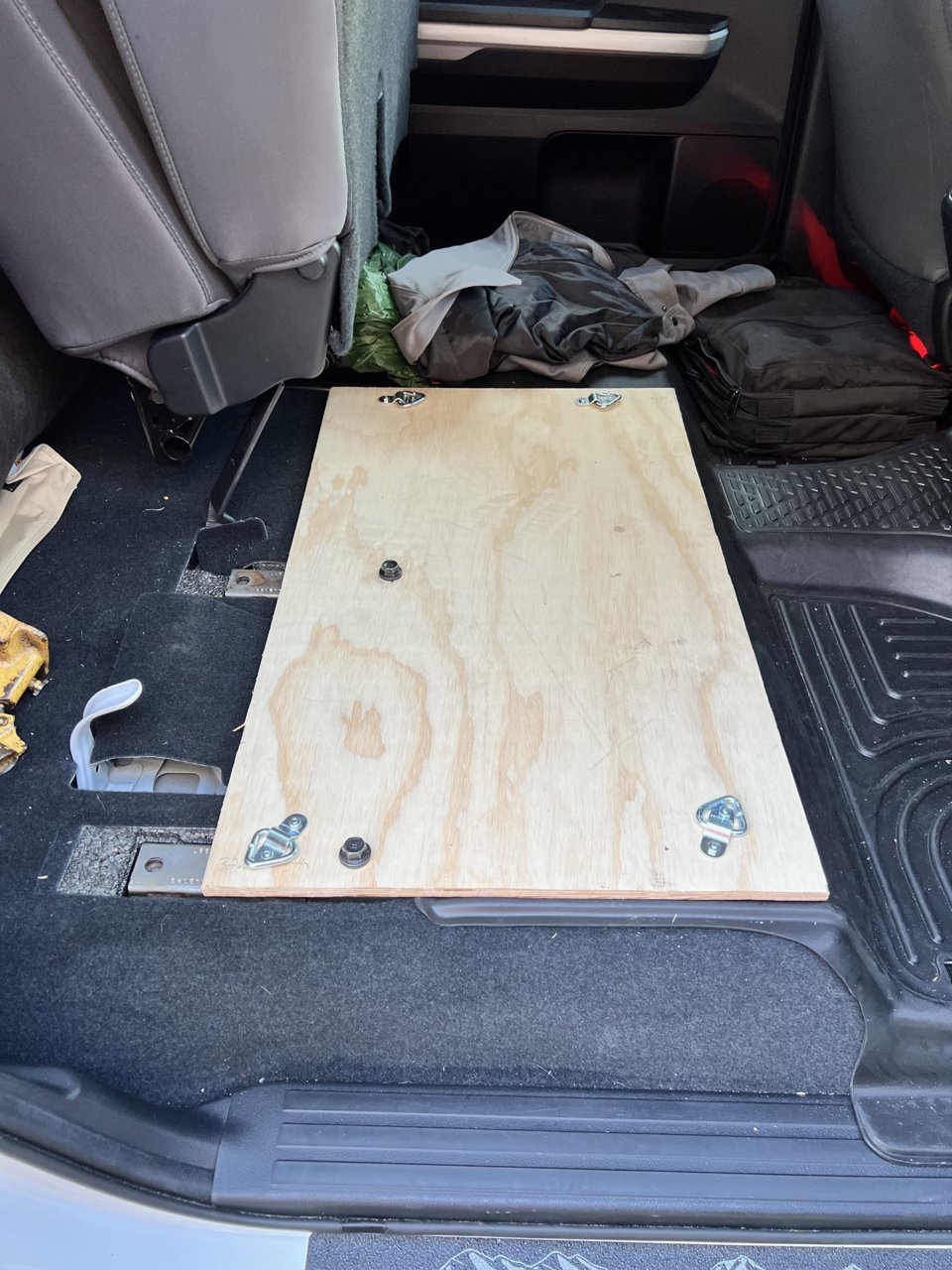

    Rigged up a makeshift floor mount out of 1/2 inch plywood for my SetPower RV45D Fridge. 25612F28-6E51-456F-86D6-BB8BF6BEF424.jpg0A21DDB7-B8F9-45D1-B595-10EEFE492E43.jpg
