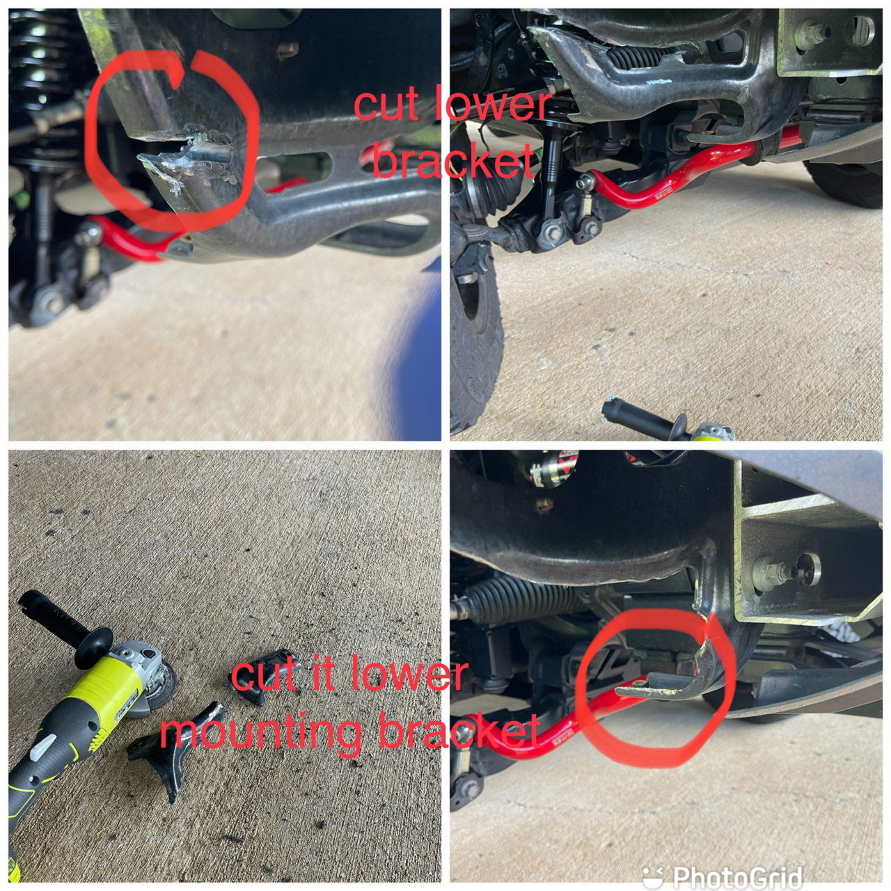

    VIPER CUT front lower bumper to clear 37” tires. figure I document my project as my research only found cut measurements but nothing on how to deal with the brackets, lower inner plastic fenders and mounting. I hope you guys have an easier job doing this.
    cut measurements. 2” on inner vertical cut, 1” on lower fog lamp, 6.25” on front bend and 5.5” on outer bend and used my inner painters tape to stencil curve. used a flat dermal and sanded after each cut to clean up for easy fender trim instal later.
    cut lower fog lamp bracket and lower mounting bracket used my angle grinder, sanded and painted.
    Cut the lower inner plastic fender where it bends. after test fitting made more cuts for cleaner front view.then drilled a hole on the lower inside to use as a zip tie point, remove outside fender mounting bracket clip and cut center section off. mark bottom hole to mount on lower fender, place the two brackets and bolt at center to make it one piece. mount bracket to outside fender for later instal of inner plastic fender. sanded and washed
    Installing lower inner plastic fender use factory mounting (2) 10mm bolt top and bottom that was cut to fit the lower section. push pin on frame near coil revisor, (1) zip tie to lower inner fog bracket with drilled hole for anchor points. Total (4) anchor points and very secure. Note: zip tie pulls the lower fender all the way forward to clear at full lock. NO heating just push and secure to still have a clean factory look and still protects the fog lamp housing.
    Finished with fender trim on viper cut.
    Over 5” of clearance at full lock and over 6” straight.
